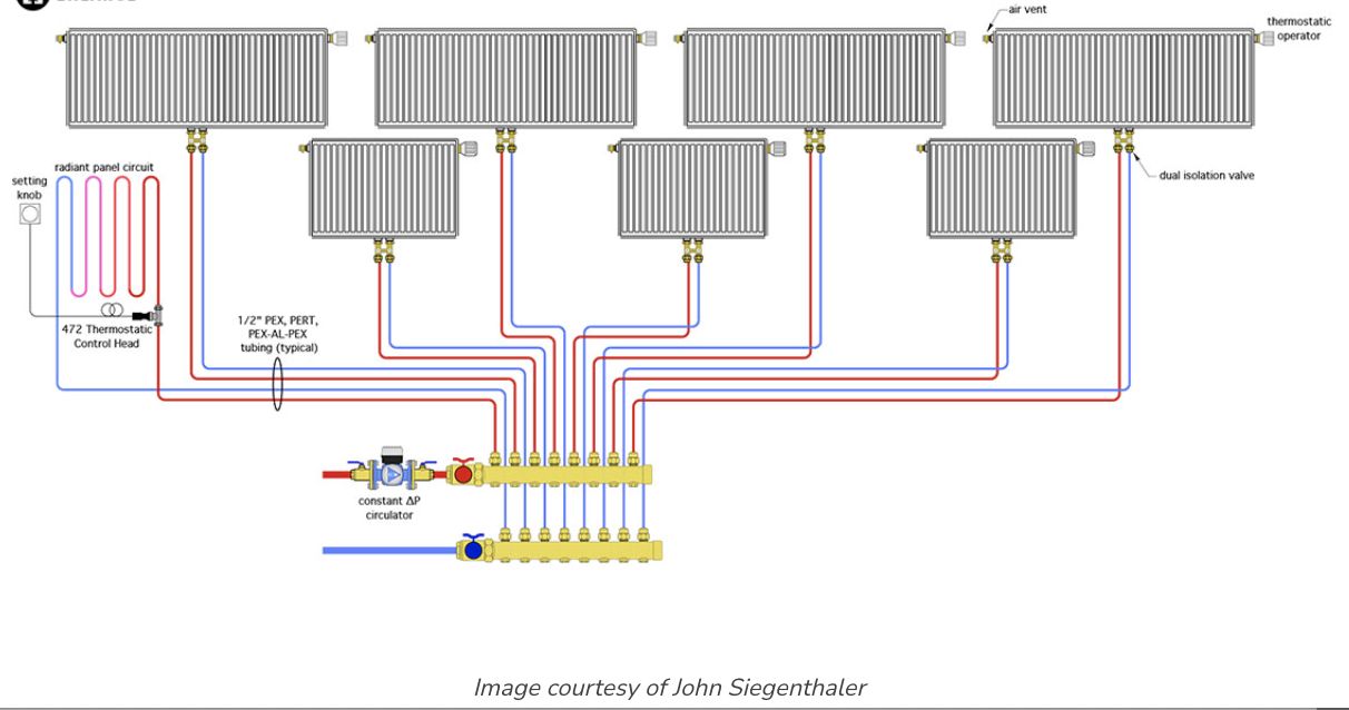

If you go with a small pex redo, a homerun piping method works well. Or in some cases a basement could use an extended homerun manifold and cut down on the amount of pex leader lengths.
TRVs on each radiator give you ultimate adjustability. Multiple radiators in the same room could be served by a single TRV.

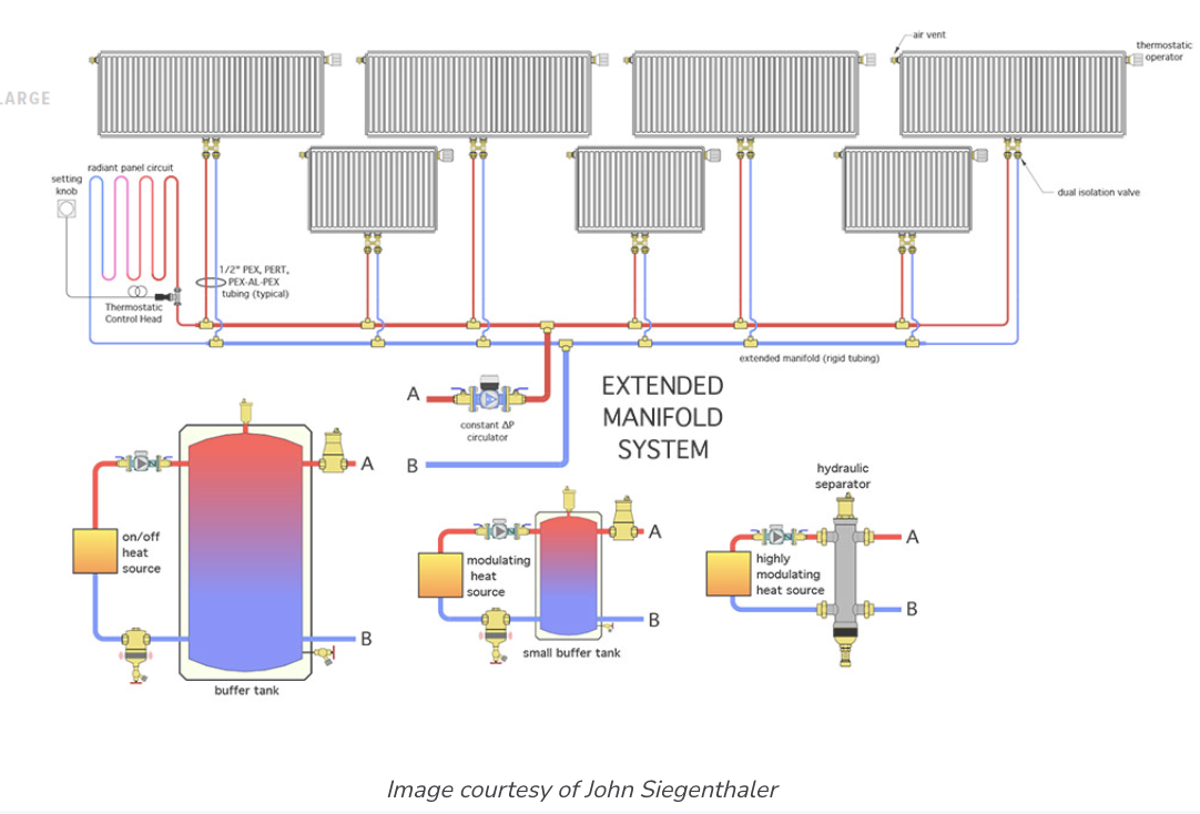

Here is an example of a homerun and extended homerun manifold system. Note the radiant zones also if you get your supply temperature requirements within 10° or so degrees.
With a lot of zoning a mod con is my choice or possibly a buffer with an on/ off boiler like cast iron.

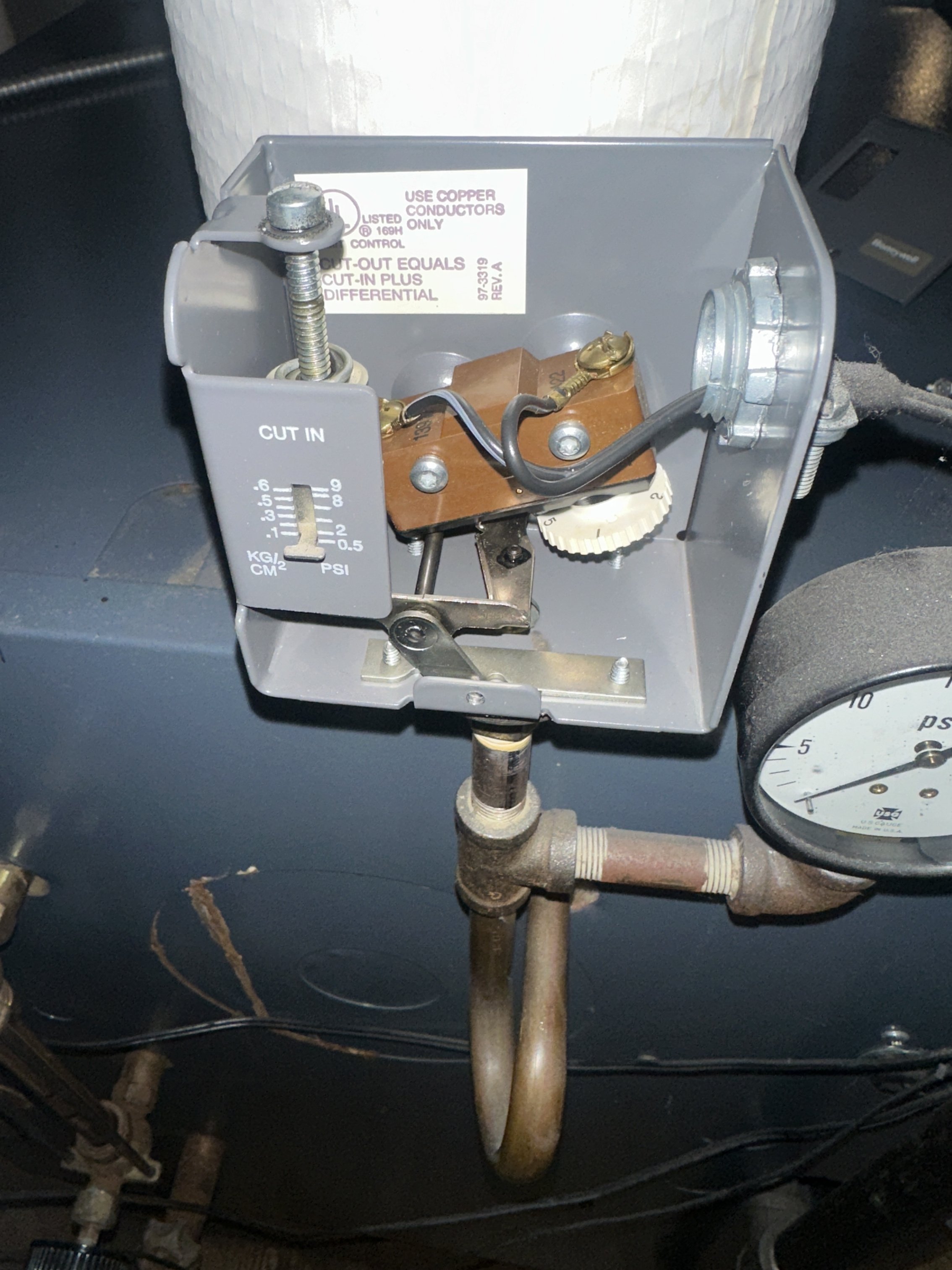

That entire unit is one big mold factory.
Download the manual and see if it must be removed or it can stay.
