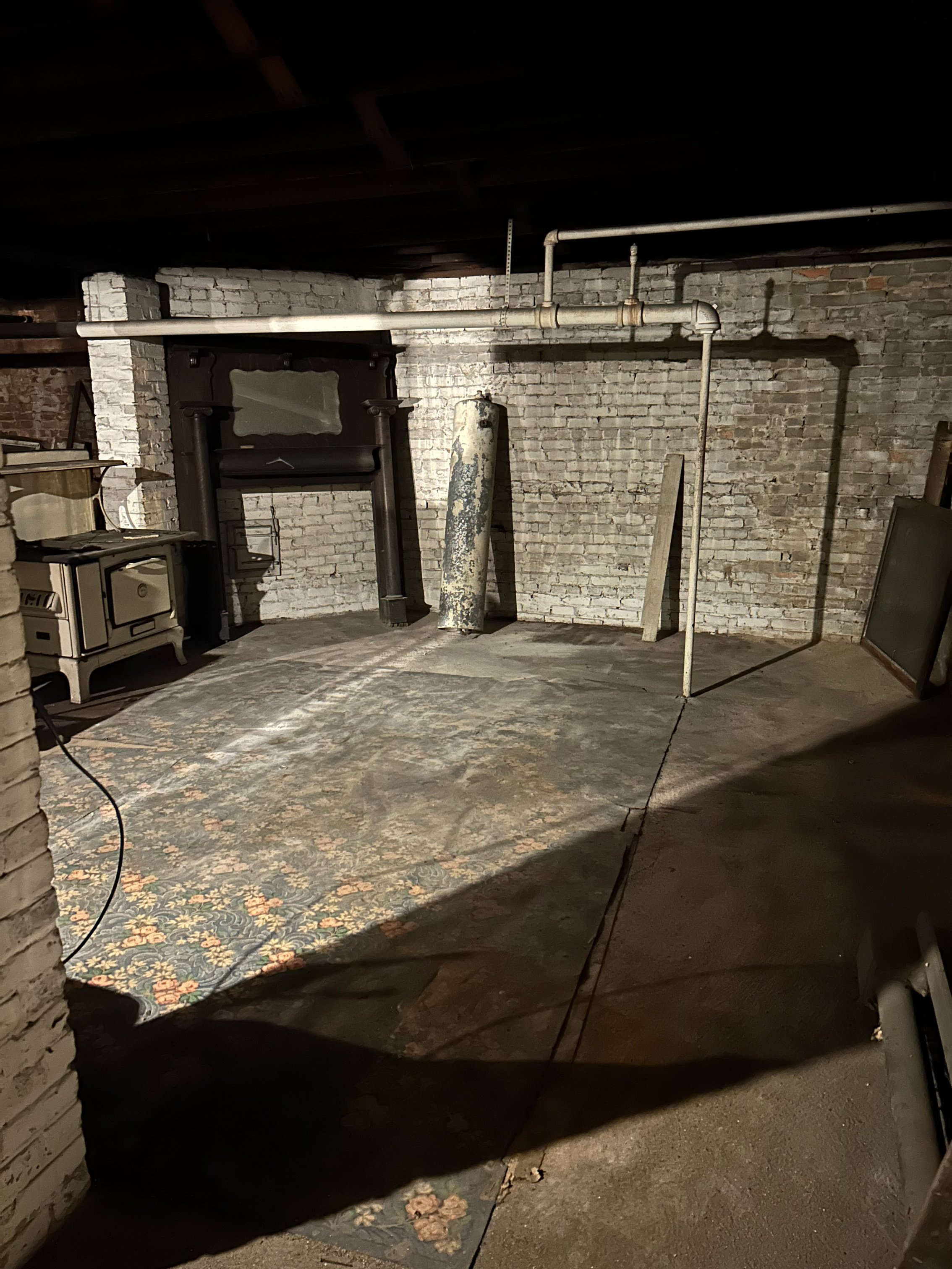

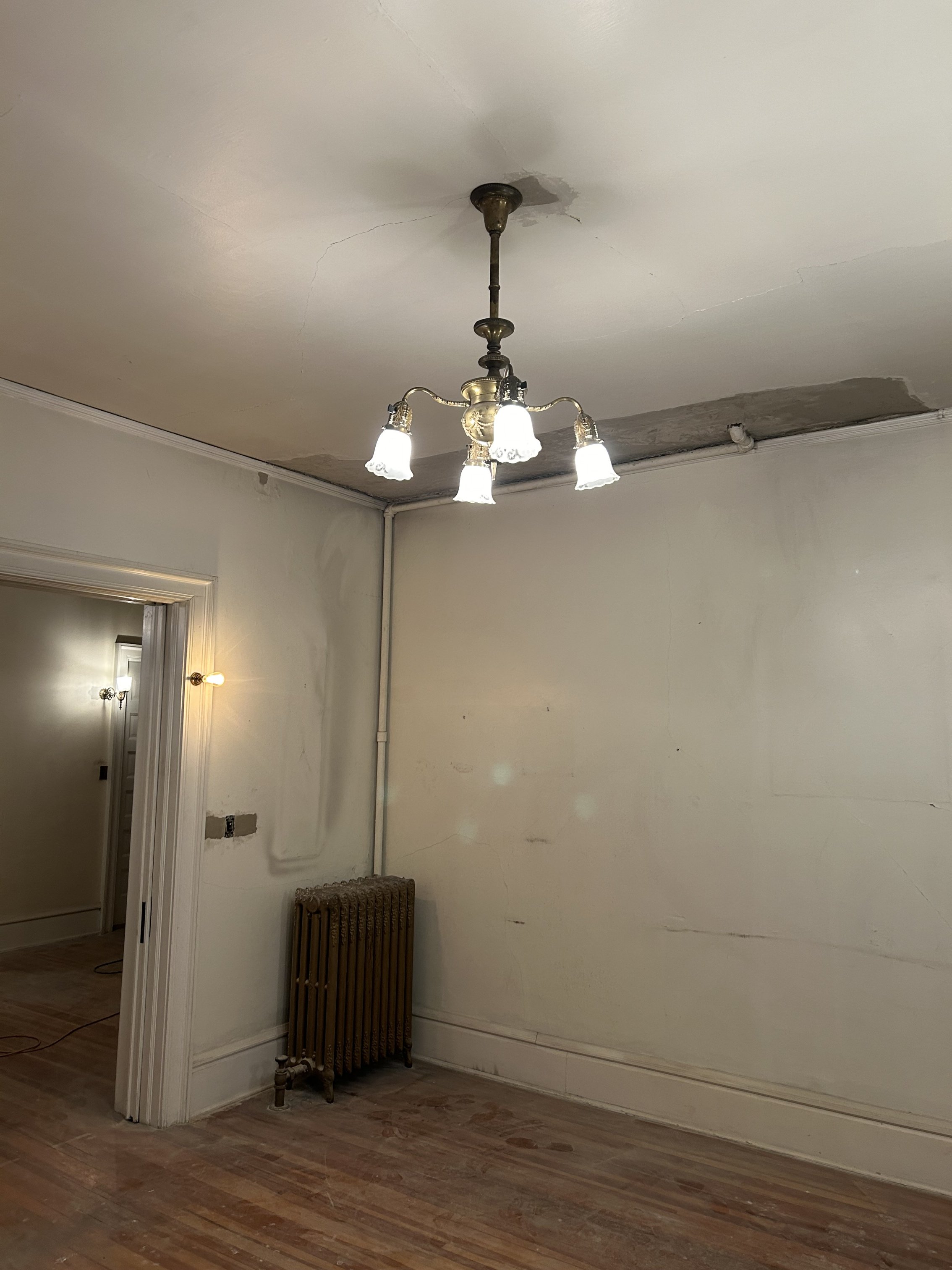

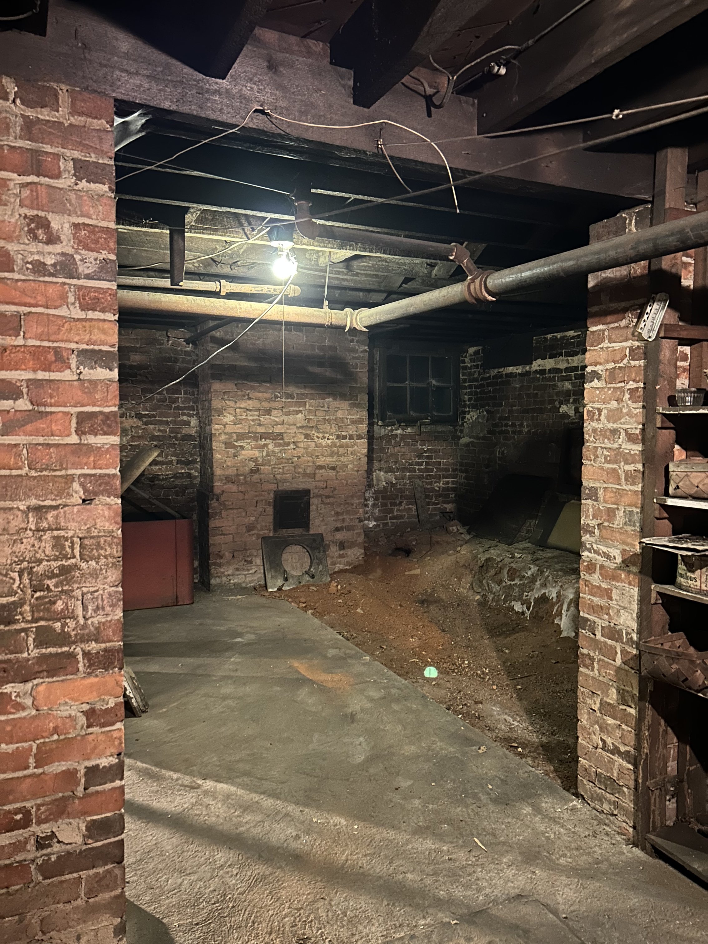

Hello,
I am restoring a 1908 6,000 sqft house that originally had a complex overhead gravity fed system dropping down from the attic. Much of this system was removed in the 1940s when a steam boiler was installed and exposed 1” and 1 1/2” lines were run to each radiator as well as large 3” runs looping the basement to supply them.
I am finishing the basement and need to remove the large runs so am planning to convert the system back to hot water by running a second line to each radiator in black pipe to match what was done in the 40s as returns for the hot water. (Most of the original radiators are there with the bleed valves so I will just remove the Hoffman vents) I am going to use a modern hot water boiler with a circulator to be able to run the new lines in the basement in the joists for head room. What size and material is best for running these lines in the basement? For ease of installation I am trying to avoid using black pipe where it won’t be seen. Is pex a viable option or is copper better? Is it possible for these lines to be sized down with the circulator pump being used?
Photos are of existing steam lines in the basement as well as the original radiators.
Thanks!
    Jamie Hall Member Posts: 27,357
    My first really stupid question. Why are you not planning to bring the steam system up to running condition? Granted there would be some work to do, but (like moving vents on the radiators to where they should be!) but… surely there is a reason?
    Having said that… the question of PEX vs. copper vs. black iron actually requires an answer to another question first: At what temperature do you expect to need to run the hot water system? And to answer that you need to know the heat loss of the various spaces and the size of the installed radiation. That will give you the required maximum operating temperature of the hot water system, and from that you can decide on PEX — which won't take sustained high temperature — or copper or black iron.

    Thank you for responding! I am not wanting to keep the existing steam system because it was run when the basement was not intended to be used and the pipes are in the way of finishing the space. By going back to hot water I’m hoping to eliminate the need for the pitched piping so the new runs can be put up into the joists as much as possible.
    From my rough calculations using the original radiators that were originally sized for a hot water system, I’m assuming around 180 degrees. Ideally less but that would be on the high end.

    I can disconnect them to check them individually. What diameter of pipe is best for the supply and return lines in the basement for the hot water conversion?
    Steamhead Member Posts: 18,491
    Depends on how much heat you have to move. Do your heat-loss calculation to get the numbers.

    The house is almost exactly as it was in 1908. No real layout or square footage changes. The radiators aside from three that were replaced later are all quite large.

    Which are you referring to as the slenderized? The two radiators I posted photos of are the original ornately cast ones with old ports that had been plugged for the gravity system. There are three 1940s small radiators that I am replacing with larger ones but I did not photograph them.

    until i zoomed in i thought the goldish radiator in the corner was a slenderized radiator that was a later design, now i'm not sure because it appears to have one of the arco patterns of decoration but the tubes look thinner
  • knudsluk
    knudsluk Member Posts: 17
    Ahh, ok. These were made by National Radiator Co.
