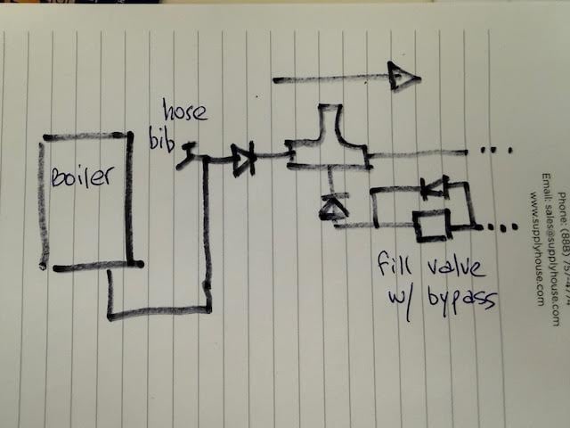

- To avoid letting air into the system at any point, what are your suggestions on the following?
- Initial stage (prior to install/ drain where the radiator is):
- Should I close the last valve for the supply part of the loop (after the pump in the upper right of the photo) and close the first valve for the return (bottom right by the expansion tank I think)? And then cut the tubing to and from the kitchen radiator I'm removing, and install ball valves inline with the main pipe there?
- You are overthinking this
- Final stage (recharge/ purge through the radiator):
- Should I also install a
boiler drain valveoff of the return pipe after the new radiator and before the ball valve inline in the main? And hook a hose up to this and into a bucket? (See attached image).
- Again over thinking. just purge as usual with one more step on the Kickspace loop. purge with valve open until air free, then with valve closed until air free.
- Should I flip the
fast-fill levelon thepressure reducing valve(below the boiler) until the gauge reaches 12-15 PSI while the gate valve between the radiator branch tees is closed and the new radiator drain valve (downstream of the radiator), to force air out of the new radiator?
- You can go above 15 PSI, just don't get too close to 30 PSI. I like to stop at about 25 PSI, but if you go over by accident don't worry, the relief valve will release any excess pressure so you don' damage anything. …and it is only water
- And then open the gate valve between the radiator branch tees and and open the drain valve near the expansion tank, to force air out of the rest of the system?
- already explained above

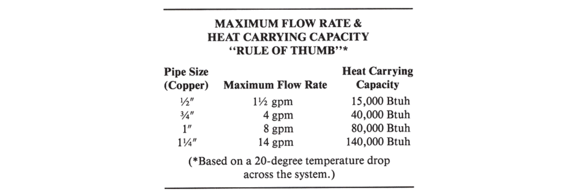

- "The PEX connecting to the kitchen radiator is actually 1/2" PEX and not 3/4" PEX, that seems to be the case for at least a few of the radiators, but I'm not sure where or why it converts between 3/4" and 1/2"."
This can be a problem on a series loop, if that is how the system is piped. It is usually not much of a problem on a 3/4" single-pipe loop with diverter tees.
With a branch system: Think of the 3/4″ pipe as the main highway, and the 1/2″ pipes as the exit ramps that feed each radiator.
on a series loop: If you have a highway with construction and all the traffic needs to funnel down to one lane, then there is a traffic jam
Using a rule-of-thumb calculation, the flow through 1/2" pipe, to stay quiet and avoid velocity noise, should not exceed about 1.5 gallons per minute (GPM). Based on a 20° temperature change (ΔT), 1.5 GPM would only be able to move about 15,000 BTU per hour through that loop.
So, a series of pipe sizes that includes any significant length of 1/2" pipe would limit that branch or loop to about 15,000 BTU/hr.
If there is a 3/4" main pipe that stays 3/4" from start to finish (from the boiler supply to the boiler return), that pipe can move about 4 GPM without creating noise. At a 20° temperature drop, that would move about 40,000 BTU/hr.
So having a series loop like this with any 1/2" pipe could limit how much heat can be delivered from the boiler to the radiators.
However, if the 3/4" pipe is the main loop and there are 1/2" branches coming off of it, then the 3/4" main can still move about 40,000 BTU/hr from the boiler, while the 1/2" branches can supply up to about 15,000 BTU/hr to each radiator without a problem.
Does that make sense? For more about your system here is a simple book that is easy to understand when it comes to what is happening inside your heating system Zoning Made Easy.

4) You can isolate as necessary when you set about to do your work. The best thing to do for purging is to install a purge assembly as shown. You can do all your purging from the boiler room and it purges everything, including the boiler. Otherwise, you're doomed for hours of wasting water and frustration. Dan Holohan taught this to me many years ago; Wetstock I?, (aka A Gathering of Wetheads) 1993? It's the first thing that gets installed on my systems.
