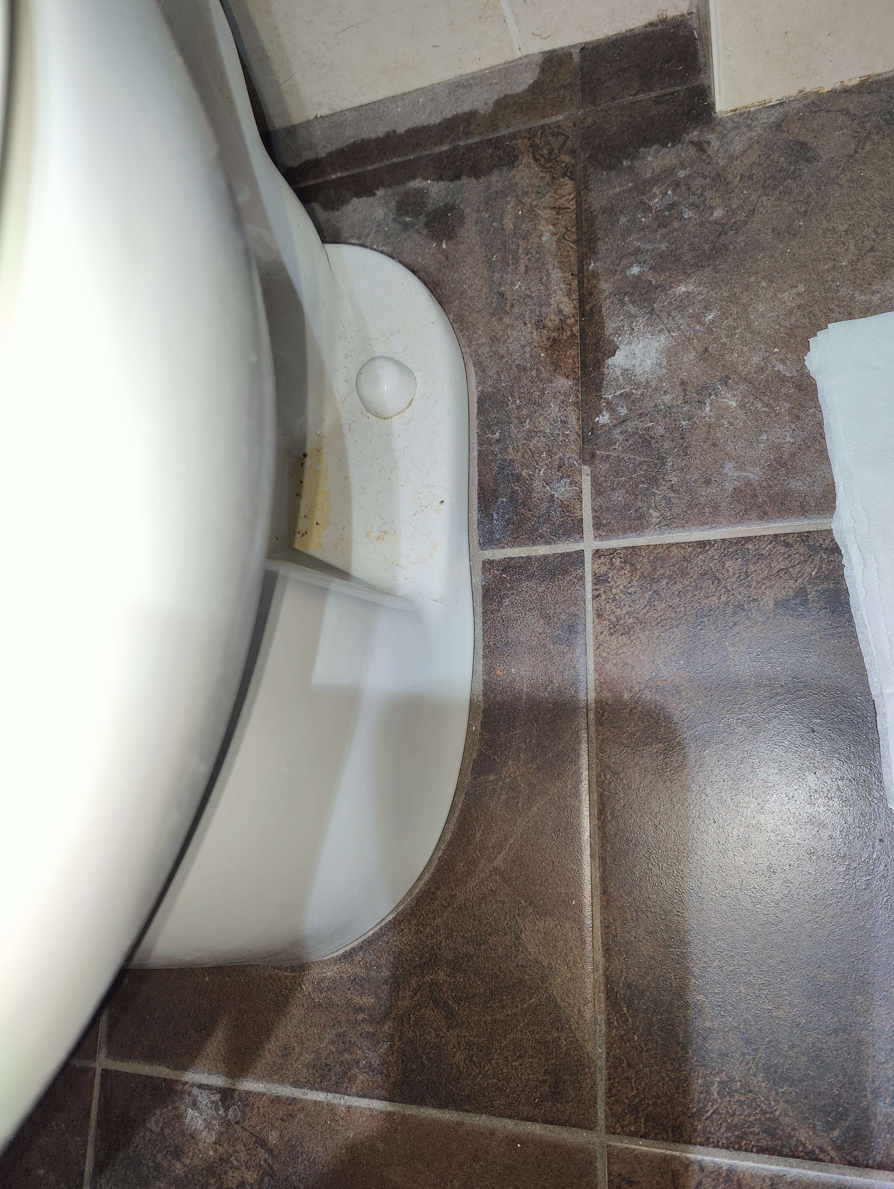

the bathroom floor behind the toilet is constantly wet along the tile joints. what could be leaking?

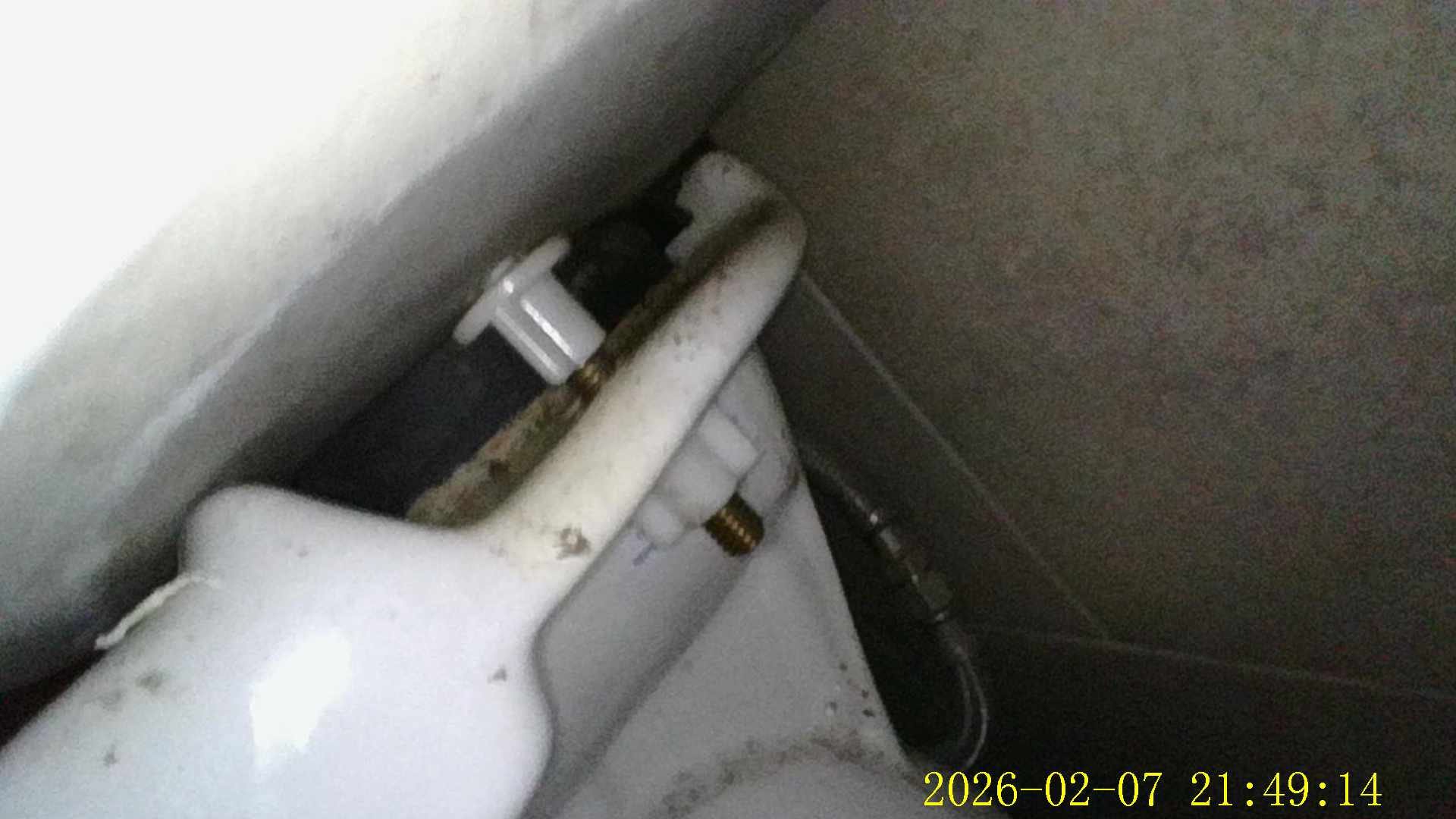

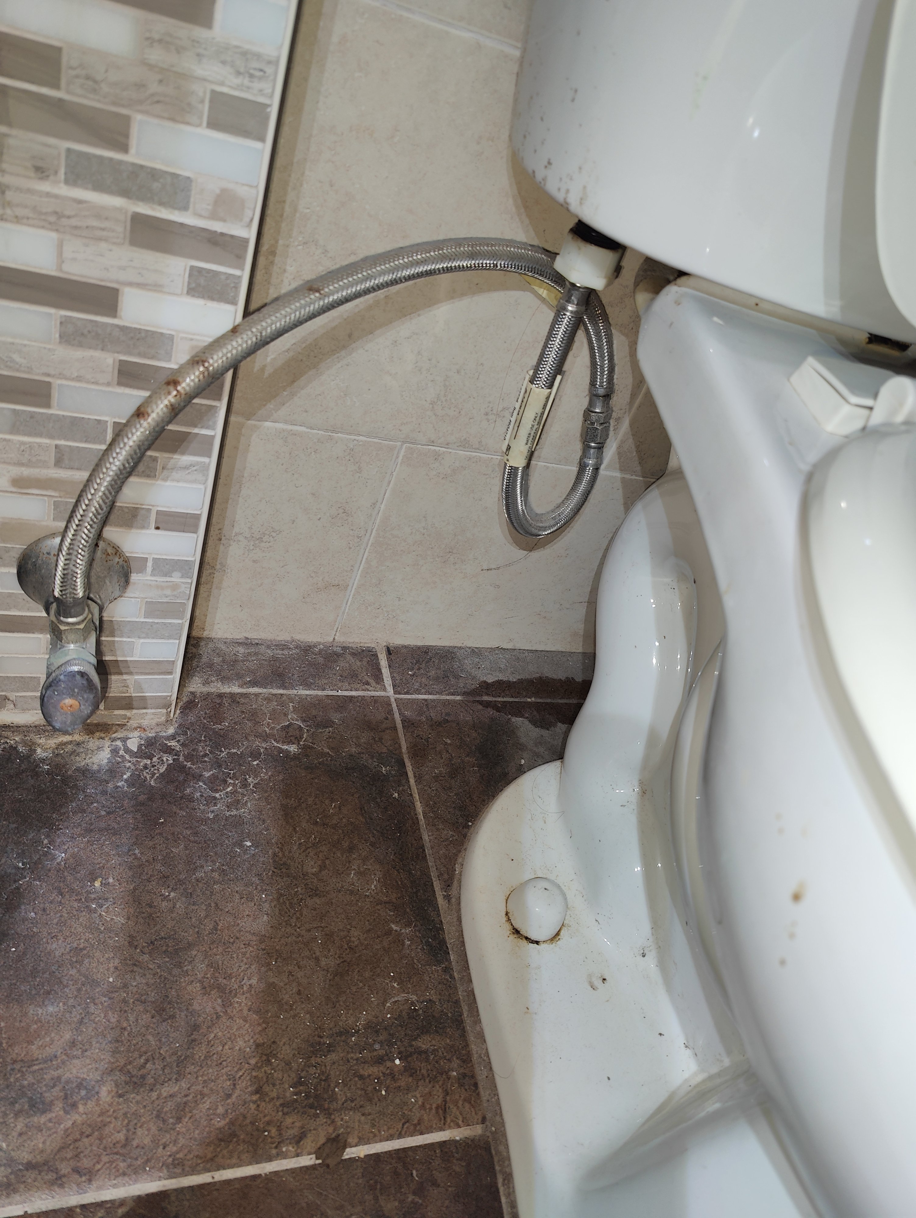

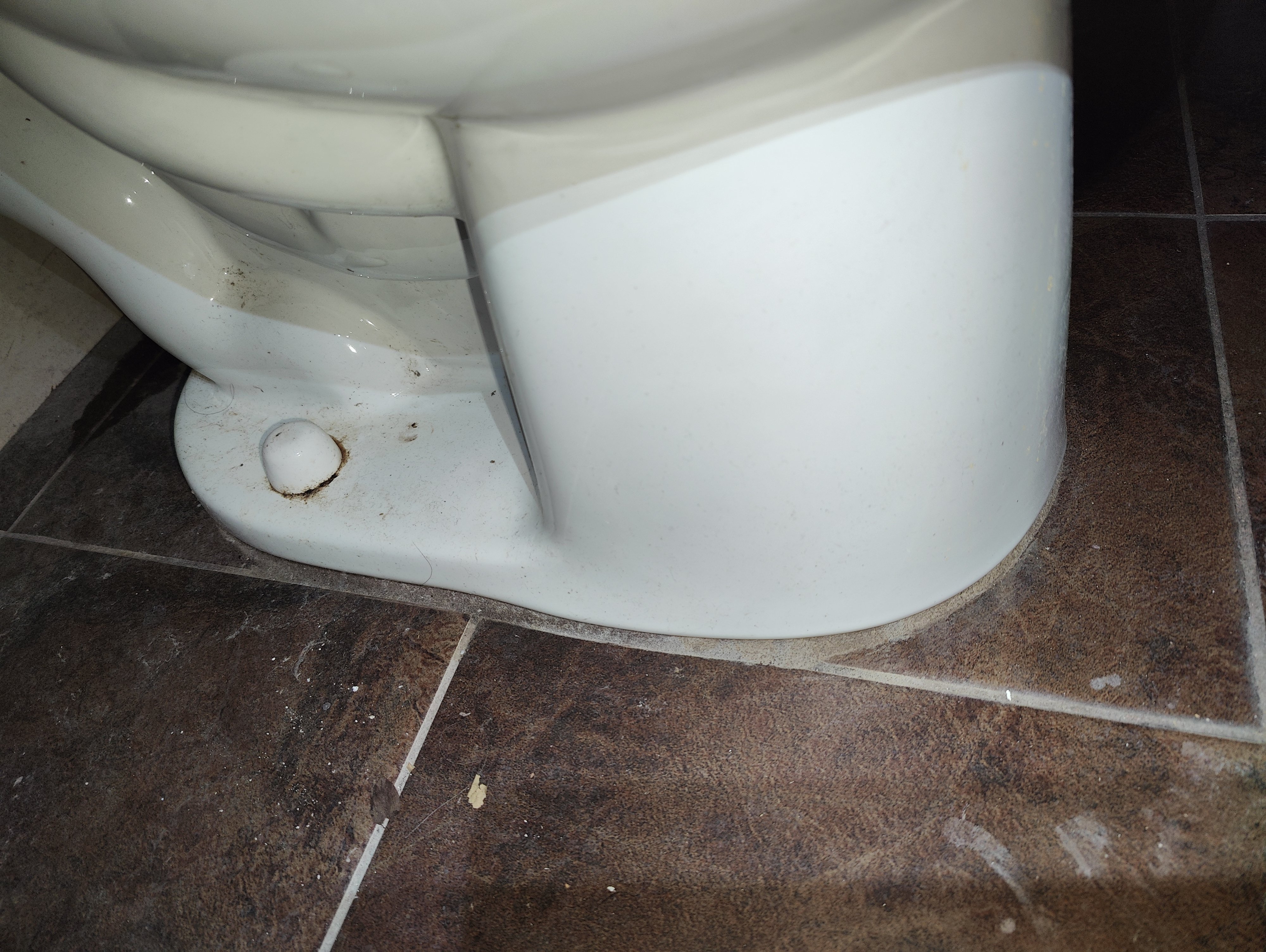

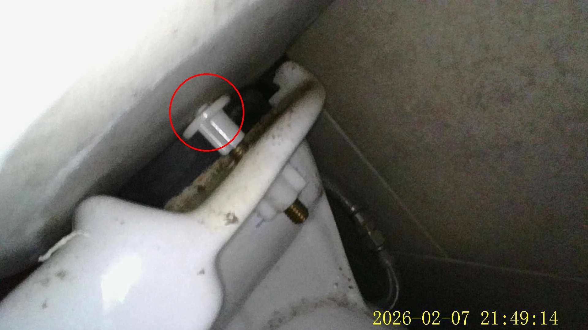

    Thanks for all your posts. The perimeter of the toilet base is dry. I also placed some tissue paper behind the toilet, it didn't show drippings after several days. The water inlet and connection area felt dry. So the water is likely weeping from beneath. What pipes are down there?

    is there a drop coming off the bottom of that loop on the supply line? it is either coming from there or inside the wall to the right

    Replace the supple line. Get one the right length. Friend flooded her whole house when that white nut cracked. Rust and deposits, leaking for a while.

    sounds like this isn't the active source of your water but make sure you're tight here too

    if the ring is leaking, why is the perimeter of the toilet base not wet?

    @azward It appears that you have tile and grout there. Water follows grout lines, it doesn't permeate a glazed tile and so the tile doesn't look wet. Unless the seal has failed catastrophically there's only a little water leaking at each flush and it follows the grout lines as the path of least resistance, it won't necessarily flood out over the surface of the tiles. Back when I was on a maintenance crew and saw situations like your picture shows I did the "wet finger" test underneath the tank and checked the supply line for leaks but it usually was the wax ring.

    dry it out and see if it starts from the wall or the supply line. put a rag or paper towel in the path so you can figure out which way it is going. i suspect the 2 supply lines screwed together may be leaking at that joint or the tubing itself is leaking, dripping there, and collecting in the corner if the corner is slightly lower.

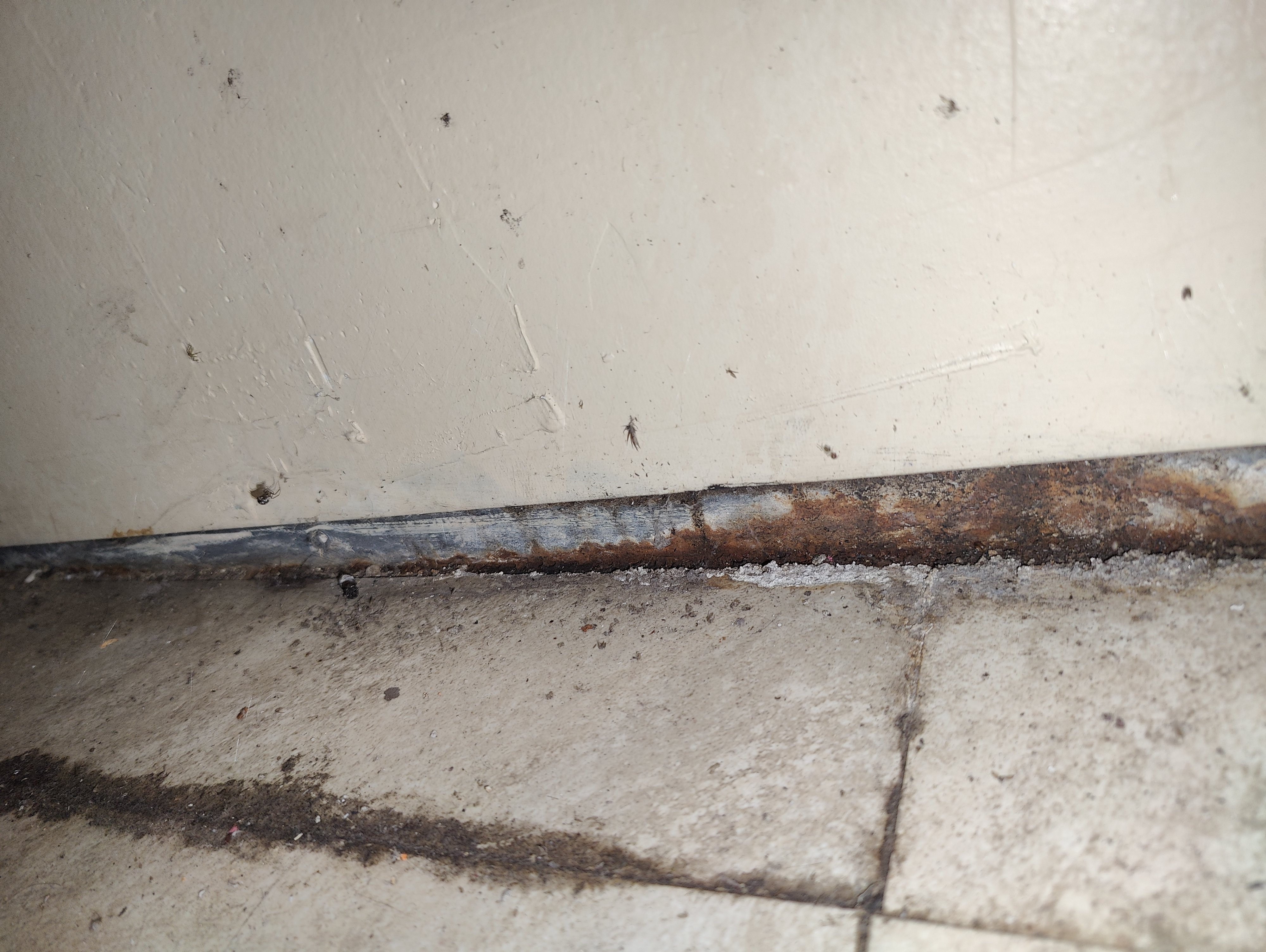

    now i would bet it's very likely the shower. the shower stall is to the right hand side of the toilet (facing toilet)
    this is a photo of the wall in the boiler room, right behind the shower area. it's constantly sweating. now connecting the two areas together, it's very likely the shower water supply tubing, or the drain pipe is leaking
    to crack things open, where should I start?

    It's not uncommon for the shower valve to leak. Not sure what kind of valve you have but I'd check there first. It's the easiest to check and repair.

    The leak could also be from a failed shower pan.

    It could be the two bolts that hold the tank to the base. The seal washer inside the tank could be the problem, the supply line to the tank could be dripping. Maybe a bad flush valve.
