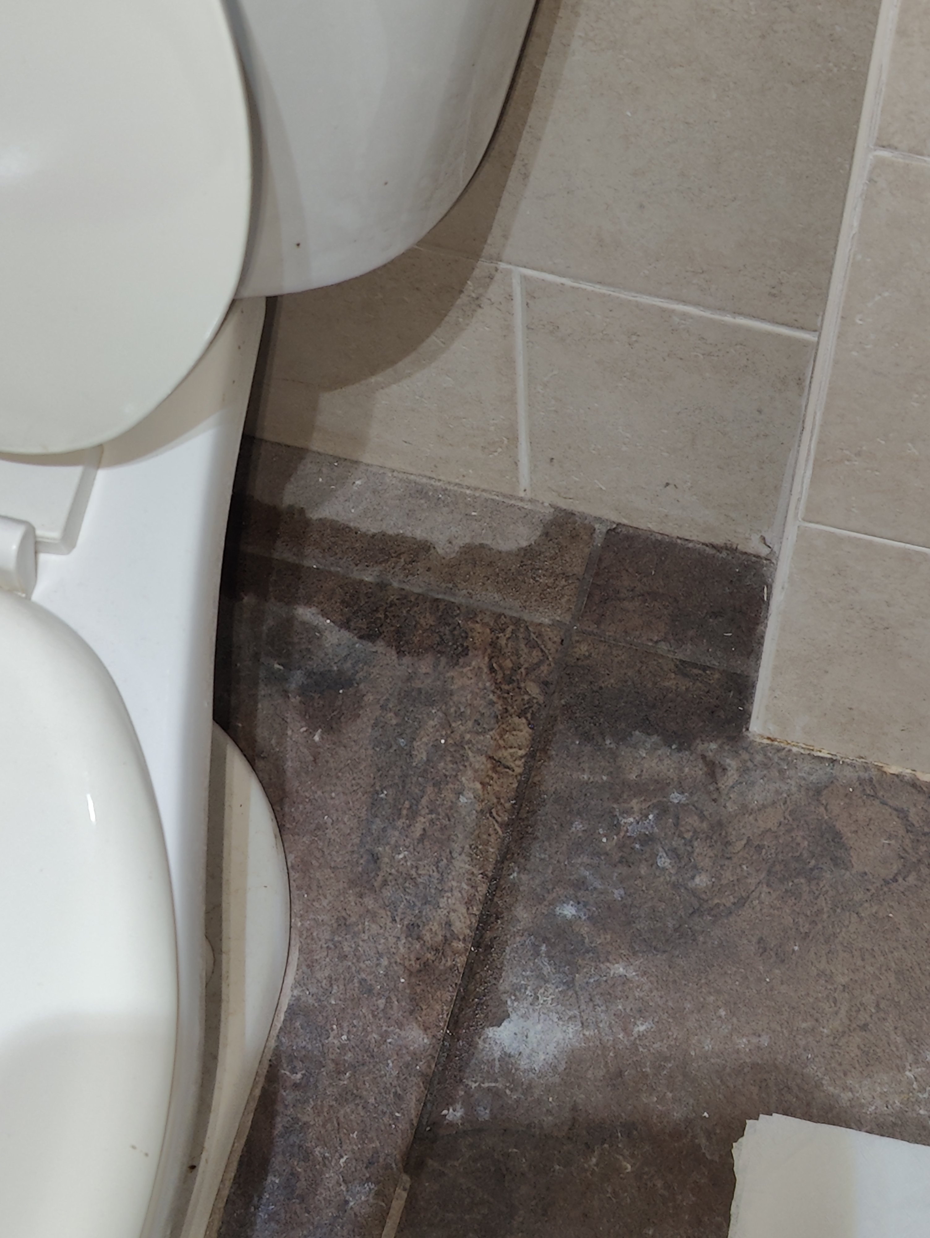

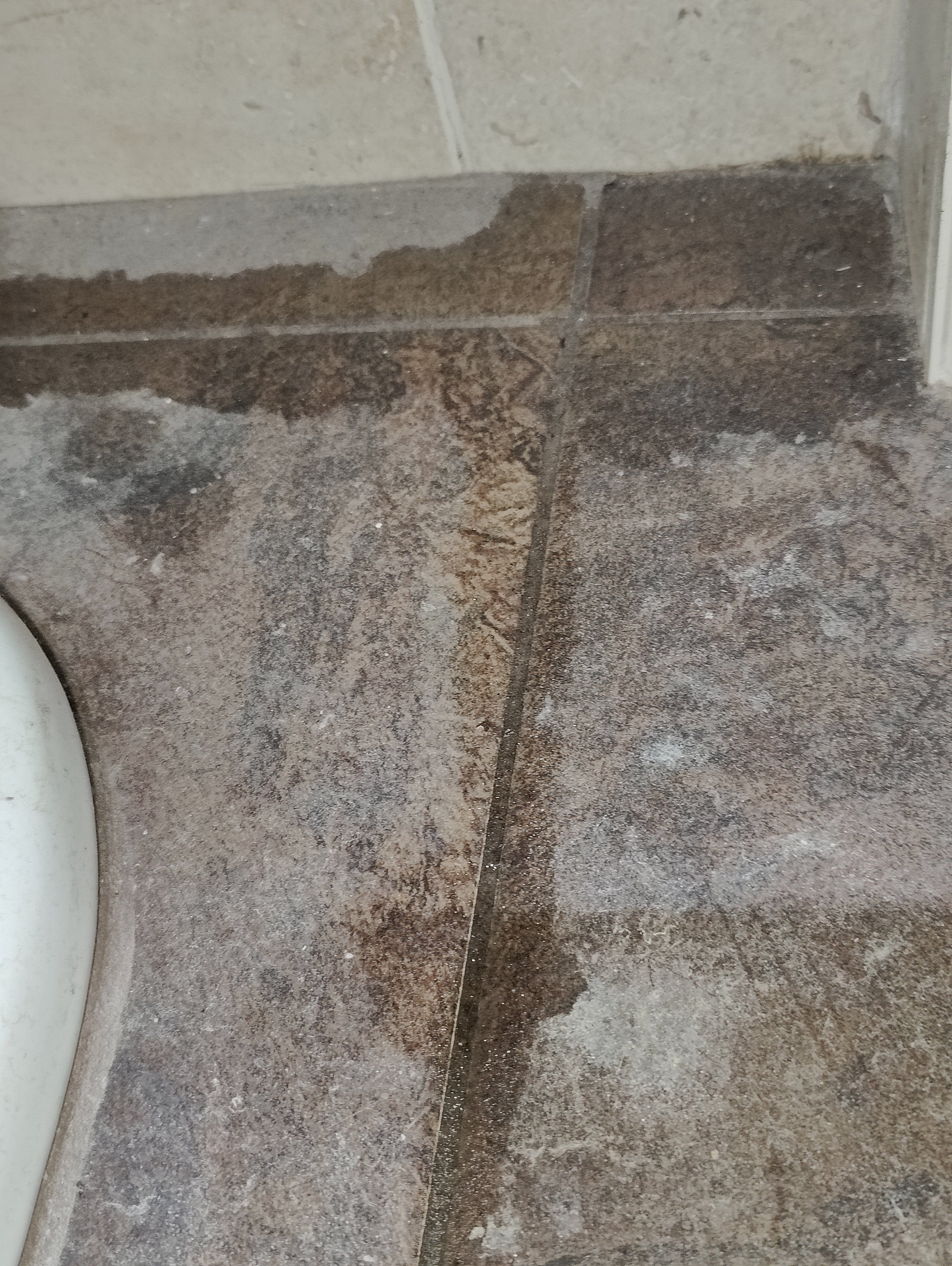

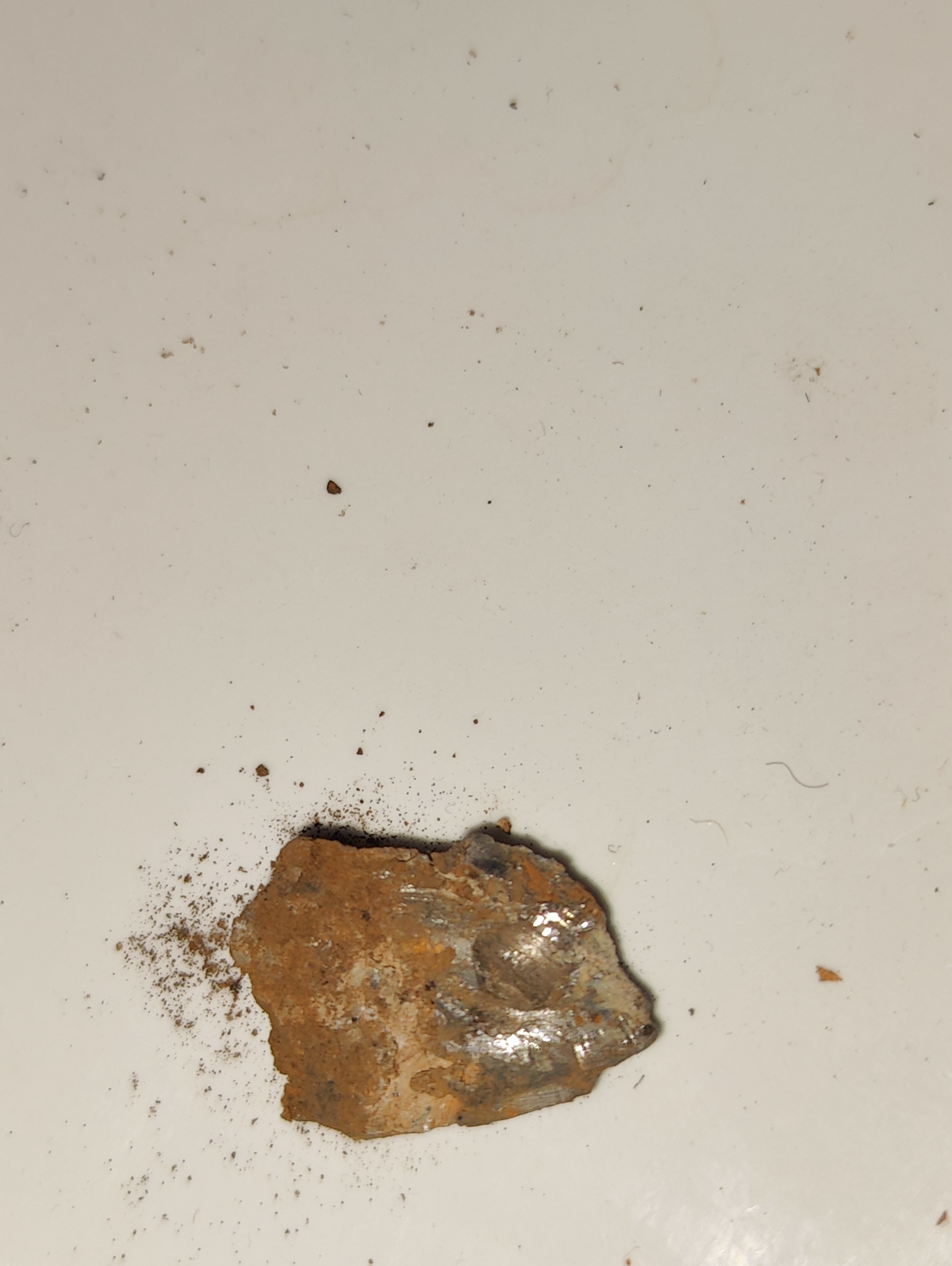

the bathroom floor behind the toilet is constantly wet along the tile joints. what could be leaking?

    More pictures all around toilet.
    it could be the seal to the closet flange or it could be the tank to bowel gasket or the washers on the tank bolts. or the supply line. or something in the wall. you need to get back there and look at where it is coming from.

  • I've replaced many dozens of toilets in a former life. Seeing that moisture pattern and assuming you already ruled out the supply line leaking
    -Tank to bowl ring gasket or bolt gaskets leaking
    -condensation around tank dripping down, generally more common in summer in spaces without AC
    -leaking wax ring and water seeping under tiles but coming up through grout joints

    Is the house on a slab? Looks like an under floor leak. It looks dry around the toilet .

    @azward take pictures of the underside of the tank where it bolts to the bowl. Take pictures of both sides, clearly showing the bolts sticking out.

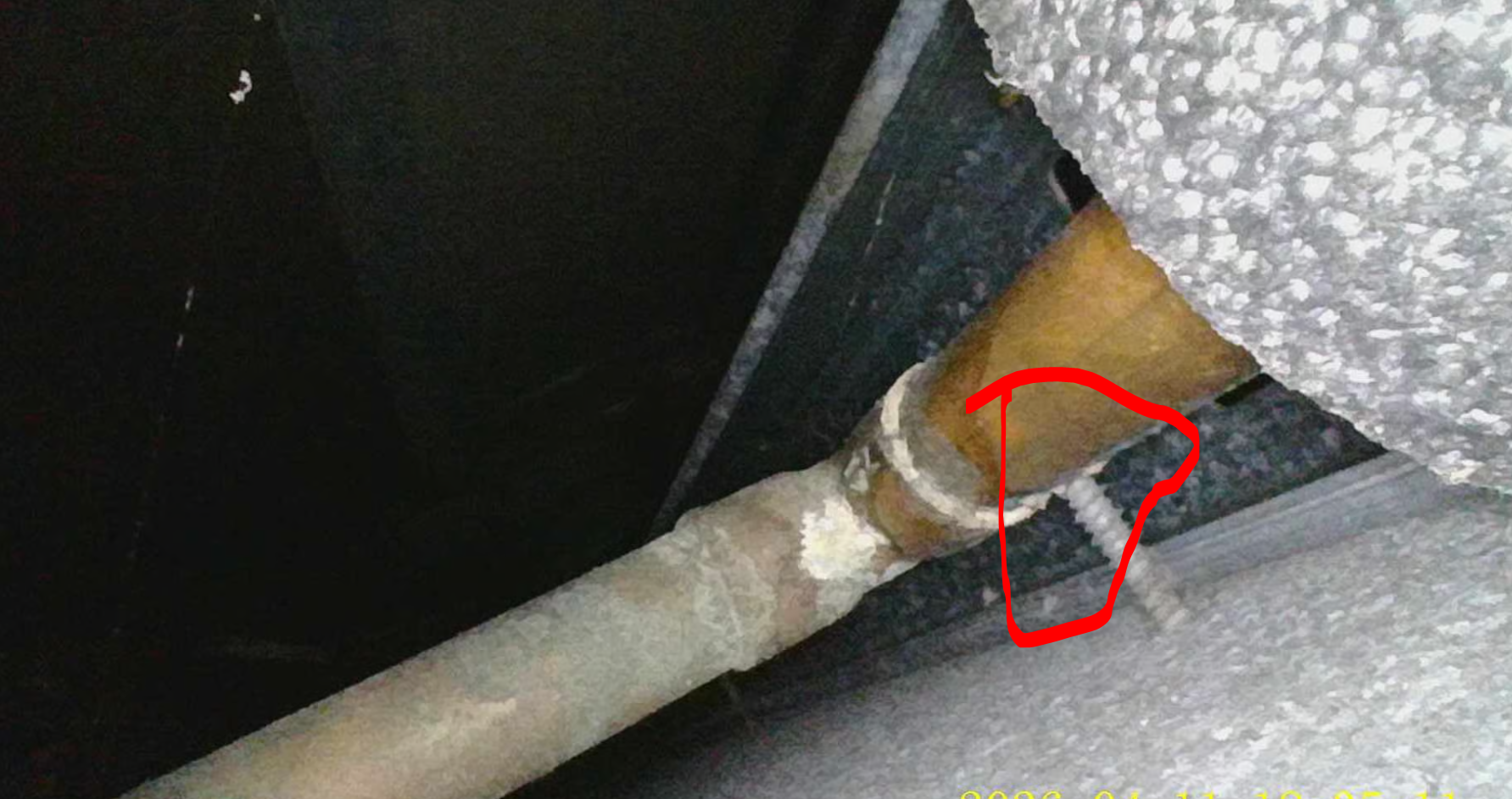

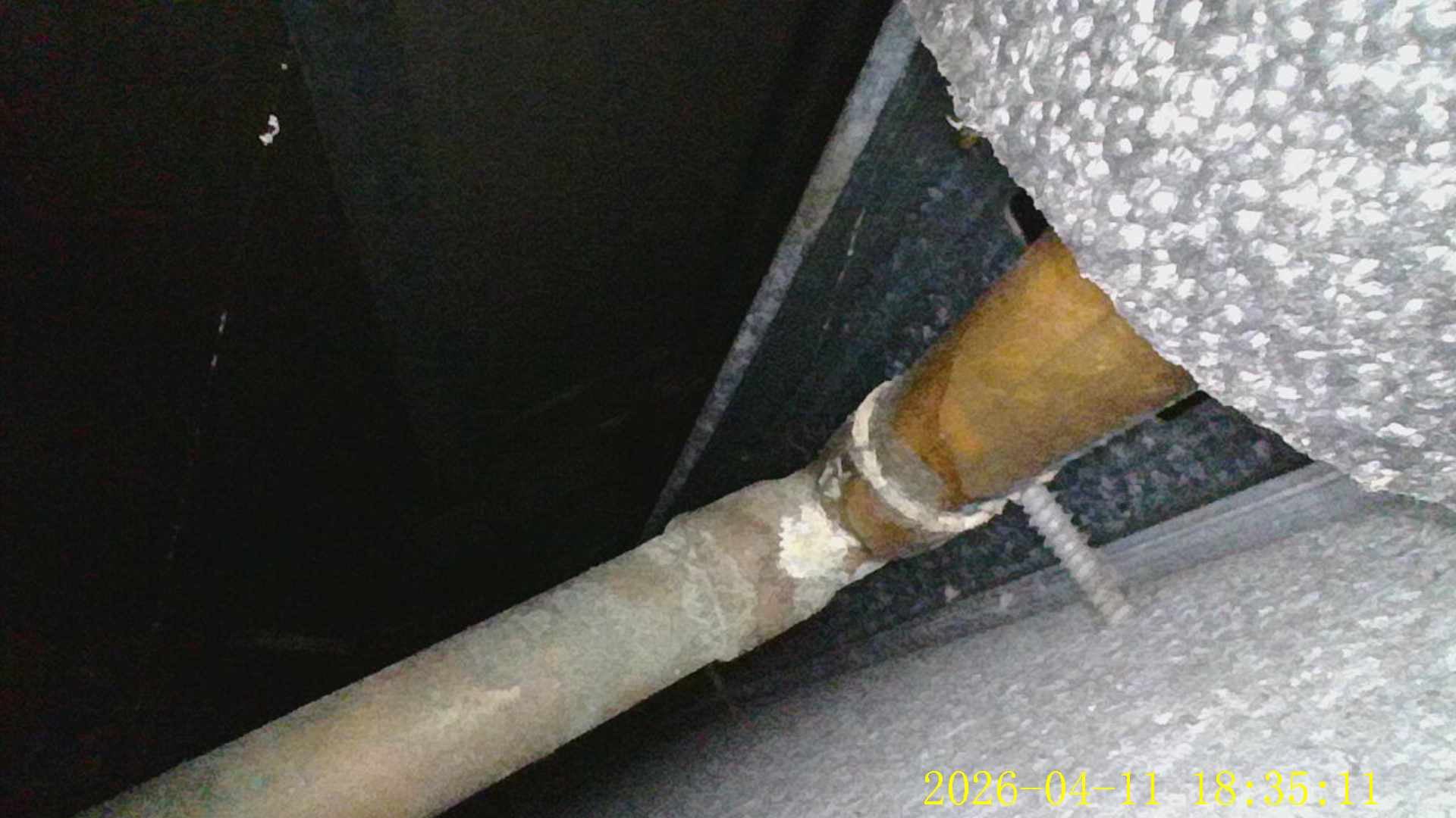

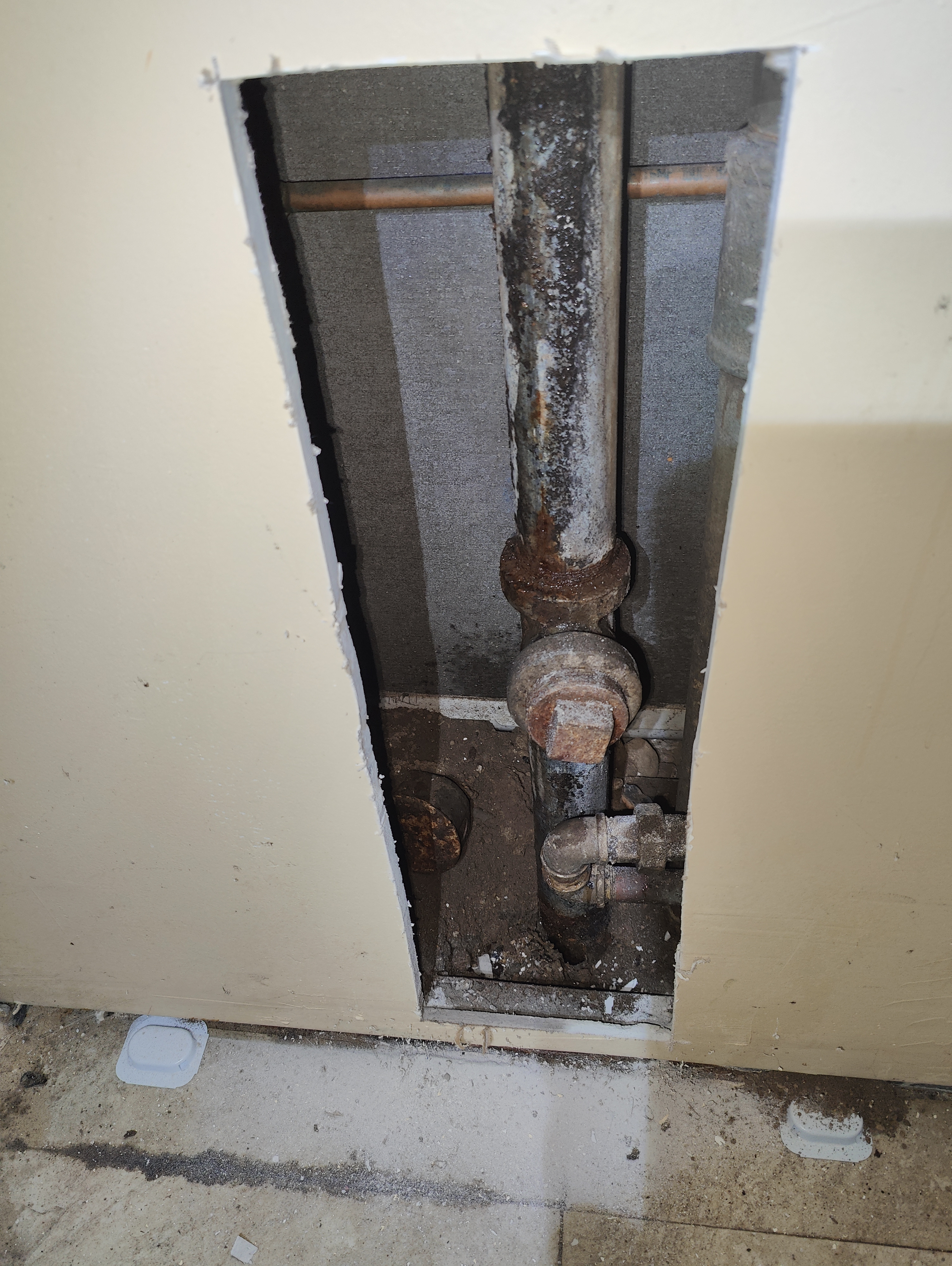

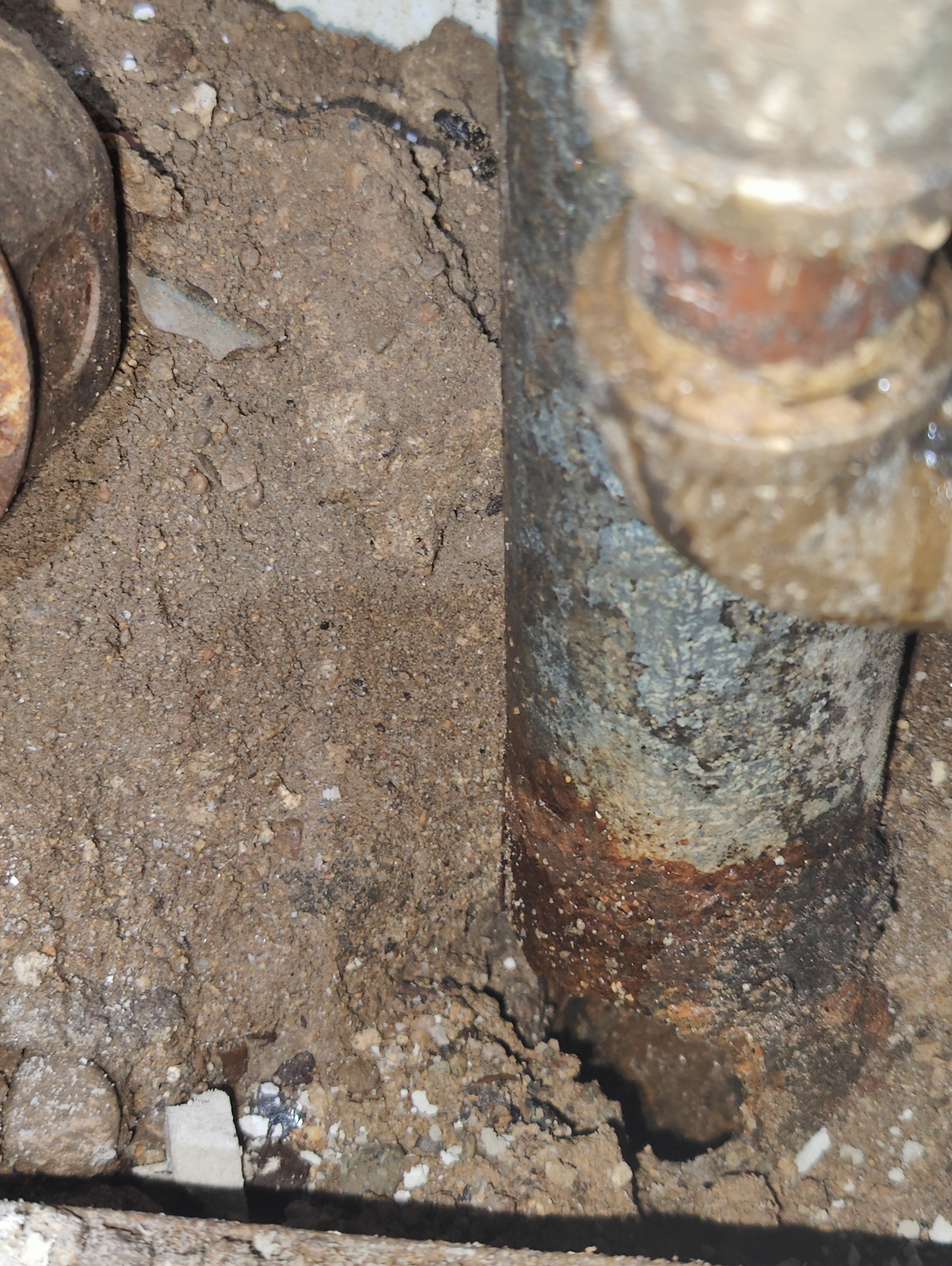

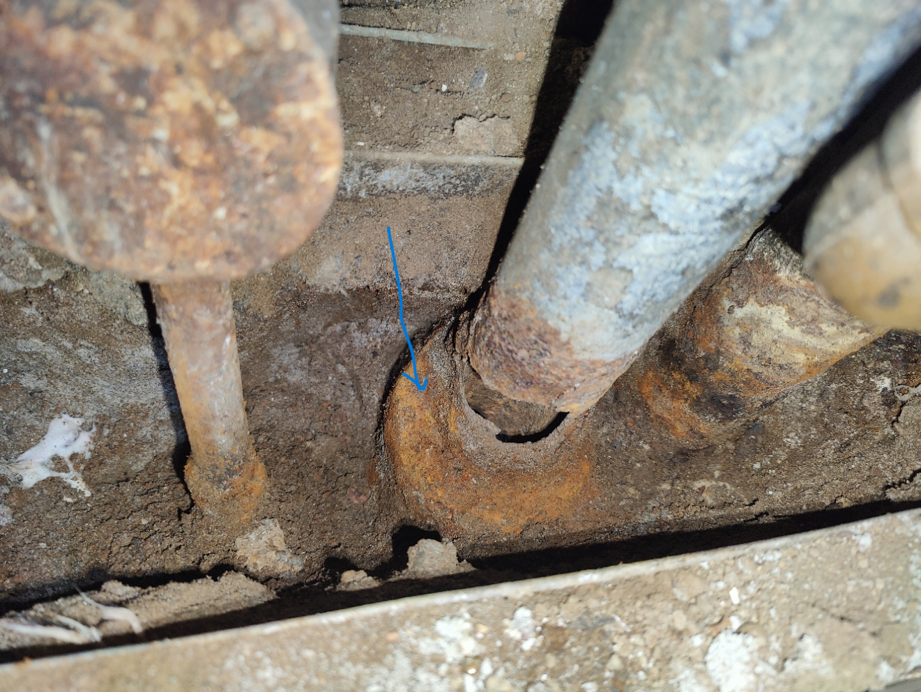

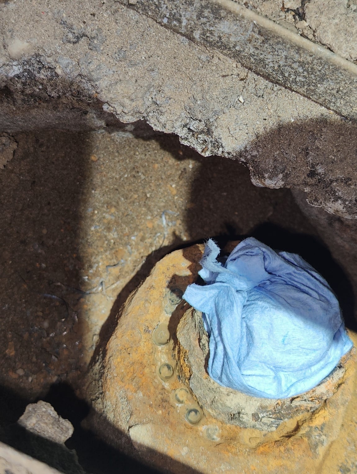

    Thanks for all your posts. The perimeter of the toilet base is dry. I also placed some tissue paper behind the toilet, it didn't show drippings after several days. The water inlet and connection area felt dry. So the water is likely weeping from beneath. What pipes are down there?
    IMG20260207171732.jpg IMG20260207171634.jpg IMG20260207171557.jpg IMG20260207171542.jpg IMG_0750.JPG IMG_0747.JPG
    is there a drop coming off the bottom of that loop on the supply line? it is either coming from there or inside the wall to the right
    HomerJSmith
    But not from below the floor. I have yet to see a leak flow up hill…
  • Jon_blaney
    Jon_blaney Posts: 351
    Replace the supple line. Get one the right length. Friend flooded her whole house when that white nut cracked. Rust and deposits, leaking for a while.
    azward
    sounds like this isn't the active source of your water but make sure you're tight here too
  • since you don't see any leaks from above, my next steps would be to pull the toilet and see if the wax ring had failed. If it had, great you found your problem. Clean the flange and toilet base and redo. If not, it's time to start thinking about what's in the wall behind

    if the ring is leaking, why is the perimeter of the toilet base not wet?
    mattmia2Grallert
  • epmiller
    epmiller Posts: 61
    @azward It appears that you have tile and grout there. Water follows grout lines, it doesn't permeate a glazed tile and so the tile doesn't look wet. Unless the seal has failed catastrophically there's only a little water leaking at each flush and it follows the grout lines as the path of least resistance, it won't necessarily flood out over the surface of the tiles. Back when I was on a maintenance crew and saw situations like your picture shows I did the "wet finger" test underneath the tank and checked the supply line for leaks but it usually was the wax ring.
    dry it out and see if it starts from the wall or the supply line. put a rag or paper towel in the path so you can figure out which way it is going. i suspect the 2 supply lines screwed together may be leaking at that joint or the tubing itself is leaking, dripping there, and collecting in the corner if the corner is slightly lower.

    Is this the same building as your other post? If this was on a slab I'd have guessed a leak in the slab floor soaking through the mortar. But I would guess there is a leak in the wall behind the toilet.

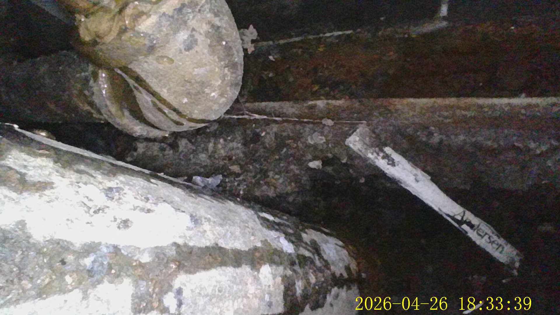

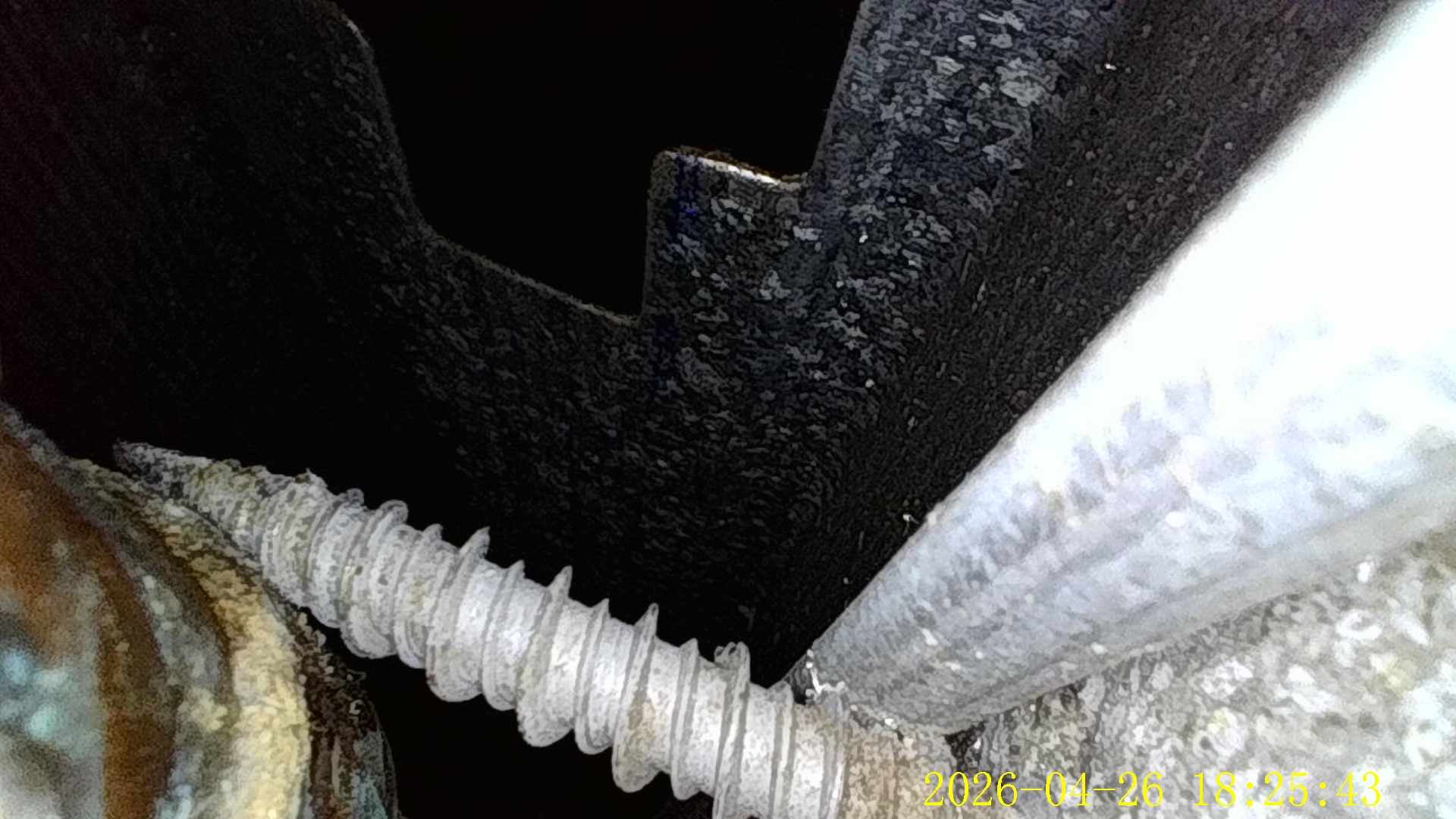

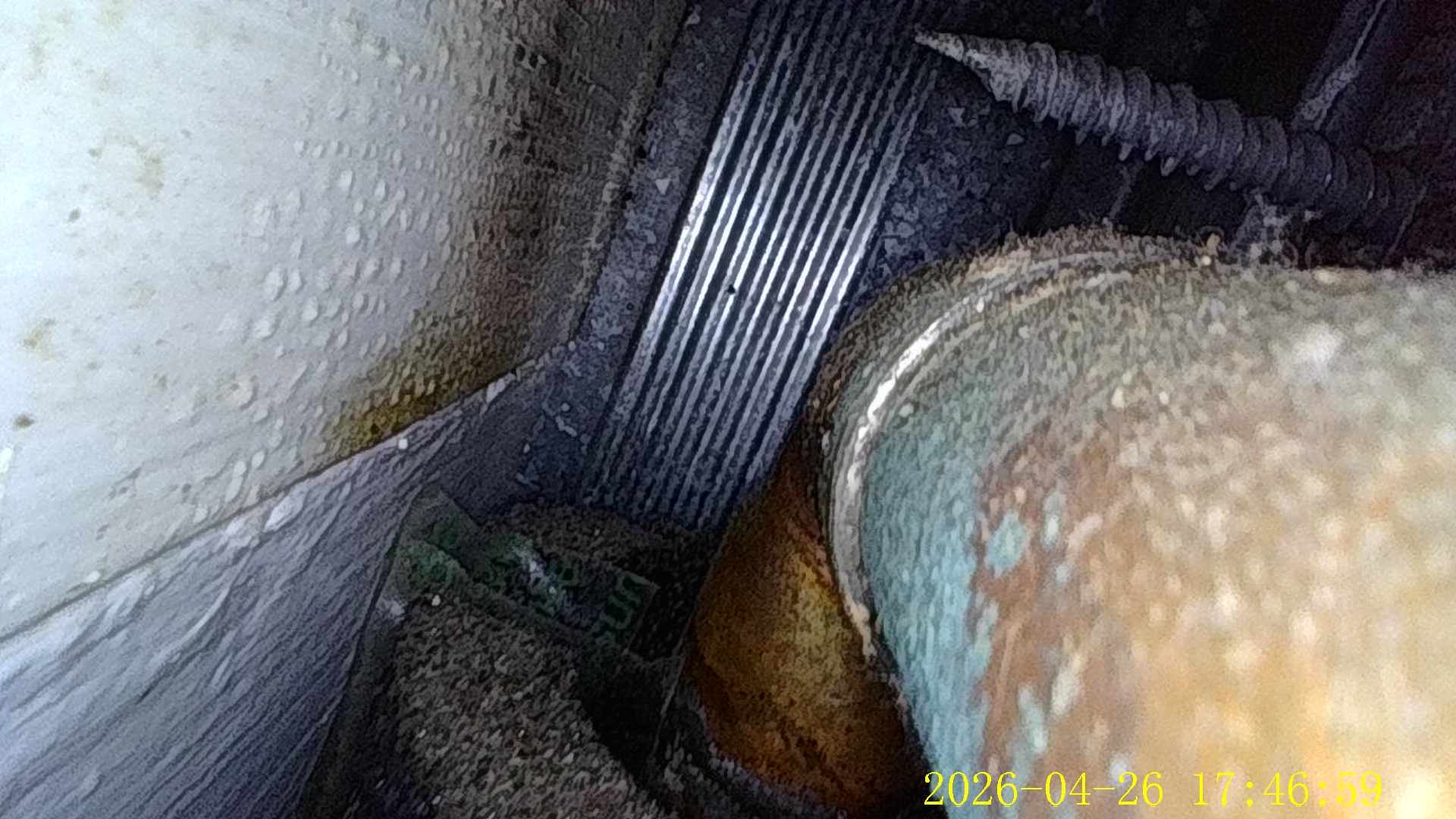

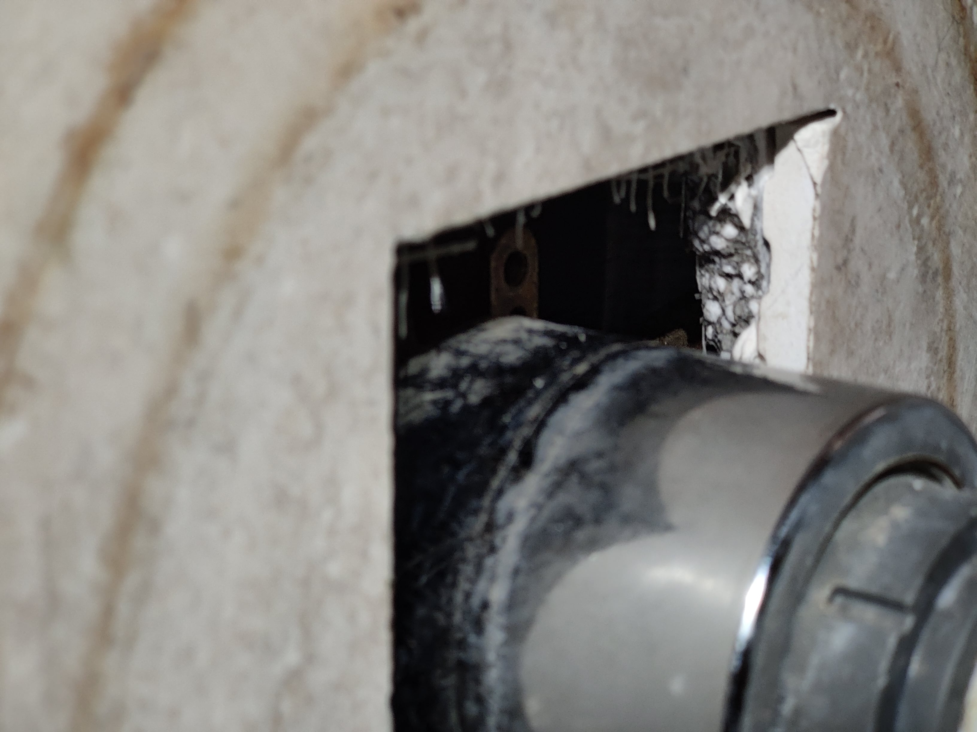

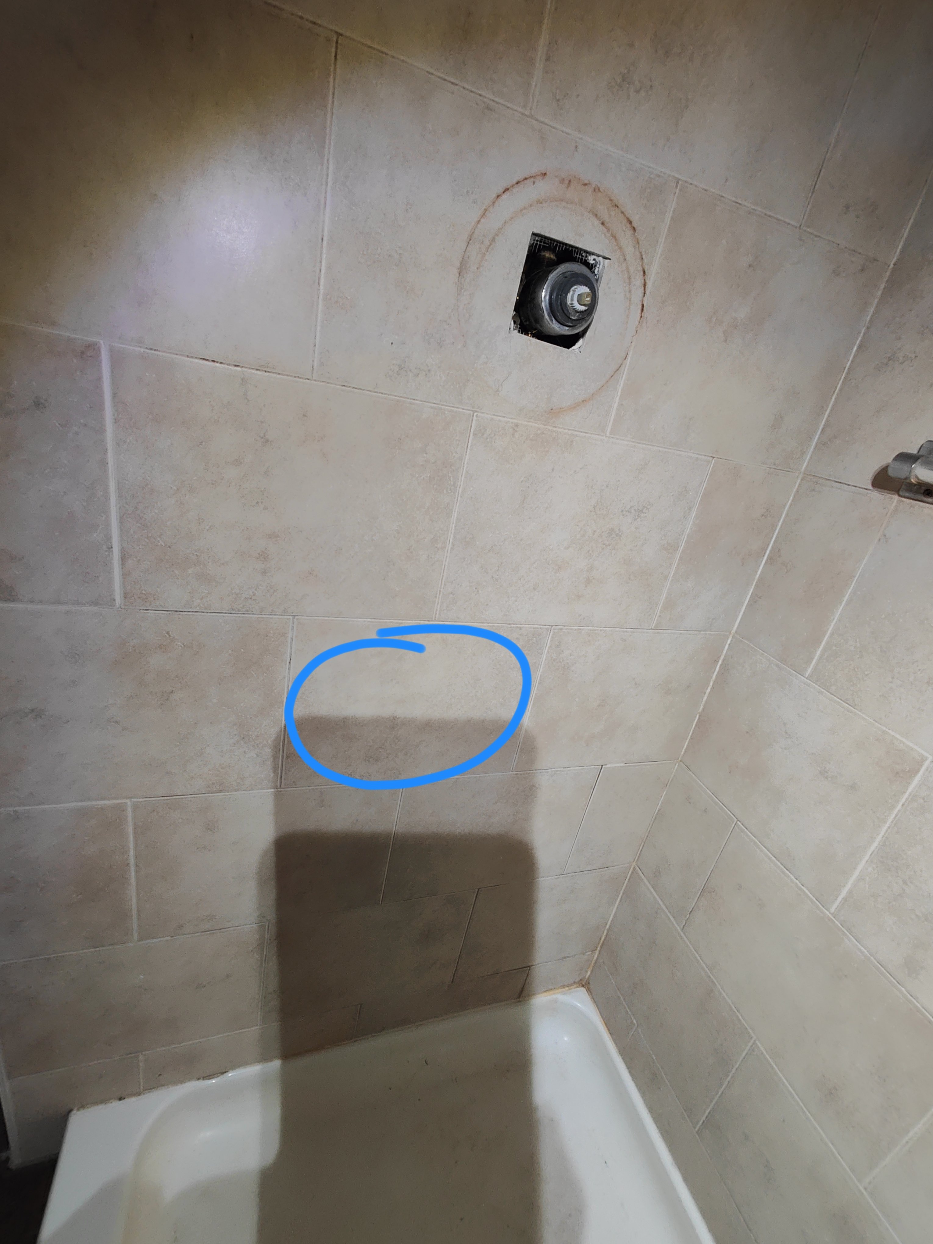

  • azward
    azward Posts: 129

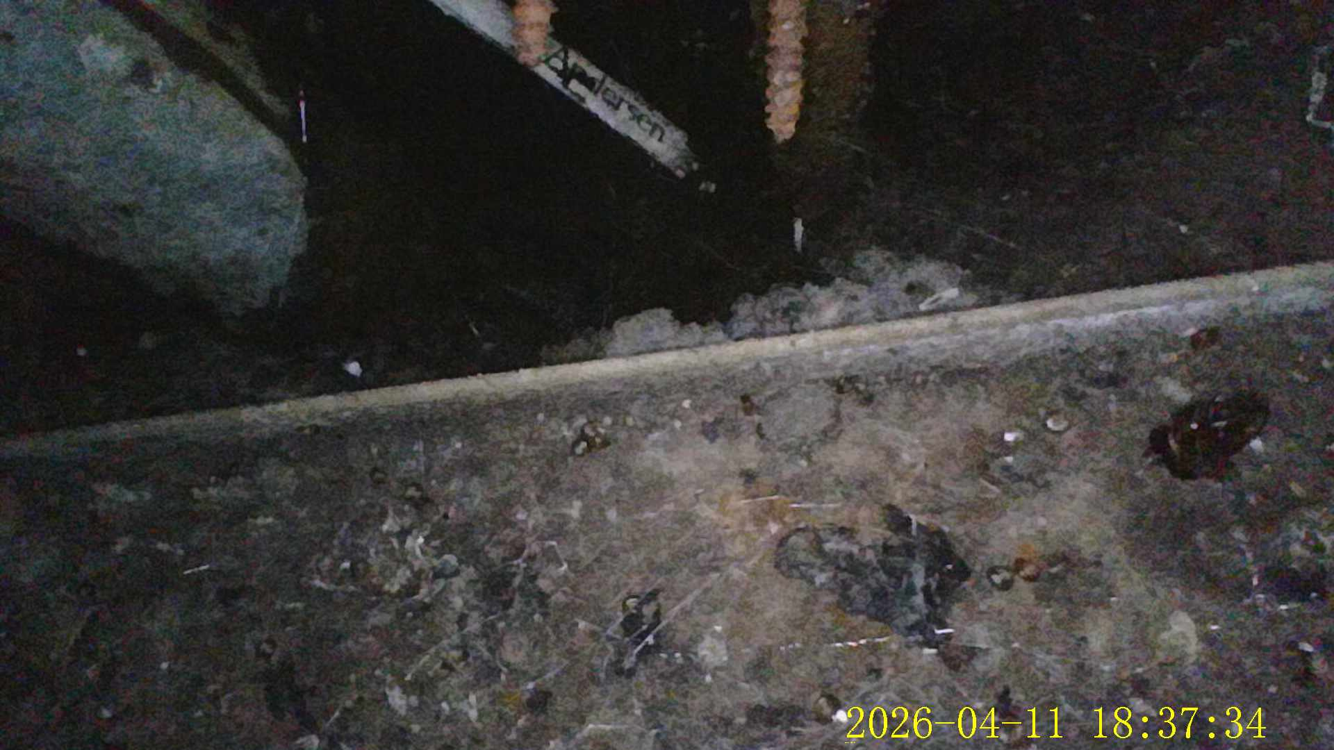

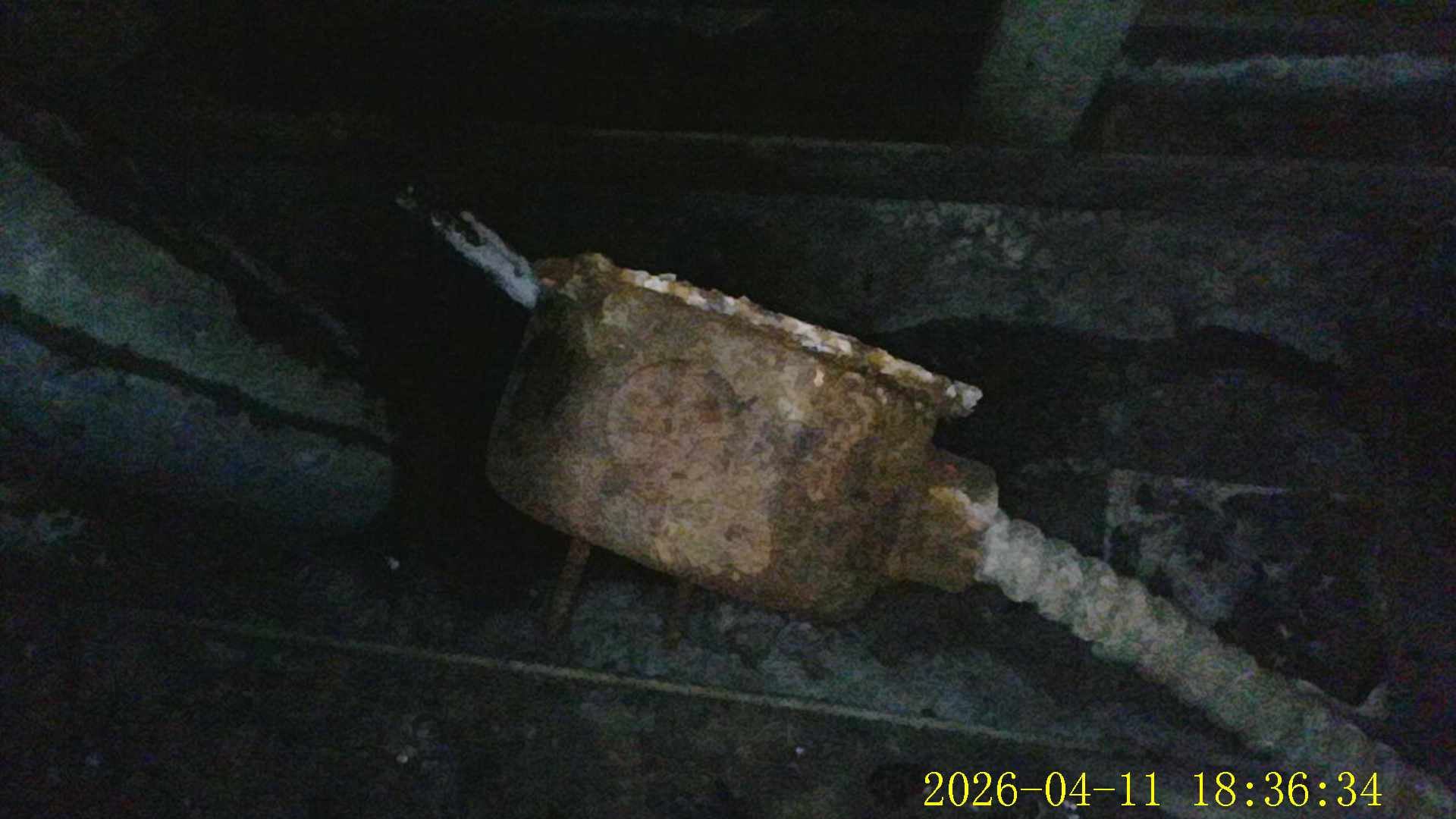

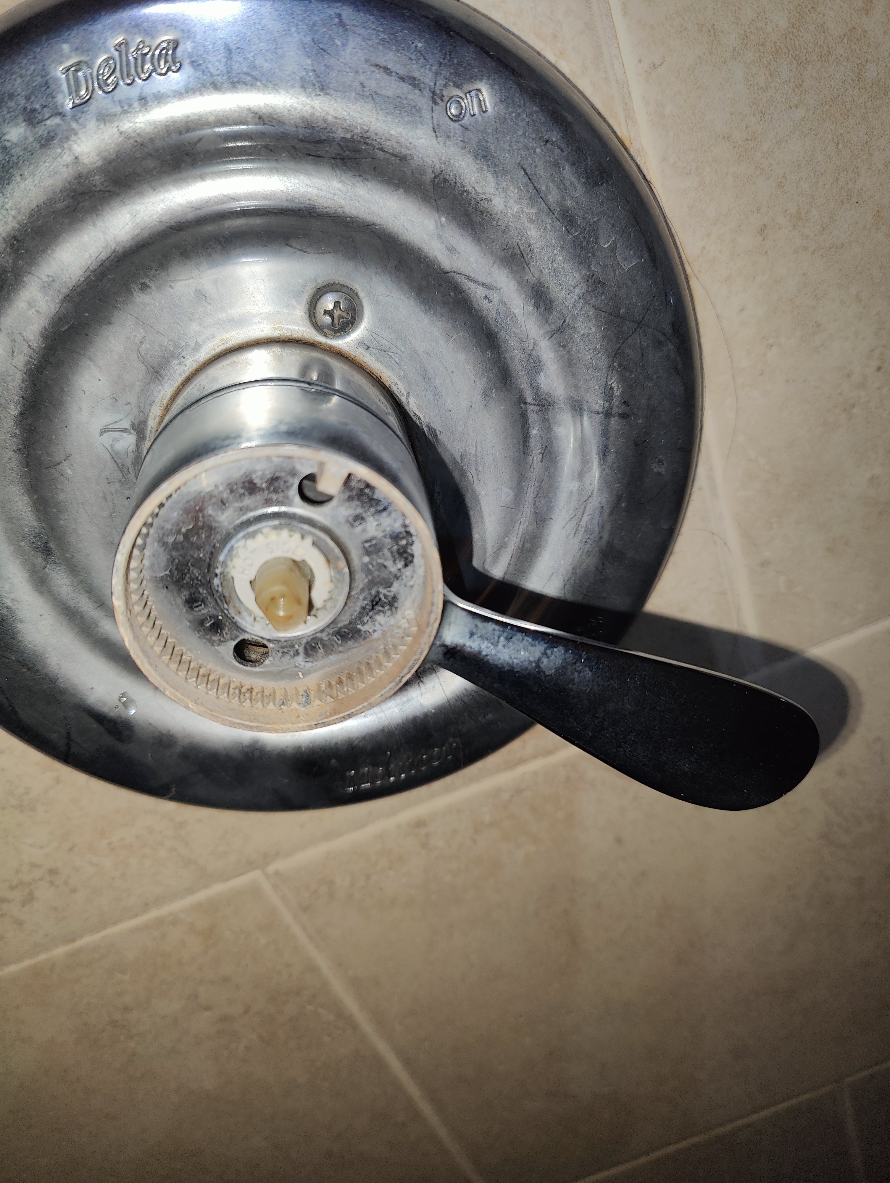

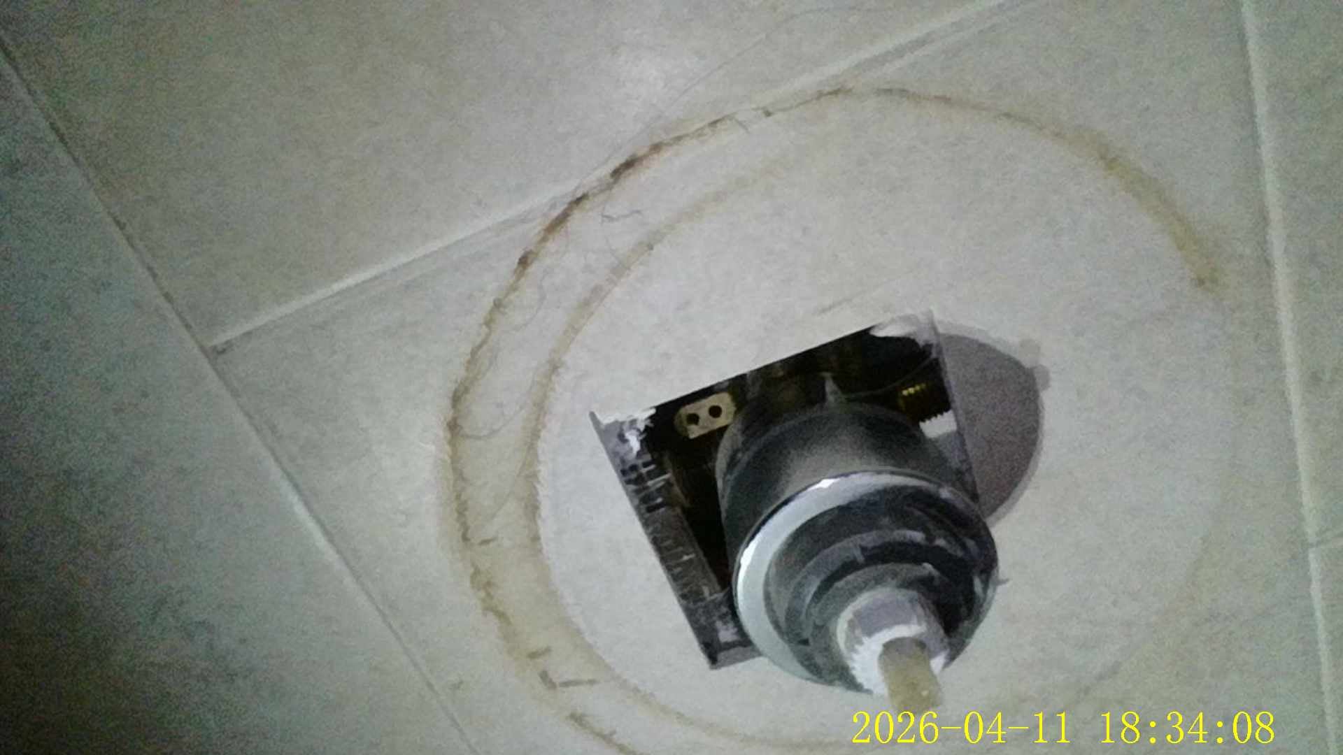

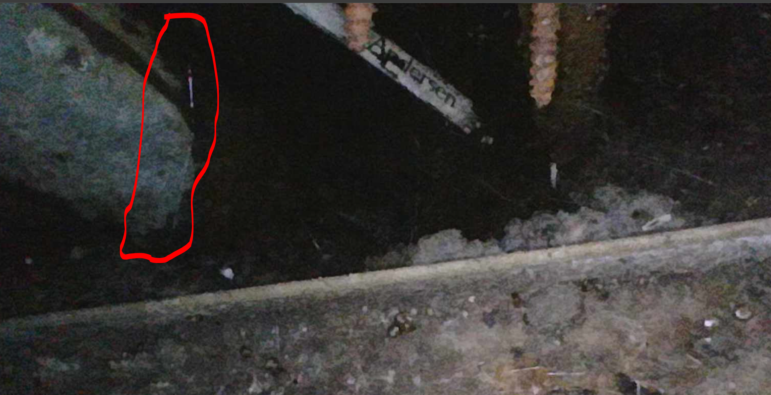

    now i would bet it's very likely the shower. the shower stall is to the right hand side of the toilet (facing toilet)
    this is a photo of the wall in the boiler room, right behind the shower area. it's constantly sweating. now connecting the two areas together, it's very likely the shower water supply tubing, or the drain pipe is leaking
    to crack things open, where should I start?
    Grallert
  • Grallert
    Grallert Posts: 1,237
    It's not uncommon for the shower valve to leak. Not sure what kind of valve you have but I'd check there first. It's the easiest to check and repair.
    Larry Weingarten
  • bburd
    bburd Posts: 1,338
    The leak could also be from a failed shower pan.
    Bburd
    the handles for the shower controls need to be sealed one way or another to keep water splashed on it from running inside the wall, either by the valve body being sealed to the tile or by the cover being sealed to the tile. a lot of less than competent installers miss this. it could also be failure of the shower pan or the tile.
