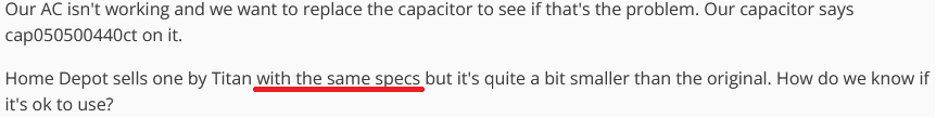

Our AC isn't working and we want to replace the capacitor to see if that's the problem. Our capacitor says cap050500440ct on it.
Home Depot sells one by Titan with the same specs but it's quite a bit smaller than the original. How do we know if it's ok to use?

    what is it doing that makes you think the capacitor is the problem?
    can you take a picture of the cap? that seems like a part number or date code rather than the value of the capacitor. there may be markings on several sides of the can.

    It has to match the microfarad rating and at least the voltage rating on the original capacitor. There are plenty of youtube videos showing you how to discharge and replace a capacitor. Maybe it will fix it, maybe it won't.

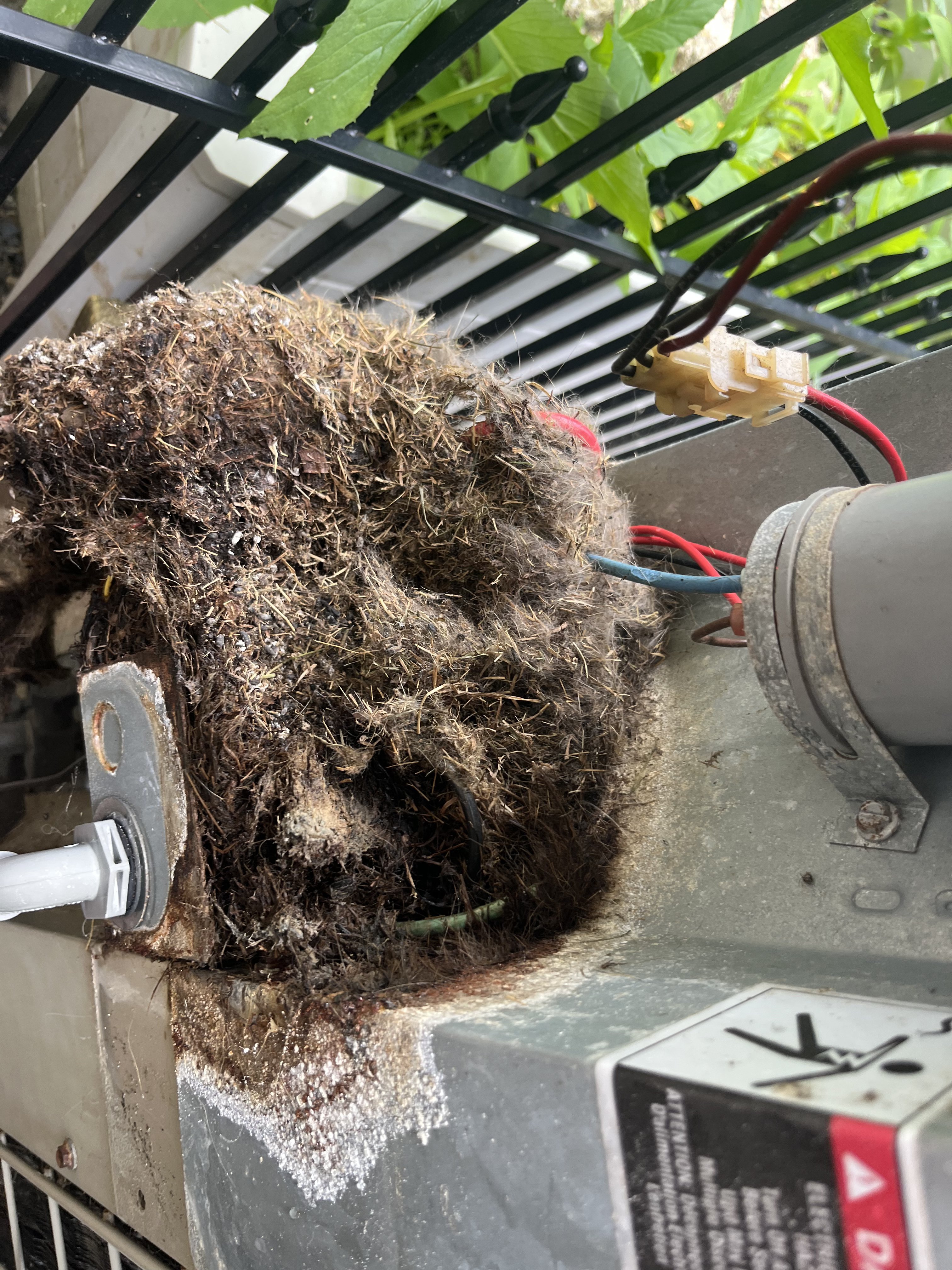

    My Neice's AC went down two weeks ago on a Sunday due to a mouse nest in the condenser. The cap was ok but chewed up wires and the contactor was disgusting.
    I remembered the hardware store which was only 5 miles away and I bought the last contactor they had

    Look on the old capacitor. You want to know the microfarad rating and the symbol for that is "UF"
    If the capacitor is wired to both the fan and compressor (most are) it will be a dual capacitor like 30/5 UF, 50/5 UF 45/5 UF etc
    Also the voltage rating may be 370 or 440 volts. If yours is rated 370 volts you can use either a 370 or 440 volt rated capacitor. If rated 440 it needs to be a 440 replacement/
    All you need is the voltage and the UF ratings. The capacitor may be smaller physically and that is ok.
    Make sure to shut the power off while changing and use a screwdriver to short across the capacitor wires before removing. Make sure the wires go back on the correct terminals. If the old cap is bulging at the top or leaking oil it is bad for sure.

    They crawled in through the wire openings. I didn't have anything with me so I told my brother to pick up some duct seal and plug the holes. I don't think they will like eating that.
    Unit has a leak probably in the condenser I had to add a little gas. Not a big leak but the first one its ever had its 31 years old and the condenser fins are starting to rot off and the furnace is the same age. I didn't have my leak detector with me.
    that looks like what a chipmunk did in my grill. it hopped up on my trash can then jumped on the back of the grill and in the vent slot at the back of the lid.
    EBEBRATT-Ed Posts: 21,328
    I couldn't believe how much stuff they dragged in there. That chunk of stuff was probably 6 x6x6. Disgusting. Wore gloves took everything out of the cabinet, cap, contactor etc and sprayed it with Lysol and then a garden hose

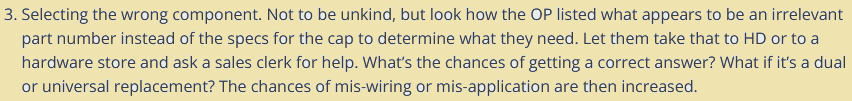

    While many homeowners may be capable of replacing a capacitor, and while in general I believe you should be allowed to work on what you own, I don’t think it’s a good practice for Home Depot to be selling capacitors.
    Here’s why:
    1. There’s the danger of electrical shock. Most homeowners don’t have a good electric meter or necessarily know how to use one to determine if the power is off. Quite often they think the power is off if the thermostat or furnace is off. I’ve frequently seen where the disconnect switch has been bypassed leaving the circuit hot. Many also don’t know about discharging the capacitor.
    2. The risk of damaging the equipment by mis-wiring because they don’t understand circuitry. It constantly gets posted in online forums of how to reconnect the wiring because they don’t understand terminal identification or circuitry. They also don’t understand that there’s a separate 24v circuit present and that wires that are the same color may not be the same.
    3. Selecting the wrong component. Not to be unkind, but look how the OP listed what appears to be an irrelevant part number instead of the specs for the cap to determine what they need. Let them take that to HD or to a hardware store and ask a sales clerk for help. What’s the chances of getting a correct answer? What if it’s a dual or universal replacement? The chances of mis-wiring or mis-application are then increased.
    On the other side of the coin, many HVAC contractors overcharge for replacing a capacitor, so I can see why a homeowner might want to attempt this.

    The OP posted the part number on the part, it seems to be a valid and correct part number to me. The OP also stated "with the same specs". The speculation that the part number was not a part number or otherwise useless was by a popular HH poster and that opinion seems erroneous to me, apparently zero due diligence, just opinion. Many things being replaced are done simply by the part number.
    Also going by the part number, maybe the manufacture updated the part to something different that provides better performance or longevity.
