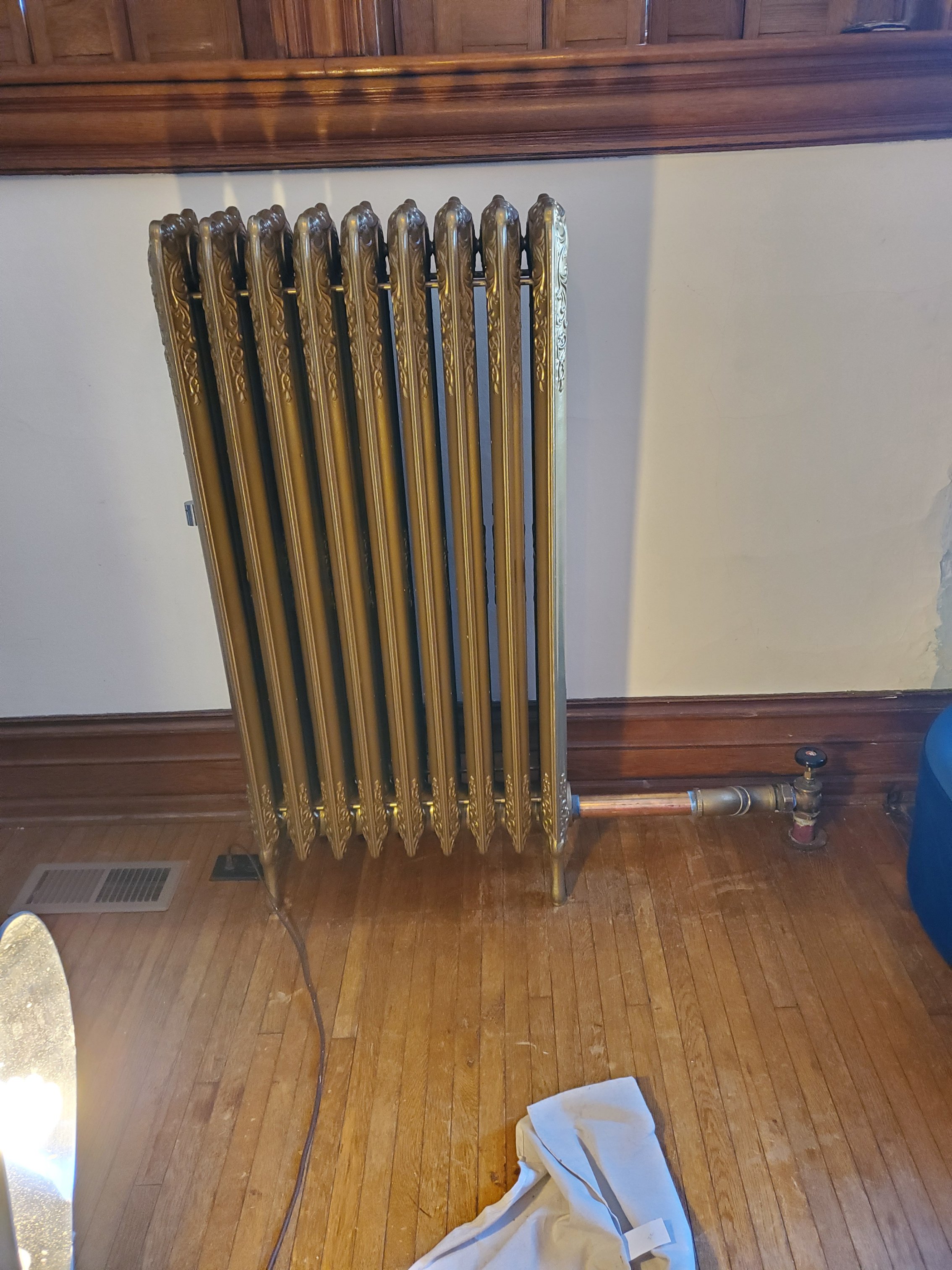

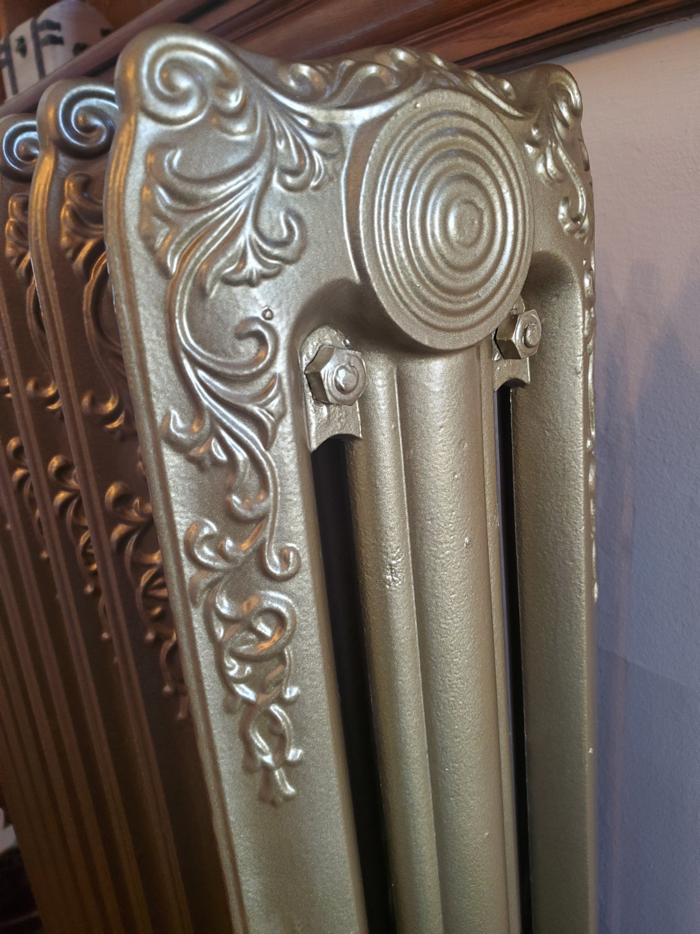

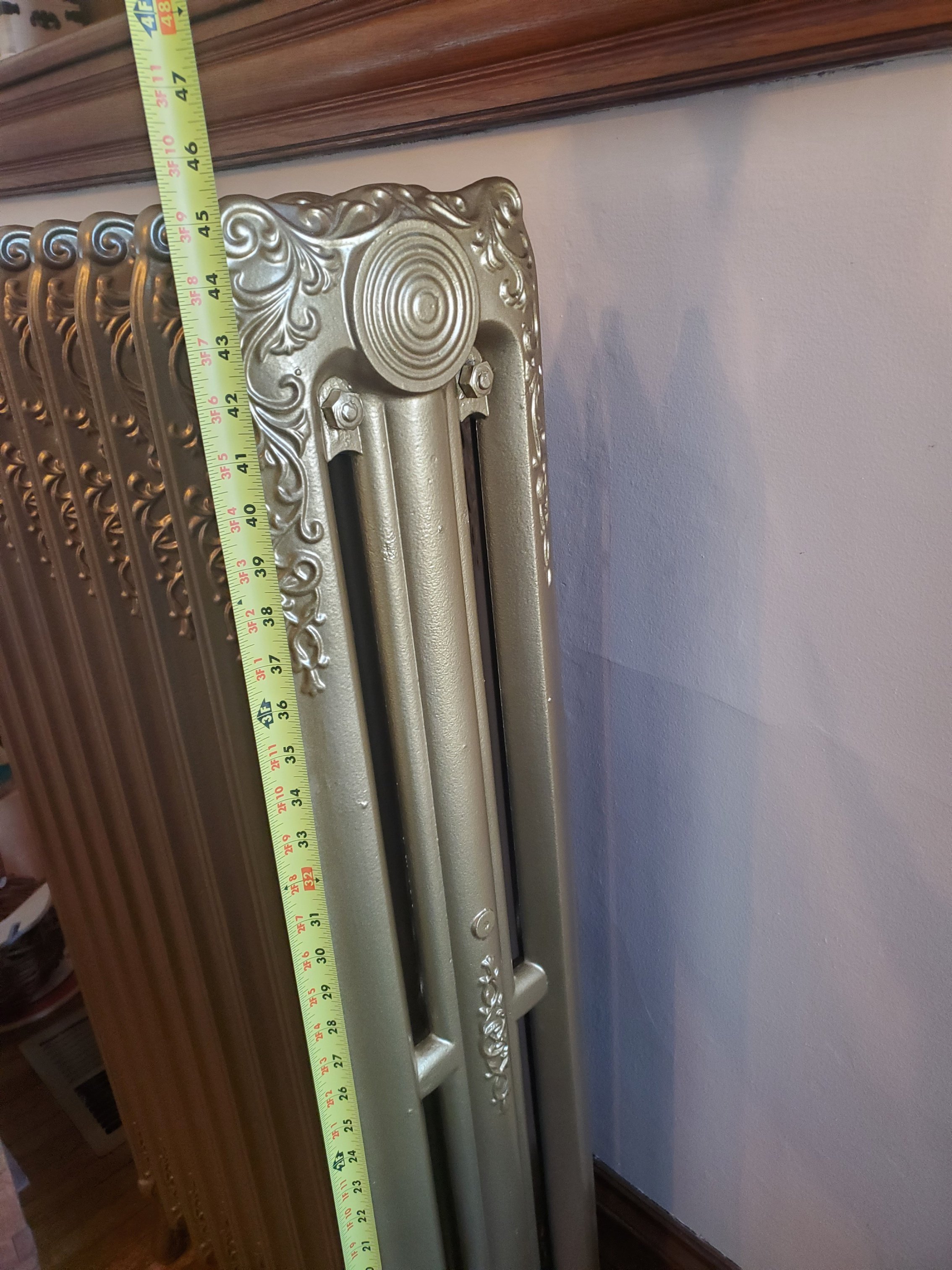

Re: Powdercoating steam radiators
My wife and I recently had a very tall(45 inch) Rococo radiator sandblasted and powder coated and we are very happy with the results. As stated above they are extremely heavy, so I would have 3 or 4 guys to help. This was a first floor radiator and only required going up/down 4 or 5 stairs.
