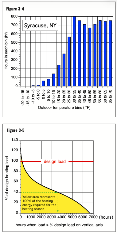

There must be a way to use AI to generate a BIN temperature for your location. Get an idea of low temperatures over the past 10 years or so.

Great idea hot_rod. Mod. con. + cast iron. C.I. would then last a "life-time" and always be on stand-by for mod. con. break-down/service/extreme cold.
