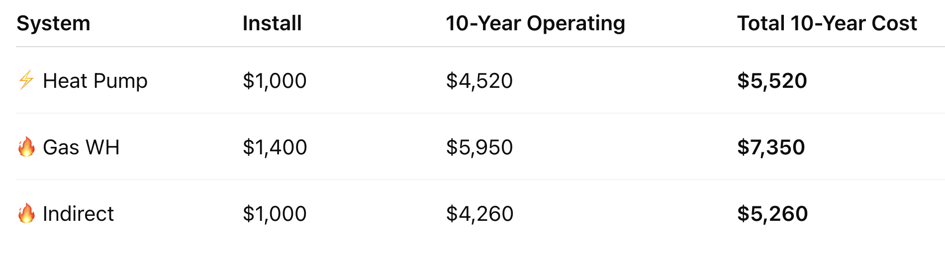

Re: Indirect vs Electric water heater
@Ghynes440 said: We are with PECO, so our kWh rate is $0.102 and our gas rate is $0.681 per CCF.
Those are not your total costs—that’s just the price of the fuel or energy. It does not include transmission, distribution (delivery), riders, fees, or taxes. when comparing to fuel delivered by truck to your home like Fuel oil you need to use the total cost because the fuel delivery per gallon includes the transportation and taxes and all the other fees, without itemization. That is how the utilities get you confused
If you look at your bill and divide the total amount charged by the kWh or CCF you actually used, you’ll find that you’re really paying about $0.21 per kWh (not $0.102) and about $1.75 per CCF (not $0.681). That may be why you’re not saving as much as you expected after replacing your oil boiler with a WM GV90+. It may be a bit more efficient, but not enough to justify the cost of the replacement.
Water under the bridge—now let’s look at the hot water situation with that $0.21/kWh electric rate and see if the indirect is a good idea.
Calculation to follow:
Since we can’t discuss pricing here, I have a national range from angi.com for three different water heaters: a heat pump water heater is $1,600 to $5,800, and I believe they are actually higher in your area. The federal tax credit of $2000 is gone for now and there is only a $350.00 rebate from PECO. Another option would be a standalone water heater that uses gas and is power vented, with an EF of 0.65, and that has a price range of about $400 higher than the HPWH after rebates. Then there is the indirect tank connected to your GV90+. Using an .65 EF for the power vent water heater and a COP of 3 for the HPWH and an AFUE of 91.0% for the boiler here is how crunching the numbers using what you really pay for electricity and gas, this is what I have come up with:
This chart does not account for energy cost inflation over ten years. It only uses the actual cost to produce hot water using three different heat sources: a GV90+ at 91.0% AFUE, a standalone power-vented water heater with an energy factor of 0.65, and a heat pump water heater with an average COP of 3.
The installed price will be higher and will depend on the water heater you select. There are more efficient standalone HPWH and gas power-vented water heaters available, so in most cases, the more you pay for the equipment, the lower your operating cost will be.
Other factors that are not considered:
- A HPWH operating in your basement will lower the basement temperature by as much as 3° while operating, averaging about a 0.6° impact over time. That may cause you to use a little more gas to heat your home, but not enough to actually measure.
- A standalone 120°F gas water heater is always connected to an exhaust vent that leads to the outside, even on the coldest days of the year. Imagine that temperature difference and the amount of heat that may be lost during standby (off) cycles.
- The indirect is not connected to a vent, but the boiler it relies on is connected to the exhaust system and may actually go cold to room temperature in the summer if there is no hot water use for several hours. so there is no standby loss up the chimney or out the vent when that happens.
I hope this helps.
Sorry Paul. Your HPWH is the better choice in your case because of the rebates and incentives, and the steam boiler can’t get anywhere close to 91% efficiency. You made the right choice for you—but it is not the right solution for everybody.
