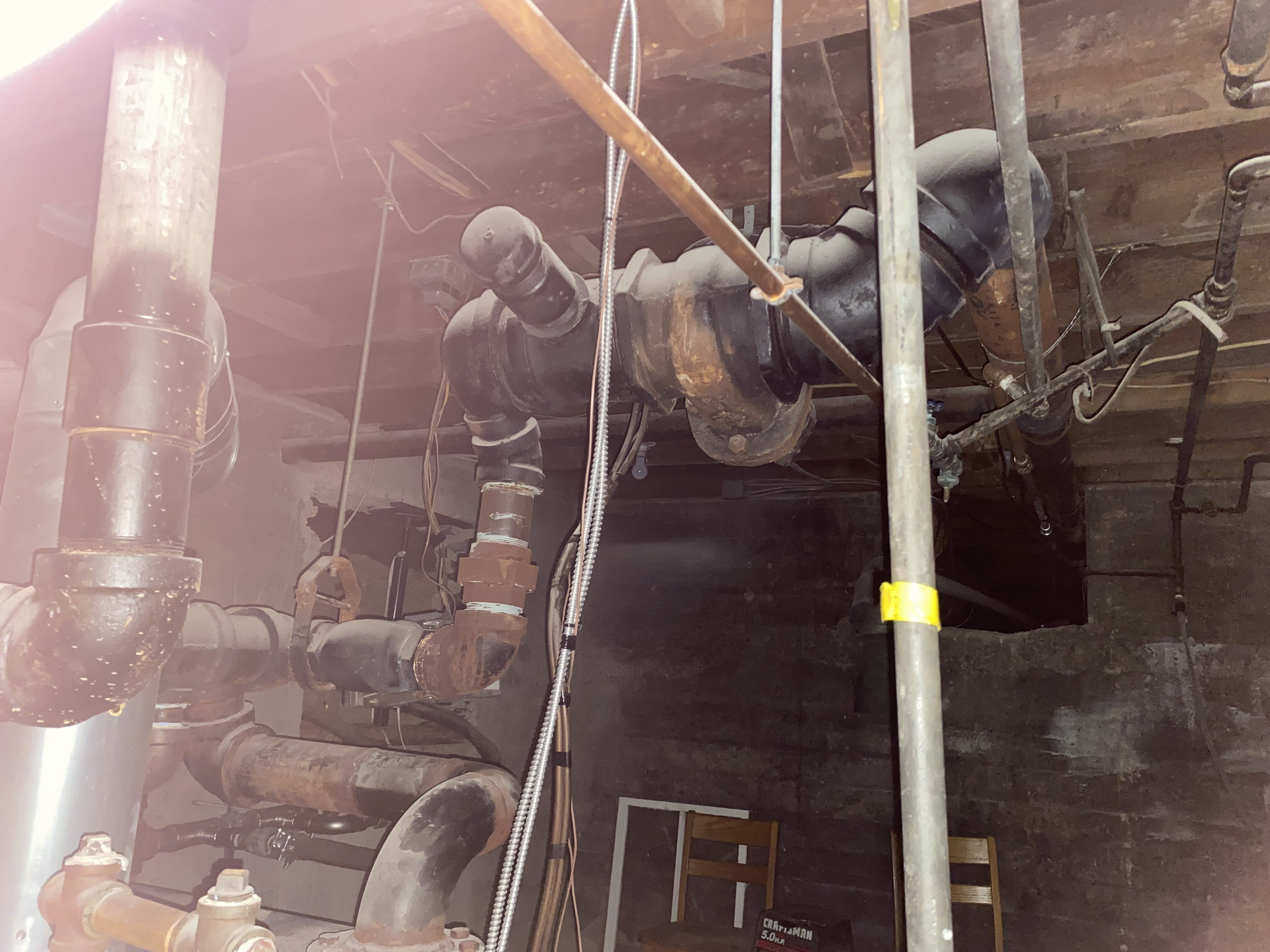

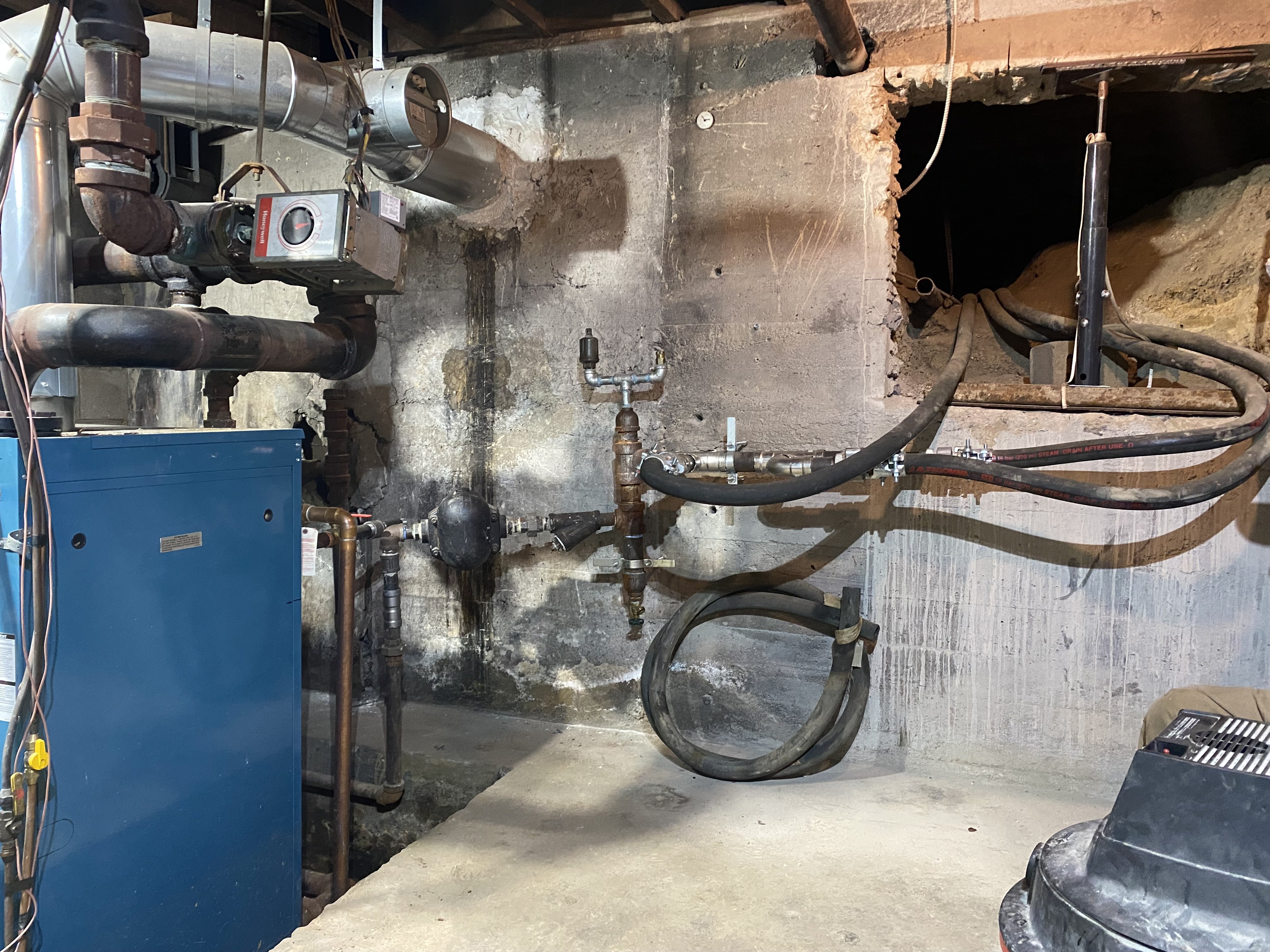

I was contacted by Scott (@karsthuntr) about evaluating the steam system in this church. It’s the oldest Presbyterian church in Virginia, founded in 1740.
The steam system was installed during a renovation in 1920. The current Burnham was installed about 8 years ago and it was a chop and drop by another contractor. It’s probably the third boiler since the system was added, the original being coal.
There are numerous issues and mistakes that have been made over the years. It’s a simple one pipe system.
Issue # 1. The boiler is severely oversized. The rating is for 2021 square feet, but the connected radiation is 882 square feet. Compounding that is the fact that it was split into two zones with the smaller one having less than 200 square feet. Some radiators have been removed and two large indirect rads have been disabled.
It appears that the system was split into two zones when the boiler that was previous to the this one was done. It was an attempt to heat the smaller office areas without heating the large auditorium. Again, less than 200 square feet of radiation.

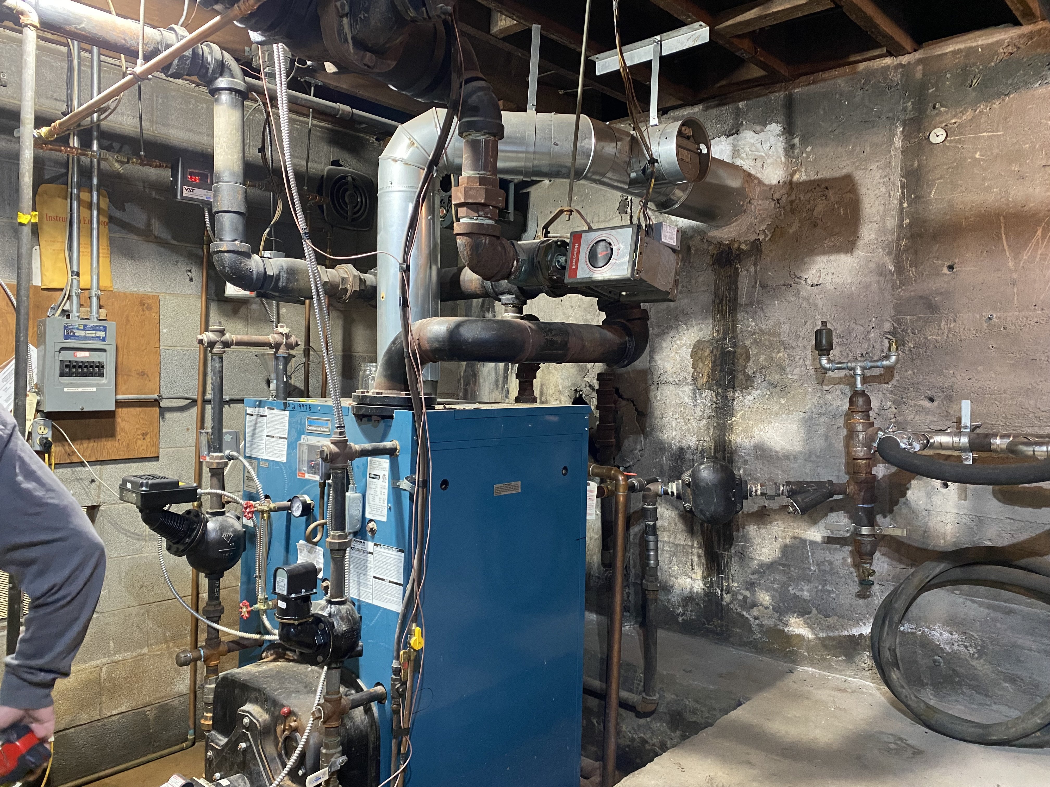

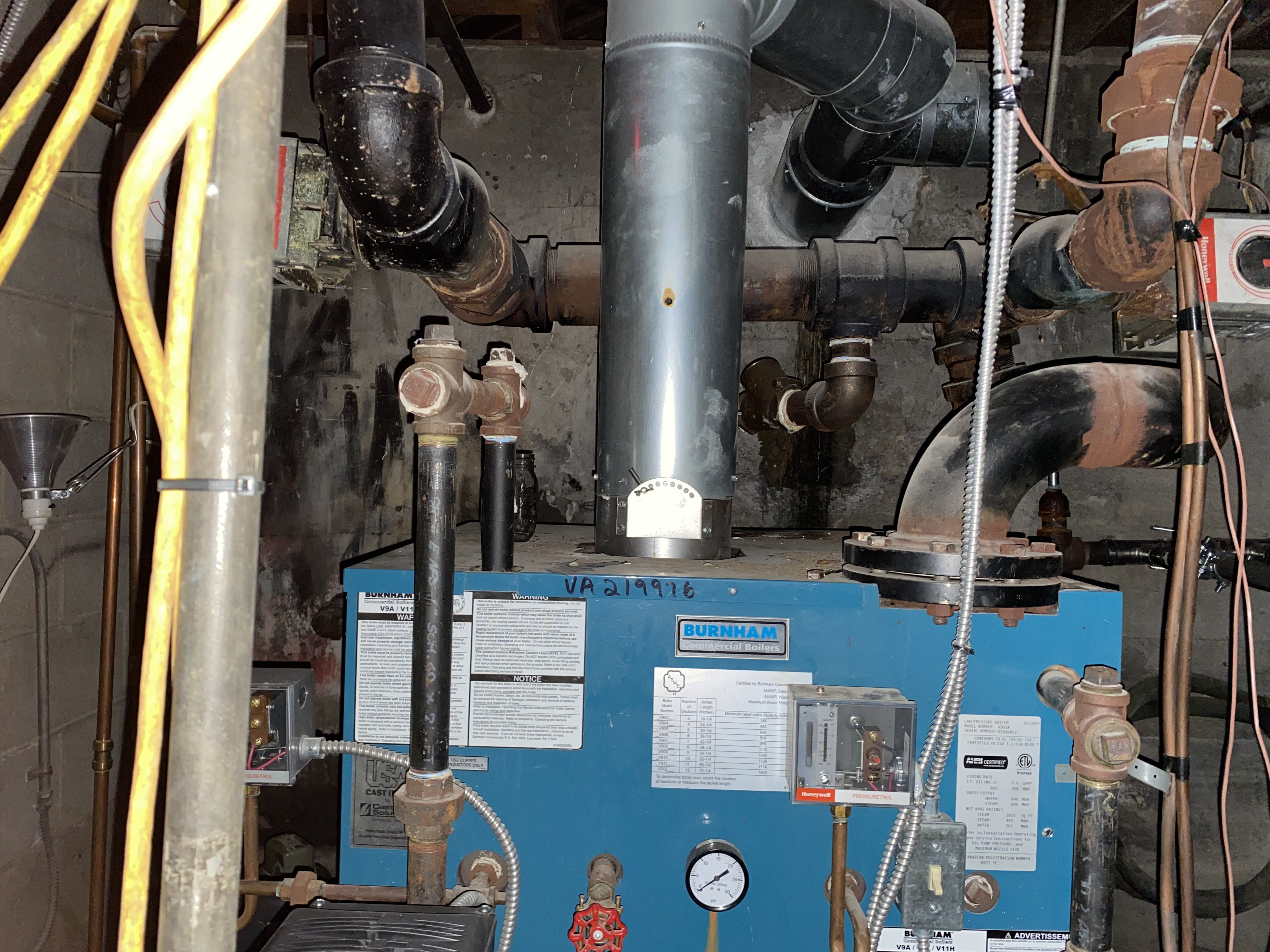

Issue #2. The near boiler piping is wrong.
As can be seen, the equalizer is tapped out of the middle of the header and only one riser (3”) is utilized coming from the boiler. The header is also trapping water at a low spot on the left due to the misplaced equalizer.
This last pic shows where the small zone was once tapped into the 6” main where it’s now capped.
Issue #3. The dry return piping.
Notice how the 2” return pipe in the opening has been recently replaced with three 1-1/4” flexible lines.
I’ve never seen anything like this done and I told the church that the lines had to be at the proper height with the proper pitch and no traps or sagging. They tried to straighten them, but I think that I’m gonna recommend doing it over with iron pipe. There’s also another return from the small zone behind the boiler. It’s still iron.

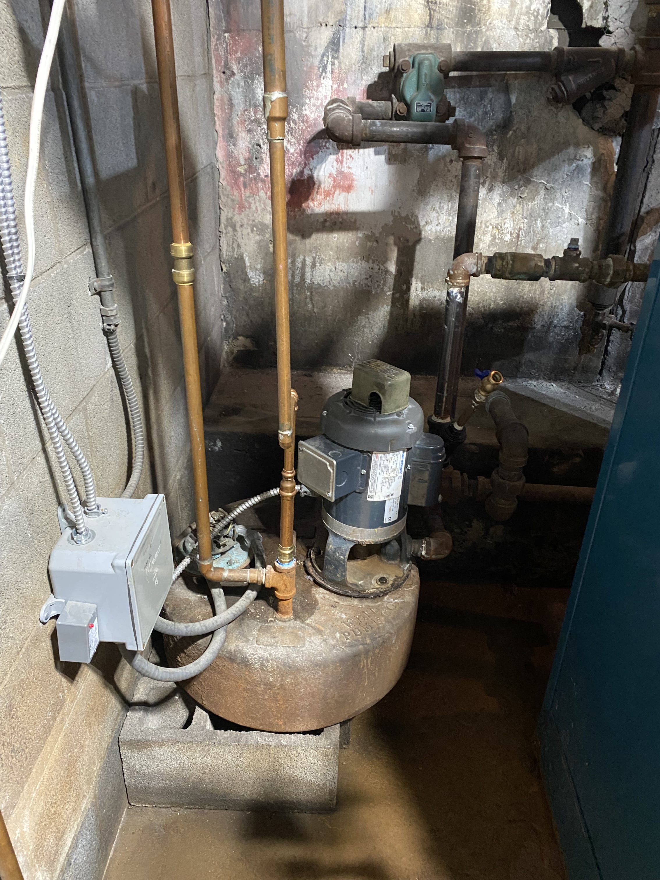

Issue #4. The condensate pump.
The boiler is currently not running because the pump is bad and not putting water back in the boiler. Someone recently replaced the motor, but the pump is bad.
The copper line on the left is the vent and the one one the right is the fill line connected to a VXT controlled by the LWCO. I’ve never seen that done before with a condensate pump.
This pump holds under 10 gallons and I’m questioning whether it’s needed. Please give me some input guys.
If it’s needed to hold excess condensate, it will get set back up as a feed pump. I believe it was added when the previous boiler was done and the system split into two zones.

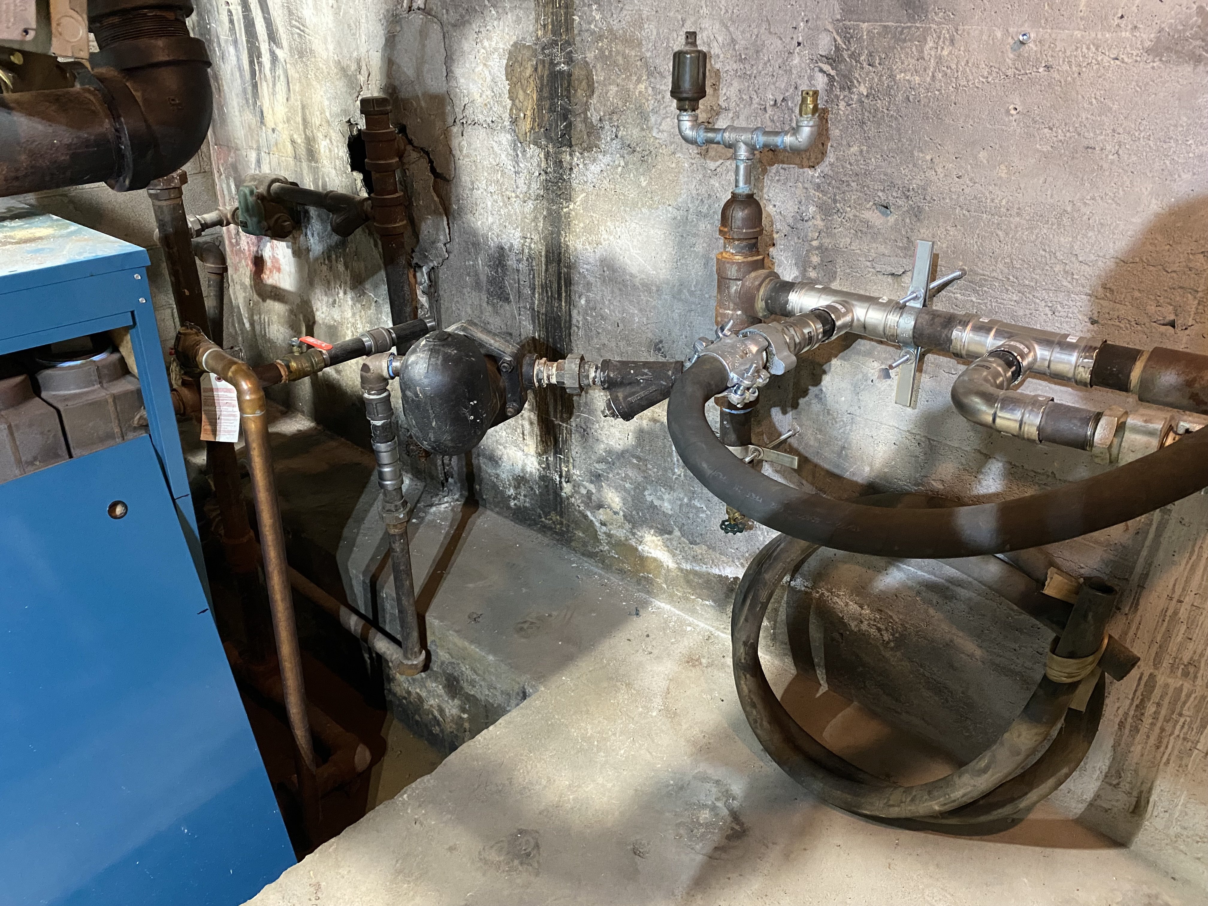

Issue #5. Traps and venting.
I believe the two return traps were also added when the system was split into two zones and therefore I see no need for them if the system is returned to one zone.

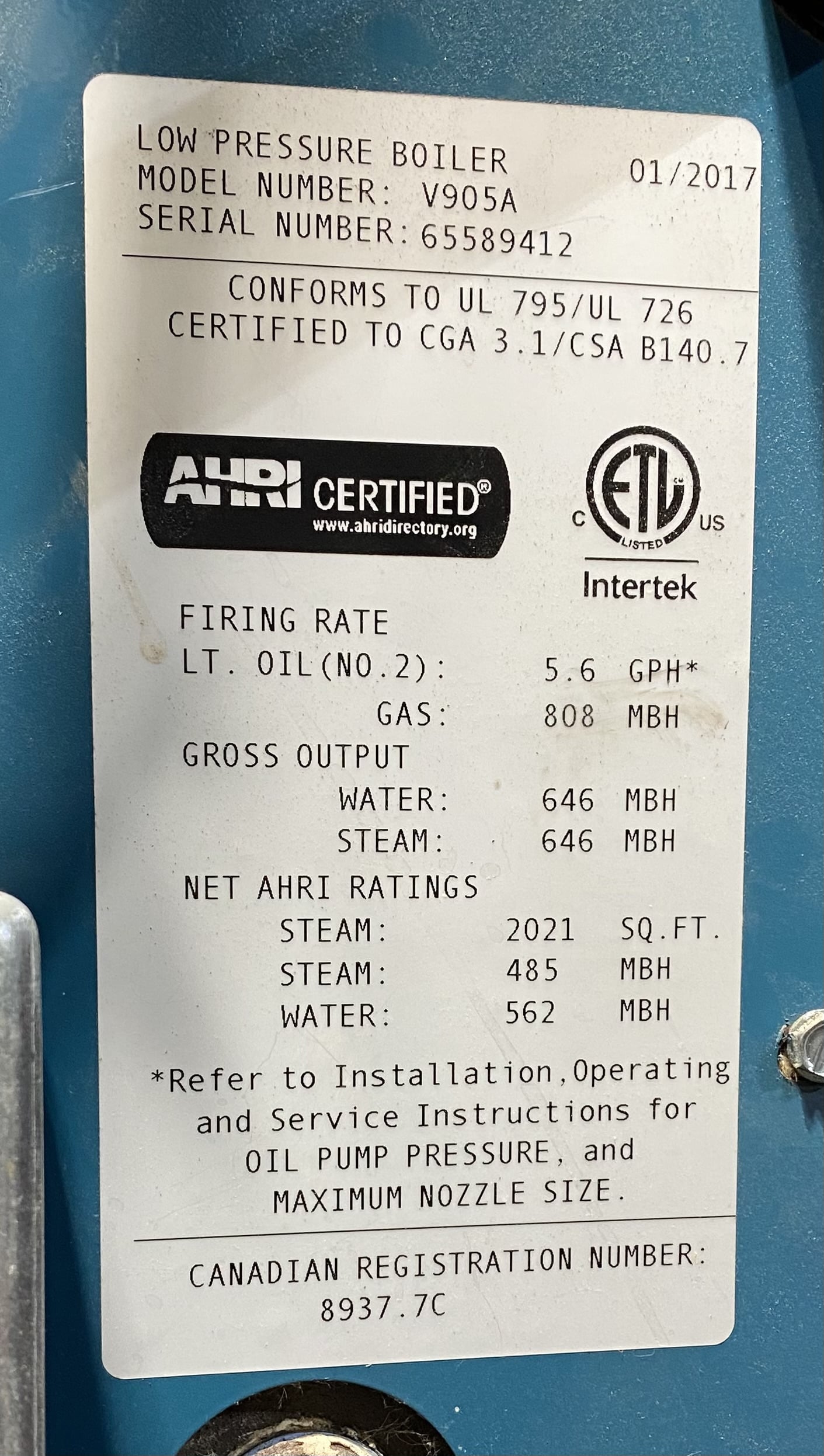

Issue #6. Firing rate
The rating tag calls for a 5.6 gph nozzle, but the burner has 3.0 gph nozzle. That’s within the burner’s range, but I doubt if Burnham would approve.
Professional advice and recommendations are welcome, please.

    one pipe and zoning usually don't get along with each other.
    calling that a "header" is very generous
    i bet the condensate pump does not need to exist
    2 boilers would probably work better and cost about the same as making the 2 zones work although how much less than 200 ft^2 is important here since the smallest steam boilers are around 250 ft^2

    i wonder if that condensate tank was their way of solving the water exiting the boiler because of that header. and possibly condensate stacking up behind the zone valve. if the motor died it almost certainly wasn't working right.

    I don’t care how many square feet of EDR are in the building… it is a church, and it needs a church-sized boiler. And zone valves are most important. It is a church, for God’s sake. Get it? God’s sake.
    But on a serious note, if you are confident about the actual EDR of the building and you can fit two very small boilers in there, that is probably the best way to do it properly. Just make sure there are no hidden rooms with hidden radiators. Remember, it is a church, after all.
    Perhaps you can sell the old boiler on a site like Heating Help, Craigslist, or eBay. It is not going to cover the cost of the replacement job, but it could help a little.
    A moving company, freight company, or rigging company may cost more than the boiler itself in order to make the sale practical. Still, there is probably someone out there who needs a boiler that size.

    Are you replacing the boiler or trying to make that one work? I am guessing the returns in the crawl space rotted out and they used hoses?
    The biggest headache is to decide what to do about zoning or not zoning. Until that question is solved you can't really decide anything else.
    I would suspect like all churches they don't want to keep the church that warm when unoccupied.
    Most steam systems with a boiler feed tank put the MU water into the feed tank and not the boiler. i guess that is what they were trying for but that little tank is hardly a feed tank.

    I heard from Beckett today and they said that the boiler could be down fired to 3.25 gph @ 140 psi = 3.85 gph, 539,000 btus. That’s still twice the size needed (265,000).
    I’m looking at removing this beast and installing a Megasteam MST892 which would be a precise match to the radiation and maybe less in cost than fixing this nightmare.

    is that boiler that is there now the manufacturer and series that kind of has a habit of developing premature holes in the hx above the water line?
    With the boiler being that much oversized you probably smart to change it out.
    If the run is not too long maybe a HW zone off the steamer would work for the offices. But if not much load electric you can't beat the simplicity and lack of needed maintenance.

    How does replacing the boiler fix the returns, or pump? What does the "evaluation of the system" mean. right now does it heat the building? Banging on Service days? What is the chief complaint to warrant replacement? Yes, I can see how botched the header is but easily fixable
    The riser and header looks to be 4" from photos with a pair of 3" (2 1/2"?)zone valves. Flange is 8 bolts -(3" is usually 4) bushing on small zone and reducing heal tee on main zone can be seen
    the boiler only calls for one riser 4" into a 4" barrel/header(w/ a 2" loop) this is actually a easy fix to repipe- has the boiler been working fine ? than run 3" to the existing 6" main and run 2" to the 3" main for your offices (200sq EDR)-
    if they are really happy using electric in the office - connect the riser/zone it as a back up into the new header with a manual valve (remove the zone valves)
    As far as sizing goes- over sized yeah,sure it is, but they lowered the input (nozzle) / don't forget to see how much bare steel in the crawlspace you have the bare 6" ,5" 4" adds up quick - quicker than your 1.33 pick up factor. Usually the friable was removed and not replaced with anything - Plenty of extra bare piping in every church we ever worked in - (not agreeing with the oversizing of the / a boiler,not sticking up for the replacing contractor) . In agreement with Edtheheaterman plenty of spaces in church where the pipes/rads/vents/traps are hidden !
    Give them steps to repair/revise - Step 1-pipe returns gravity- see if it works properly - Step 2 lose the hoses - etc,etc,etc Clearly replacing the 905 with a MST is not fixing the rest of the mess- header has to get fixed whether this one stays or goes- When the 905 rots out replace it with your boiler of choosing-

    I didn’t say that I was gonna give them an estimate solely to replace the boiler. Anything that I propose would include all the necessary corrections and repairs.
    The present boiler has already been down fired below what Becket recommended and the old masonry chimney was not re-lined when it was installed. So, it’s still firing at twice the size of the connected EDR with the piping pick up included.
    Since they’re gonna have to pay to re-line the chimney, it should be done to match a correctly sized boiler, not the beast that’s there now.
    I can get a MegaSteam with the factory piping kit for what it would cost just to do the near boiler steam piping that’s there now.
    I appreciate constructive suggestions, but your tone suggests you think that you know better than I what’s best for this job when you’ve only seen what’s posted here.
    I’ve been doing this for over 50 years. Please show a little respect.

    is the header kit going to help you, will it put the risers to the mains and the return and the vent where you need them or will you end up replacing most of it with different fittings and nipples anyhow?
    Looks like plenty of room to make it work and the smaller boiler will help.

    We’d still have to pipe up to the mains, but a couple of 3” lines would not be a big deal. Having to do a 4” header, which the present boiler would require, would be a lot more work.
    We’ve been down this exact same road before:
