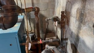

I have church I was working on. I replaced the 1960's Lennox oil burner with a new SF Beckett on a hot air furnace. While I was there the local big commercial contractor was there working on the steam system in the old part of the church. They were having problems with condensate return. They left and said it was working and 15 minutes later it was out again. I have read The Art of Steam Heating in the past and I know enough to not really mess with it.
My question is about the condensate pump and why its needed in this situation.

    A condensate pump or boiler feed pump is used if for some reason some issue (usually elevation) prevents the condensate from coming back to the boiler by gravity.
    Condensate pumps and boiler feed pumps are similar but different. A condensate pump is controlled by a float switch (like a toilet tank) that operates a switch to start the pump. When the condensate comes backit rises in the tank trips the float switch and the pump pumps the water into the boiler weather it needs the condensate or not.
    A boiler feed tank also collects condensate, but the pump responds to a pump control mounted on the boiler.
  • the condensate generally returns to the boiler by gravity but depending on design of returns and how high it is possible for them to be kept the condensate may not be high enough to put itself back in the boiler by gravity as each pound of pressure reflects roughly 28" of extra height for the gravity to overcome.
    if the return is carefully engineered and the boiler is run at what are considered vapor pressures, i.e., well under 1 PSI, it may be possible even on large systems to forego condensate pump but condensate pumps do the job with brute force in circumstances of low often 'wet' returns.
    that said, condensate pumps are generally pretty straightforward and resilient. it is some thing to go wrong and I avoid where possible but they shouldn't be too hard to keep serviceable. worst problems i've had is having to macguyver the receiving tank where the attachment points for the pump have rotted or corroded.
    this was a project that had a condensate pump which i believe was required because the previous boiler had a much higher water line but I expermentally bipassed the condensate receiver with one of the returns and running at vapor pressure the system had no problem operation without a return pump. I used clear polycarbonate tubing for the experiment so I could observe the process. What you notice is that the water in the return is higher than the water in the boiler by about the number of inches reflecting by the operating pressure. it is hard to gauge from those pictures because they don't have very much resolution the way they were posted whether there might be any opportunity for eliminating the condensate pump. on a guess this is an updated boiler perhaps shorter and having a lower waterline than the original but that is just a guess.

    Al that's very fine — but the first thing to do is to see if the pump and receiver are operating as a boiler feed tank and pump, or a condensate tank and pump! The two often look exactly alike — except they are controlled differently.
    The thing is, a condensate tank setup can, and frequently will, flood the boiler with unhappy results. The boiler feed tank arrangement, on the other hand, won't unless the boiler level switch malfunctions — which is rare. It does have to have an overflow to drain, however…
    So that's step one. Which is it?

    I have a feeling that the "old part of the church" may have had a large water content, hand fired, coal boiler some time ago. It may have been converted with an oil burner, and now there is a more modern boiler that you have pictured. The reason for the condensate pump or boiler feed pump is because the old boiler had a much larger water content than the newer boiler that is there now. As a result of the difference in size (not BTU size but water capacity size) there may be more water in the system than the newer boiler can accommodate as a result of the change.
    This may have caused the new boiler to flood when the larger amount of condensate finally returned to the boiler. The fix is a boiler feed pump with a tank that can hold the extra water until the boiler feed control needed more water. The tank would supply the water rather than adding fresh water from the cold water feeder. That keeps the smaller water content boiler from flooding because the extra water is stored in the tank until needed.

    Okay that makes a lot of sense. Of it has an electronic water feed control. I think what is happening is the condensate is not coming back fast enough and the water feed doesn't feed enough water so it trips off on low water.
    It is a small condensate pump you can see it on the left of the boiler. I wonder if a bigger condensate pump that holds more water would be a fix.

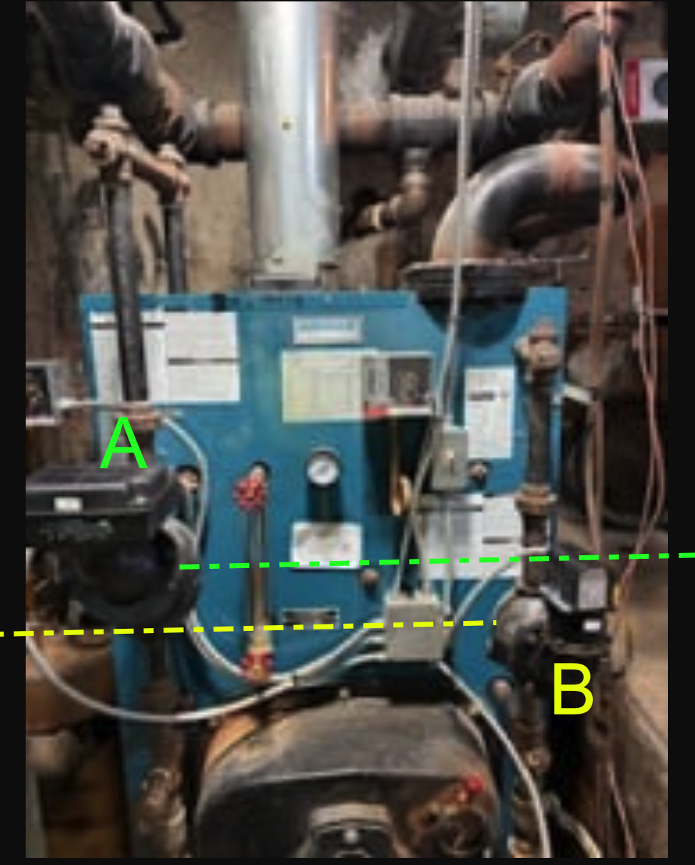

    Looking at this photo there is a control to operate the feed pump on the left and another control on the right to add cold water if the feed pump can't keep up. The fresh water feed control should be about an inch lower than the boiler feed control. They are both low water cut off devices so it is tough to tell what the problem is without looking at how they are wired.
    As a rule a boiler feed pump usually has a larger water tank. A condensate pump has the smaller tank and the church's boiler seems to have the condensate return size tank. As the system gets older and pipes get filled with mud and rust from years of operation, the condensate may not be returning as fast as it used to. The correct fix is to clean all the dirty wet return lines.
    If you think you want to get involved, you really need to read up on the equipment and how it should be wired and how the condensate is actually returning to the boiler.  Is it by way of the float in the tank turning on the pump or by way of the switch on the front of the boiler inside the control on the left?

    In this photo there are two McDonnell LWCO devices. the one on the left (A) looks like a M&M 150.
    There are 2 switches in the control. One is a normally closed (NC) switch that can be used as a LWCO.  The other switch is normally open (NO) switch and can be used to turn on a boiler feed pump, or activate a solenoid valve to add cold feed water.  The switches are different from each other and can be adjusted to operate at different water levels so the water can be fed to the boiler while the burner is still running.  Only if the water level drops further will the second switch open to cut off the burner.
    The other control (B) appears to be a 51 series mechanical water feeder that is equipped with a No. 2 switch.  (Often called a 51-2) the main purpose is to mechanically add cold water to the boiler when the float drops to a point where the boiler can accept more water. Much like the float valve on a toilet tank. That can operate similarly to the 150 because the valve can start to open before the No. 2 switch can shut off the burner.
    The fact that the two devices are more than 1 inch apart vertically tells me that they cannot function together as intended—one as a low-water cutoff (LWCO) and the other as a feeder that restores water so the burner can restart.
    If the Model 150 shuts down the burner, the water level may stop dropping. If it never drops any further and the condensate return pump has no water to return to the boiler, the pump could end up running dry—which is not good for the pump. At the same time, because the water level is no longer falling, it may never reach the point where the Model 51-2 adds water. As a result, the water level would not rise enough for the Model 150 to allow the burner to restart.
