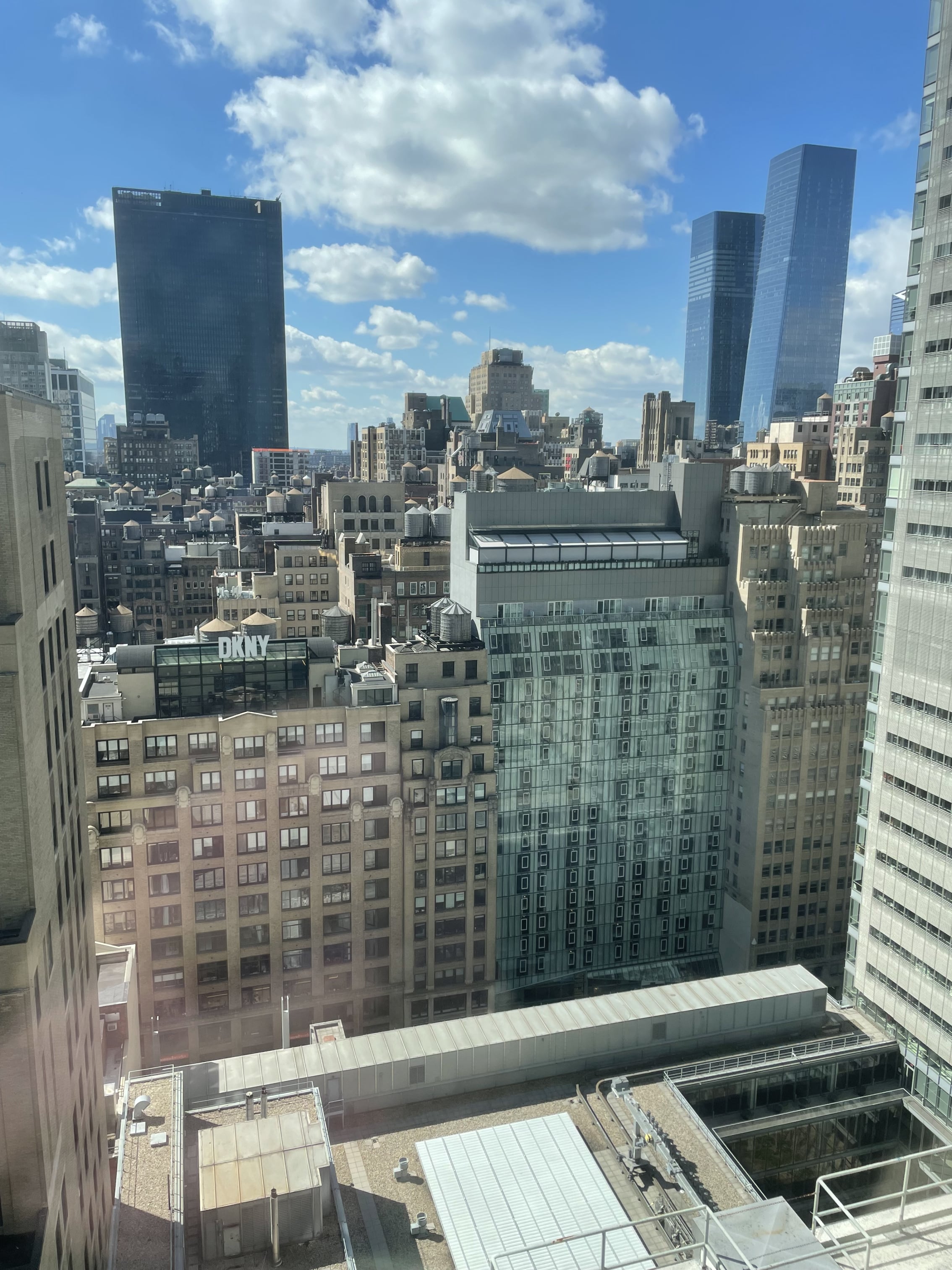

    If you can zoom in you will see so many. Its unbelieveable

    pedmec Posts: 1,488
    I took that from my room window at the Hilton in times square. St Patricks day 2024
