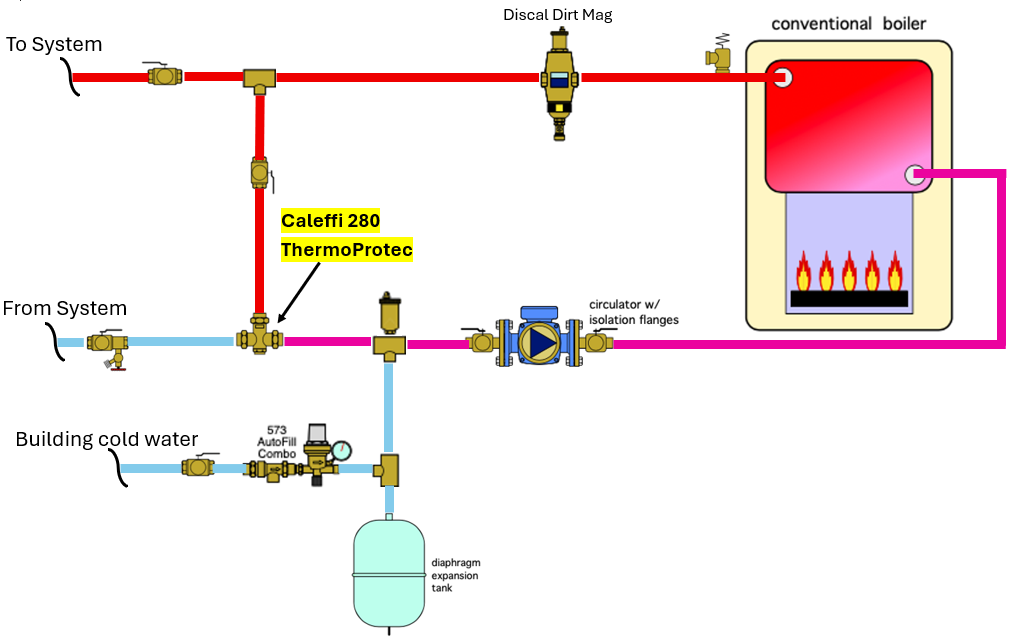

Where and how would you connect the 280 series mixing valve in the diagram below? It’s a single zone system, so the circulator will (hopefully) be to the left of the expansion tank, pumping away.I’m just looking for a simple way to communicate what I want, and make sure that it doesn’t get installed on the water heater instead!
the 007 may not be the right circulator for that application. the gravity system will be low head but you may need more flow than the 007 provides(i don't know but someone needs to do the math or you will have a bad time). the 007 is probably fine for that boiler in to baseboard in a series loop or zoned but it might not have the volume for a high volume system at least as a direct piped system vs primary secondary with 2 circulators.
the pump sizes by the the gpm and the head, flow resistance of the circuit
The gpm tells the amount of heating btu you can move. A a common 20 delta, temperature drop around the circuit the math is simple.
To move 120,000 you need 12 gpm
The large piping will not present much flow resistance, nor will a three way valve
Estimate 4’ of head, so an 007 would move 12 gpm, 120,000 btu/ hr
choice for high flow low head applications, if you need more than 12 gpm or so.
The amount of water, the volume does not effect the pump selection.
if you place 3 shut off ball valves like this, you can isolate the pump and 280 valve for easy service. A purge valve before the bottom left shut off
Expansion tank and fill valve before the pump.The pump pulling away from the mix valve, pumping into the boiler
Air purger at boiler supply connection.

this diagram is perfect, thank you.
I feel like telling them that I want a 280 series valve, and it should be piped like so is about as simple as I can make it.
I think telling them what size pump to put in is probably crossing the (imaginary) line for me as a customer doing what should be their job (ignoring the part where I provided the spec for boiler protection). Idk. Honestly that would be approaching the point of just having them deliver the thing, hook up the gas, connect the vent to the chimney, and then let me do the near boiler piping myself and have them comeback for commissioning and combustion testing when I’m done.Also, telling my wife that I’m gonna do it myself might also lead to my inevitable death (“I don’t know what happened, a random brick fell off the house and killed him”). My wife reads a lotta murder mysteries so I gotta stay on my toes.

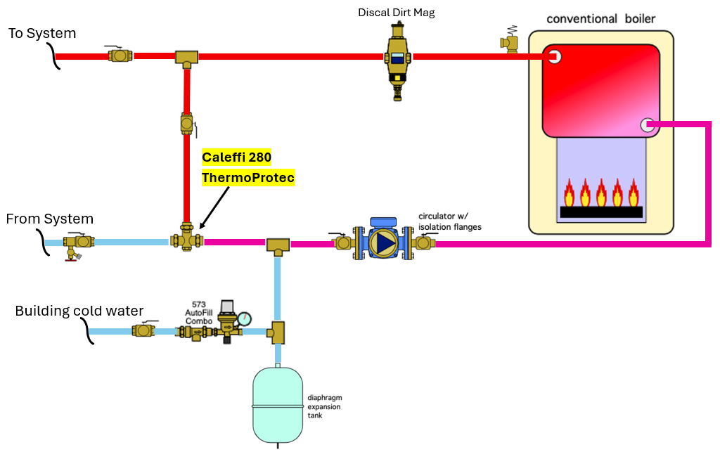

This is basically just a fancier version of Hot Rod's sketch above, but can you guys look at this and tell me I if I screwed anything up?
that works, you have good isolation, dirt and air separation.
I would delete the air vent above the expansion tank
The valve on the blue from system line needs to flip so the purge port is on the left of the ball., or use a Webstone version that can purge two directions

Boom
Now, can someone remind me why I recall there being a recommendation to put the circulator on the supply side of the boiler (pumping away from the expansion tank)?
pumping away from the boiler, expansion tank, and air separator
away from the expansion tank so the pressure the pump is producing goes to moving water through the system, not pushing water in to the expansion tank. if you pump in to the expansion tank it can accommodate less expansion because you are forcing more water in to the tank with the higher pressure on the discharge of the pump. on a cast iron boiler and converted gravity system where there isn't much resistance to flow this matters less but it is best to not find out your system is the exception.
away from the air separator so that the air separator is at the lowest pressure and on the outlet of the boiler so the water at the air separator is at the hottest point in the system. less air dissolves in hotter water and less air dissolves in lower pressure water so it encourages the air to come out of solution at the air separator.
The circulator should pump away from the expansion tank so it adds it's pressure differential to the system.
It does not need to be on the supply side of the boiler. In fact some high head mod cons prefer you pump into the boiler.
The air purger works best at the supply, the hottest water in the system.
But the expansion tank does not need to be below the purger either, as you show.w
it is also preferred to pump away from a 3 way mix valve, so it pulls the hot and cold through the valve.
The red and blue water to get to purple :)
It will work great as shown
The pump does not push water into the expansion tank! Where would that water come from? There would be less water somewhere in the piping if the pump was to push water into the tank.
The expansion tank connection into the system establishes the PONPC point of no pressure change, the pump cannot effect that.
Water enters an expansion tank from the expansion of the water as it is heats, volume increases, or comes out as the water cools.
