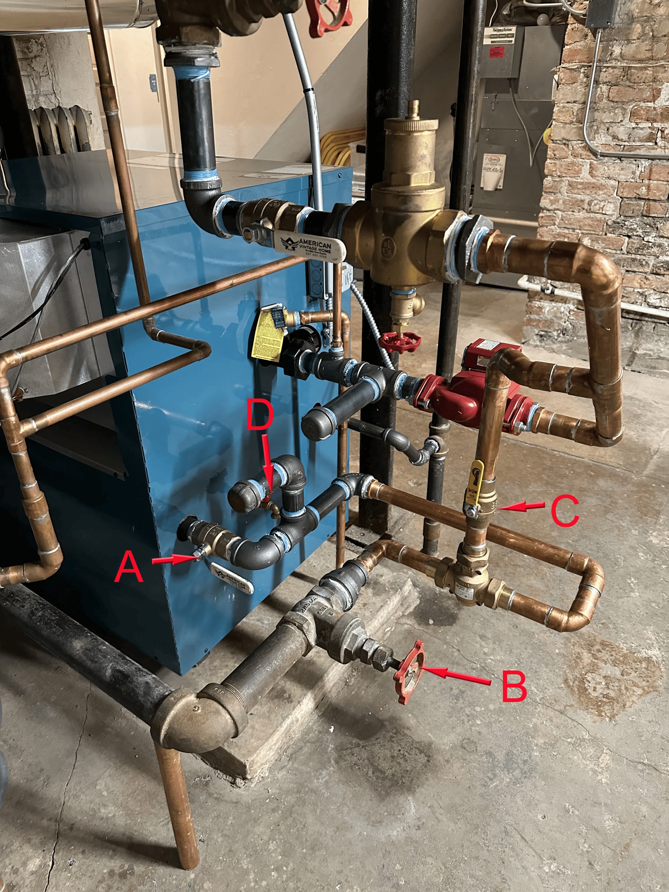

thanks for the suggestion, @EricPeterson. Is a full purge the only foolproof way to do this? How else can I tell if I’ve still got air if none of the radiators bleed air anymore? It’s possible I overstated how much air there is now - I just visited every radiator in the house and got water at first turn on each one.
The reason why a better circulator strategy is on my mind is that after the system has been running a while, and the valve is getting closer to fully open to the return side, I am getting heat to some of the previously cold and more distant radiators. The only difference in my mind between operation early in the cycle and late in the cycle is how much boiler output is a going going to the radiators, since the supply temp is fairly warm (140F or more) after only a few minutes. Early on when return temps are low, I estimate 50% or less of the boiler output is going to the radiators (just based on the various delta Ts and knowledge of the boiler output). After an hour or two it seems to be closer to 75-80%. A bigger circulator would guarantee that I got hot water to more radiators faster, right?
The problem with a bigger circulator is that you'll get even higher velocity through the bypass at startup, which can cause noise and/or pipe erosion. The best solution may be re-piping for primary/secondary. We have two WGO-5 boilers heating two separate gravity conversion systems in our old 4-unit condo building, and I'm planning to re-pipe them primary/secondary through a hydraulic separator so that either boiler can heat either/both systems.
I know you're reluctant to do a whole re-pipe for primary-secondary, but that would de-couple your boiler/bypass flow from the system flow, so you can get full flow through the system at all times without hindrance from the bypass.

Any hydroinic component should be operated at the listed, tested flow rate. Beyond the Cv number performance suffers. This is critical on control valves, they want to work within that assigned number, or very close to it. A gpm or so on either side of the Cv listing isn't a dealbreaker. Nobody makes valves in one Cv increments. Use the formula or spread sheet to see how working outside the designed flow looks. If you know any two numbers solve for the other.
Here is a 25 gpm flow through a 17Cv valve
If you have a valve with a 17 Cv and start running 25- 30 gpm through it, it will not perform as designed.
With hydraulic seps the main function it to create a separation between the A and B side. Where flow in either side does not effect flow in the other side. This is accomplished by the sizing of the center chamber. There should be little to no movement from top to bottom under performance. No crossover of flow from the flowing to non flowing side. The math works out to the center barrel being about 3X the diameter of the branches. In this example 40 gpm enters one side, no flow out the other side, very low velocity top to bottom .44 fps
I have tested other brands with a food coloring injected into the non flowing side, not all perform as listed.

Thanks a lot for those details, @hot_rod. Can you help me understand your point that I don't need much pumping power for a gravity conversion, in light of this article:
I've got 2200 sq ft EDR of cast iron radiators and associated piping. If I am reading the table in this article right, it says that I would need an even bigger pump than the NRF-33, and thats before the flow restrictions the valve adds, right? I know this article is not your writing so maybe you have a different view than its author.
What worked just fine was not the gravity system itself (I assume the conversion happened many years ago), it was my exact boiler + NRF-33 before I added the 280 and bypass piping. I want to be clear: I am not complaining, I am glad I have proper boiler protection, etc. I am just trying to figure out how I get back to having all my radiators get warm in a reasonable time, which was how it used to be. If the answer is that I need a new pump, or P/S piping, I happy to hire someone to do that. If there is something simpler/cheaper, even better.
You said you got a lot of air out of the system (in several steps) after the addition of the bypass. I know the rads are now bleeding only water, not air, but I'm still not convinced there isn't more air somewhere. I already told you the story of how hard it was to get all the air out of one of our much smaller gravity conversion systems (500 EDR vs your 2200).
Your next cheapest option would be to power purge the system, not just bleed at the radiators. But you may not have a purge station piped into the system to facilitate that. If not, maybe try adding a purge station and then purging to ensure you do get all the air out. Once you know all the air is out, if the system still isn't working, at least you've eliminated one potential root cause at (hopefully) minimal expense. Because it would be a shame to go changing pumps, piping P/S, etc, if the root problem turns out to be that you still have air somewhere.
@hot_rod might be able to suggest a simple purge setup for you involving some garden hoses, a large trash barrel, and an electric pump.
I do have what looks like a garden faucet at the bottom of the radiator which is at the lowest point in my home (this is a radiator in the basement that doesn't get hot, but that was true before I got the valve). When I had the valve installed, I asked the installer about this radiator and he spent a ton of time draining water through this faucet. While this did not end up heating the radiator up, I wonder if this is what would be the purge station in my system?
if so, what is the procedure? Something like (0) power the boiler off and wait for it to cool somewhat (1) close the return vale into the boiler, (2) attach a hose to this faucet and run it into one of my basement drains, (3) open the refill valve to add water to the system? Then let this run until I'm seeing only water, no bubbles?
@hot_rod or @EdTheHeaterMan will be able to tell you how to purge most effectively. It will work best if you can purge through different parts of the system, one section at a time. This is easier if you have isolation valves in the right places, which you probably don't. They'll probably need to look at the photo of your near boiler piping and tell you which valves, if any, to close.
Also, I don't know if that bypass valve complicates purging. When the boiler is cold, the bypass is closed, meaning no flow through the return half of your system. So how do you purge the return half of the system…?
The problem with that is you don't have isolation valves around your bypass like @EricPeterson does. So when you open the bypass valve again to reinstall the element after purging, you're letting air back into the system you just purged. Hopefully it's a small enough amount that it doesn't cause an air lock.
Another thought. You might be able to flush out any airlocks by closing the radiator valves on the rads that do get hot. Then run the system with only the cold rads open. Run it for a while that way, until you're sure the bypass has mostly opened, then try bleeding them again if they still don't heat.

Im concerned that the original gravity system got modified somehow over the years causing flow issues
If it worked correctly back in the day with no pump it should not be hard to pump it
The pump just overcomes a small pressure drop through the boiler itself and 2’ through the valve
Was there any 3/4 fin tube added or any other restrictive heat emitters?
Living the hydronic dream0 -
nope, it’s all old cast iron radiators. As I mentioned earlier, what unambiguously worked, albeit at fairly low return temperatures, was this boiler + circulator + piping without the bypass and protection valve.
