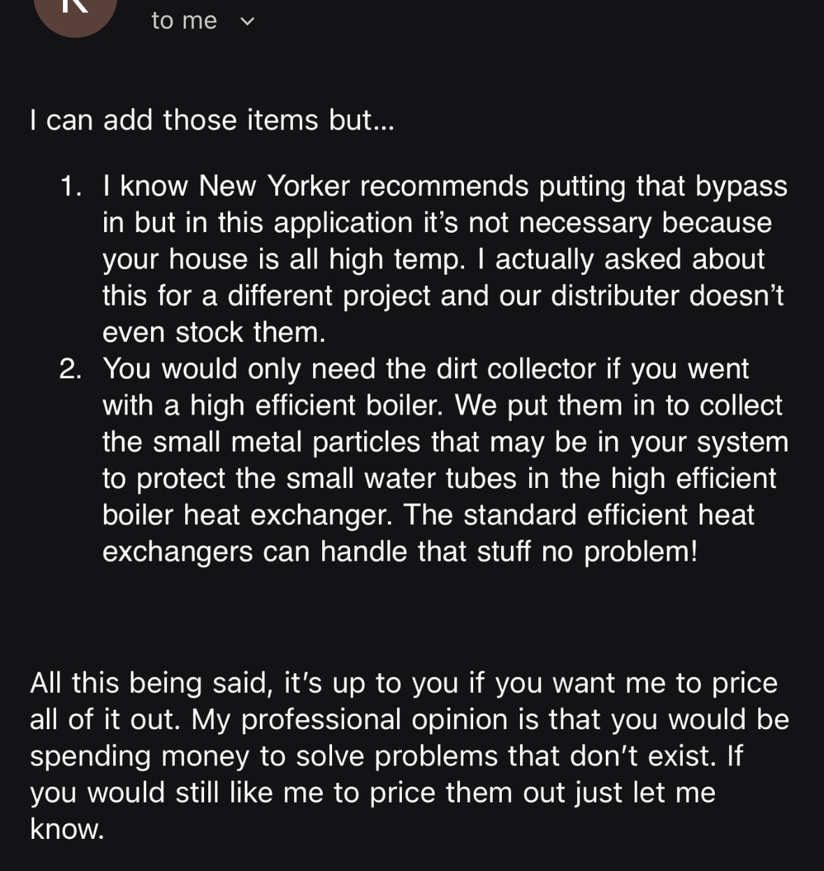

I dont really know how to properly ask this question - but what other equivalent methods are there to protect a cast iron boiler from low return temps? I’m on my 3rd contractor, getting a 2nd quote for a boiler replacement and it seems like none of them have ever heard of needing/wanting this before. And US Boiler makes it wonderfully easy for me to ask them to add their bypass kit to the quote, except that the kit is apparently out of stock or hard to get?

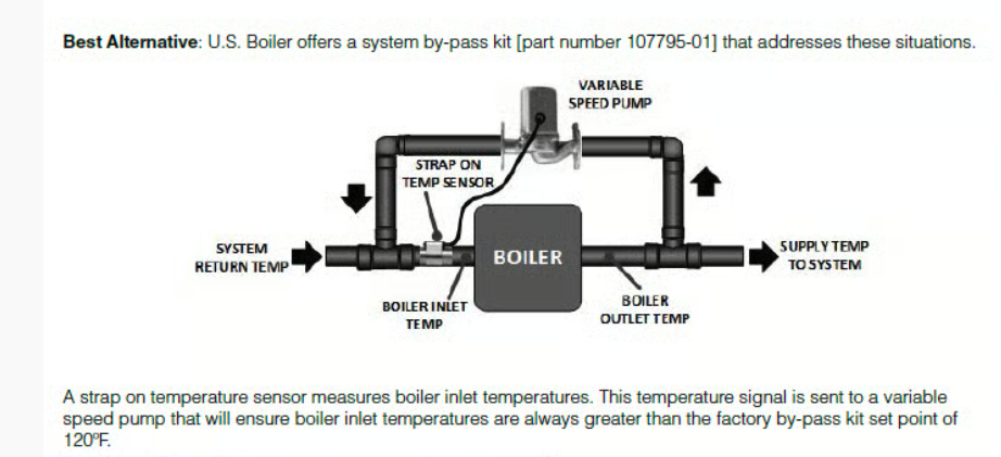

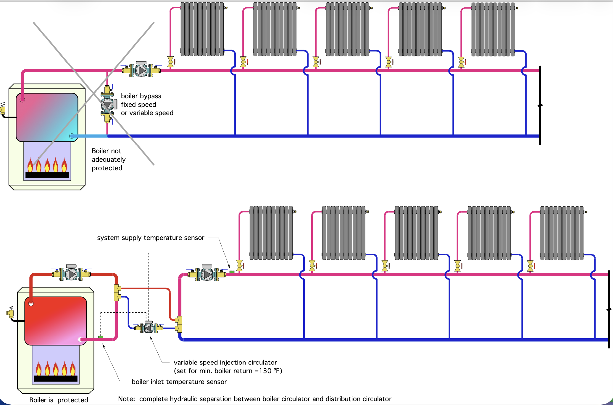

I’ve seen a few photos on here where you use thermostatic mixing valves instead of a speed controlled pump. That seems okay to me to.
To put it more succinctly, what the heck do I ask these guys to use if the kit I want is not available?
And just for laughs here was his response to me asking for the bypass kit and a magnetic separator:
Thanks

    Where are you located? You need someone who understands hydronics, and can read a manual. Boiler protection is fairly easy, and can be done a number of ways.

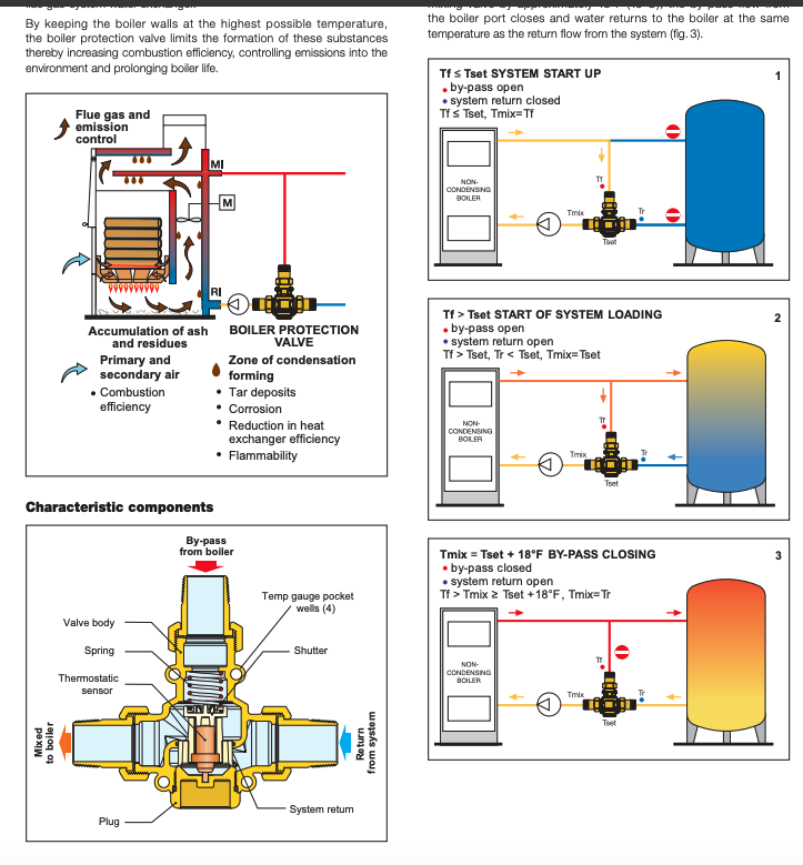

    The second picture is the better method. If the kit is unavailable, you can buy your own circ and sensor the rest is just standard pipe and fittings.
    Most HW jobs with baseboard come up to temp quickly and don't require protection but there are always exceptions. If you have and older system with CI radiators or a gravity conversion job that holds a lot of water, then you may need protection

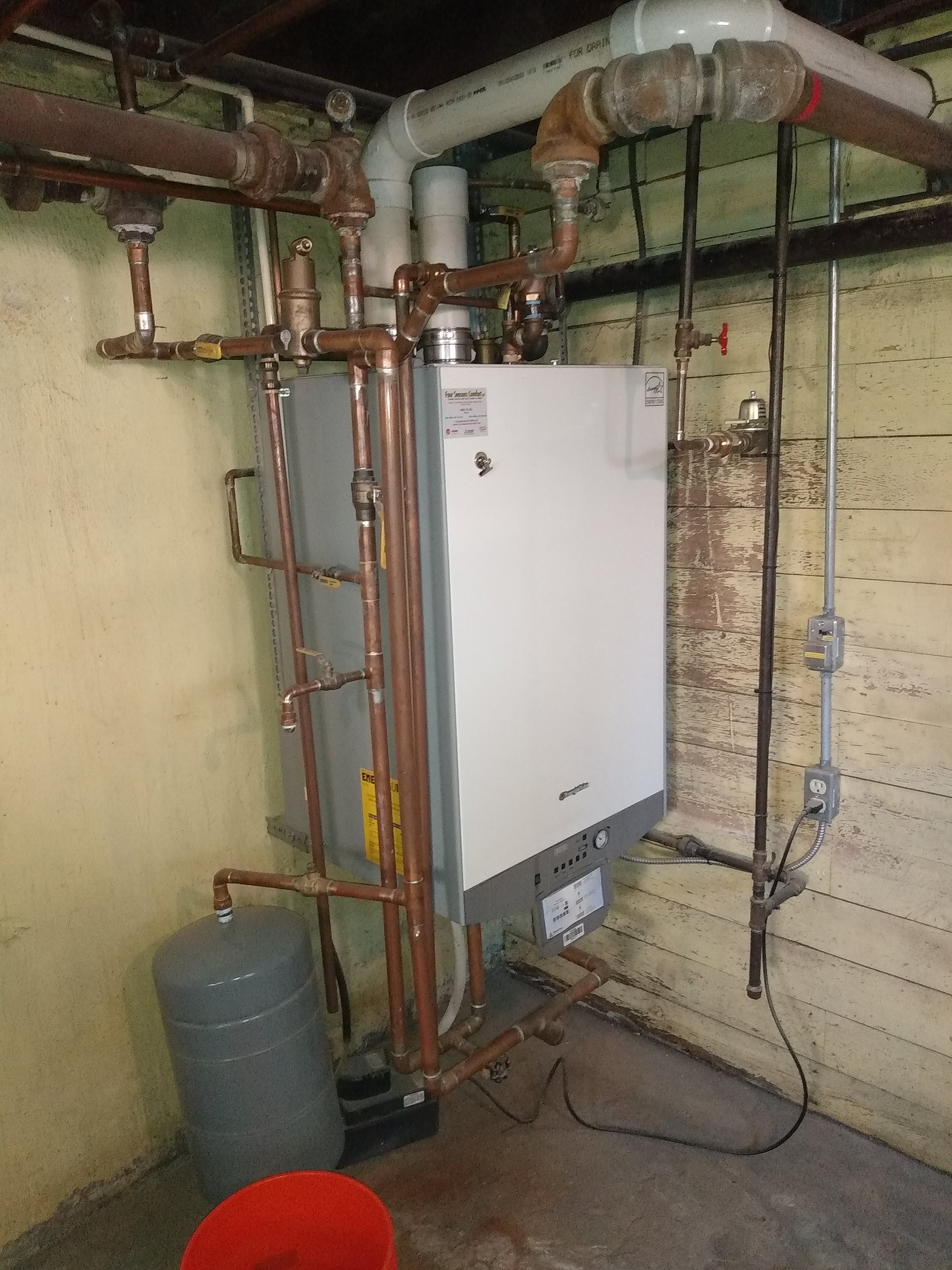

    We currently have a Triangle Tube Prestige Excellence 110 combi that has had quite a few issues and has left us without heat and hot water numerous times, which is why I’m going with a separate direct power vented water heater and cast iron boiler.

    A system like yours does scream out for a condensing boiler. That low return drives efficiency and the array of control settings allows you to dial in a near constant circulation operation
    A cast boiler should have protection and efficiency will be a bit lower

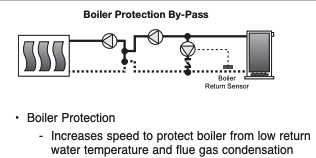

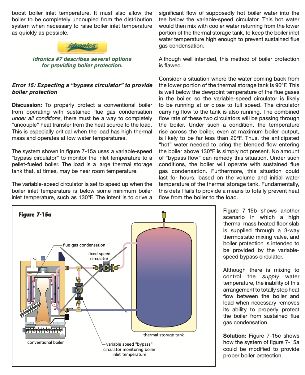

    I would not recommend that variable speed bypass method, it does not, can not offer 100% protection
    A 3 way valve can or build your own bypass with a vs pump

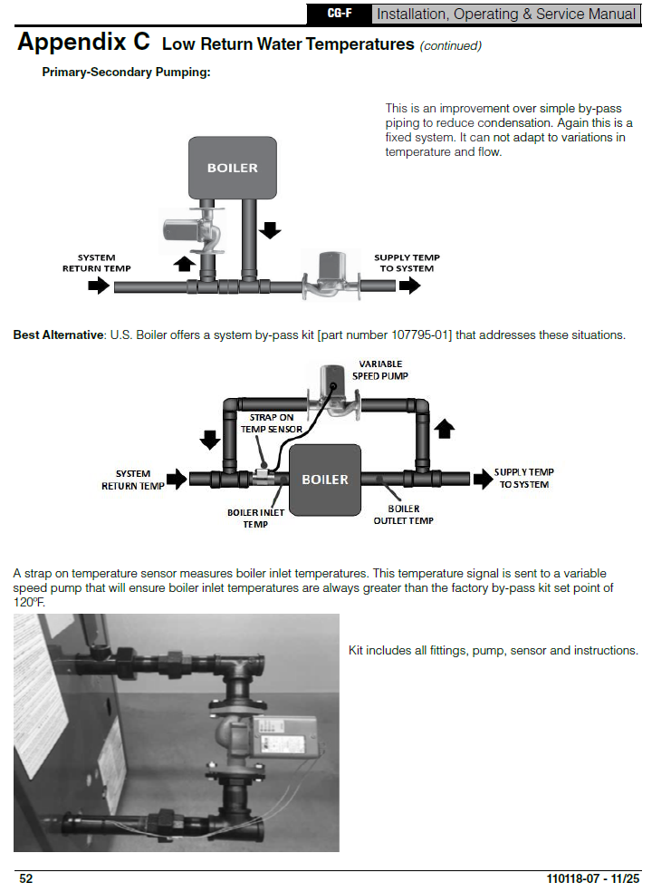

    I'm planning for a 105,000 btu cast iron boiler (88 MBH DOE, 77 MBH AHRI) that would still leave a little capacity for increased radiation if I find I need it. But like you're saying, it will be sized pretty close to my actual load.
  • Erin3
    Erin3 Posts: 20
    When you say the "variable speed bypass method" are you referring to exactly how the US Boiler bypass kit works? Why can't it offer 100% protection? I'm not questioning your knowledge, I'm just genuinely trying to understand this for myself.
    If I think this through on my own a bit, your answer is probably going to be that the pump can only ever take some capped % of the total GPM leaving the boiler. But the pump can never redirect 100% of the total GPM leaving the boiler back to the return. Whereas a 3-way valve (mixing valve?) will not allow any flow to leave until it hits the setpoint temp… NOW WE'RE GETTING SOMEWHERE.
    So if I'm picking up what you're putting down - the preferred method here is to use a single 3-way valve? Is there a Heating Help concensus on that?
    If I were to have this contractor just install it without a bypass piped in, would you guys say it's within the capability of a homeowner (me) to install a 3-way valve after the fact? My wife is really getting fed up with me "overthinking" this replacement, so I (she) was really hoping this company would be the last one… 😁😅

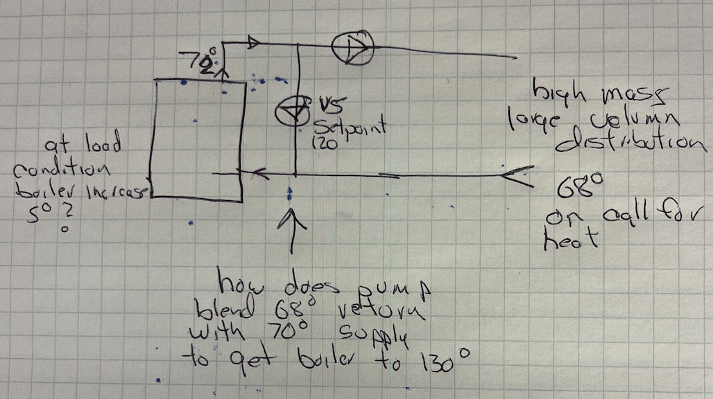

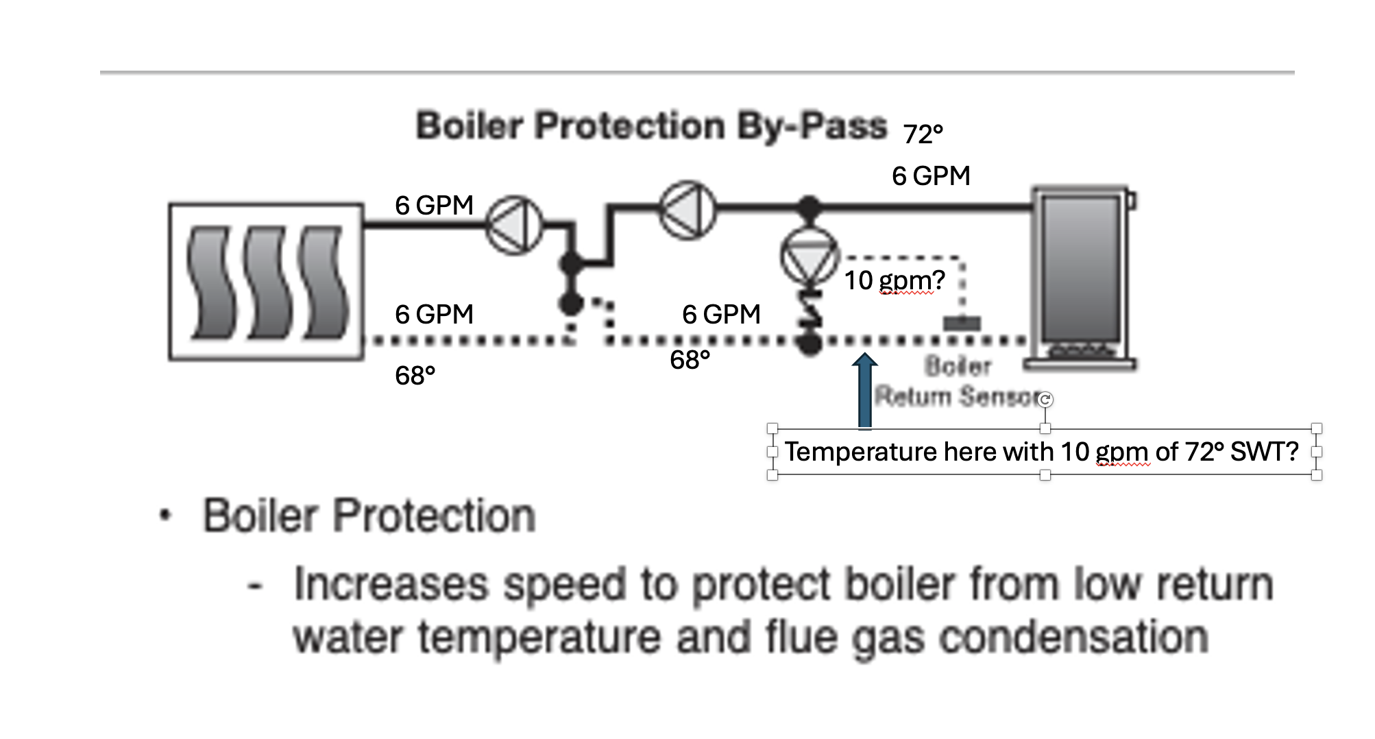

    I'm not sure how this US Boiler solution works without a system pump?? They show system pumps on the other methods? A bit misleading for the inexperienced installer.

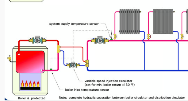

    If you put some typical numbers to a system you will see the issue.
    Assume a cold start boiler, not a tankless coil boiler?
    On call for heat water returns at room temperature, or cooler depending on piping location.
    So assume 68° is coming back from a 180 gallon high mass radiators, large steel pipe.
    the boiler is sized close to the load and radiators connected expect at a design condition the boiler can "lift" the temperature a few degrees, call it 72°.
    How does a variable speed pump increase the temperature to get the boiler to 130?
    The only possibility would be to turn off the system pump to allow the boiler to catch up to120- 130. If so why have a bypass pump? Just bang bang the system pump on/off based on return temperature, saves an expensive pump.
    A proper return method has a means to disconnect the load from the boiler, based on a temperature reading.
    This is why a bypass valve or pump is only a guess and works at the condition you set it up at. When is that? Coldest day, full load on the system? Boiler hot or just starting? What happens on a low load, medium load condition? Too much bypass?
    We talk about a "thermal clutch" a means to allow the flows to modulate at the exact rate the boiler can accomodate.
    This is what a 3 way mix valve does, or a properly piped VS pump.

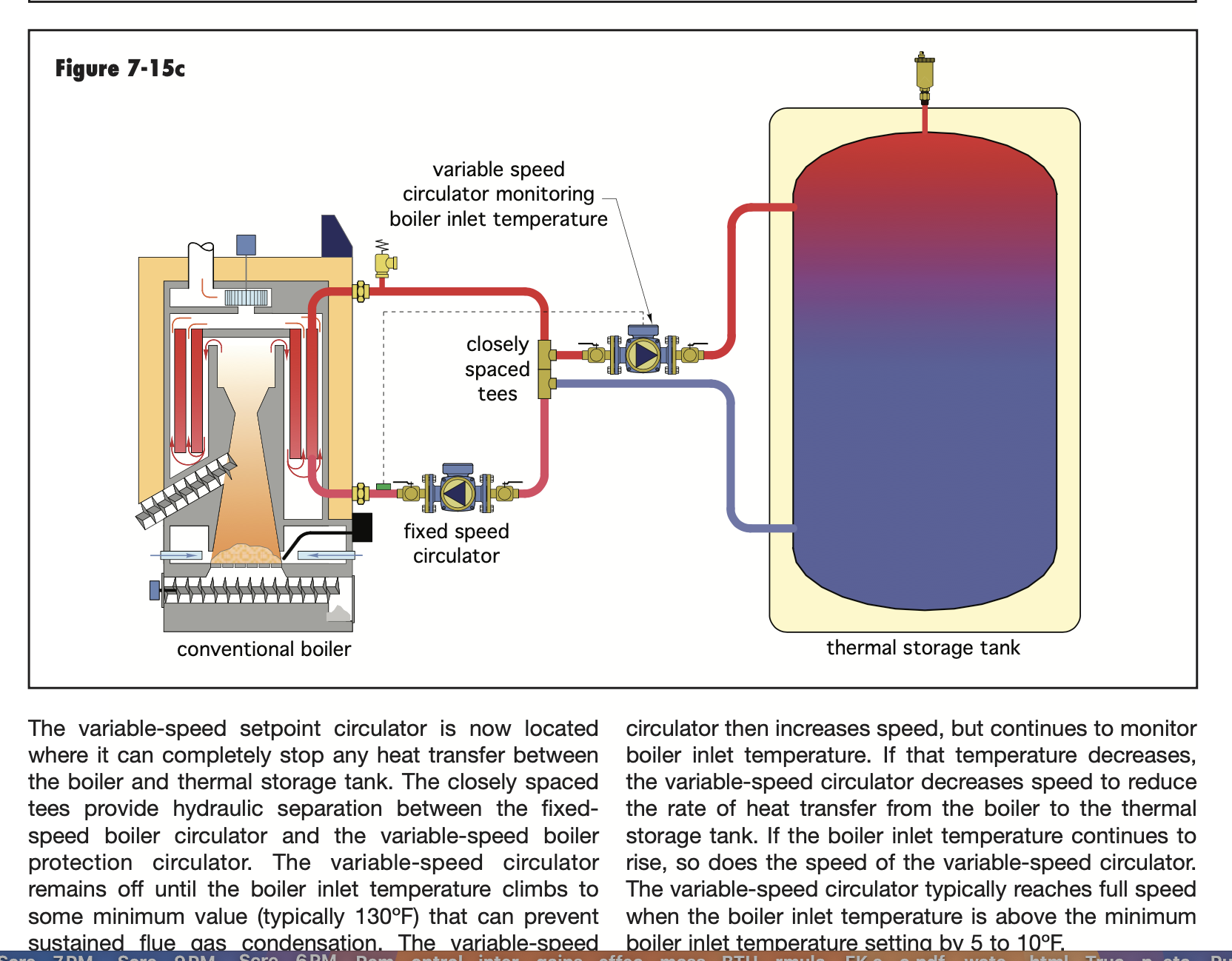

    With a low head system, a single circ can work.
    With multiple zone pumped systems, or high pressure drop distribution, closely spaced tees with a mix valve. Zone an boiler pump sized accordingly as you have hydraulic separation in this option.
    The small piping change in this next drawing allows the load to disconnect from the boiler. The VS pump, as a P/S close tee piping, injects energy into the system based on a return sensing, a motorized thermal clutch solution. With this solution all 3 pumps could, should be sized to their exact loads. The boiler pump as per the manufacturers spec choices. The injection pump, based on the injection formula, ususlly a very small circ.
    The distribution pump may be a high flow low head version on a gravity conversion, could be a medium or high head on a radiant tube system.Thrin
    Explanation below
    This is a lot like the Pumping Away concept and discussions. Plenty of installers claim pumping away is a waste of time, not needed, ,pumping into boilers and expansion tanks has worked fine for generations, why else would boiler manufacturers put pumps on boiler returns?

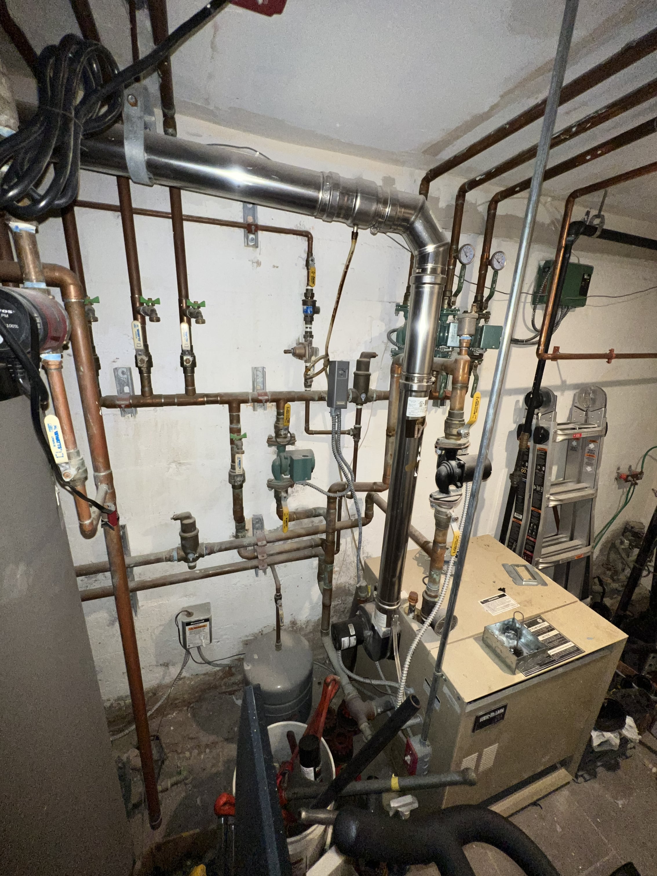

    Here's my existing boiler:

    mattmia2 Posts: 18,001
    prevent condensation in the boiler block. with the mass of a gravity conversion system it is likely that the boiler may not be able to put enough heat in to the system to get the outlet to 140 until it has run for quite a while and other than on the coldest of days it is likely the thermostat will satisfy before that happens. it would also overshoot if the boiler was large enough to heat all that mass quickly.
    pecmsg Posts: 7,488
    consider replacing the oversized lines. That will help a lot.

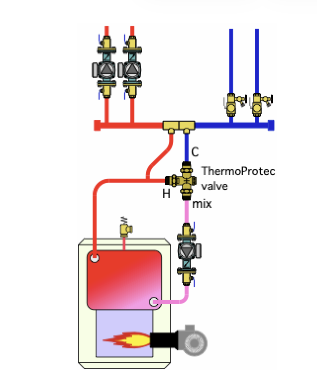

    It's hard to beat the simplicity of a thermostatic return valve. Thermostatic bypass valves have been used in various boilers for many years. Most pool boilers have them built inside. The weil GV gold CI boiler had one built in.
    With the large pipe, low head loss system you have a single pump would probably do the job. Check the boilers recommendation for pump.
    The color schematic below happens to show the buffer as the load, same concept. Step 2, allowing a portion of the return to blend in may happen in minutes, it may take 1/2 hour, it is all based on the load and boilers delivered output. if the boiler is oversized to the attached radiation, the most common match, then the valve opens faster.
    The largest market for these valves is the wood boiler industry. I spotted a handful of manufacturers with these valves at the Mostra show in Italy a few weeks back. So they talk more about solid fuel problems, like creasote formation same physics at work with fossil fueled boilers.

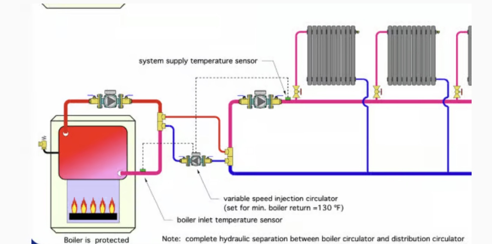

    I think the VS pump like this color drawing makes sense. This piping concept has been used for years with CI boilers connected to low temperature radiant as it both mixes and protects the boiler, basically called "injection mixing" It's the concept and product that put tekmar on the map
    The Taco schematic below this schematic, see the difference??
    It's all about the pump placement. Again how does the pump "speed up" to overcome the large thermal load? It's not adding any heat energy. Only if the distribution pump drops off could that happen, the thermal clutch would be the boiler pump. may as well just use a $50 aquastat to hold the pump off.
    The ONLY reason to use any return protection method is the load /distribution is much larger that the boiler can keep up with, suppressing it's operating temperature condition. May as well pipe and control it with a appropriate fix as the goal, not a "maybe" That was the whole point of injection mixing!

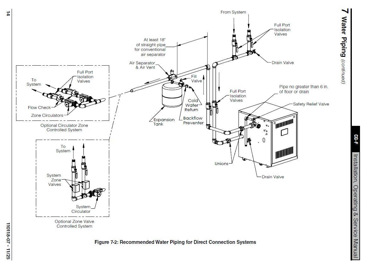

    The quoted boiler is a New Yorker CG40FN which I believe comes with a Taco 007 circulator.

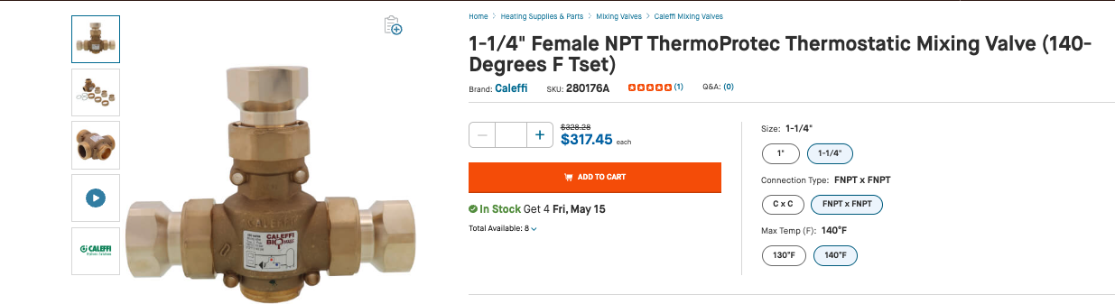

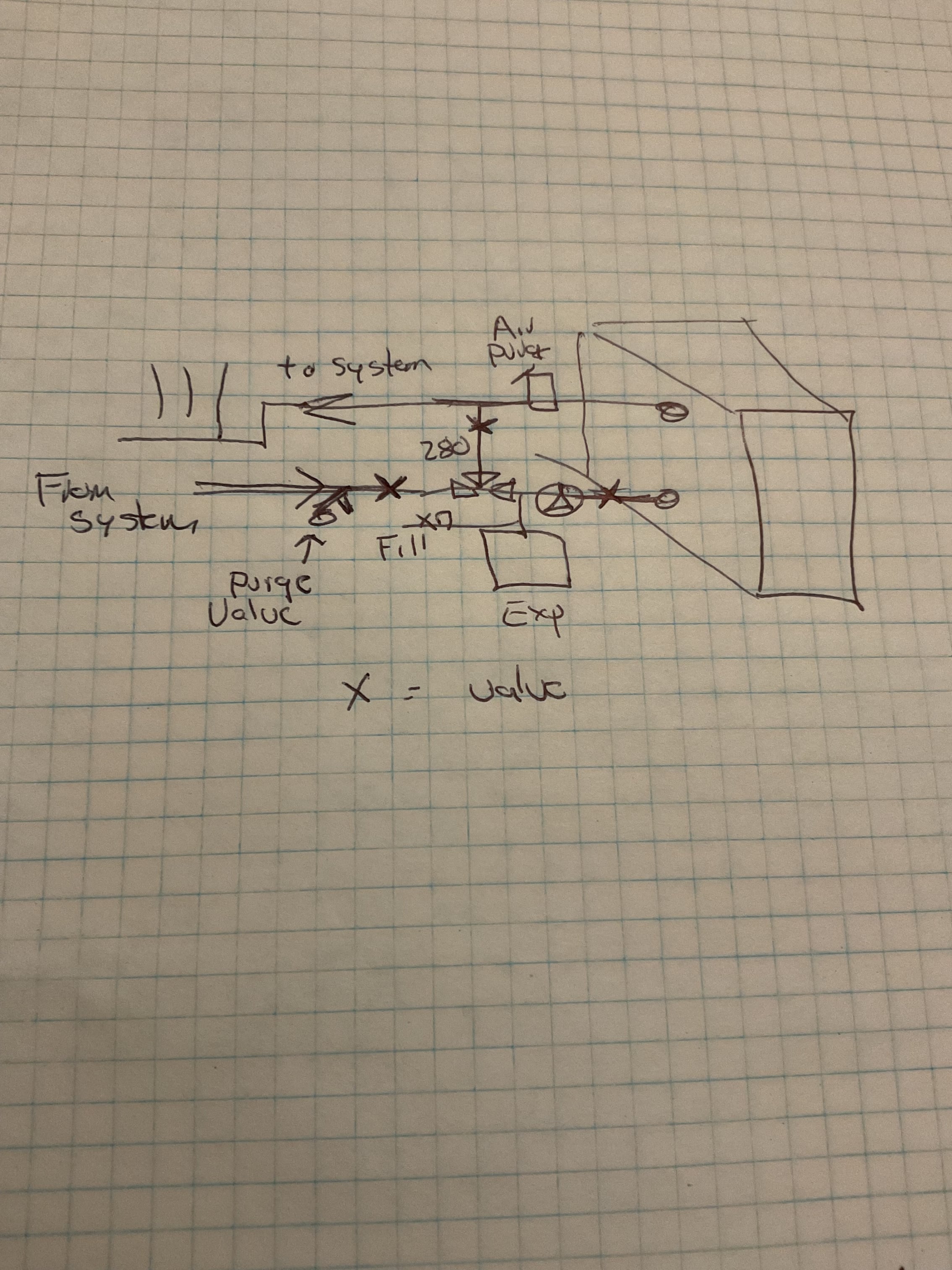

    Where and how would you connect the 280 series mixing valve in the diagram below? It’s a single zone system, so the circulator will (hopefully) be to the left of the expansion tank, pumping away.
    I’m just looking for a simple way to communicate what I want, and make sure that it doesn’t get installed on the water heater instead!

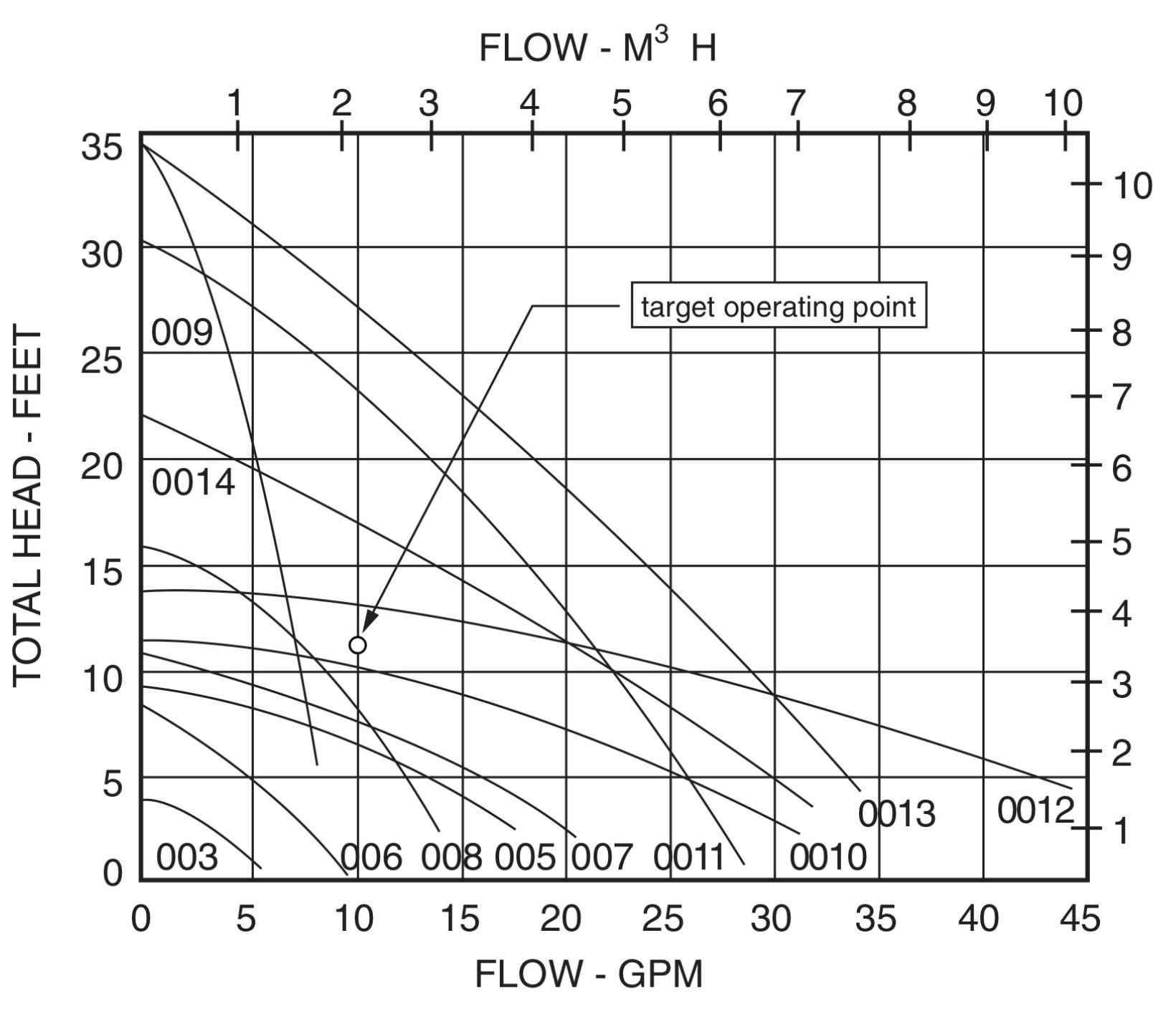

    the 007 may not be the right circulator for that application. the gravity system will be low head but you may need more flow than the 007 provides(i don't know but someone needs to do the math or you will have a bad time). the 007 is probably fine for that boiler in to baseboard in a series loop or zoned but it might not have the volume for a high volume system at least as a direct piped system vs primary secondary with 2 circulators.
    hot_rod Posts: 28,221
    the pump sizes by the the gpm and the head, flow resistance of the circuit
    The gpm tells the amount of heating btu you can move. A a common 20 delta, temperature drop around the circuit the math is simple.
    To move 120,000 you need 12 gpm
    The large piping will not present much flow resistance, nor will a three way valve
    Estimate 4’ of head, so an 007 would move 12 gpm, 120,000 btu/ hr
    choice for high flow low head applications, if you need more than 12 gpm or so.
    The amount of water, the volume does not effect the pump selection.
    if you place 3 shut off ball valves like this, you can isolate the pump and 280 valve for easy service. A purge valve before the bottom left shut off
    Expansion tank and fill valve before the pump.The pump pulling away from the mix valve, pumping into the boiler
    Air purger at boiler supply connection.

    Close, one of the pumps would need to turn off when boiler return is below 130. It could be the injection loop pump or the boiler pump.
    The primary loop is always the loop that has the expansion tank connectd to it. I think the distribution loop, up top, with the zone pumps is the primary loop?
    tcassano87
    if you are doing it with an injection pump and an on/off control you need to be able to make that circulator's flow low enough that it doesn't immediately cool the boiler to the point the aquastat turns it off again as soon as it starts which probably is a combination of pump size and a throttling valve.
    It would seem if you are going low flow high delta that you need to be able to throttle the flow through the close radiators most of the way off with the radiator valve to make the water find its way to the far end of the system. if you're dealing with 2" or 3" pipes and 3/4" or 1" radiator runnouts all the heat is going to want to get off at the first couple radiators without a way to throttle the flow.

    this diagram is perfect, thank you.
    I feel like telling them that I want a 280 series valve, and it should be piped like so is about as simple as I can make it.
    I think telling them what size pump to put in is probably crossing the (imaginary) line for me as a customer doing what should be their job (ignoring the part where I provided the spec for boiler protection). Idk. Honestly that would be approaching the point of just having them deliver the thing, hook up the gas, connect the vent to the chimney, and then let me do the near boiler piping myself and have them comeback for commissioning and combustion testing when I’m done.
    Also, telling my wife that I’m gonna do it myself might also lead to my inevitable death (“I don’t know what happened, a random brick fell off the house and killed him”). My wife reads a lotta murder mysteries so I gotta stay on my toes.
    PeteA

    This is basically just a fancier version of Hot Rod's sketch above, but can you guys look at this and tell me I if I screwed anything up?
    that works, you have good isolation, dirt and air separation.
    I would delete the air vent above the expansion tank
    The valve on the blue from system line needs to flip so the purge port is on the left of the ball., or use a Webstone version that can purge two directions
  • Erin3
    Erin3 Posts: 20
    Boom
    Now, can someone remind me why I recall there being a recommendation to put the circulator on the supply side of the boiler (pumping away from the expansion tank)?
    pumping away from the boiler, expansion tank, and air separator
    away from the expansion tank so the pressure the pump is producing goes to moving water through the system, not pushing water in to the expansion tank. if you pump in to the expansion tank it can accommodate less expansion because you are forcing more water in to the tank with the higher pressure on the discharge of the pump. on a cast iron boiler and converted gravity system where there isn't much resistance to flow this matters less but it is best to not find out your system is the exception.
    away from the air separator so that the air separator is at the lowest pressure and on the outlet of the boiler so the water at the air separator is at the hottest point in the system. less air dissolves in hotter water and less air dissolves in lower pressure water so it encourages the air to come out of solution at the air separator.
    The circulator should pump away from the expansion tank so it adds it's pressure differential to the system.
    It does not need to be on the supply side of the boiler. In fact some high head mod cons prefer you pump into the boiler.
    The air purger works best at the supply, the hottest water in the system.
    But the expansion tank does not need to be below the purger either, as you show.w
    it is also preferred to pump away from a 3 way mix valve, so it pulls the hot and cold through the valve.
    The red and blue water to get to purple :)
    It will work great as shown
    The pump does not push water into the expansion tank! Where would that water come from? There would be less water somewhere in the piping if the pump was to push water into the tank.
    The expansion tank connection into the system establishes the PONPC point of no pressure change, the pump cannot effect that.
    Water enters an expansion tank from the expansion of the water as it is heats, volume increases, or comes out as the water cools.
