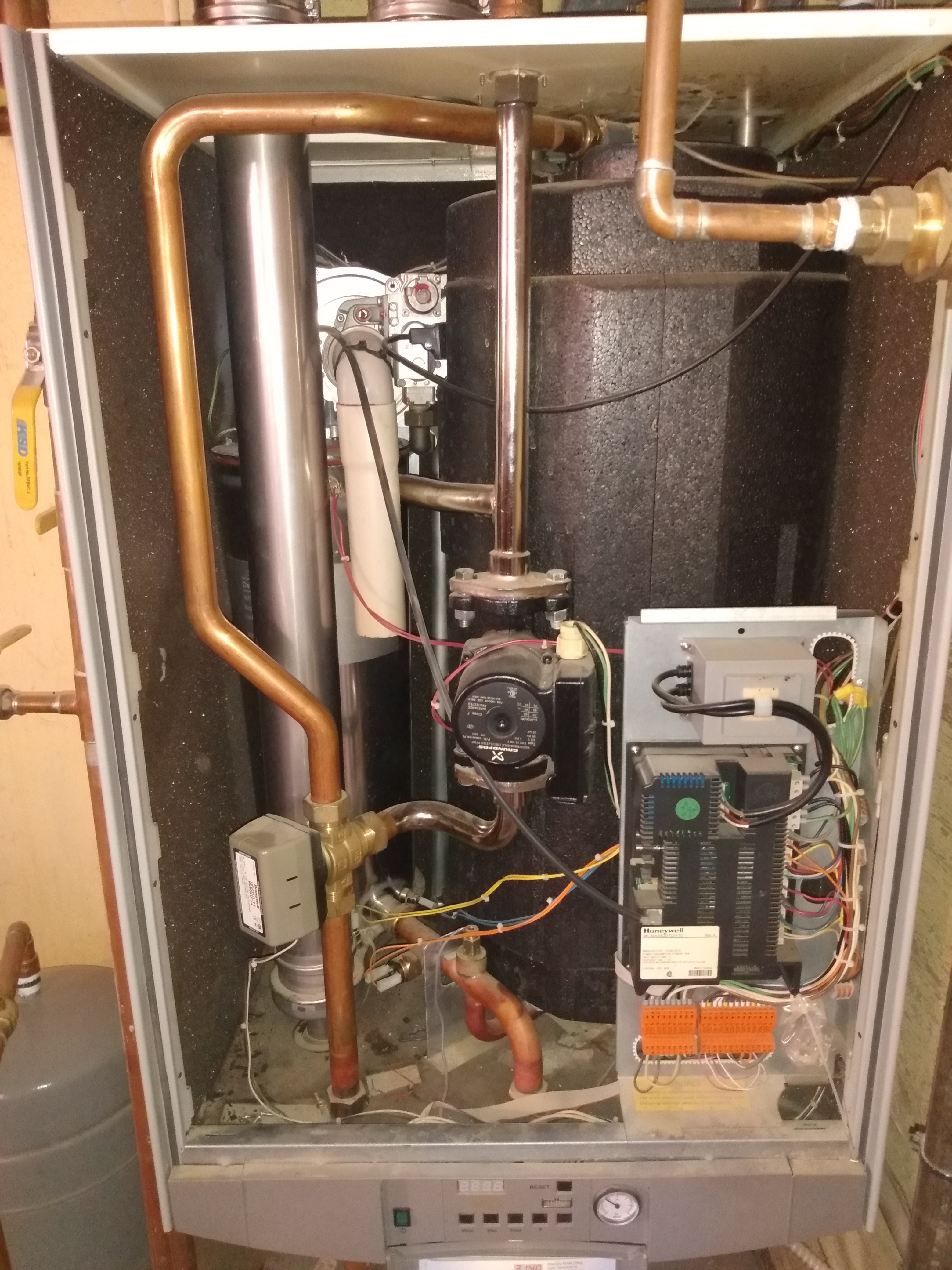

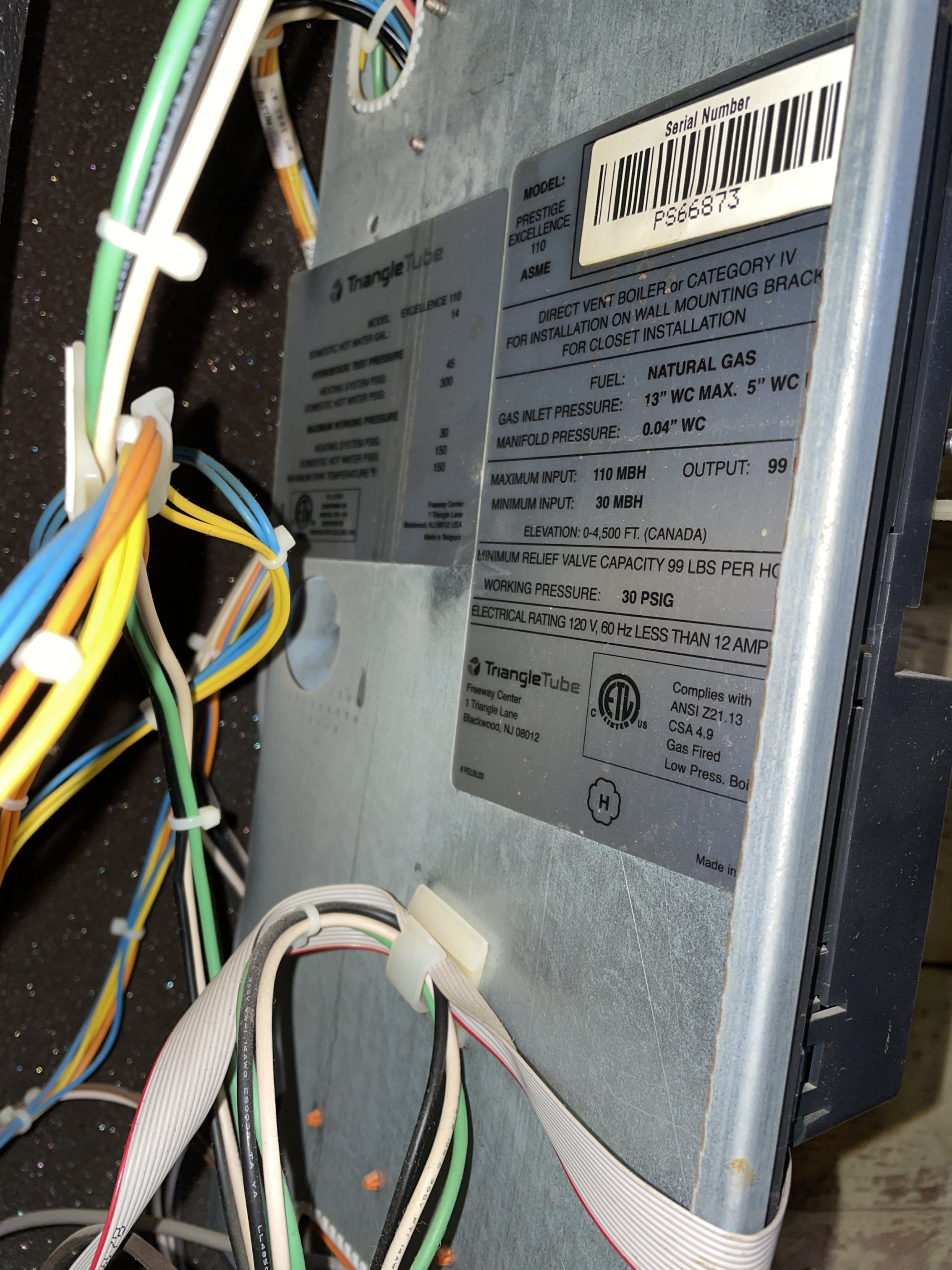

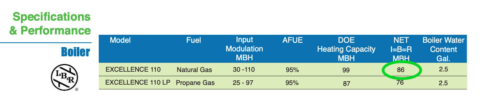

    When a boiler that has a 110,000 BTUh input at over 95% efficiency there will be an output rating of about 99,000 BTUh
    When a cast iron boiler of say 80% efficiency has that same 110,000 BTUh input, the output is only going to be 88,000 BTUh. So a less efficient boiler will need a larger input to get the same output. So there may be some logic to the larger cast iron boiler size.
    However there is some concern about selecting the proper size boiler. Chances are that your 110,000 BTU boiler had a modulating input and that you never really needed to have a 110,000 BTU boiler for space heating. You only needed that for the DHW side of the system.
    To know what actual size heater you need, you should have a Load Calculation for your home completed.  This may reveal that you only need 70,000 BTUh for your home and the 140 is too big.   Try a different contractor that will at least do some measuring of your home and come up with a load number for your home.  ACCA Manual J or  AHRI form 1504WH for a heating system are acceptable calculations.  Another way is to go by your historic fuel usage.  There are calculations that will tell you your actual load based on accurate fuel usage data.
    Once you know what size your home requires then use the AHRI NET output number (formerly I=B=R NET) in the boiler specifications sheet to select the proper size boiler.  The input is for measuring the gas pipe the AHRI NET is for matching to your load calculation.
    Your triangle tube boiler specifications:
    The Burnham Specifications:
    This is too close to call because the smaller 105 boiler will have a NET output of 78,000 compared to your existing 86,000 NET output.  You really need to do the load calculation.  Your contractor is playing it safe rather than doing the homework necessary to get you the best choice.  If your home only needs 70,000 or less then the 140 is too big and the 105 is a better choice.

    Looks like the TT is direct piped, no primary secondary. If so you need to make sure it was getting adequate flow.
    It wise to have a dirt/ magnetic separator on those old iron pipe systems

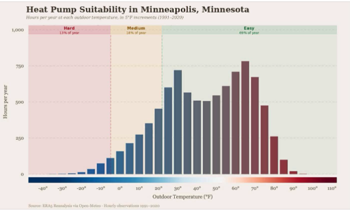

    Data like this would show how many days a year you need full boiler BTU output. Probably less that 8-10% of the year. Find the data for your closest weather station.

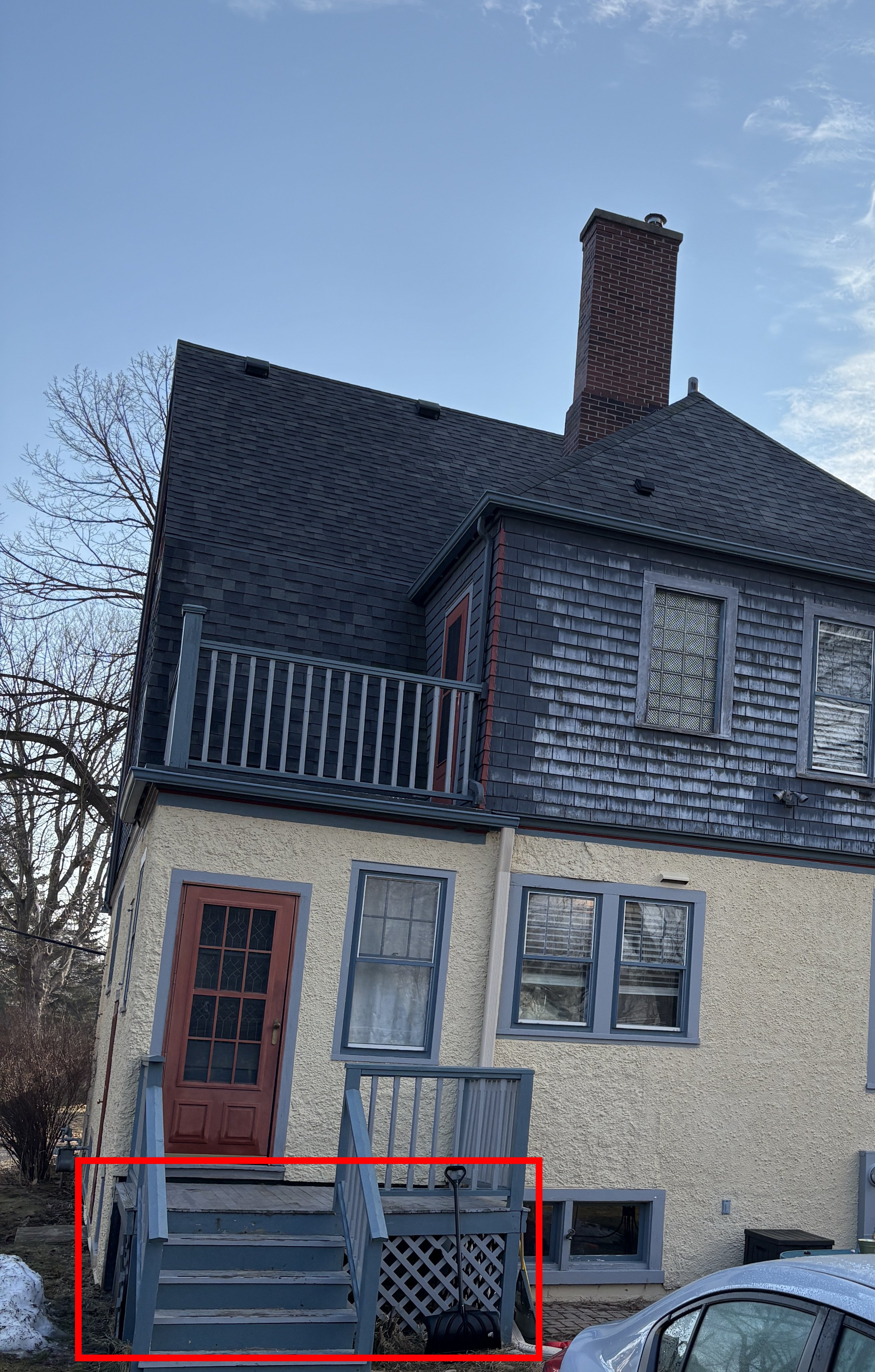

    2. There's a small chunk of exterior wall that isn't currently sided…. it's a long story, but it was like this when we moved in. I only realized it late last summer when we cleaned out the mountain of stone/rubble under the back deck. I plan to correct this this summer.

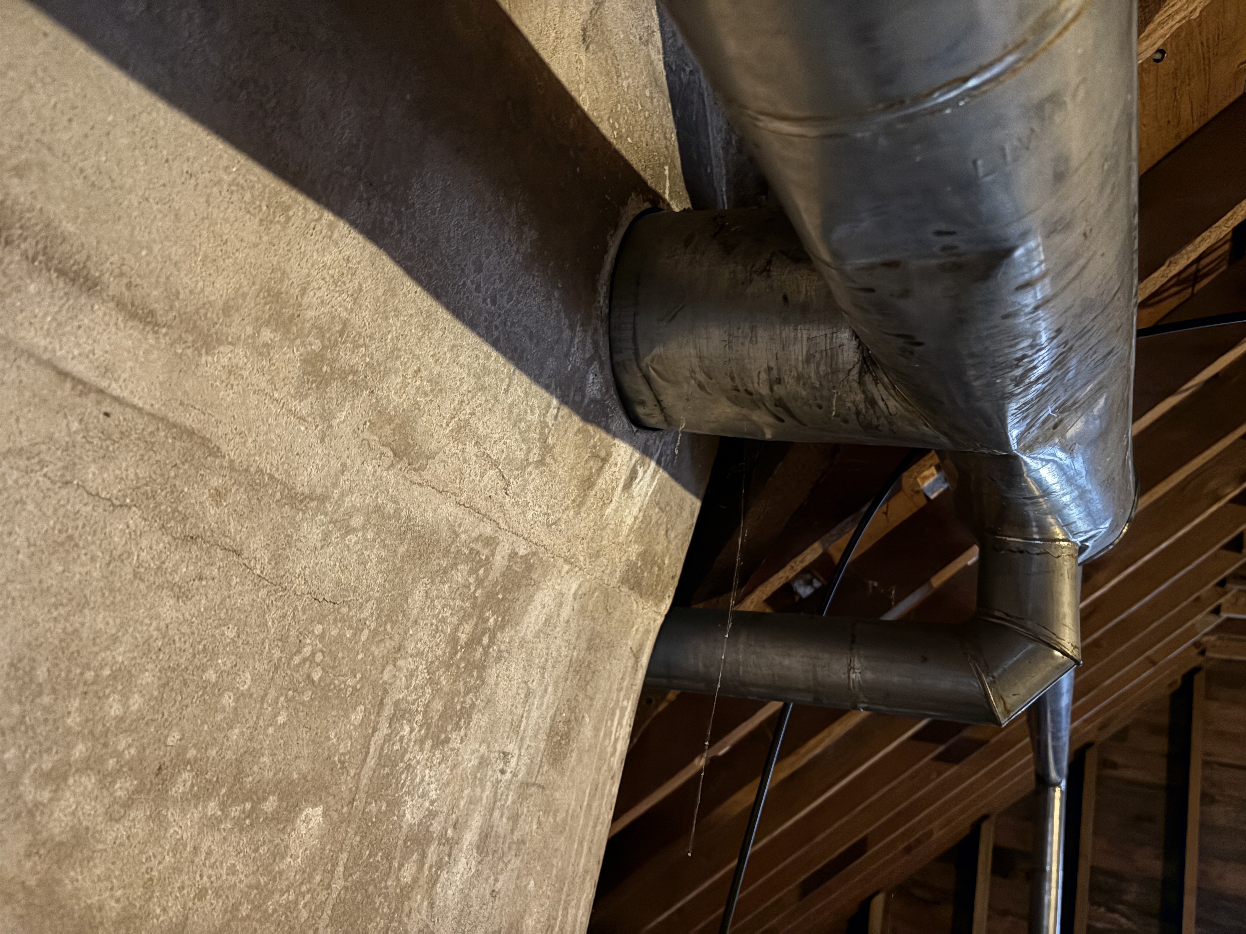

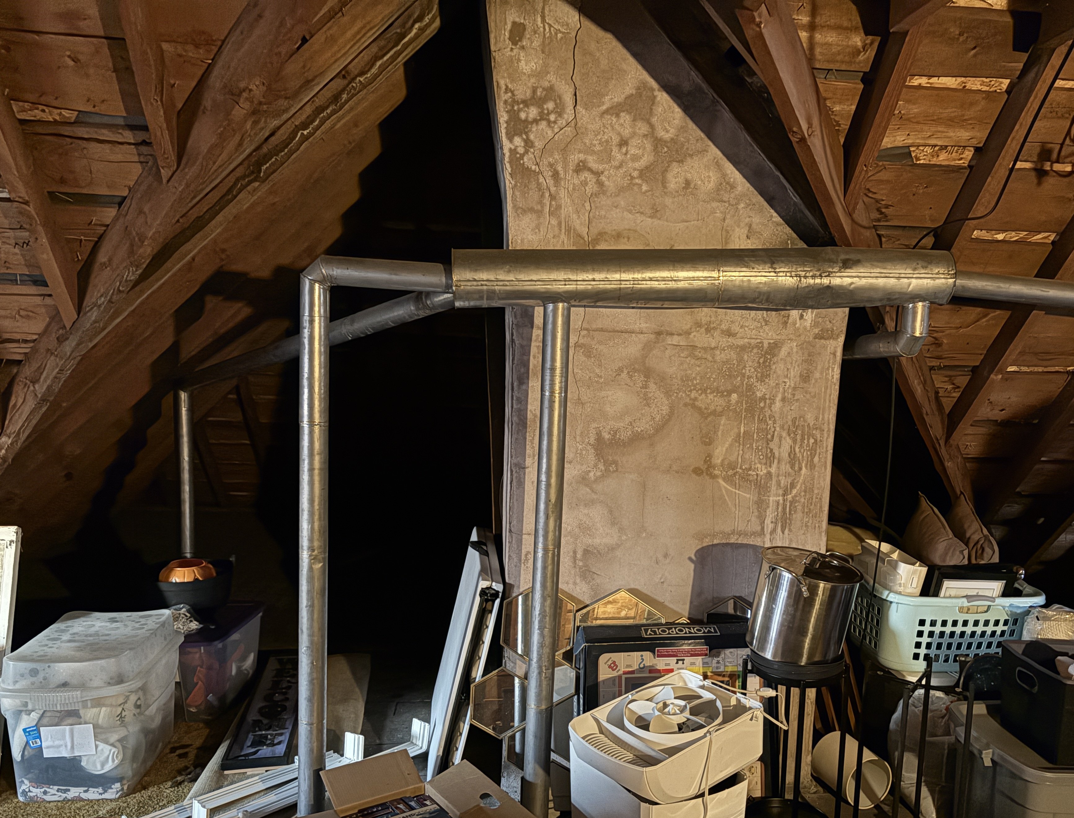

    3. Lastly, there's a weird chimney / vent system on the second floor that will get sealed up this summer too. The vents are currently covered, but it is not 100% air tight. If anyone has seen this before, I'd love to know more about it…
    I'm hoping that correcting items 2 and 3 this summer will result in reduced heat losses next winter.

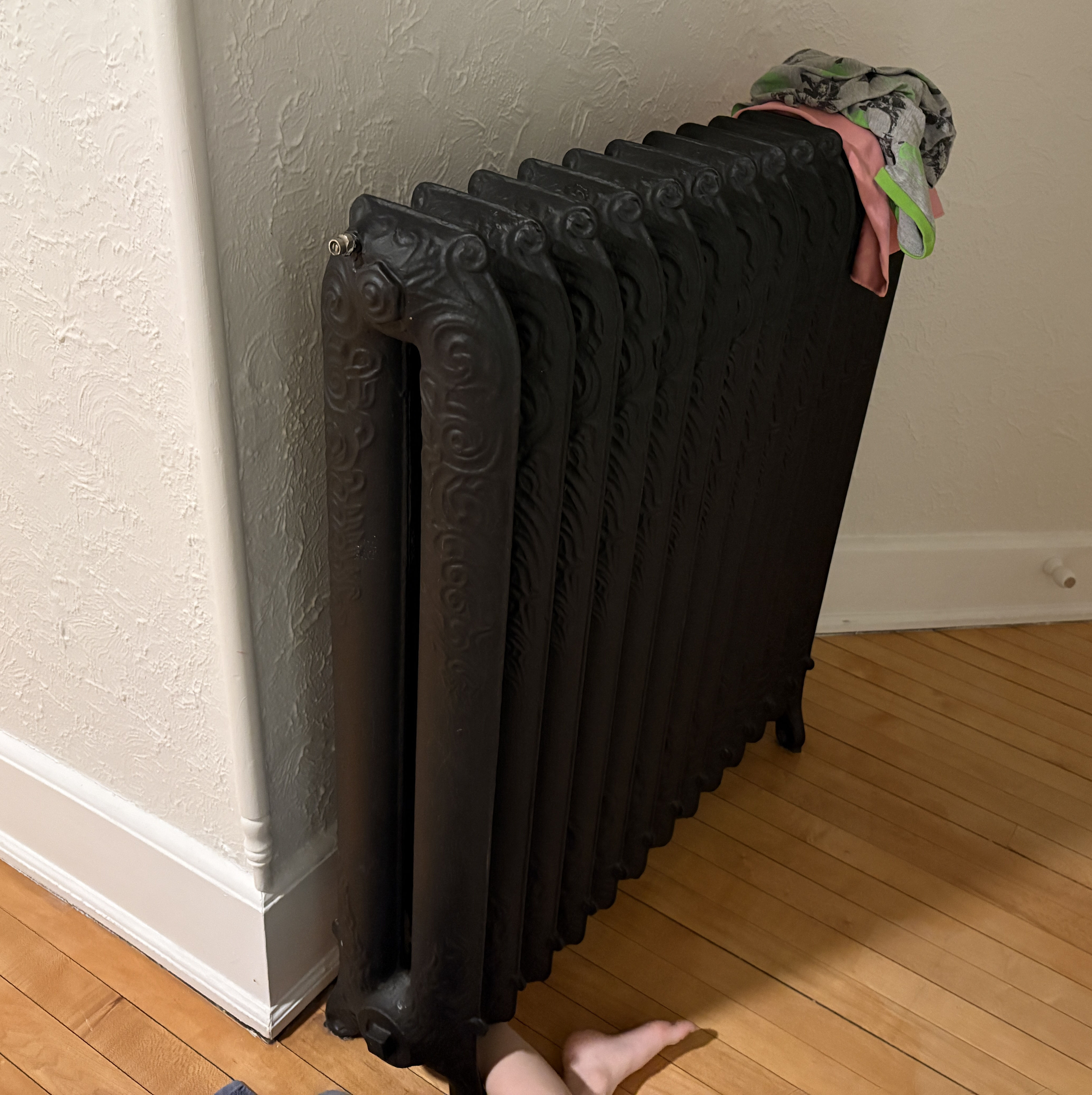

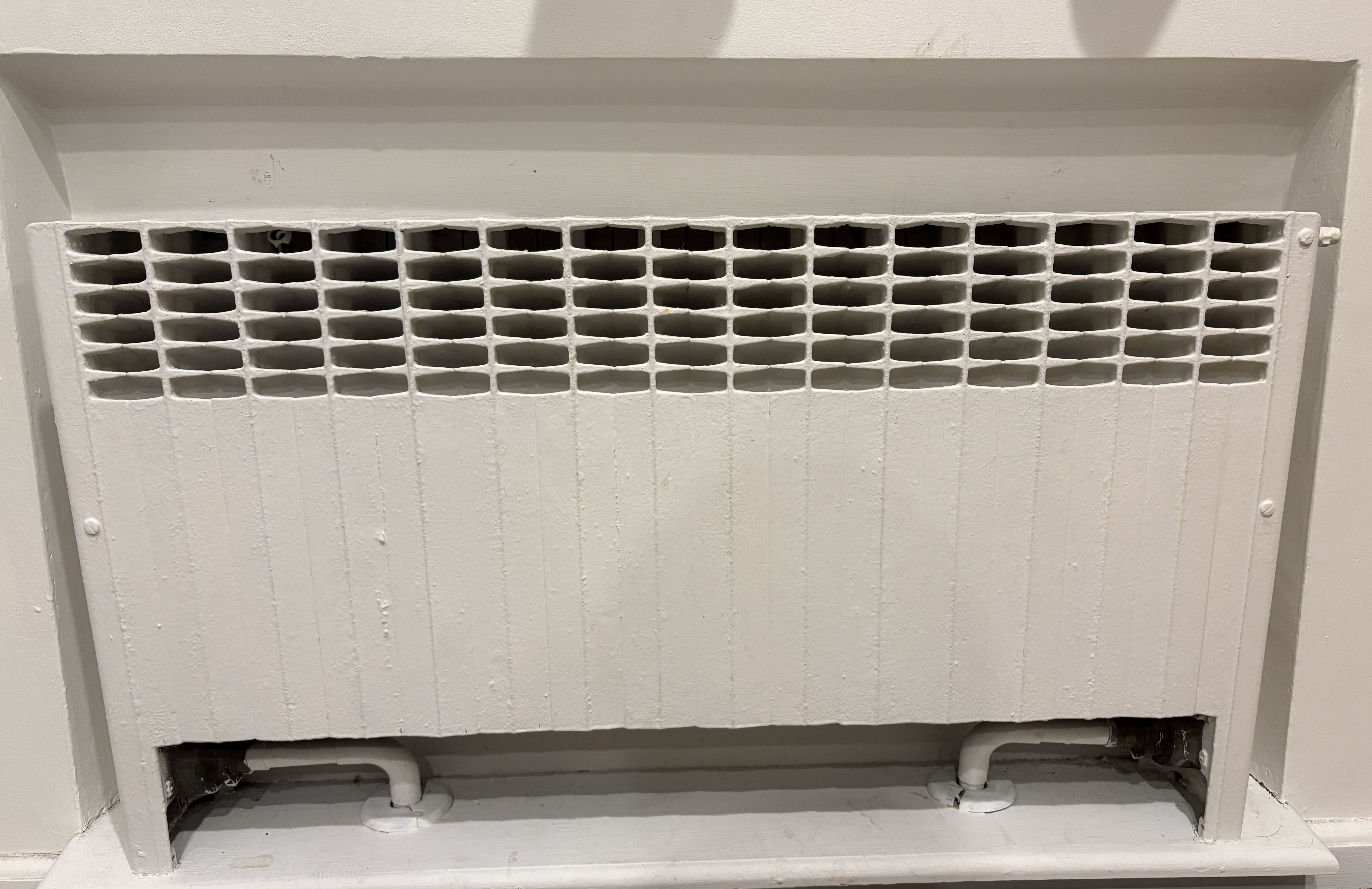

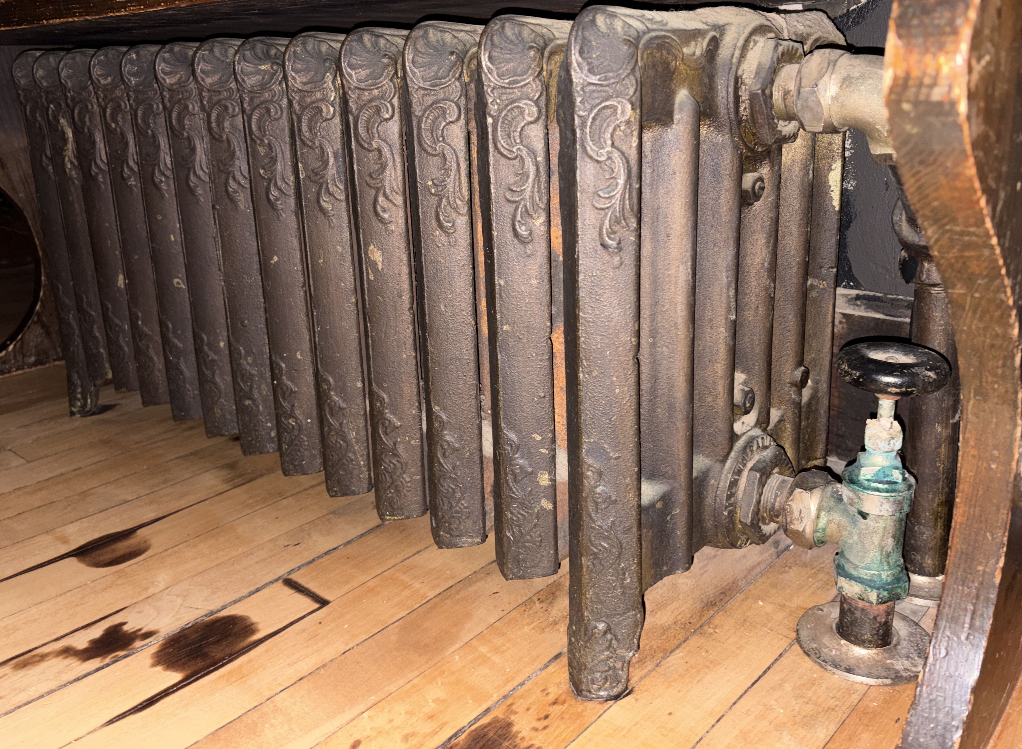

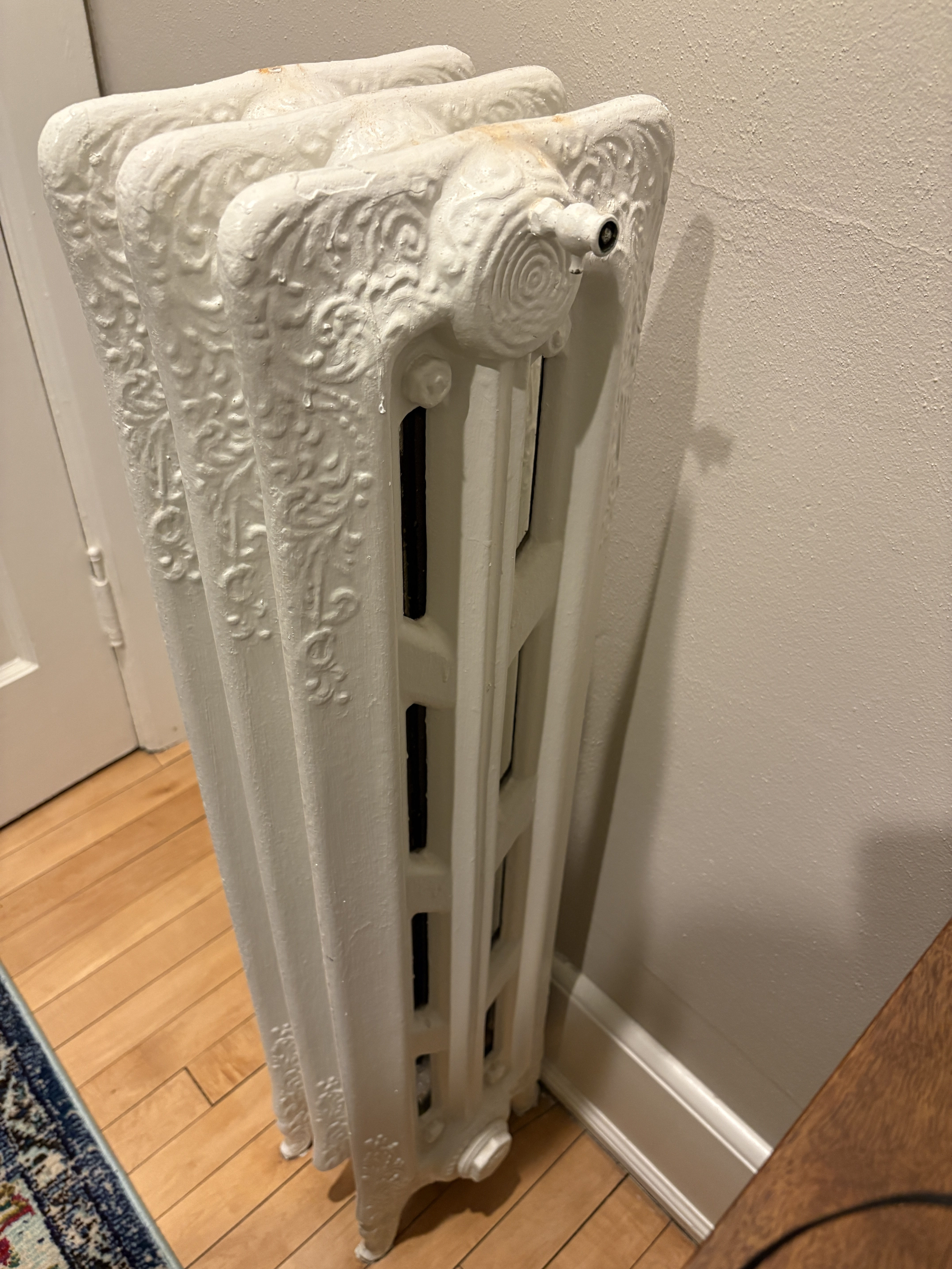

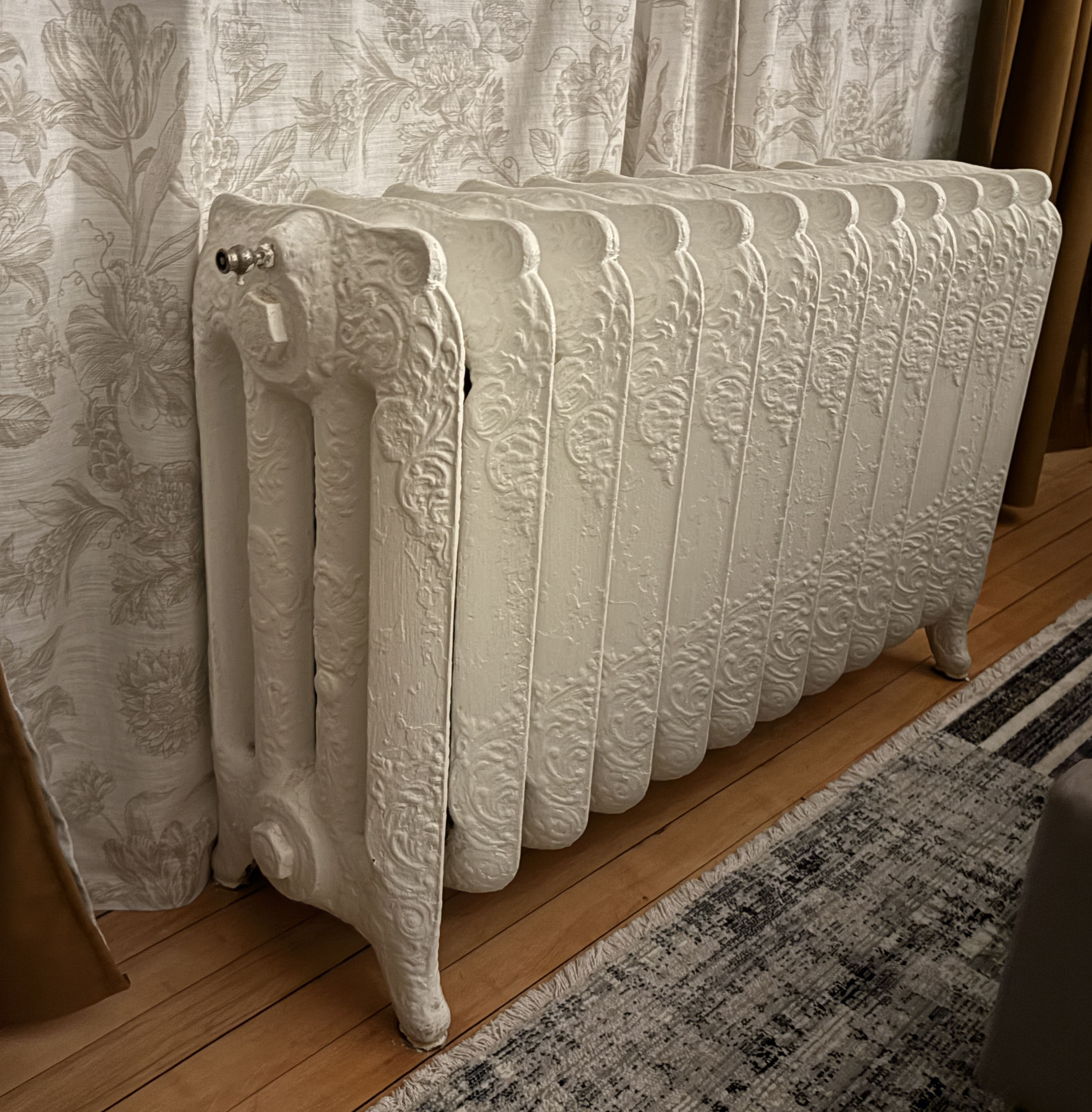

    Radiators
    Height
    Columns
    Sections
    EDR/s
    BTUh
    20
    20x36x5
    16
    1.98
    5,392
    26
    3
    18
    3.75
    11,475
    16.5
    6
    13
    3.5
    7,735
    38.5
    3
    14
    5
    11,900
    37.5
    2
    13
    4
    8,840
    38.5
    3
    6
    5
    5,100
    38.5
    3
    8
    5
    6,800
    22.5
    4
    12
    4
    8,160
    38.5
    3
    5
    5
    4,250
    38.5
    3
    3
    5
    2,550
    Total
    1st Floor
    36,502
    Total
    2nd Floor
    35,700
    Total
    72,202
    Found estimated EDR per these documents, where my values for BTUh = EDR * sections * 170
    https://images.greenbuildingadvisor.com/app/uploads/2019/08/13144448/Sizing-Cast-Iron-Radiator-Heating-Capacity-Guide-.pdf
    https://s3-us-west-2.amazonaws.com/catsy.782/Radiation+Classic+Slenderized+Radiant.pdf
    Example 1 (6 of 10 radiators are this style)
    Example 2
    Example 3
    Example 4
    Example 5

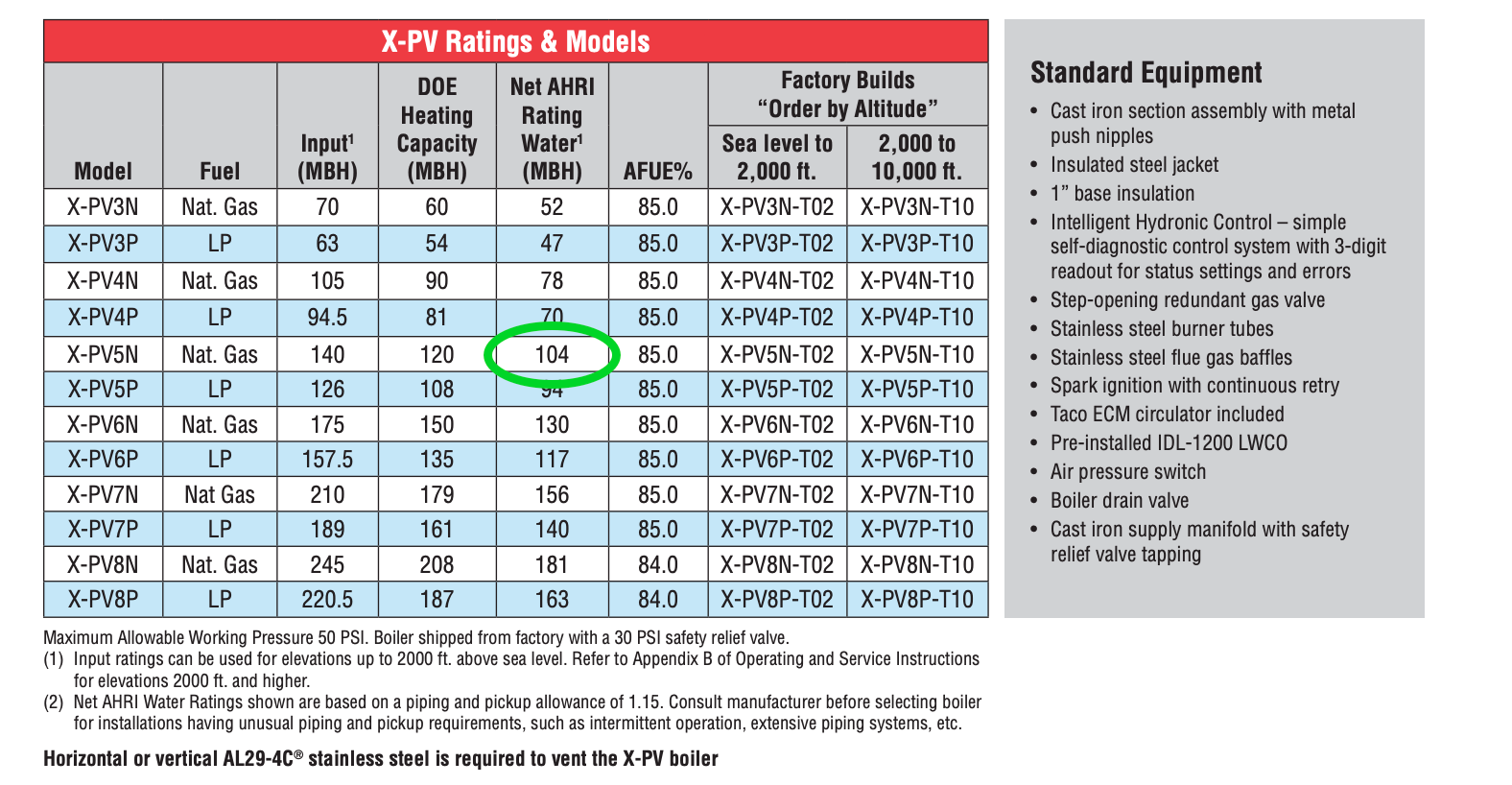

    Alright - sorry for triple commenting, but I've made some major edits/revisions to my tables above and want to get some feedback on a few more things.
    1. Obviously there's a really big mismatch between the output of my radiators (72,000 BTU/h) and the heat loss of my house (116,000 BTU/h). What do I do here?
      1. The X-204 has a net AHRI of 77 MBH, which matches my radiators pretty well.
      2. The X-205 has a net AHRI of 102 MBH, which matches my heat loss calculation pretty well.

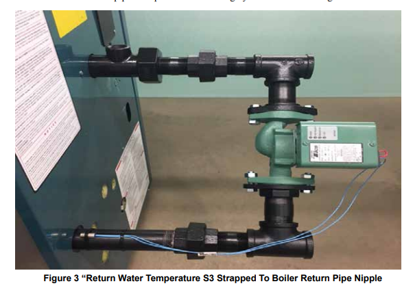

    2. Either way, does anyone have an opinion on whether I should ask them to include the "boiler by-pass kit" in the quote?
      1. https://s3-us-west-2.amazonaws.com/catsy.782/System+Bypass+Circulator+Kit+Instructions.pdf
