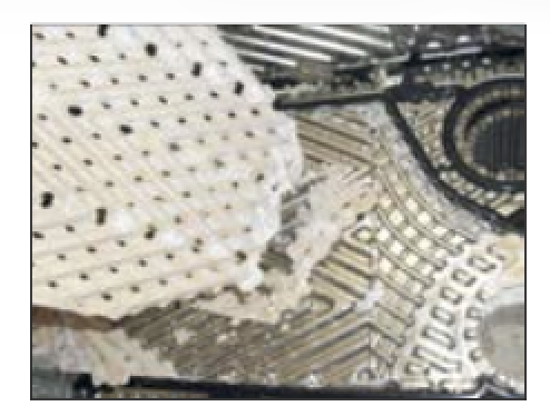

    Here is an example of limescale and a plate hx.

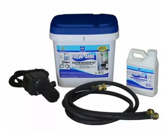

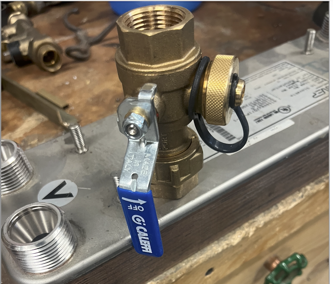

    A simple cleaning method is install a flush ball valve on each port. Then connect one of the descaler kits and pump it for an hour. No need to disconnect, loose fluid or pressure this way.
    Screenshot 2026-05-14 at 8.05.00 PM.png Screenshot 2026-05-14 at 8.05.52 PM.png

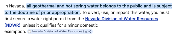

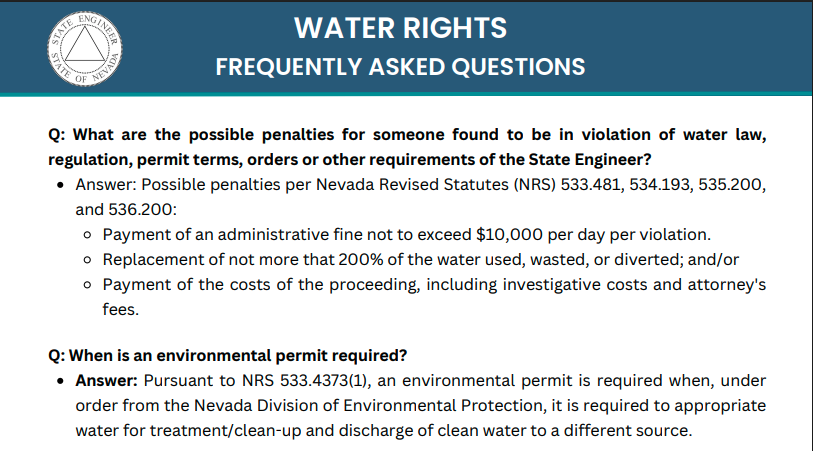

    hot_rod Member Posts: 27,806
    Readily available information, possibly you qualify for a minor domestic exempotion, worth a phone call.
    Screenshot 2026-05-15 at 8.14.25 PM.png Screenshot 2026-05-15 at 8.15.33 PM.png
    https://water.nv.gov/uploads/water-rights-docs/Water_Rights_FAQs_Final.pdf

    I know there is private use of geothermal water in Utah and Colorado, you just need to apply for the proper permits. The State DNR decides if you are able to get a permit.
    Nevada reads like there is a minor domestic exemption available.
    The DNR in Utah is helpful with their phone support. At some point they suggest you retain a water rights attorney, for legal questions, however.
    There are water shares and water rights, typically. Sometimes water shares come with the property but they can be bought and sold, they are similar to a stock certificate. Once you have shares you can have access to water. If it is available to the property.
