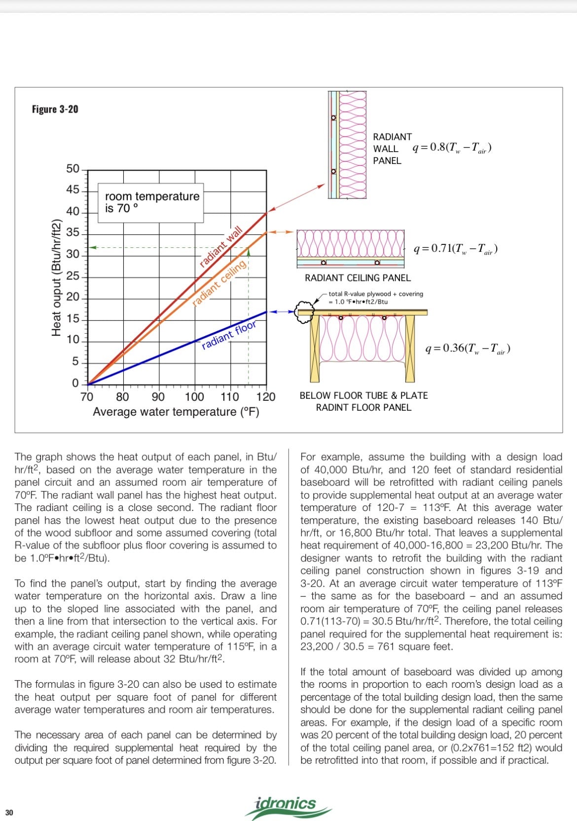

    The only type of system which offers any hope is radiant floors or ceilings — or more likely, both. You need to have a very clear idea as to how much heat is required to heat your house, and that means doing a careful and thorough heat loss calculation. Then you can begin to wonder if you can meet that heating load with water at that temperature — and, not irrelevant, if you have enough water available. You may find that you need essentially all of the floor and ceiling surface to be heated. You may also find that you will need 20 plus gpm of flow, 24/7 , to maintain the temperature — 30,000 gallons per day. Do you have rights to that much water?

    This graph shows some common retrofit options and expected btu/ ft output. Radiant walls are about the high output, and you have a lot if surface area availade
    Running that water through a plate HX you would only loose a few degrees, do call it 88 degree supply water
    A hp adds a lot of cost to boost maybe 10-15 degrees

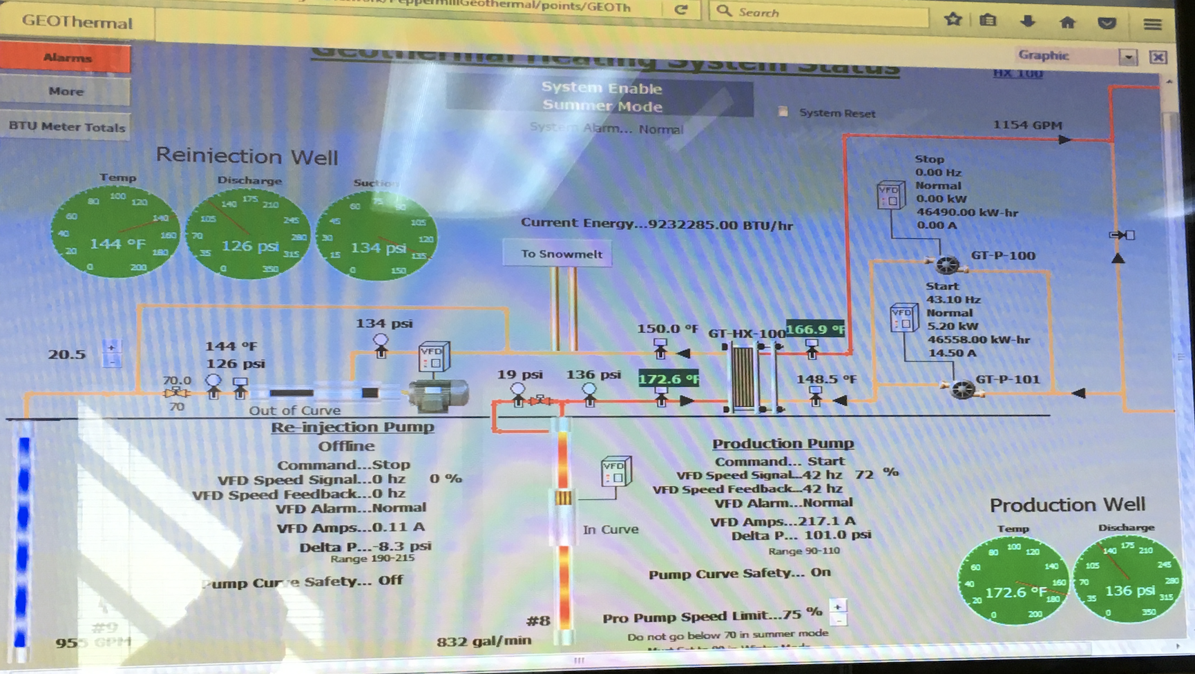

    I visited the Peppermill in Reno a few years back and got a tour of their geothermal system which heats and provides DHW for the entire resort, 2.1 million feet of space. They pump and dump.
    One pump pulling 176° F from the well, another discharge to help pump back down a well across the property.

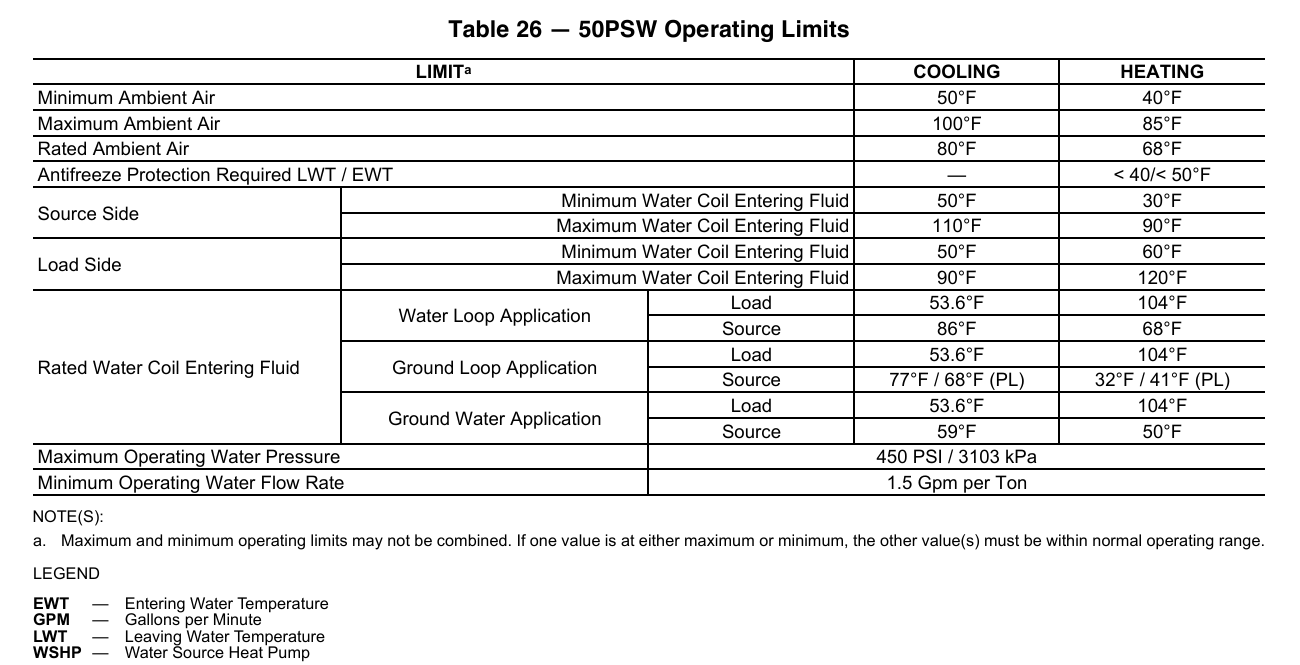

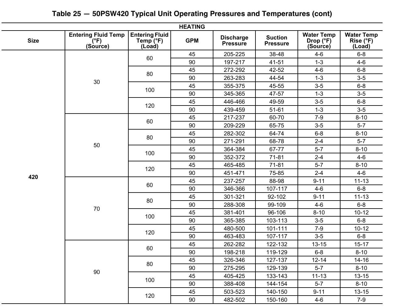

    Just use a water-to-water heat pump if you have the flow. Carrier's 50PSW is a good place to start. To quote from the installation manual: "
    Ground Coupled, Closed Loop and Plate frame
    Heat Exchanger Well Systems
    These systems allow water temperatures from 30°F to 110°F. The
    external loop field is divided up into a 2 in. polyethylene supply
    and return lines. Each line has valves connected in such a way that
    upon system start-up, each line can be isolated for flushing using
    only the system pumps. Air separation should be located in the
    piping system prior to the fluid re-entering the loop field"
    So you should be able to get a 120 degree temperature, that should be fine for a hydro air system to provide heating PROVIDING you have flow. And of course a permit to reduce the geothermal temperature. As others have pointed out you will need a heat exchanger to keep the water streams separate and be able to clean the scale on the geothermal side, but not a big deal so figure 3F drop and some added pumps (source temperature would be 87F - still within the operating range.
