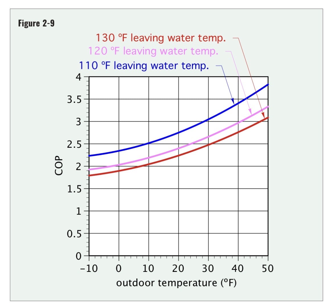

    hot_rod Posts: 28,524
    if you could heat with130 degree water on a 0 day you are still running 2 COP. 80% of the heat season you will get above 2 COP
    For every quantity of energy in, you get two out
    If you know oil and delivered electricity cost, go here, use 200% for geo hp efficiency
    https://coalpail.com/fuel-comparison-calculator-home-heating

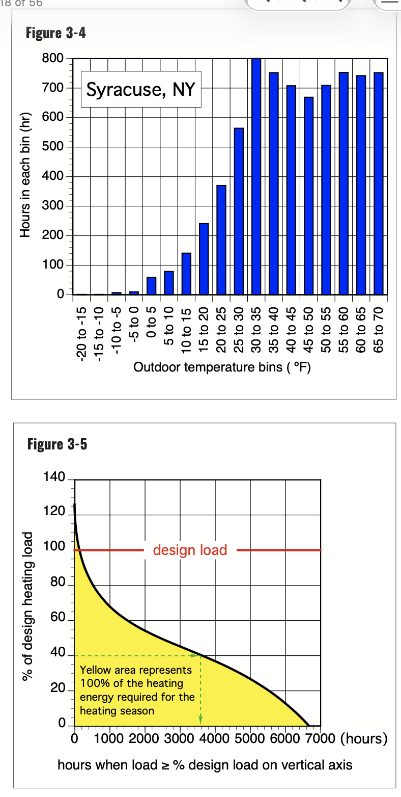

    Are you on PSGE? These seem like reasonable rates. Compared to some NE areas at .30 per kwh
    You need to crunch numbers, for power costs, loads temperatures, etc.
    A graph like this helps show how often you ate at various temperatures., If Syracuse is a design of 5°, less than 100 hours a year is it at that temperature with 30- 35° the largest % of the year. Putting COP over 2.5.
    The Idronics I link you to will help with economics also. If in fact you are unddr .20 per kwh, a HP may make sense if you can work within it's output tempeature range.
    I've lived wit an air to air HP for 5 years now, I hate it in heating mode. As Jamie mentioned it blows luke warm air. I miss my hydronics dearly.
