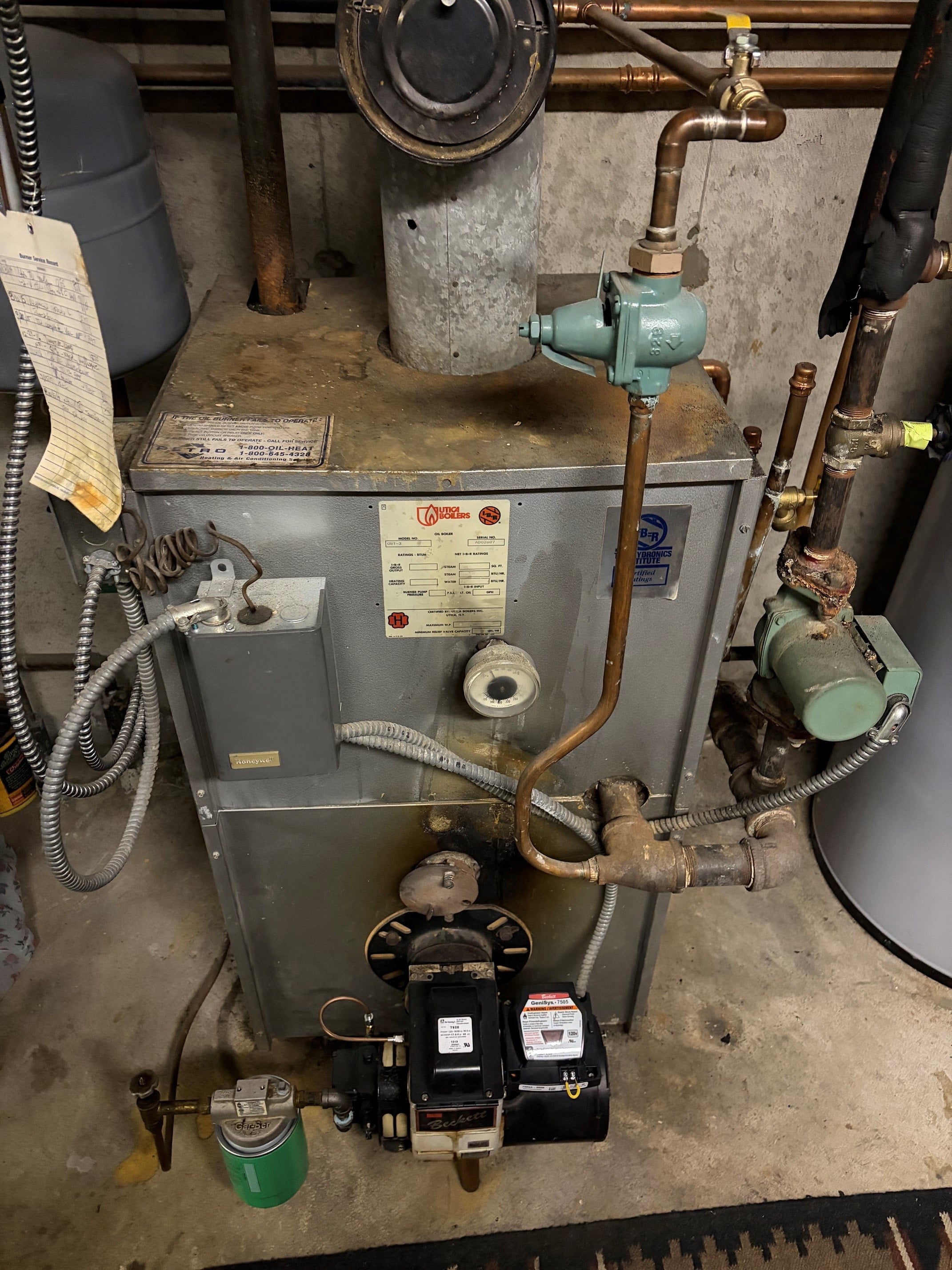

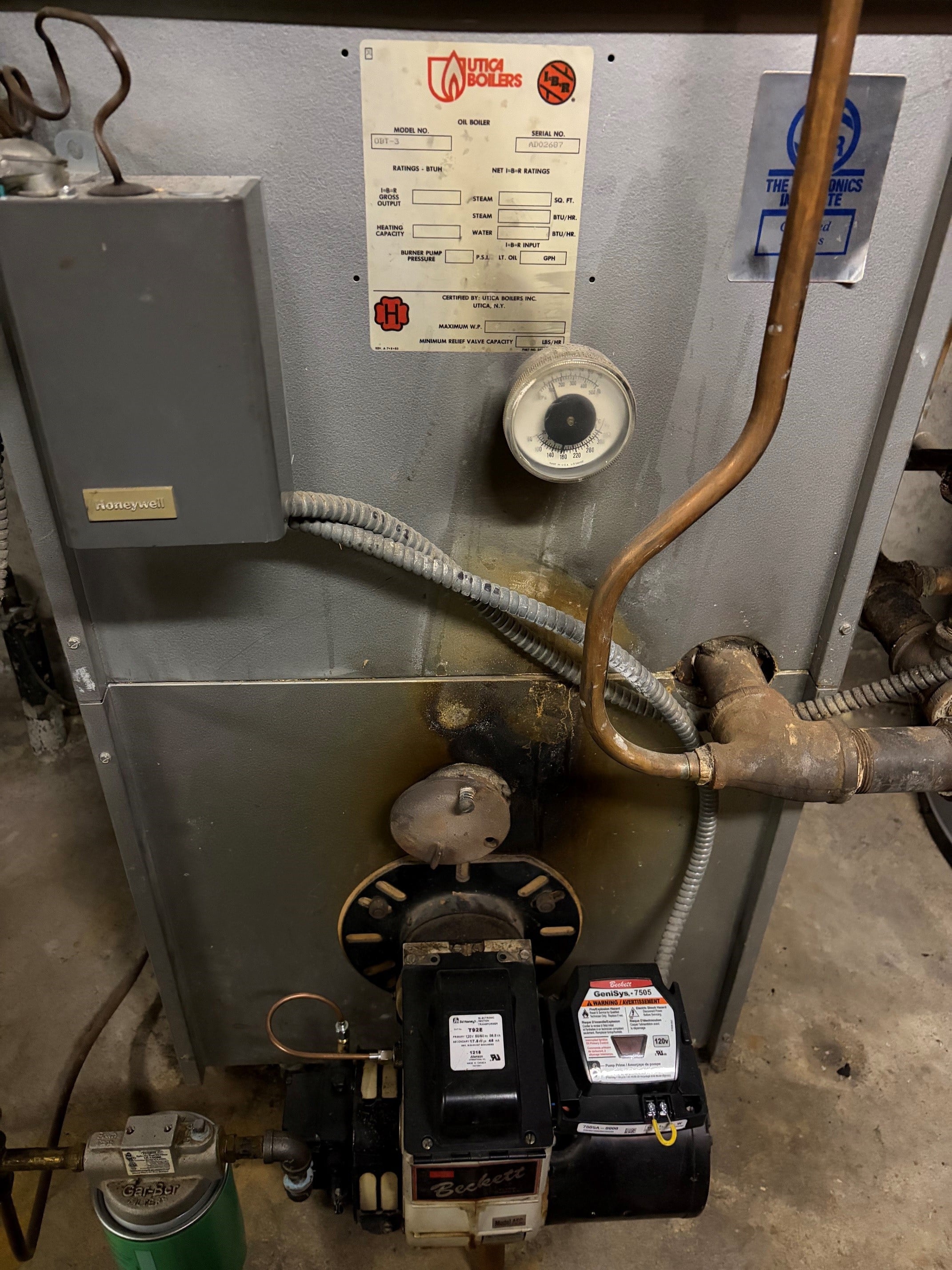

    @Steamhead: ah, you found some old dialogue, that could be helpful, thanks. Some photos attached.

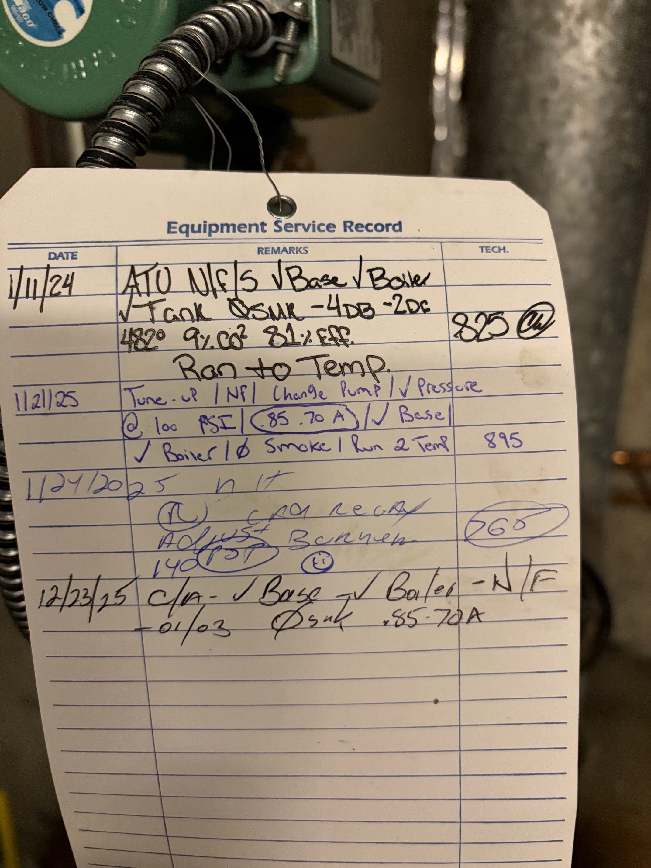

    My oil company comes every year for an annual tune-up, but besides trying to ensure that they don't let the tank get too empty before they make the next delivery, I don't need to do anything else. Which I like! And honestly that could be a factor in deciding if I want to go to heat pumps, which would require more maintenance.
    Last tune-up efficiency was at 80% but I have no additional info. I was told that this particular boiler tended to burn through in the rear of the unit but there's no discoloration in back like you see in front.
    I included recent service notes in case you're able to interpret them.
    @hot_rod: I did do a manual-J with Dana's assistance, and that, as well as a dealers calculation based on my oil usage all point to ~2 tons, though Dana suggested that with some insulation/ sealing enhancements I could possibly look at 1.5 tons.
    I was recently introduced to a New Yorker boiler which I believe produced 80 Kbtu, which is unfortunately as low as I'm probably going to find. Feel free to suggest any lower-output high quality boilers you might like.
    BTW: any idea what the output of my Utica is?

    That Utica is a "dry base boiler" meaning the water jacket does not surround the flame. If the oil company services, it properly and makes sure the combustion chamber is in good condition you will not have a burn through.

    Definitely not a 3-pass, which is the best design for oil.
    My SWAG on that boiler works out to a Net rating of about 80,000 BTU per hour.
    If I were going to put a New Yorker in that house I'd look at the CI-HGS-74E. This is a 3-pass cast-iron boiler that is very easy to maintain, and is more efficient than a steel dry-base boiler or a pin-type wet-base type. Its Net rating (what is assumed to be available at the radiators after deducting a standard pickup factor) is 64,000 BTU per hour. Go here:

    Retired last year, not sure if I'm here forever or will move west where my daughter is.
    PS: met with a rep from an HVAC co, he took ~6 minutes to perform a manual-J and was not familiar with air-to-water (I don't think they're used much in this area). My guess is that in order to get the whole-house rebate from PSEG I'd have to install more heat pump capacity than I need, effectively eliminating any savings…just a guess. He also suggested the deep cleaning involving coils and blower wheel is only needed every couple of years.

    Supposedly the once-a-year tuneup/checkup by the oil co covers the boiler's needs, but when they're in and out in under 1/2 hour maybe there's more that could've been done.
    It does look like A2WHP requires additional components and could be $$, and it was suggested that it was more appropriate for larger, more complex homes.
    If the oil company is in and out in half an hour they are not doing anything but a nozzle and filter change…..if that.
