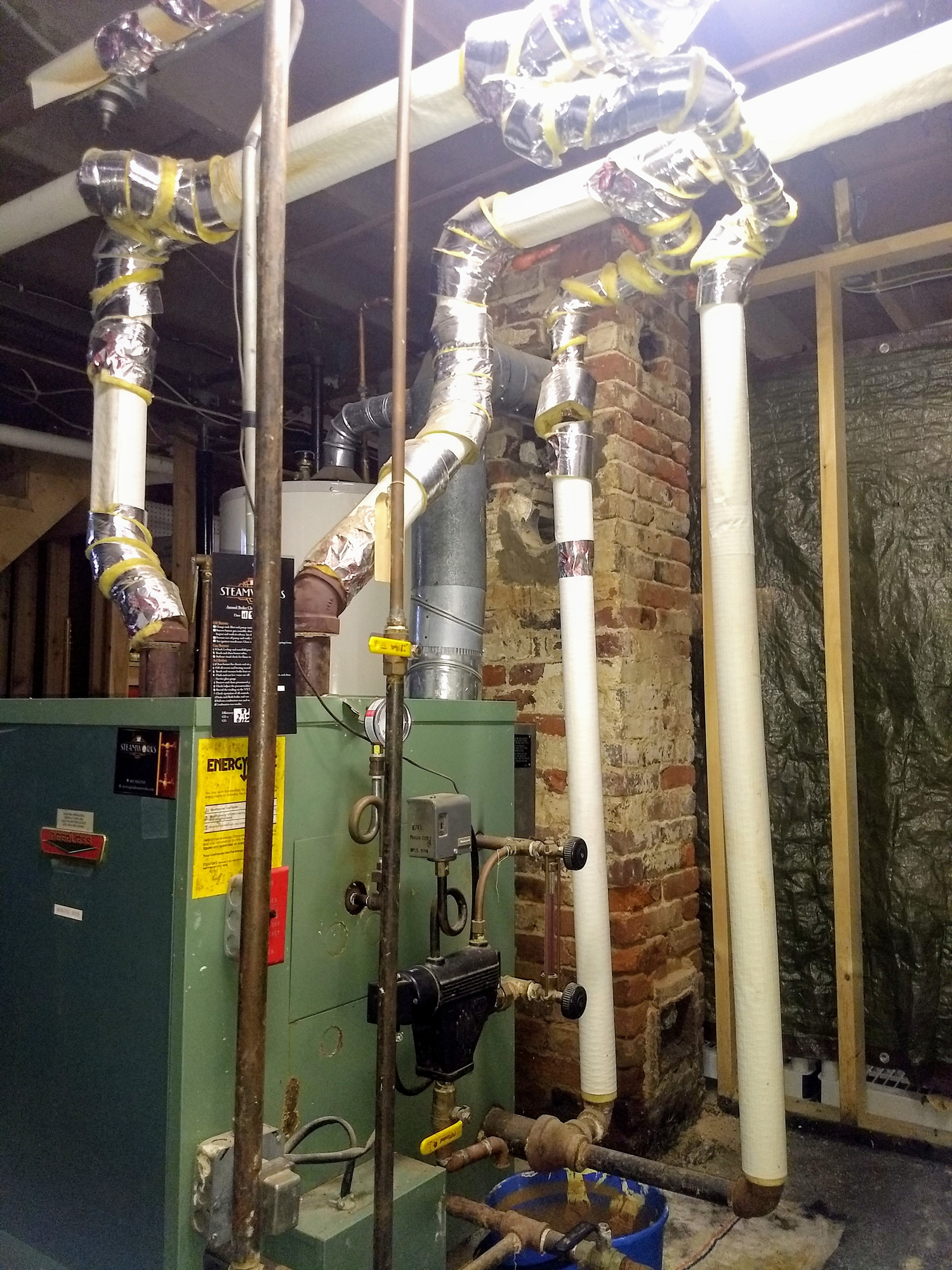

  • AdmiralYoda
    AdmiralYoda Member Posts: 793
    Have you guys been sneaking into my basement? It sounds like you're describing my boiler! 45 year old Peerless that is way oversized. No header, no equalizer, no hartford loop.
    I've contemplated re-piping it myself multiple times but I'm not sure if it is worth the effort. The system works pretty good and doesn't give me much trouble. Would I have dryer steam? Maybe. Would the system heat up quicker? Maybe. Would I save some fuel? Maybe. Would I damage the 45 year old boiler trying to take apart the old pipes? Maybe.
    Two risers. Each one goes to its own main. No equalizer, no header. Single pipe counterflow. System works great!

    ethicalpaul Member Posts: 8,742
    edited March 16
    No.
    Did you watch my video? My system now looks like yours 😂

  • AdmiralYoda
    @ethicalpaul That is an old picture but I've installed a vaporstat as the primary pressure control with the pressuretrol being the backup. 16oz cut-out and about 4oz cut in. It does cycle on pressure during long calls for heat due to being oversized but I'm fine with that.
    I've reduced the cut-out down to 10oz and the system works just fine but it cycles a lot which annoys me.
