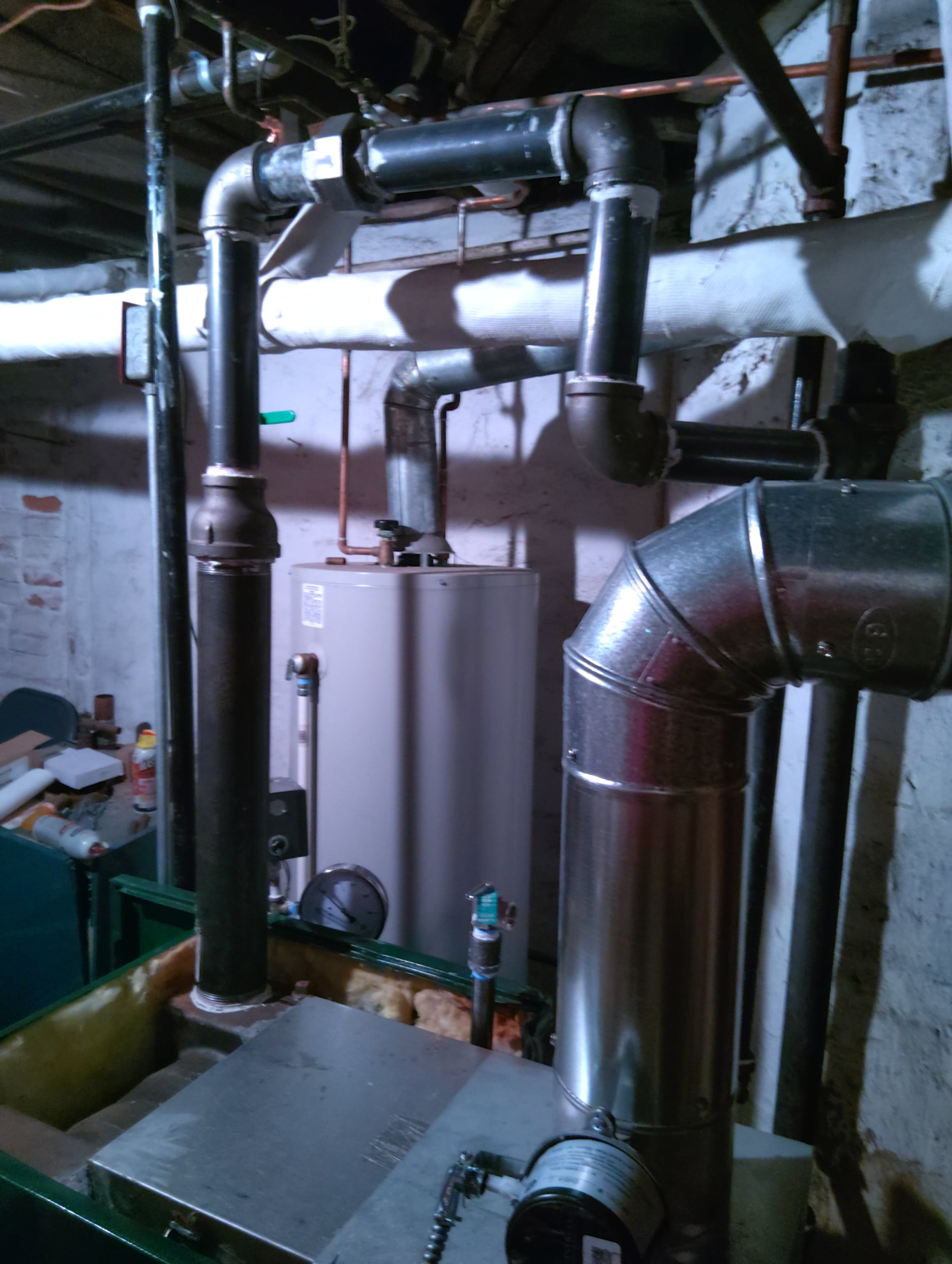

  • WilliamGwiazdowski
    WilliamGwiazdowski Posts: 168
    edited March 19
    This setup has been working at my place for close to 30 years now, current boiler was installed October 1998. No Hartford loop, water line is probably way too low for the boiler return trap to work but it works. I have about 98% of the original insulation on the pipes which helps as well. System heats the house perfectly fine and evenly.
    PC7060
    ethicalpaul Posts: 9,035
    Love that giant, high original header
    PC7060Long Beach Ed
  • Thank you !! I would imagine that the steam leaving to go to the front of the house and the back of the house by the time it goes through that high riser coming off the boiler and the massive header is fairly dry!
    As dry as any other steam created by a low-pressure residential boiler!
