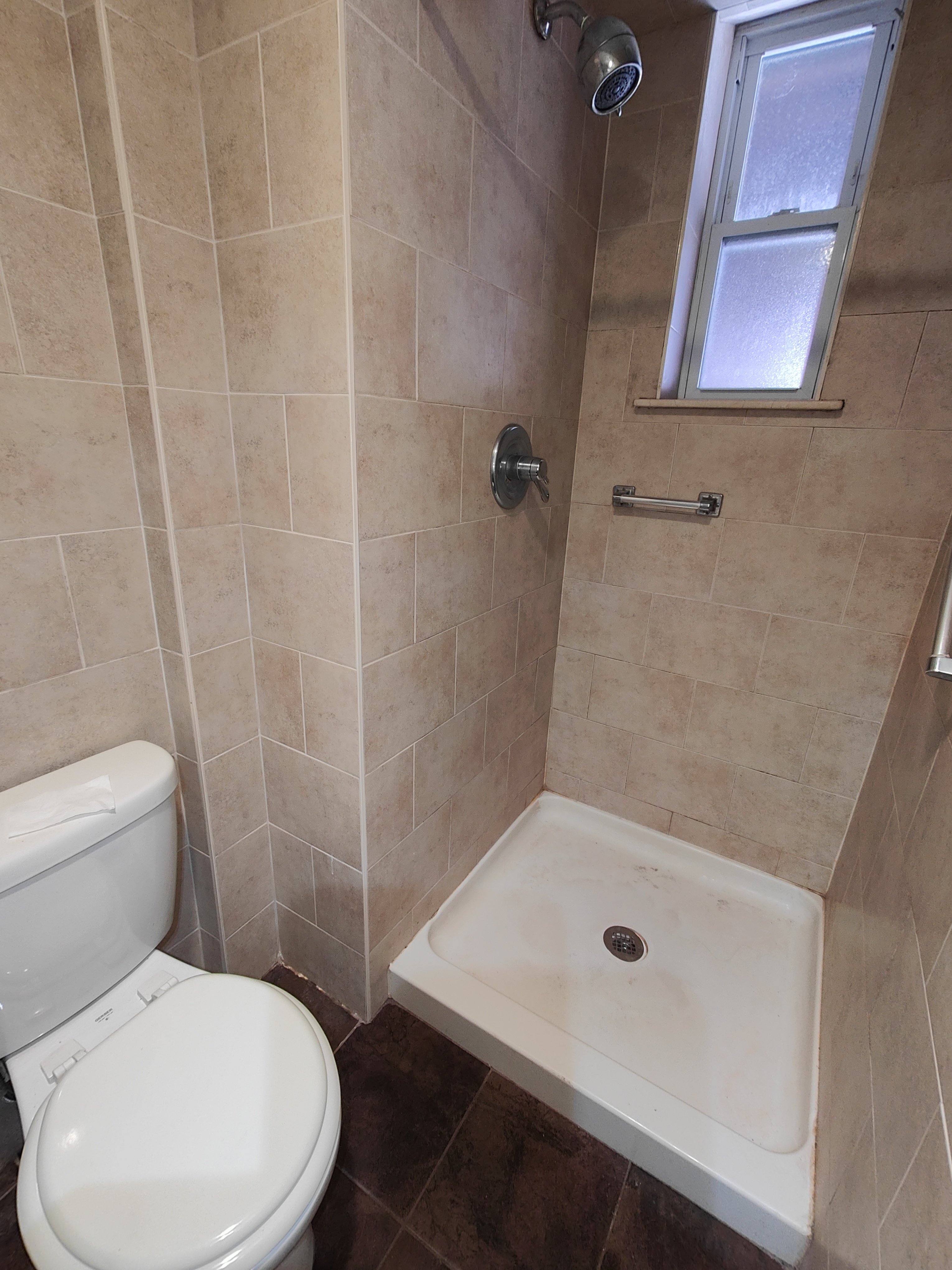

near toilet floor constantly wet

That bottom of that loop is dry.
The tissue paper that I placed underside did not register any dripping dents either

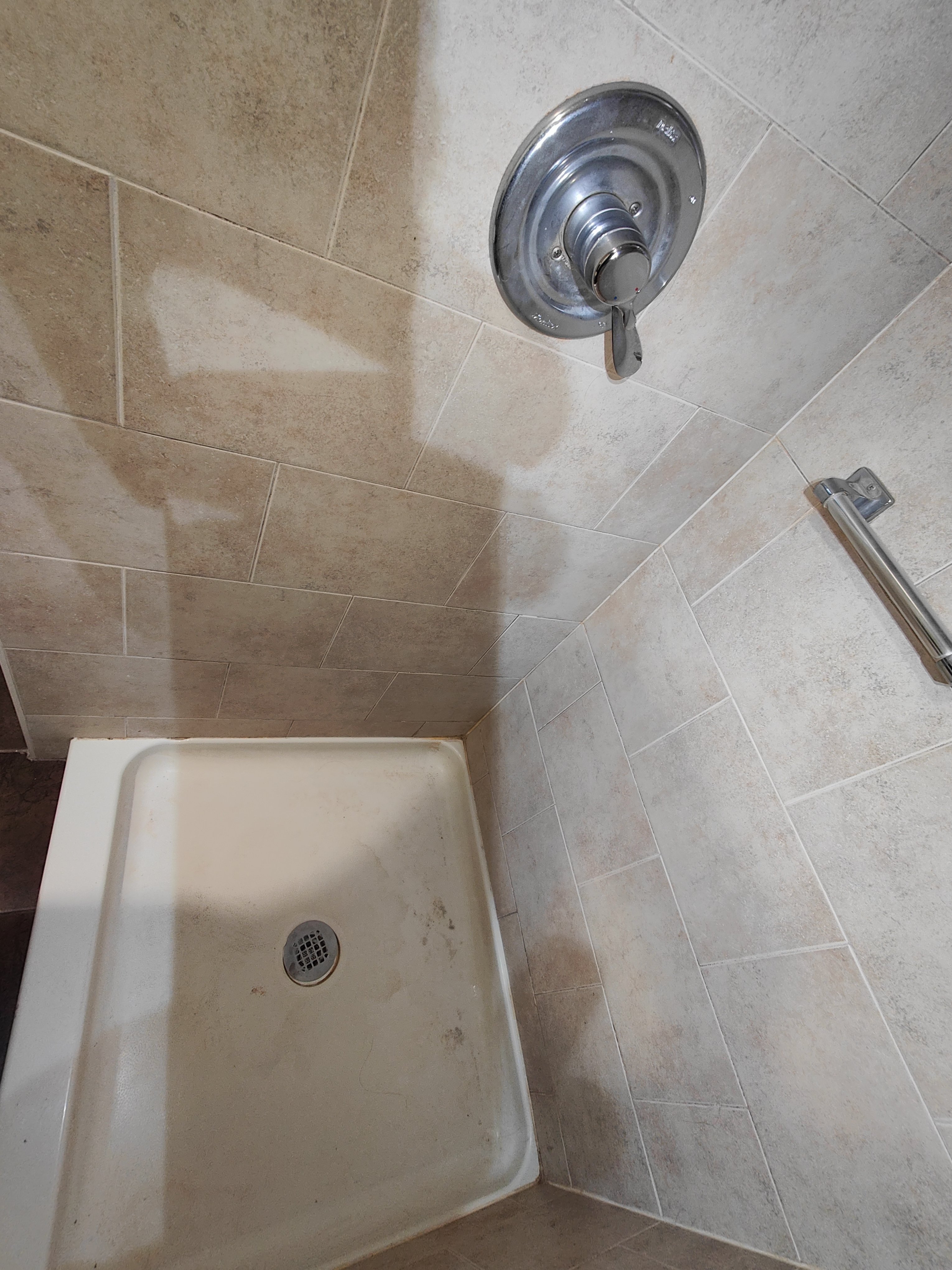

This is the shower stall.
But the leak source seems to be closer to the back wall than to the shower valve
This is the basement level, so not roof leak
Is the shower in regular use or just idle? If it's in use, avoid using it for a while like @MikeL_2 suggests and see if the water dries up
It would also be worth popping the shower handle escutcheon off and seeing if you can see any visible leaks from the shower handle body
1 -
It is vacant for months. Shower and toilet both are in idle. Water is shut off at the meter.
The shower water supply and valve is not particularly close to the water stain. This has left me confused.

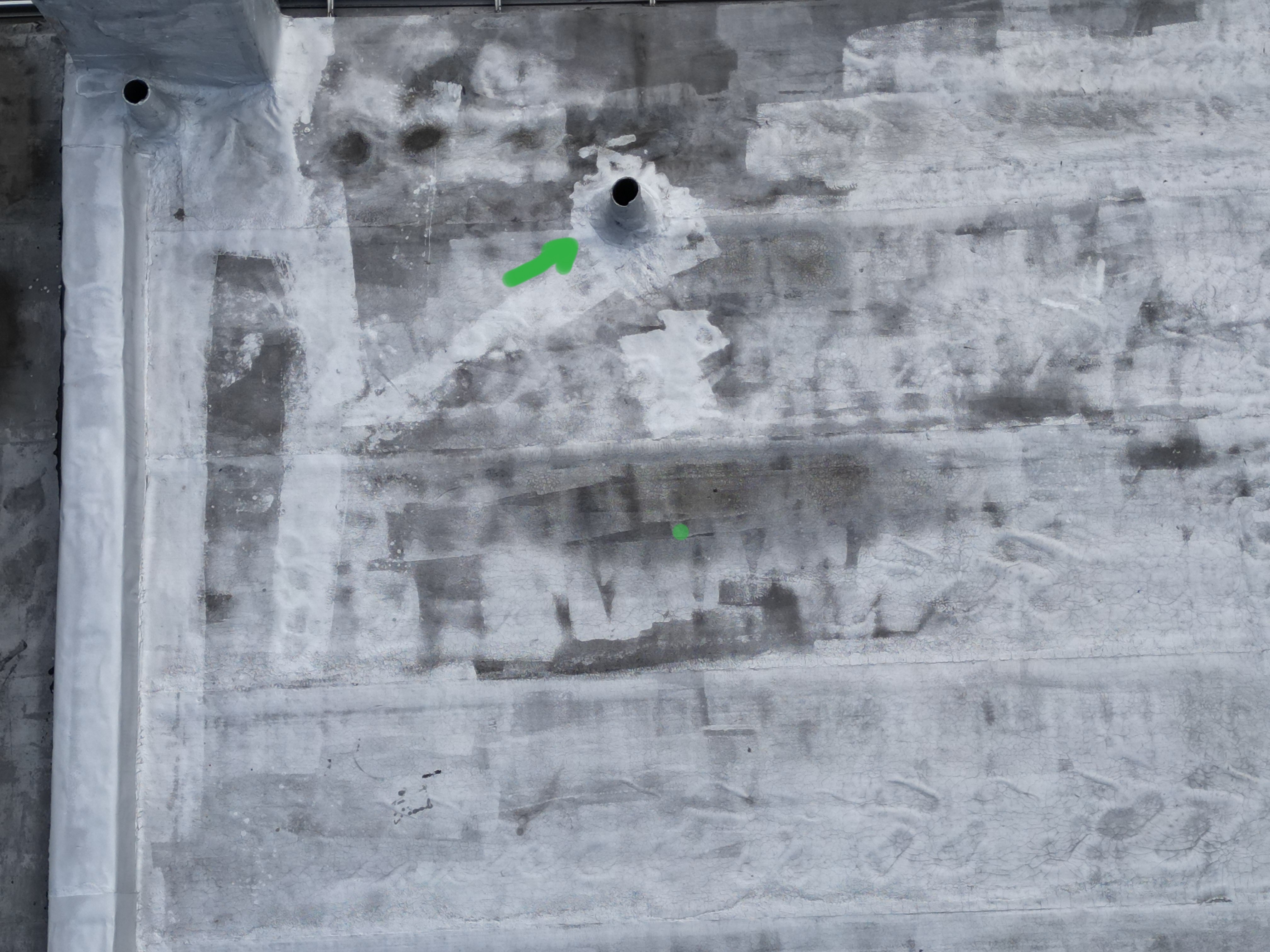

is the stack vent in that wet wall? roof leak coming down the outside of the vent?
known to beat dead horses0 -
The vent area in the roof is still in good condition
If nothing else is found as mentioned. The next thing is to look in the wall.
@pumpcontrolguy makes a very good suggestion. Removing the escutcheon from the shower valve and looking and listening inside the wall is a great idea.
The water could be tracking down from the vent stack or the buildings framing regardless as to how well it may look.
Since the bathroom is not being used as you mention, water can be tracking from a leak other than the fixture where the leak appears. Keep note of when it rains. I had a similar leak that came from outside and was delayed in showing itself. Use a garden hose and spray the suspected area(s) and take note of what happens and or how long the leak reappears.

Flat roofs are like swimming pools. The membrane can get damaged and cause all sorts of leaks.
One guy years ago and new to the trade, said he drilled a hole in a flat roof from below and instantly regretted it. Draining the roof into the building was not his intention. Yikes!!
If water seeps through the vent hole along the stack, it usually leaves water stain on the ceiling or walls on the top wall. Currently there are no water stains on the top floor
I had a leak that was running down the vent pipe to the first floor, across a joist and leaking out of a door crack. Later on, it moved and leaked out of a baseboard, no traces up higher at all.
After fixing it, it re-appeared 10 years later leaking across the 2nd floor ceiling in a totally new location.
Got stuck at this step when I disassemble the shower handle
The shower handle assembly is supposed to slide off at this step, then the trim sleeve can be removed to reveal the cartridge. But the handle does not slide off. Is there a puller designed to pull it off?
did you remove all the screws or setscrews? a lot of delta products with that style handle have a setscrew in the side somewhere. the cartridge itself is plastic so once all the fasteners are out it should just pull off with some wiggling.
there is not a set screw.
they have a tutorial video, 2:45 is a similar faucet model to mine
the one in the video has a setscrew
Sometimes the setscrews are hidden under a little plug, so maybe check for that.
But if there's really not one and/or you've already removed it having difficulty the handles can also get stuck in place with mineral deposits. spraying inside that assembly with CLR or vinegar then letting it sit for a bit can help in that case as it can help break those deposits free
If you watch that video from 2:40, that model does not have a set screw on the handle
It seems the handle is welded to that gear tip of the cartridge assembly by crude
I have kroil. Is kroil suitable to apply ?
if all the fasteners are out some wiggling and pulling will get it free, metal doesn't seize to plastic.
you could also put a socket or piece of pipe or tubing against the end of the broach between the center stem and the broaching and use a handle puller or something similar to press it off
kroil probably wouldn't be super useful here. The CLR or Vinegar are acidic to help break down calcium or such that has deposited between the handle and the cartridge.
Sometimes you just need a little brute force. A slide hammer puller can be handy for something like this
