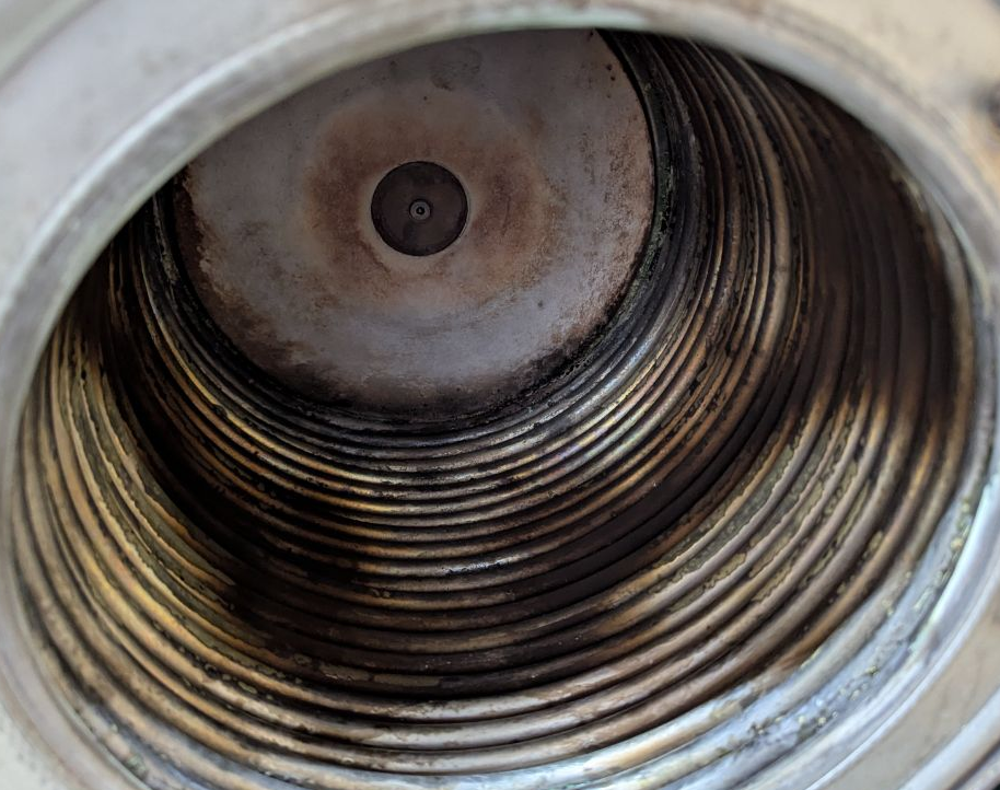

It looks (to me) like tech #1 did a thorough cleaning down into the "grooves" This picture is of the bottom of the chamber (phone in the chamber facing down)
and here is a zoom in:
I ran a piece of sheet styrene I had in some of the grooves and I didn't seem to hit or dislodge anything. I'll vac and wipe down the chamber and vac the burner anyhow. Tech I trust said just a damp (water) microfiber
The swirl plate looks ok to me. I'll take a closer look. I guess I am looking for a deformation or, say tear, or something?
So, here is where I am at (to the best of my ability) - controls and igniter/flame sensor are ok, high temp sensor ok, chamber seems ok, 120vac seen at the gas valve, swirl plate looks ok (but I'll look closer).
That leaves the gas valve and that funky pressure on the boiler side of the valve.
Tomorrow the "tech I trust" will be coming by to start to design the next system and I am sure he will take a look. I'll ask him to retest the pressure and I think he will want to do a combustion analysis.
and we go from there. That first shower in our own shower is going to be glorious once up and running 😍🤞
Swirl plate looks ok.

I agree the swirl plate looks cracked, what I wonder it that is enough to upset it. kind of makes me wonder if a thin layer of epoxy on both sides for a test would work. I wonder if the crack gets wider with the inducer blower running.

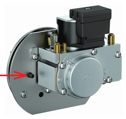

In the picture with the vent pipe, I don't see any port drilled and plugged like the manual shows. Although there is some stuff in the way. Kind of wonder if it was ever done.

You need a new swirl plates as that crack will open when running. I'm certain that is your issue. The control chase is a red herring. This needs replacing anyway because you don't throw that back in an expect it to work. Peerless has a parts supplier online that you can get ship right away.

May not be a crack in the swirler.
@109A_5 Yes I have seen Pine Hollow. They have worked together on occasion
Looks like a crack to me, it looks like it is on both sides, anyway it should be verified. I'd try epoxy as a test before I spent any more money on parts, etc.

Apparently that cracking is a known issue, however the cause is maybe unknown, at least in 2015. @Redrum you may find the post interesting.
Some folks feel it is worse with LP.
https://forum.heatinghelp.com/discussion/comment/1384524
One Pipe System0 -
More carnage:
From back in 2011:
Did some checking with HTP about "swirl plate" problems here is their comment:
I believe pre mature failure is due to two reasons:
The back draft of flue gases from venting system through heat exchanger and back out through swirl plate. The spent flue gases contain a great deal of corrosive condensate. The fix we used was to increase post purge on fan to clear all spent flue gases from venting system.
Another cause can be recirculation of flue gasses entering the cabinet and being drawn into swirl plate. Same material just from another direction.
About two years ago the manufacturer of the swirl plates changed what they are made of. They switched to Poly Propylene a more durable product that can also take higher temperatures. Swirl plates made of this newer material can be identified by the letters PP under the triangle on the back side of swirl plate.

The pictures of the inside of the boiler look good, it's nice and clean. If I was working on it I would replace the swirl plate and check the venting before doing the combustion analysis. I've seen boilers with similar problems where the venting was the root of the problem. Exhaust recirculation due to the intake and exhaust pipes not having the required horizontal and vertical separation.

@109A_5 - I can't control where the test port was drilled, it came with the house 😉. Noted.
Also, 109, and the rest of you. I'll delve into the swirl plate more today, @pedmec , I hope that you are right, I'll pay a hundred easy for heat and hot water, in fact I'll pay…..
I zoomed in on the photo:
As I mentioned the "tech I trust" I have known for quite a while and he is big time into hydronics, AC, etc, and being an engineer, I appreciate when he talks the science of what and why. I may not understand exactly what he is saying in terms of the specifics as it relates to this, but I know it's not BS because I understand enough of the science to recognize BS. I'll see him today. I asked if he could perform gas valve measurements and a combustion analysis, but the main reason he is coming is for the new design.
I will mention the swirl plate to him, and we may take it out. If he doesn't, I will and get back to you, but I am betting he'll perk up when I show him. Edit - just spoke with him via text, he said "that'll do it". We are checking to see if we can get one locally (ERB supply in Buffalo). I don't mind this part, even if it's not the fix, it's broke and needs replacing.
I had it in my hands and it didn't feel like PP (I spent some time in plastic molding industry). It had more of a nylon look. PP is recycle number 5 ans the triangle is empty (see pic)

"I can't control where the test port was drilled, it came with the house 😉. Noted."
I understand you can't control when someone does it incorrectly and before your time there. This is correctable just drill another hole where the manufacture states.

both the "coffee grounds" in the heat exchanger and the swirl plate deterioration are both signs of flue gas re circ. Id look at the venting and make sure its correct.
So, here is an update, good news, almost, well, not really.
My tech (I trust) found a swirl plate locally, and the supplier tagged it for us just before it was going to get shipped out of state. They gave preference to an account holder (my tech). Turns out that Peerless told the sales rep they won't have any new ones until Feb, March. That jives with supply house. To me that is a head shaker that a manufacturer can't make sure parts that are prone to fail are available.
We installed it, and it fixed the A01 Ignition failure error (so it was definitely a factor). But, the flame extinguishes after, say, 20-30 seconds (instead of 2-3), causing an A02 Flame Failure. So, the benji for a plastic molded part got me a step further. I can read real good readings on the flame sensor in the installer menu where there were zeros before.

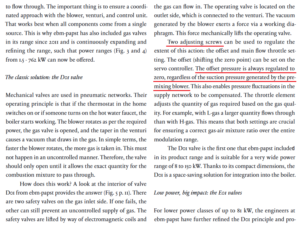

We could not get the outlet pressure to zero, it would climb to 3,4,5 during the flame period. He tried adjusting the valve, but it didn't seem to make a difference. So, we took apart the swirl, valve, and inspected the Orifice. Looked ok, except that there were a couple of what looked like hair we pulled out, might have been teflon from upstream piping.
He hooked up his combustion analyzer and struggled with that as well. First, the boiler only ran for 20-30 seconds at a time, and second, no adjustments could get the CO2 down. He was not pleased that he could not solve it.
He said that all recirculation was supposed to be off, so we did that, and "tea kettled" (new phrase for me), the boiler PR. At least we got to see the water color 😒. So, the rest of the test had to be done with the circulator on feeding the indirect.
All his adjustments were with the throttle screw.

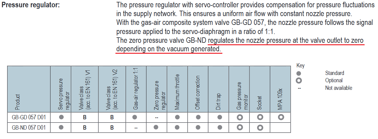

Failure to obtain negative pressure after adjusting the throttle sounds like there’s an obstruction somewhere, from the burner, through the heat exchanger, and then through the vent pipe.
It’s either that or the regulator in the gas valve is off.
Try temporarily firing the boiler with the vent pipe disconnected after you’ve visually confirmed that there’s no blockage in the pipe.

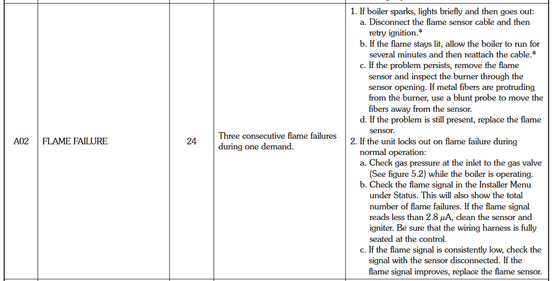

c) @109A_5 - Yes, we went through section 1 of the AO2 flame failure. Disconnecting did not allow it to stay lit, so - 1c) I had just had the burner out, and measured the gap between the igniter and flame sensors to the burner and both were in spec. Also, it was clean, no metal fibers, and, the flame sensor is brand new.
The burner mesh was cleaned (shop vac'ed) by me, and it looked clean, but what do I know? There was no visable build up and the holes looked open. Plus, Tech #1 must have cleaned it when he cleaned the chamber.

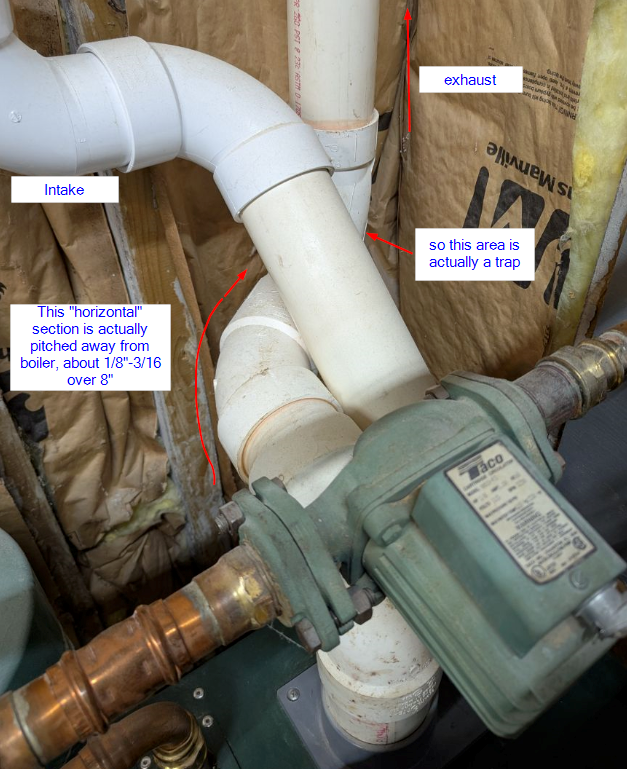

e) @Ironman - I'll take a look at the vent path you describe. I'll need to figure out the exhaust travel past combustion, as I don't know it, I am sure I can find it on the web.

The exhaust piping which appears to have a horizontal section, should be pitched toward boiler. It's not, it's pitched away as described.
Another thing I would try (if it has not been), if the house / boiler room is rather air tight, the majority of the combustion intake air will still come through the boiler's air intake even with the cover off. As a test I would intentionally block off the boiler's air intake and open the closest window or door from outdoors to the boiler (complete air path) and see if it changes anything when the boiler tries to ramp up to 100%.
Picture(s) of the intake and vent pipes outdoors ? Any bushes or other obstructions in the area ?

https://www.ebmpapst.com/content/dam/ebm-papst/loc/europe/gb/tech-mag/techmag%2001-22.pdf

I opened the combustion chamber again, and poured water between the exchangers, and saw the same/similar amount of water drain to the condensate tank. I could not figure out how to these the other condensate pipe but I guess I could just pour water in the exhaust vent.
But I noticed the previously cleaned chamber was quite blackened, perhaps because the tech was adjusting the gas valve. However, tech 1 cleaned it and it was shiny. I ran it for a month, it failed, but when I opened it, still shiny. After yesterdays work with tech it looks like this
Second, I wanted to check the vents as best as I could. I disconnected the exhaust at the fernco, and ran a plumbers snake from the outside to the fernco - it was clean. I found that the intake piping was just press fit in one spot, as it pulled apart. So I attempted to remove the fitting plate for both on the top of the boiler, but quit because it seemed like the exhaust side was in some type of gasket. I looked at the parts diagram and it looked like it had a tail, and I wondered if I could pull it out before hitting the motor above. So I chickened out. I checked the inlet venting all the way through, it's clean.
Outside, I'll get a pic when I go outside. But basically it's wide open (trees and bushes no closer than say 8'). The in vent is a PVC Tee with screens in top and bottom, the exhaust is a PVC horizontal pipe, maybe 4-6' long with a 45 turning down, also screened. Both seem to be above a reasonable snow level.
@HVACNUT - I am sure peerless does, the question is what the number is? My tech is going to call his local distributor who is a peerless dealer to try to get the number.
@109A_5 - thanks for the link from the gas valve manufacturer. I'll send it on to my tech. I know that the offset had a "do not adjust without the proper equipment!" flag in the manual.
As for your comment about blocking the input, will do. The house is very tight, it is a timber frame with SIP panels, and I have a HRV (which I have running 20on/40off). It was built with efficiency in mind (for 2001).
Which reminds me, I should be able to just run the HRV and close the intake vent, right? The HRV will provide the outside air. What will I learn from this?

Looking at the gas valve cut away view it looks like there should be no gas flow without inducer blower draft (vacuum) at the gas valve outlet.
Gas valve cut away view.
https://www.techritecontrols.com.au/cms/uploads/Techrite-Controls-Ebm-Papst-Ebm-Papst-Gb-055-Wnd-D01-Whirlwind-Valve-1199.pdf
" We could not get the outlet pressure to zero, it would climb to 3,4,5 during the flame period. He tried adjusting the valve, but it didn't seem to make a difference. So, we took apart the swirl, valve, and inspected the Orifice. Looked ok, except that there were a couple of what looked like hair we pulled out, might have been teflon from upstream piping. "
Looking at some of the data sheets the offset correction (Servo pressure regulator) seems very small, but that may be dynamic. So I wonder if that adjustment is capable of adjusting out a static 3 to 5 Inches of Water Column offset.
If in fact it only just puts a slight bias on the metering of the main operating valve and can't adjust out 3 to 5 Inches of Water Column, i'm starting to think the gas valve has an issue. Like the main operating valve leaking or not seating properly due to contamination causing it to leak or not regulate properly. Causing the boiler to run rich.
They don't really state at what vacuum levels the zero pressures happen at. And how would the vacuum be measured any how ? Some inducers have a sampling port.

Kind of wondering if this is a test port (inducer / venting performance), or maybe it is Top Secret.
