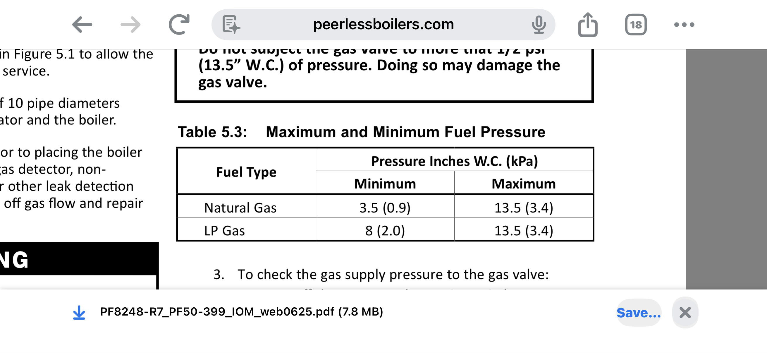

    When the tech was there, was a combustion test done? Gas pressure tested? The display shows flame rectification.

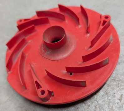

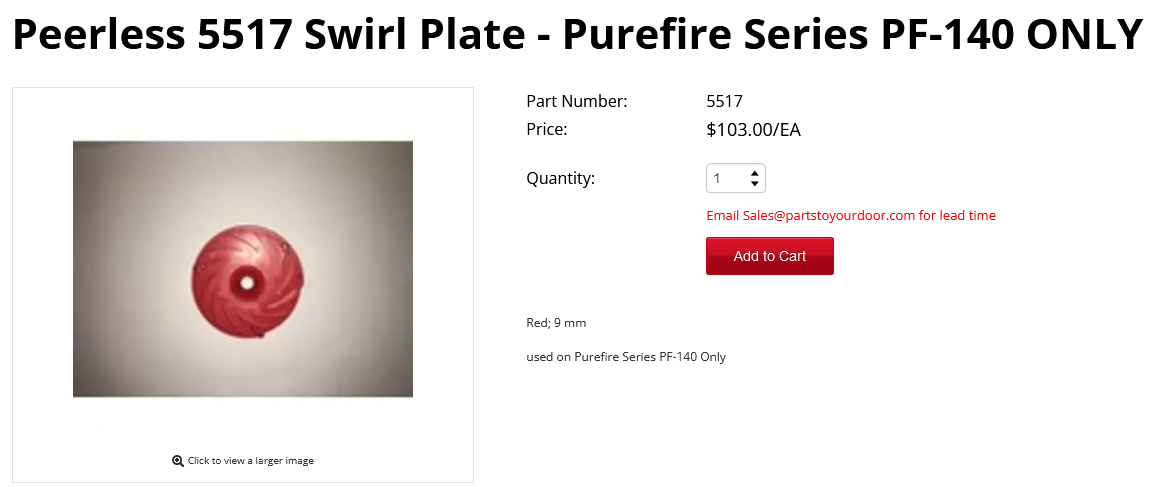

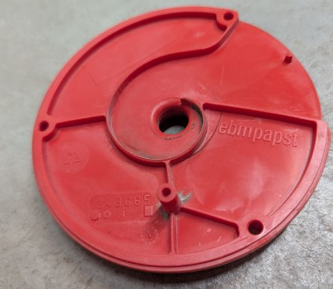

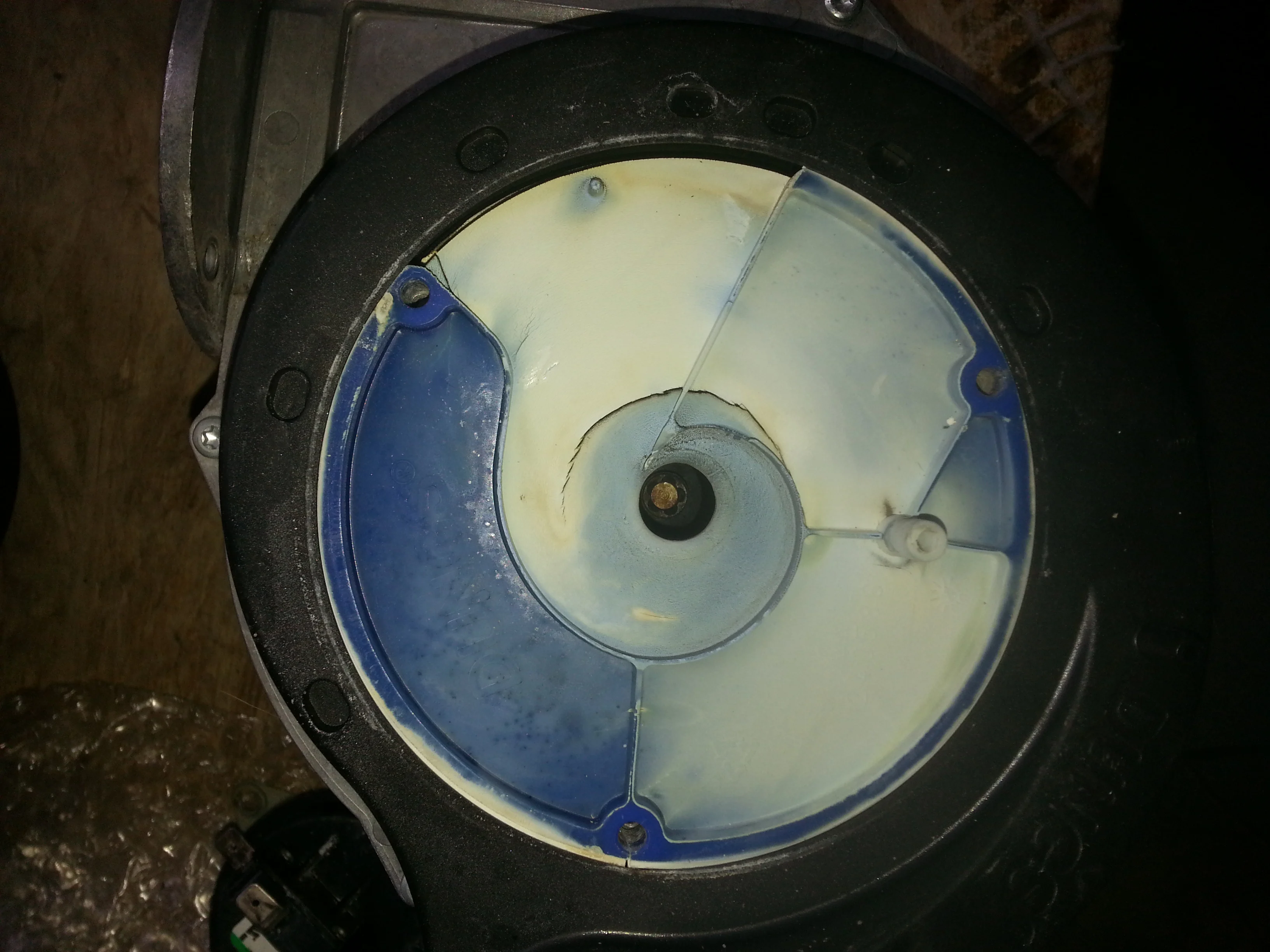

    I have had issues with the gas valve and swirl plate in the PF, but yours could be a simple throttle screw adjustment. Who knows without the tools?

    Thanks, I realized I left a couple things out. I am so used to Nat Gas I forget to mention we are on Propane. Also, we are switching supplier, and the new supplier coming Monday wanted our tank (500 Gal) below 30%, we are at 23% right now. I immediately suspected that (
    The tech did test gas pressure (as we had to consider the low tank) but it was good. Combustion test not to my knowledge. He complained that something was "siezed" on the gas valve. I know he had to disconnect the supply hose to test the gas.

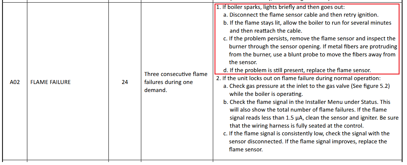

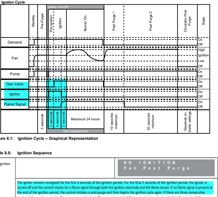

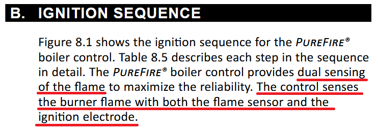

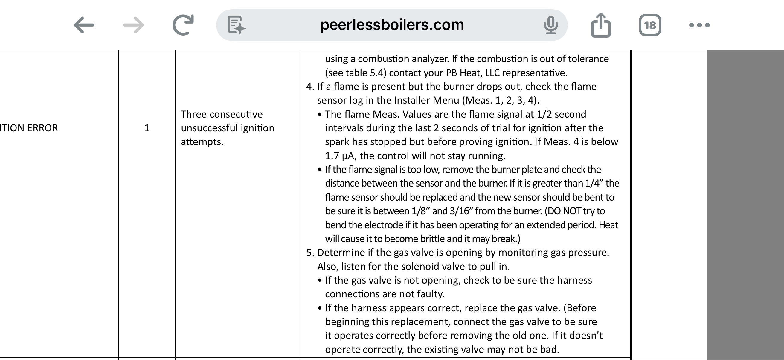

    I also found this in the manual which makes me less sure it's electronic, and maybe is gas:

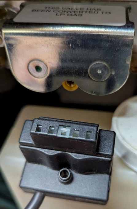

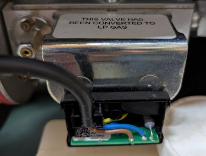

    So, when the boiler does a "trial for ignition" I look through the glass, see a "glow" like a flame, then it goes out, and moves on to fan post purge. I had thought (wrongly) that the timing was - ignite on, test for flame, no flame, turn off gas valve. It appears that the timing is ignite on, ignite off, test for flame, gas valve remains on unless no flame detected. Then you can go into settings and check the 4 flame sensor currents (which are all zero). My point is zero is possible if no flame because of when it was checked. Zero values do not indicate a bad board (I think)
    So, I know that I can check the AC voltage to the control valve and see if it's getting good voltage at the right time, but I don't think I can test if mechanically it is passing the gas.
    you mention the "flame sensor trick". I have an extra sensor, I was wondering if I could leave the one in, connect the spare, and hold a flame to it while going through ignition. I am wondering if a flame from a lighter would provide enough energy to record uA in the controls. I have a map gas torch as well. That would tell me sensor and board are probably ok.
    Edit, also can you please elaborate on "flame rectification"?

    "He might be right. we see current coming from the flame sensor to the PCB (ammeter inline) but in the installer menu (which I showed him) there are only zeros. I had seen good values before. "
    What current were you seeing uA or microamps DC ? The flame acts as a rectifier diode with a high forward series resistance. Many flame detection circuits can tell if the flame detection wire / electrode is somehow compromised to ground, since there will be AC current (which may be excessive) or when there should not be any current and there is and/or the flame rectification is not within specification.
    It seems odd that you are measuring current (multimeter) but the board is not detecting it any more. The refresh rate of the boilers display may be slow, so if the flame goes out immediately it does not display anything.
    What causes the flame to go out ? Incorrect combustion, lack of fuel or air, or the gas valve actually closes.

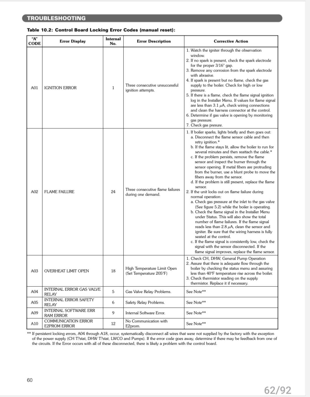

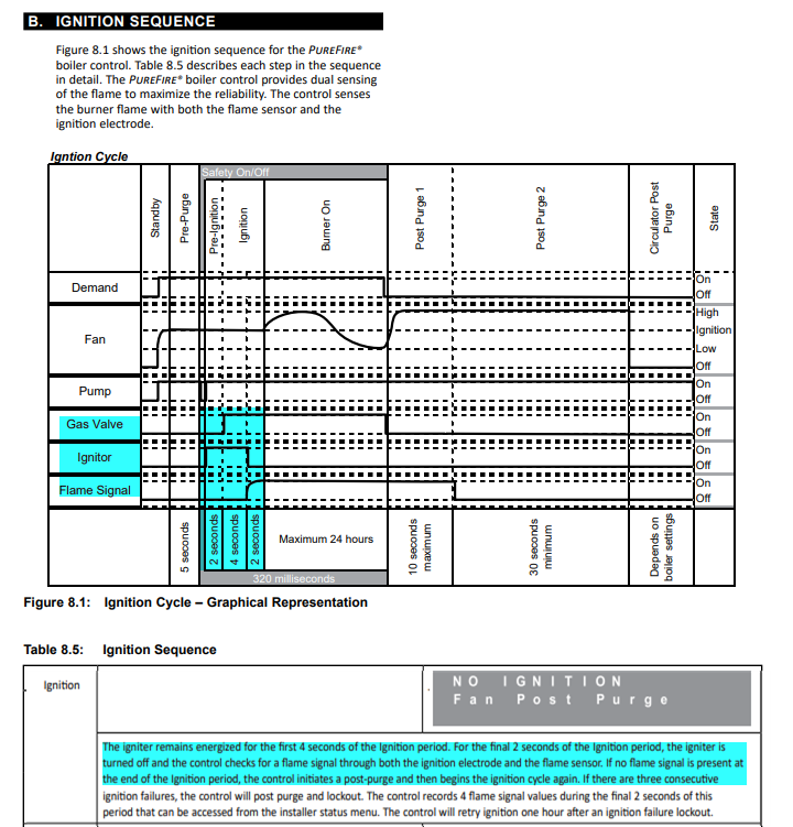

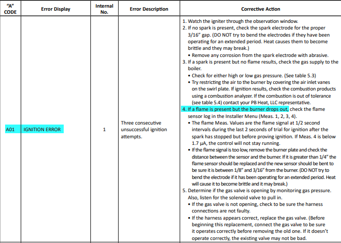

    OK, Hvacnut, I pulled the same section from my exact product, a bit different:
    So, my issue has always been A01 Ignition, but I have also had A02 flame failure
    I just ran a couple tests. During a cycle, I feel (and hear) the solenoid on the valve click, hear (poof) and see the flame, steady for a second, then out, then the solenoid clicks (off) a couple seconds later, then fan purge.
    The values of Meas 1-4 are all zero (see 4). They used to have values until recently.
    I have an old Fluke meter, it only measures mA. I put it in series with the flame sensor and control board, repeated the test, and measured 0.021-0.028, which according to my math is 21 to 28 uA which seems wrong. From distant memory I remember seeing about 3-4 uA in the readings (when there were readings).
    The thought that the current is there and the board doesn't see it, therefore bad board may be wrong. It could be that when I see the current is different from when the 4 readings are being taken. I mentioned before that during previous flame failures the "ignition try" seemed longer, like a poof, poof, poof (up to 5) when now it's just one poof. "Poof" being the sound of ignition.
    As for 5, I cannot measure it myself, but the new tech coming Friday can. What I find interesting is the "flame present but does not sustain leads to the possibility of no, or insufficient gas (#5). I would have thought see flame = gas there, but I guess not.

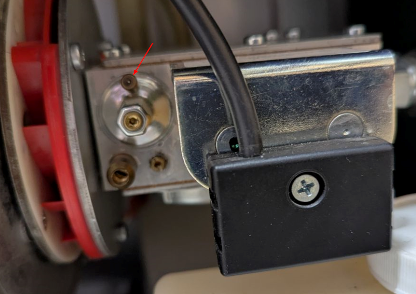

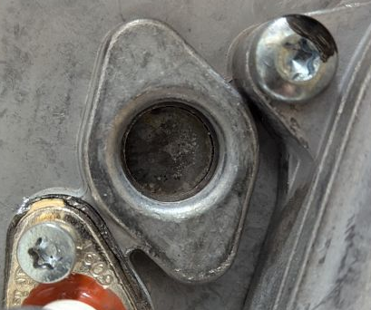

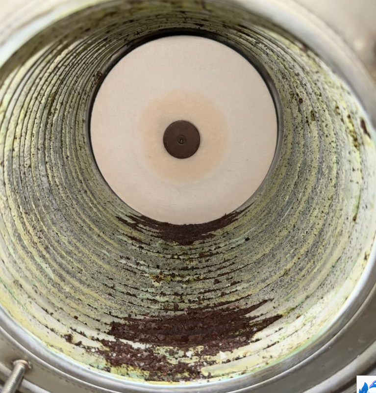

    I ran a few more experiments, but first, a couple pictures of the spy hole into the combustion chamber:
    normal:
    During the ignition process:
    My tests:
    I turned off the gas supply and never saw (or heard) anything, it just looked like the first picture. I then turned on the gas and saw and heard the ignition as shown below.
    I disconnected the igniter and as expected, saw nothing.
    So, my thoughts - It is getting gas, enough to lite, but enough to sustain the combustion? Is it getting enough air as well? Or, is everything ok with the gas, but the control is not seeing the flame sensor signal and therefore shutting down the ignition and complaining about it.

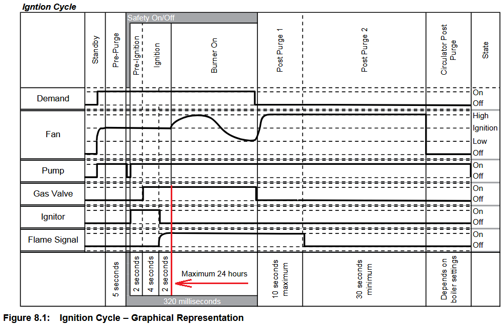

    HVACNUT Posts: 7,784
    Flame signal should be minimum 3.1 uA.
    There is a way to force fire it. Once flame is maintained, it must be adjusted to Peerless specs with the analyzer.

    I find this interesting.
    "dual sensing" So is it AND or OR logic or something else?
    "maximize reliability" reliability of what ? The boiler actually working or locking out and being (ummm) safe ?

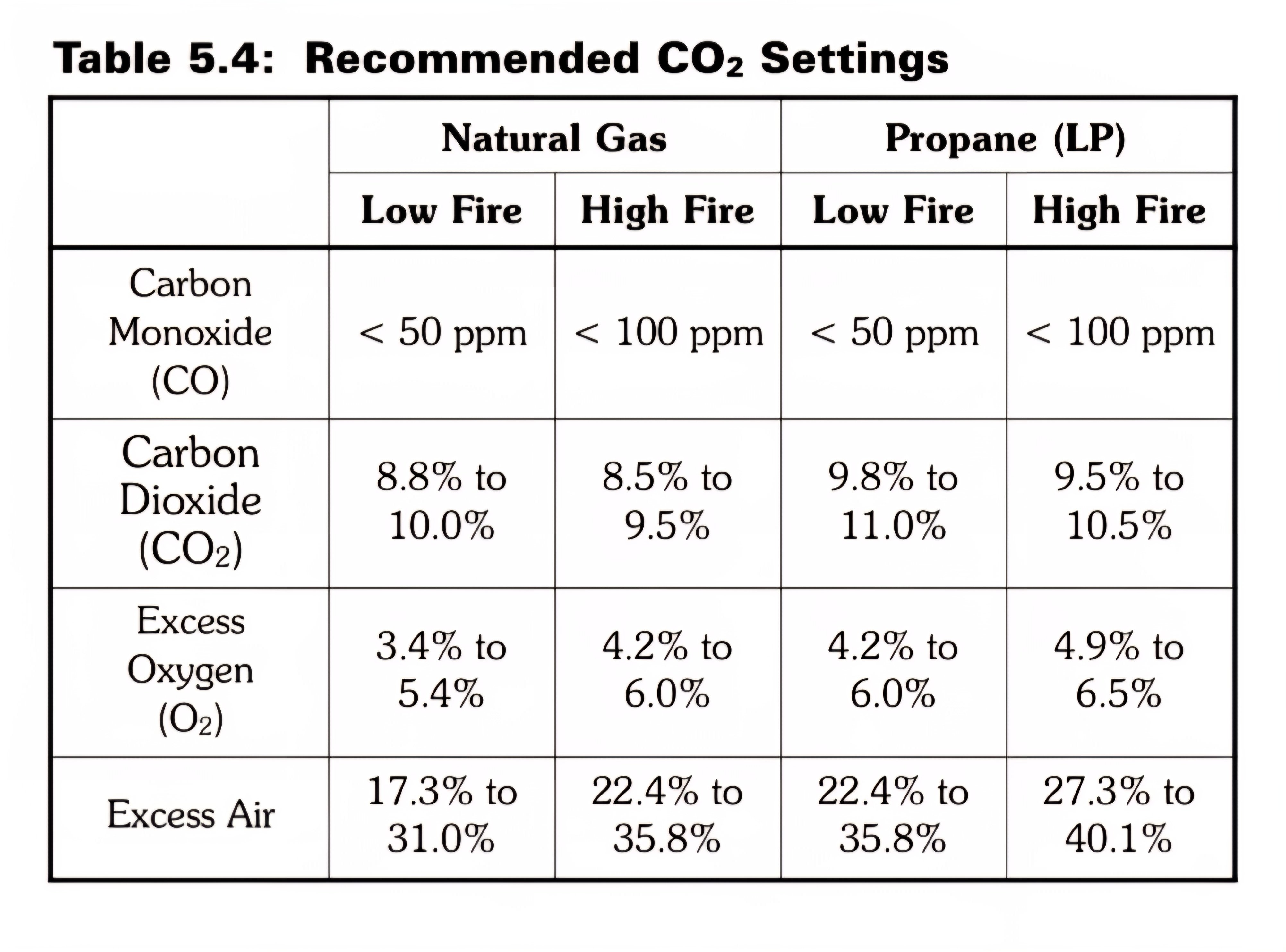

    I really feel like without a combustion analysis, any and all efforts to solve the problem are futile, especially with propane. Pictures of the boiler installation and the venting would be great. The fact that it was so dirty and malfunctioned again after it was cleaned are indicating the combustion settings are way off, maybe it wasn't converted to LP properly. I wouldn't have spent a dime on any replacement parts until combustion is set properly. Sorry but this isn't a DIY thing, you need to find a professional who knows how to use a combustion analyzer and read the installation instructions.

    Maximizing reliability compared to the older Peerless Pinnacle/HTP Munchkin boilers that only used the sensor and has tons of issues, because they weren't setup properly with a combustion analyzer and had flame rectification issues as a result.
    109A_5 Posts: 4,759
    @SuperTech So your are saying it is OR logic ? If either flame sensor is satisfied the flame should continue ?
  • SuperTech
    SuperTech Posts: 2,711
    edited December 2025
    The newest controller uses both parts to read the flame current. This helps when ignition isn't perfect and the flame pattern is poor, it prevents the boiler from locking out due to not sensing the flame when the flame is there, but combustion or ignition is poor and a single sensor may be unable to reliably prove the flame is remaining lit.
    So it would seem the sensors are wired in parallel then.
    I did this once with a commercial burner. It had a gas pilot and main flame was oil. 46 gallons/hour.
    The factory mounting for the flame scanner would pick up the pilot flame fine and main flame on oil as well. But after a long run time the combustion chamber would be glowing hot. The boiler would shut down on pressure and then recycle to start. The flame scanner would pick up the glowing hot chamber on prepurge and the burner would lock out on a false flame.. Another scanner wired in parallel fixed the issue siting in a different spot.
    The problem could have been fixed by changing to an ultraviolet scanner that wouldn't sense hot refractory by it wasn't allowed by MA. code. It was ok in 49 other states but not here.

    3. I was not aware of the flame sensor and the igniter both being used to detect ignition. Yes, AND or OR is not described, but it is a big question.

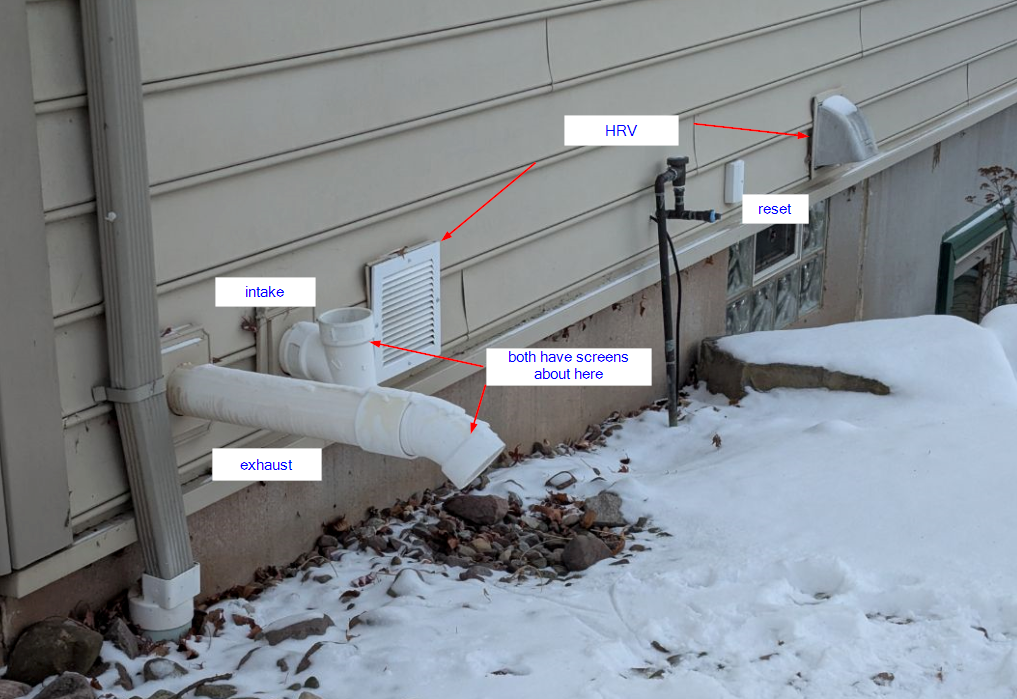

    9. I'll post a picture of the install and venting. Remember, I have had hot water heat all my life (even as a kid) but this is not my install (so install criticisms are not my fault :), we bought the place 18 months ago and were so happy to have hydronic heat…but this system has been more than finicky. I miss my Buderus.
    My conclusion to date is it could be gas is there, but not enough, it could be o2 causing combustion issues, and it could be electronics. Again, I am not trying to DIY, but I am having a problem finding the right contractor/support. I asked my previous tech, when it was very apparent he was struggling, if he could call Peerless tech support (which I have read is available). He said "they won't answer". I contacted another tech and his answering service says "sure, we do Peerless" and 1 hour after the 2-4PM window he called me and said "I'm sorry, we don't do peerless" but he was nice enough to stay on the phone and discuss it with me.

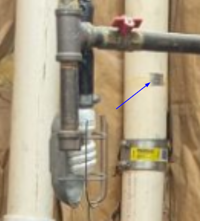

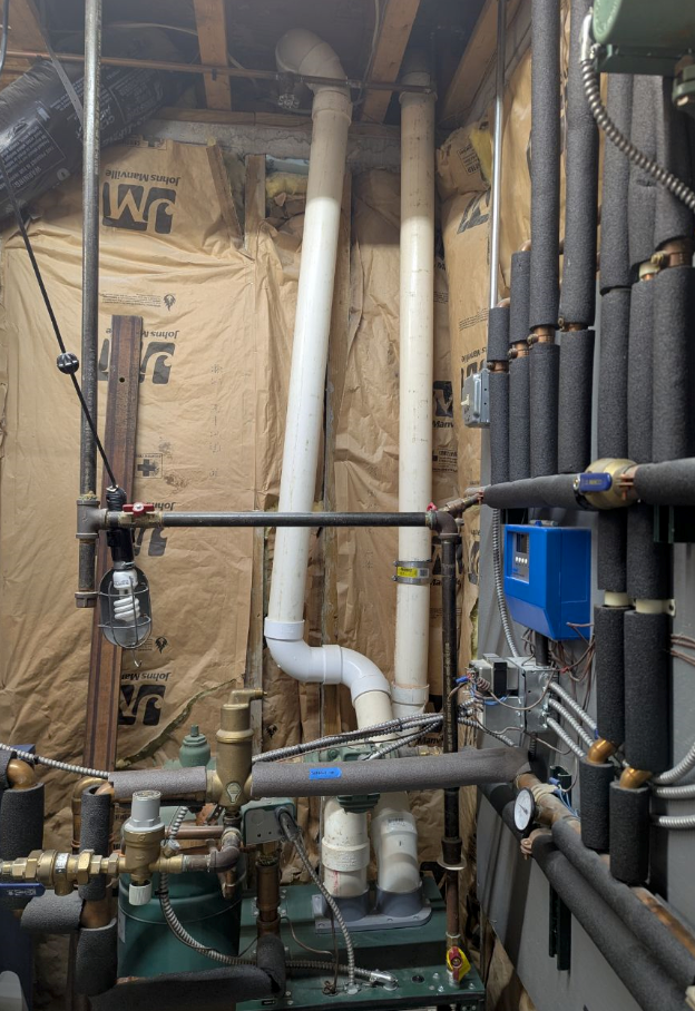

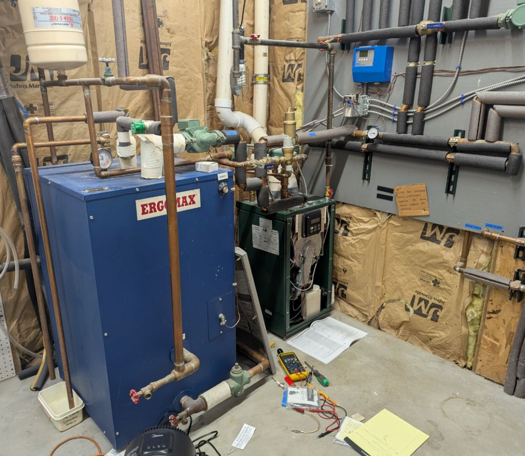

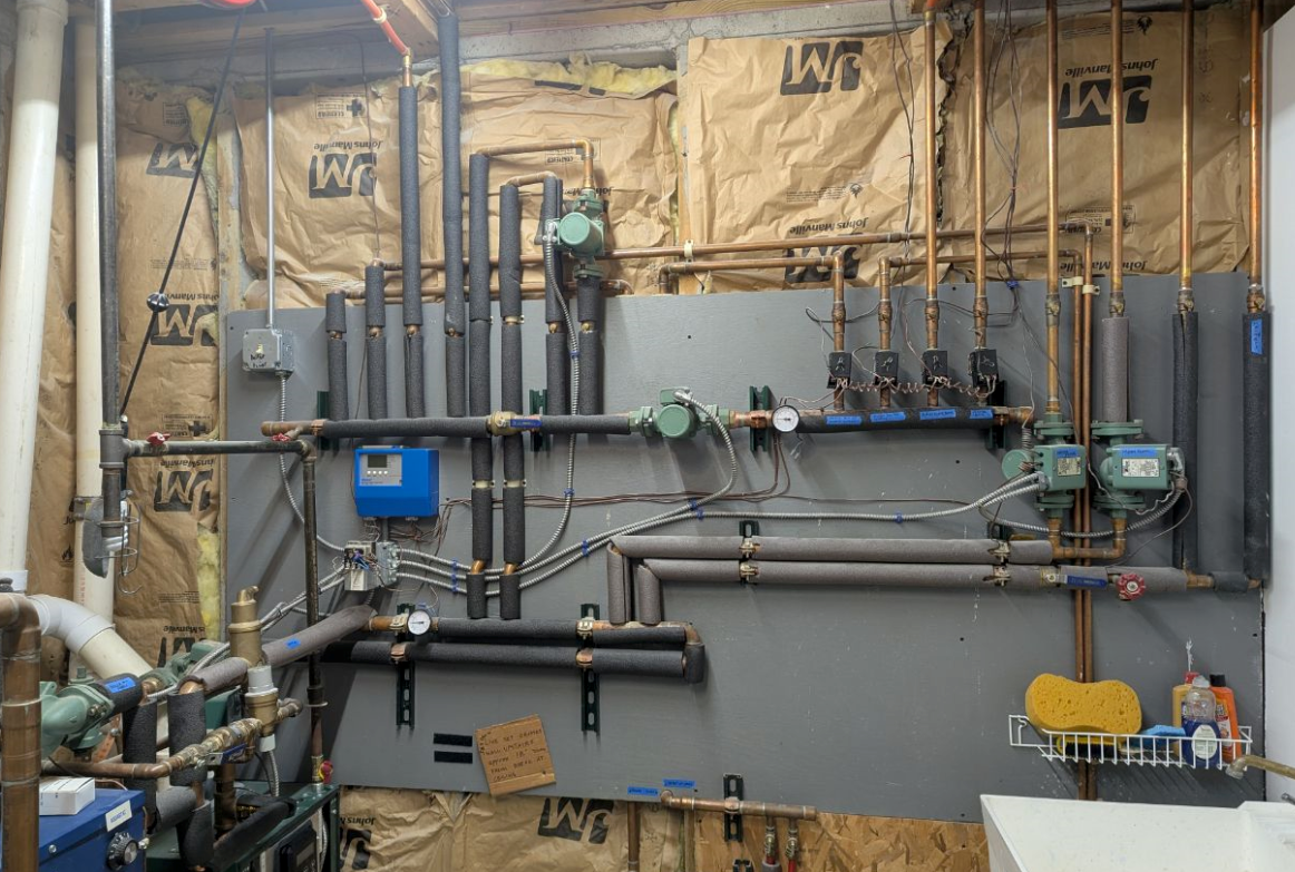

    pictures of system
    Tekmar 363 with outdoor reset controls the pumps and zone valves. One secondary loops feeds two pumps (far right) for main living and master level area (baseboard). The other secondary zone feeds a series of zone valves for two lower level (walk out basement) zones - in floor radiant heat, one zone for master bath (in floor radiant), and the last one for a panel radiator in the first floor bathroom.
    I can get a pic of the outdoor venting if needed but it is all clean and each has screens (looks like about 1/2" or 3/4") to prevent debris.

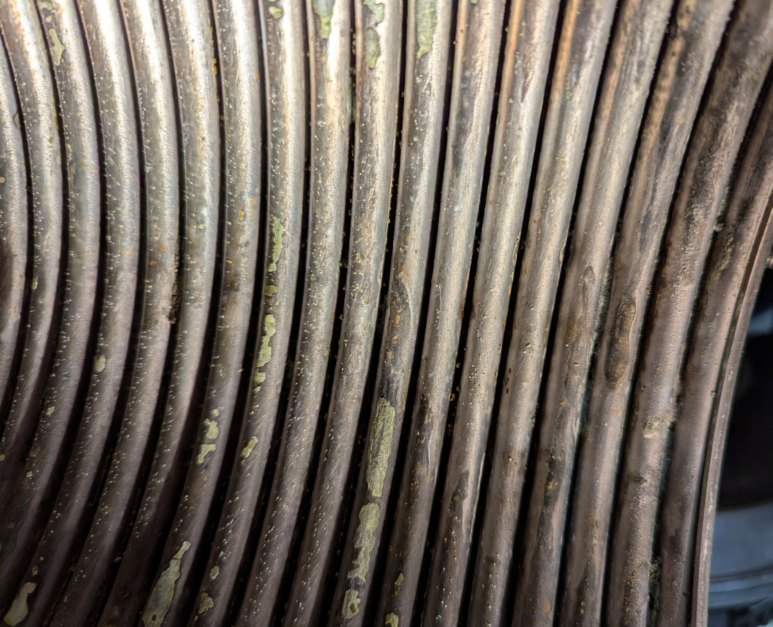

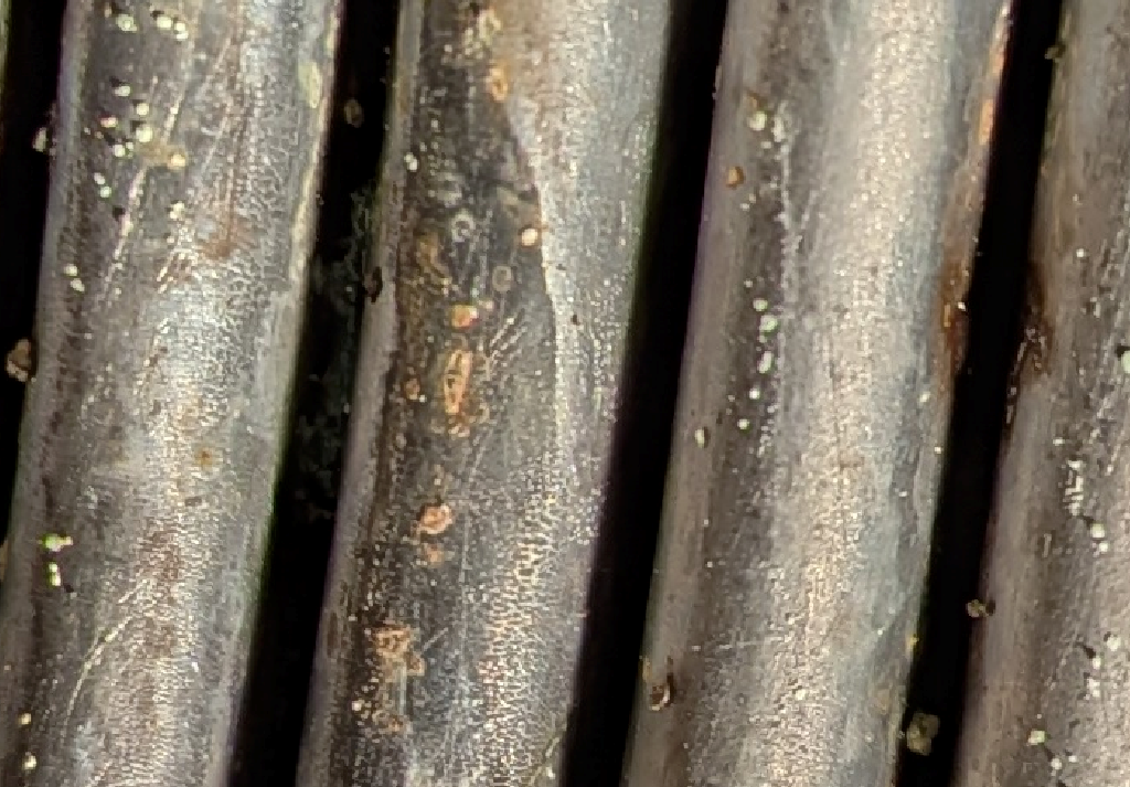

    How well was the heat exchanger cleaned? If the contractor only removed the surface debris and didn’t use a credit card and chemicals to get between the tubes, then it wasn’t properly cleaned and that may be the issue.
    Unfortunately, when a homeowner or a tech who’s not properly trained starts giving their diagnosis of the problem, it can be like a red herring that sends the entire thread in the wrong direction.
    I’m not implying that you aren’t intelligent, but you were sent in one direction by the tech you hired and then began pursuing that and sending this thread in that direction.
    I doubt that there’s an issue with the control board, but it could be possible.
    When we come to a service call, we can see the entire system and evaluate everything based on our experience and knowledge. But when a thread begins with “help with control board”, because that’s what a tech said, it’s already set sail on that path.
    Any manufacturer will tell you that over 90% of control boards that are replaced were not defective. An incompetent tech will inevitably blame the board because he doesn’t understand it.
    Again, it MAY be the board, but I doubt it.
    A dirty heat exchanger and improper combustion settings will give the symptoms you described.

    As for how clean, I don't have answers, I saw that he used a drill with a nylon brush wheel (like the old wire wheels only nylon). He took some befores and afters:

    He said it was really dirty, I am not a good judge of that, I have no clue. I spoke with the previous homeowner and I got the impression that from 2018 to 2025 it had not had anything but "superficial" service, and only once.
  • Ironman
    Ironman Posts: 7,975
    The flue gasses pass from inside of the heat exchanger to the outer side by going between the tubes. If that part isn’t properly cleaned, then just cleaning the inner surface area is of little value.
    It’s time consuming and a pain, but it’s crucial for proper operation.
    I can’t tell for sure, but it looks like just the surface was done.

    Hi Bob, By tubes do you mean what I would consider the grooves of the corrugated cylinder? In between the ridges that look clean? Using a drain pipe reference.
    I have other pictures I can take a look at further.

    Can I just remove that oval plate to inspect both that and the igniter and sensor positions with respect to the burner? Or do I have to take the whole front off?

    Edit - Cleaning helped. Prior to cleaning it had chronic ignition issues, hard to keep the boiler going. After cleaning it has zero issues. But only for about 3-4 weeks, then chronic came back, and the next day it finally it went to terminal (which it is now, impossible to get to ignite)
    Edit #2 - I now remember him using a spray bottle, looked like diluted simple green when he was cleaning

    Here’s a link to a YouTube video on cleaning the type of heat exchanger that you have.
    Unfortunately, they didn’t put as much emphasis on cleaning between the tubes as I would have liked, but it’s helpful.
    You need to use an old credit card or something similar to get between the tubes as they’re about 1-1/2” deep.
    Bob Boan
    109A_5 Posts: 4,759
    This one may show it better, skip to 3:41 if you want
    Keep in mind all the debris generated by the cleaning must be removed.
    Also I kind of wanted the Fluke model number to look up the spec. It kind of looks like an 87 series which should do uA.
    Did you read this part of the manual ?
    "(which it is now, impossible to get to ignite)"
    I'm kind of confused about the blue flame in the picture. So now at this point there is no flame at all ?
  • Redrum
    Redrum Posts: 192
    Bob, 109 - thanks for the videos, I'll hang on to them. As for the manual instructions, I did read them, but only after the tech did the cleaning. If I don't end up replacing the boiler, or the new one is similar, I'll probably do annual cleanings (bi-annual?) myself. I'm pretty meticulous.
    I have to emphasize that before the cleaning the boiler igniting was hit and miss. In the three tries before lockout, it might light on the 2nd or third, or lockout. Cleaning made it ignite first try every time (for about 3-4 weeks, then hit or miss returned, then dead.
    As for the blue flame in the picture confusion - IMO, the ignition occurs, it just doesn't stay lit. It's not just a spark. Again, one thing I think is key, but a mystery, is the ignition visual and sound is different. Before now, when I was getting uA readings in the installer→status menu, it would pulsate a bit, both the flame and the "poof" (like poof,poof,poof). Now it is one blue flame, about 2 seconds, one "poof" →failure. Also, no readings in the installer→settings.
    The manual and timing diagram above show that it's gas valve on, igniter on, then off, then the 4 current measurements are taken in the next 2 seconds, if inadequite, gas valve off, failure. I can feel and here the gas valve solenoid click.
    I checked and wrung out all of the grounds, even those behind the display
    Turns out the meter is a wavetek (I have both, both yellow). It has mA but can read to 0.000, so it can read down to uA.
    But I think a strong clue is that I can read current in series with the control and the sensor during ignition and the control doesn't see anything, or is looking at a time the meter is not reading, which would lead my tech suspicions to the control module.
    The other clue is it used to pulsate poof,poof,poof, now it's one poof. Peerless doesn't supply this detail, but perhaps the control is modulating the gas valve (hence the poof,poof,poof before), but since it doesn't see any uA on the first step of the modulation, it aborts early.

    Video of an ignition try. Note the single poof, flame, then gone. In the past it was multiple poofs with flame modulation.
    https://www.dropbox.com/scl/fi/fghmdz7902c5rkhg11pky/ignition.mp4?rlkey=q41scjpo6iqjyx6liwiqcn7sn&st=p9q7rlw6&dl=0
    Please let me know if you can't view it, or if you need a vid or pic of something else.
    Jim
    109A_5 Posts: 4,759
    The video is viewable. I believe I hear the gas valve open, but not sure if the gas valve is closing or the flame just goes out, seems like a lack of fuel for some reason.

    agree 109. I don't think the gas valve is closing as I hear it close 2-4 seconds after flame extinguishes. I truncated the video to keep it small. I'll go back to the original and maybe post a longer one.
    That is really THE question, is the flame going out due to gas or 02, or because the control is turning it off.
    Can you clarify how these gas valves work? I assume that there is on and off, but is it an analog thing where the amount of gas passed is variable? I would think, because the boiler seems to regulate the gas based on the amount of h2o heating that needs to occur.

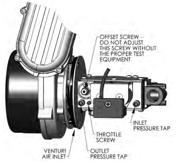

    I thought to check at the valve and then I saw this connector and decided not to. First, I'd have to figure out which lead and even then I would fear even the slightest damage to the sockets with makeshift probes
    but I can tell you I hear and feel the gas valve solenoid per the timing diagram I previously posted and will post again here:
    I definitely hear the gas valve turn off some time after the fan purge has started.

    You said that the flame goes out before the gas valve closes? Check your inlet gas pressures again. Static (gas valve off), dynamic (gas valve on) and running after flame established over time.
    The gas pressure should not drop more than 1”.

    To me it looks fuel starved (blue flame just fades away) basically before it gets to the red line below, since the flame does not seem to even last the first 4 seconds of the 6 seconds of the ignition period. Time index 2 seconds to 5 seconds of the video.
    I believe there is a full wave bridge rectifier hidden in that molded connector. I think there was a recent post about a similar connector with a Weil McLain boiler having issues with a similar connector / wiring harness. I don't recall if they stated the boilers symptoms other than maybe intermittent operation of some sort.

    13 inches static. The gauge should stay on the inlet port for ignition and run to see the pressure drop when the gas valve opens. I don't know what (4) is, but the outlet side of the gas valve should read about zero to negative inches Hg while running.
    Is the Venturi intact? No cracks? When the boiler was open, was the condensate drain tested? Is there water in the trap?

    Let me post a pic of the boiler, opened and you can let me know what to check
    Here's where I am. Control and Display Module changed, Igniter and wire changed, flame sensor changed, nothing did anything. I am still getting 0.0uA on the installer settings→status, screen 4,5. Boiler ignites, flames, goes out,3x until lockout.
    I contacted Peerless though their website form, and they recommended another tech firm, I called them, and while they said they were not very well versed in Peerless (sigh), they would be able to work with Peerless tech support to resolve it on Monday.
    So, with first tech, control module, igniter and sensor, second tech, I am in over $2k on a 7 year old boiler. At some time it will be time to cut bait and install a new system. Frustration talking, but also being a realist. Why own something so important that no one can service? Hoping a Peerless employee is stalking this thread 😀
