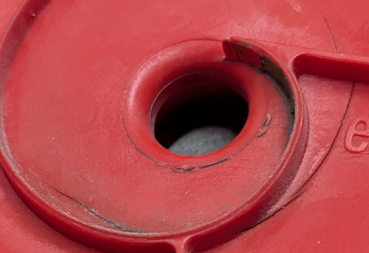

    It looks (to me) like tech #1 did a thorough cleaning down into the "grooves" This picture is of the bottom of the chamber (phone in the chamber facing down)
    and here is a zoom in:
    I ran a piece of sheet styrene I had in some of the grooves and I didn't seem to hit or dislodge anything. I'll vac and wipe down the chamber and vac the burner anyhow. Tech I trust said just a damp (water) microfiber
    The swirl plate looks ok to me. I'll take a closer look. I guess I am looking for a deformation or, say tear, or something?
    So, here is where I am at (to the best of my ability) - controls and igniter/flame sensor are ok, high temp sensor ok, chamber seems ok, 120vac seen at the gas valve, swirl plate looks ok (but I'll look closer).
    That leaves the gas valve and that funky pressure on the boiler side of the valve.
    Tomorrow the "tech I trust" will be coming by to start to design the next system and I am sure he will take a look. I'll ask him to retest the pressure and I think he will want to do a combustion analysis.
    and we go from there. That first shower in our own shower is going to be glorious once up and running 😍🤞
  • Redrum
    Redrum Posts: 192
    Swirl plate looks ok.

  • Ironman
    Ironman Posts: 7,975
    It looks cracked around the hub.

    I agree the swirl plate looks cracked, what I wonder it that is enough to upset it. kind of makes me wonder if a thin layer of epoxy on both sides for a test would work. I wonder if the crack gets wider with the inducer blower running.

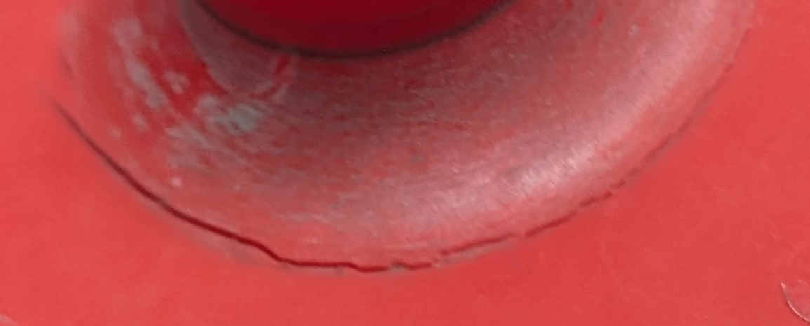

    You need a new swirl plates as that crack will open when running. I'm certain that is your issue. The control chase is a red herring. This needs replacing anyway because you don't throw that back in an expect it to work. Peerless has a parts supplier online that you can get ship right away.

    Looks like a crack to me, it looks like it is on both sides, anyway it should be verified. I'd try epoxy as a test before I spent any more money on parts, etc.

    Apparently that cracking is a known issue, however the cause is maybe unknown, at least in 2015. @Redrum you may find the post interesting.
    Some folks feel it is worse with LP.
    https://forum.heatinghelp.com/discussion/comment/1384524
    109A_5 Posts: 4,759
    edited January 1
    More carnage:
    From back in 2011:
    Did some checking with HTP about "swirl plate" problems here is their comment:
    I believe pre mature failure is due to two reasons:
    The back draft of flue gases from venting system through heat exchanger and back out through swirl plate. The spent flue gases contain a great deal of corrosive condensate. The fix we used was to increase post purge on fan to clear all spent flue gases from venting system.
    Another cause can be recirculation of flue gasses entering the cabinet and being drawn into swirl plate. Same material just from another direction.
    About two years ago the manufacturer of the swirl plates changed what they are made of. They switched to Poly Propylene a more durable product that can also take higher temperatures. Swirl plates made of this newer material can be identified by the letters PP under the triangle on the back side of swirl plate.

    Also, 109, and the rest of you. I'll delve into the swirl plate more today, @pedmec , I hope that you are right, I'll pay a hundred easy for heat and hot water, in fact I'll pay…..
    I zoomed in on the photo:
    As I mentioned the "tech I trust" I have known for quite a while and he is big time into hydronics, AC, etc, and being an engineer, I appreciate when he talks the science of what and why. I may not understand exactly what he is saying in terms of the specifics as it relates to this, but I know it's not BS because I understand enough of the science to recognize BS. I'll see him today. I asked if he could perform gas valve measurements and a combustion analysis, but the main reason he is coming is for the new design.
    I will mention the swirl plate to him, and we may take it out. If he doesn't, I will and get back to you, but I am betting he'll perk up when I show him. Edit - just spoke with him via text, he said "that'll do it". We are checking to see if we can get one locally (ERB supply in Buffalo). I don't mind this part, even if it's not the fix, it's broke and needs replacing.
    I had it in my hands and it didn't feel like PP (I spent some time in plastic molding industry). It had more of a nylon look. PP is recycle number 5 ans the triangle is empty (see pic)

    So, here is an update, good news, almost, well, not really.
    My tech (I trust) found a swirl plate locally, and the supplier tagged it for us just before it was going to get shipped out of state. They gave preference to an account holder (my tech). Turns out that Peerless told the sales rep they won't have any new ones until Feb, March. That jives with supply house. To me that is a head shaker that a manufacturer can't make sure parts that are prone to fail are available.
    We installed it, and it fixed the A01 Ignition failure error (so it was definitely a factor). But, the flame extinguishes after, say, 20-30 seconds (instead of 2-3), causing an A02 Flame Failure. So, the benji for a plastic molded part got me a step further. I can read real good readings on the flame sensor in the installer menu where there were zeros before.

    Kind of wondering if this is a test port (inducer / venting performance), or maybe it is Top Secret.
