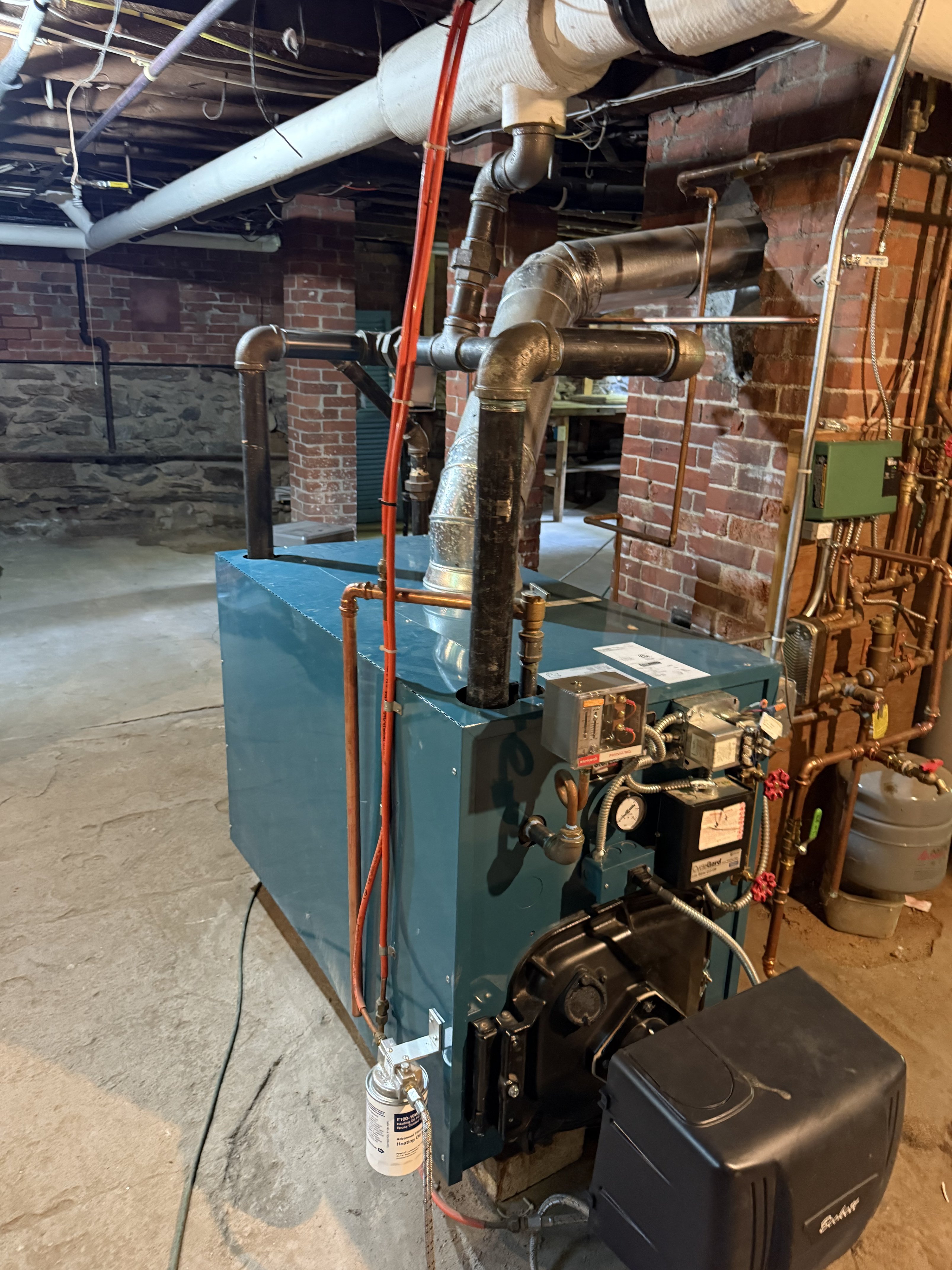

I was out this house today casing out air conditioning. The people just bought the home. A very nice home. I’m curious how this big old 9 section boiler wil gets its steam to the system
the header is supposed to be 3 inch, they bullheaded the 2 inch into one 2 inch connector, into the mains

    It’s also piped wrong with the main tapped between the risers.

    Jamie Hall Member Posts: 27,699
    If it works without problems, it serves to show how forgiving steam can be…

    mattmia2 Member Posts: 17,906
    "works" can have a lot of meanings. I wonder how close the output of that boiler is to the actual connected edr

    GW Member Posts: 5,211
    yes and yes. It seems like if I goof something up, the demons and vipers are biting at my heels. But when somebody else does a goofy job, everything works out just fine.

    Are those risers bushed down at the outlets of the boiler?
    wuyuzizi000
    Can't see how the equalizer is tied in. @GW
    The hacks get away with it all the time. Anything over 2" black is a foreign object to them. I thought I was the only one. If I had installed it like that the boiler would have likely blown up on start up.
    edited July 2025
    Looks like a reducer or bushing and tee at the end of the header to make sure no condensate or carryover goes in to the equalizer…
    the header is full 2 inch, all the way to the 90 that drops to the equalizer. It’s turned 45 but it is not trapping any water.

    Steamhead Member Posts: 18,805
    No. That's a Burnham V-89, and the outlets are tapped 2-inch.
