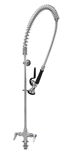

    T&S pre-rinse faucets have always been single hole, if you are into the industrial look.
