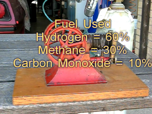

    That may have been for coal gas (sometimes called town gas). It was made from coking coal and had a large percentage of carbon monoxide.
