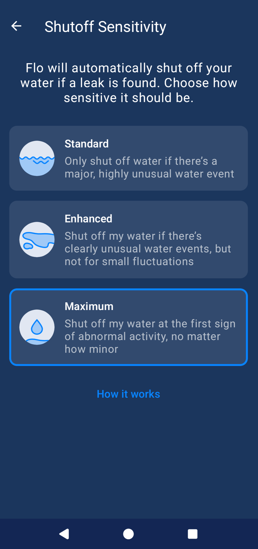

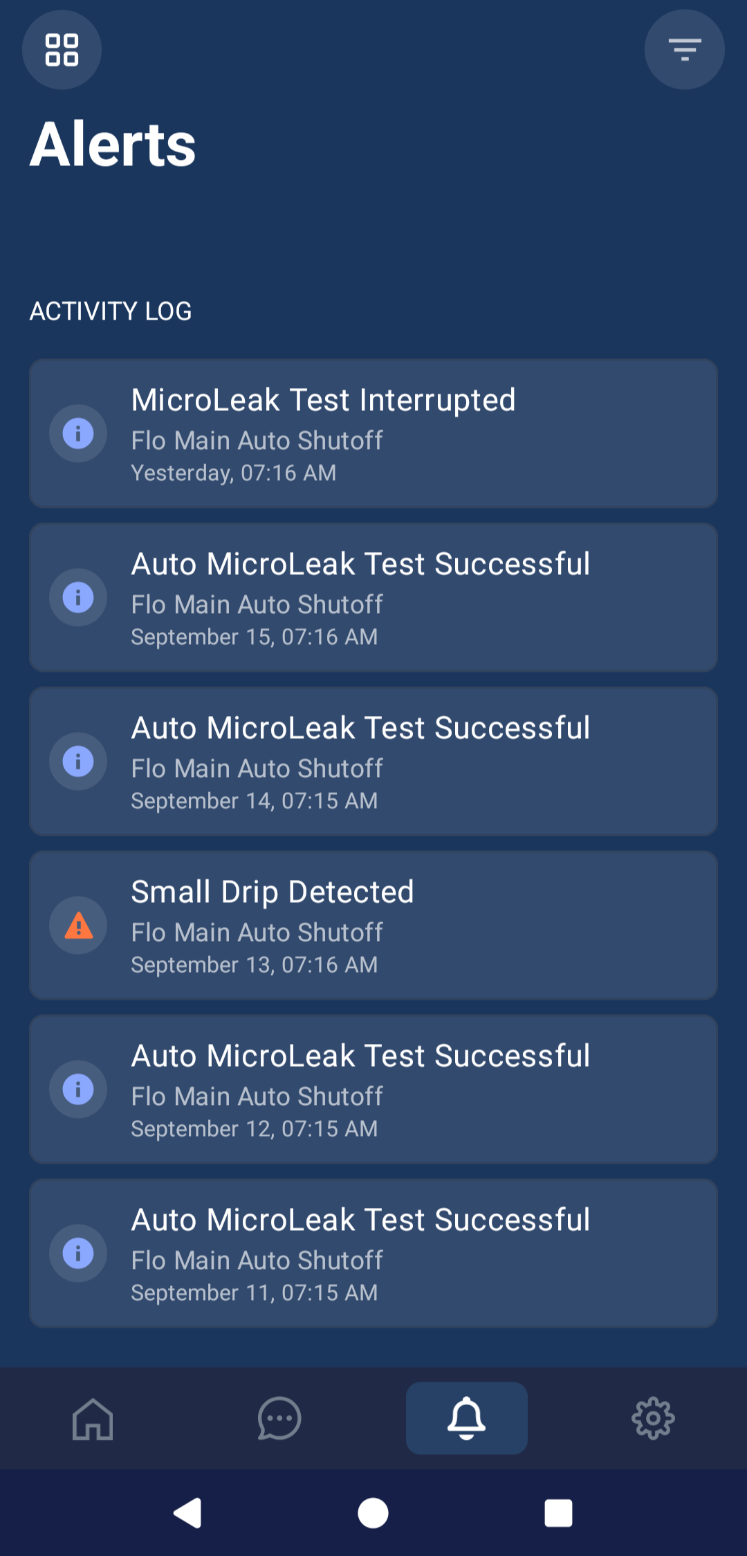

The moen flo is capable of detecting "micro leaks". How much volume/time is that? I couldn't tell you. Moen states as slow as 1 drop per minute. I'm not sure I believe that. It does this test (daily, say 4 a.m. or a time range set by user) by shutting off their automatic valve and monitoring any pressure drop. If a micro leak is detected , a notification will be sent but the water will not be shut off.
I have a 1.25" moen flo valve on the main supply in basement. The water has been shut off a number of times for long showers, toilet flapper not closed, etc. The app/software will learn what is the homes expected usage patterns. It's well worth it in my opinion.

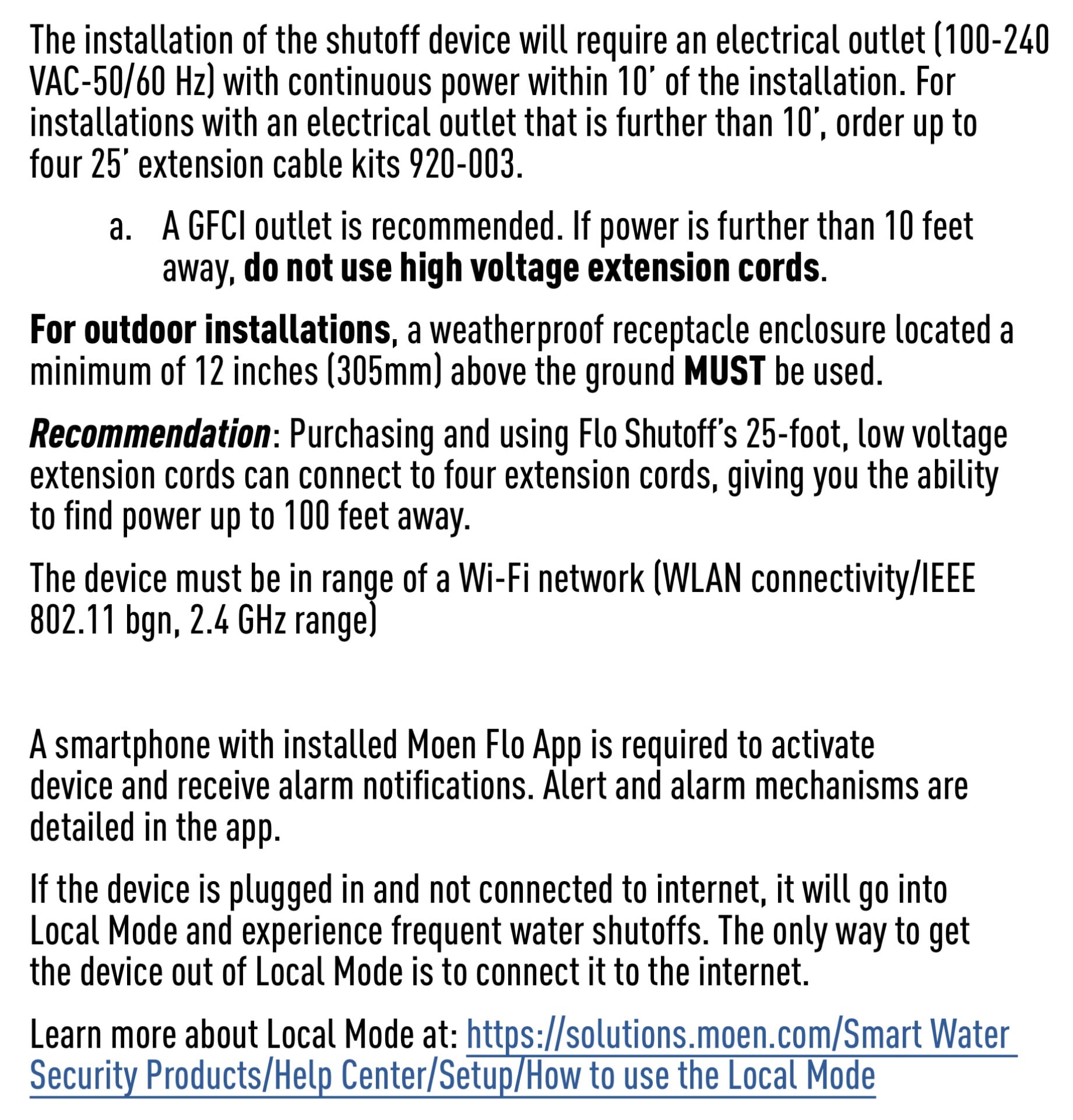

Unfortunately these devices require a robust home wifi network with a reliable internet connection as well as power.
Imagine you are away during an ice storm, and power to your house is cut. The furnace wont run and the network/wifi wont run. Disaster waiting to happen and these devices can’t help you because they have no power and no network connection.
Just be sure you understand the limitations of what they can and cant do before you purchase. Connecting the device to a small battery UPS might be a good idea!
i'm pretty sure the better ones have a battery and local control.
The Moen Flo instructions state the following. This post was about the Moen Flo. There is no mention of installing a battery in the installation instructions.
… require continuous power within 10’ of the installation
… If the device is plugged in and not connected to internet, it will go into Local Mode and experience frequent water shutoffs. The only way to get the device out of Local Mode is to connect it to the internet.
