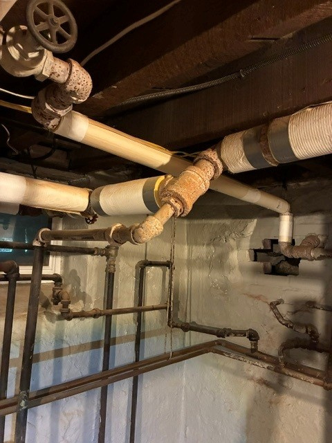

I have a wet loop seal/water seal right near the end of my steam main. The loop is leaking a bit and i think i should replace. Should i consider using a steam trap or just replace kind for kind?

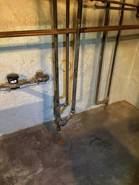

We always install a Gate Valve with a tee and 3/4" Boiler drain below the water line, whether its the Hartford Loop or a loop seal (install one on each leg) Its the best way to be able to blow out and Muddy Splunck that congeals at all the low points of a Steam system. We will use a ball valve in a pinch, but the Teflon ring inside them dont hold up long in the superhot steam condensate. Mad Dog
1 -
If you do them like this, you can power-flush 'em out down the road, and the mud and splunck have no chance to collect. Mad Dog

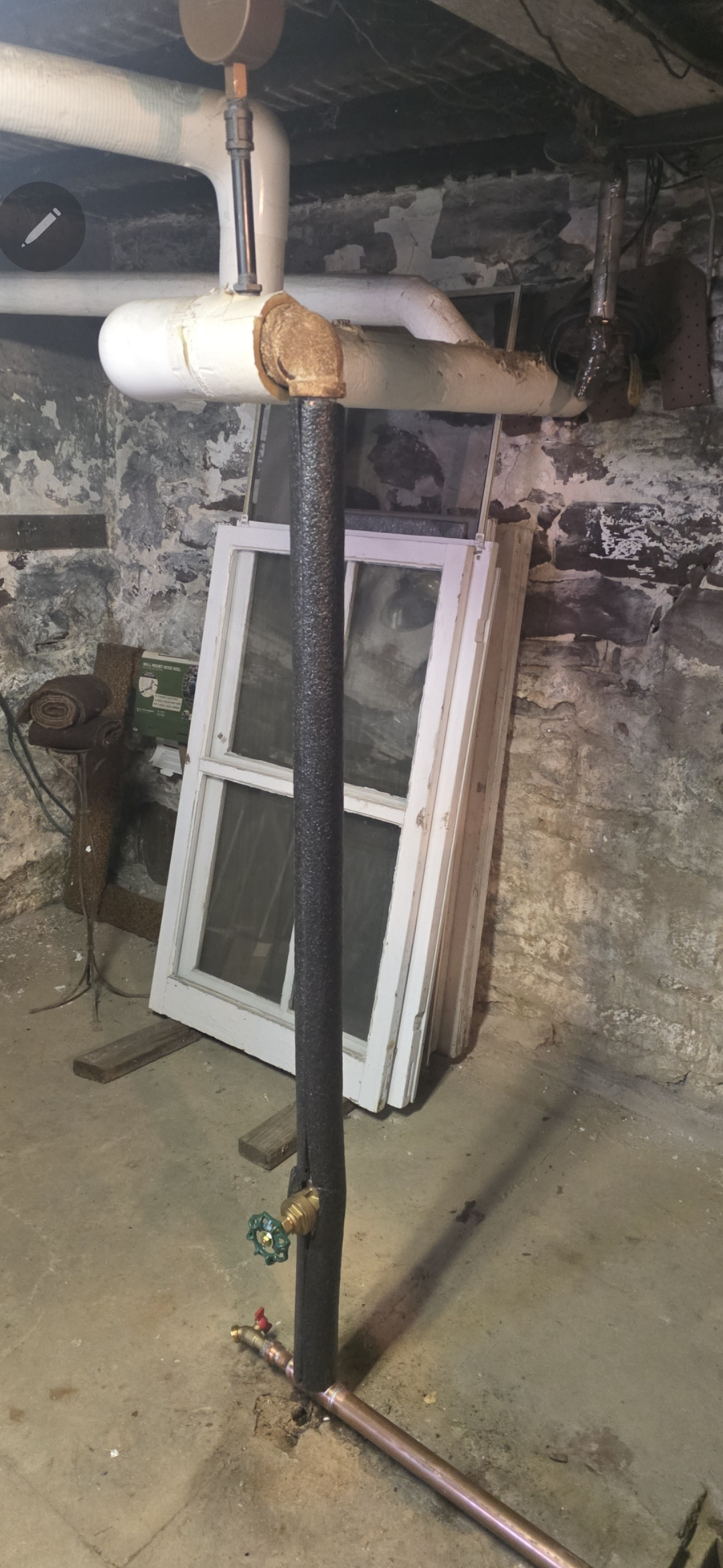

Or just use two unions. You can take the whole thing off to clean it.

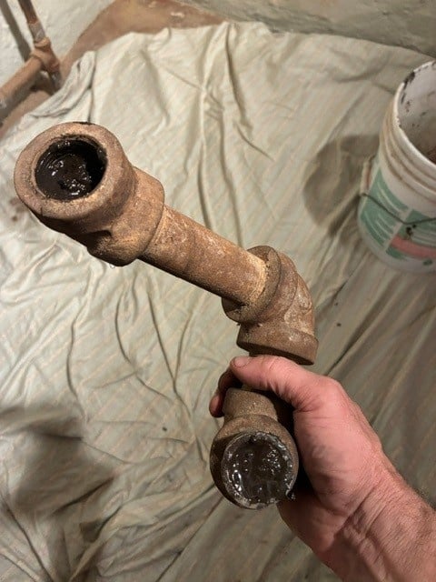

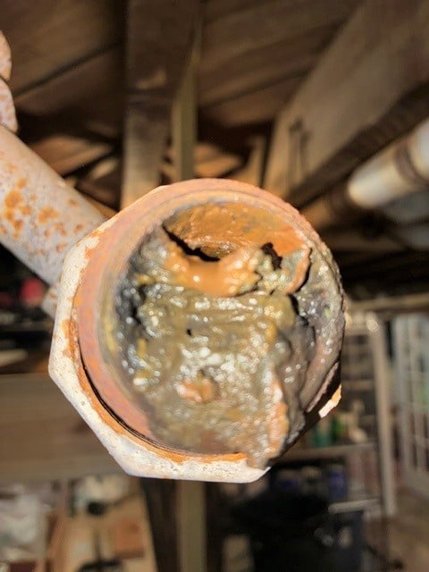

I needed to add a third union. Thought to share the horror of the sludge i found during replacement!!

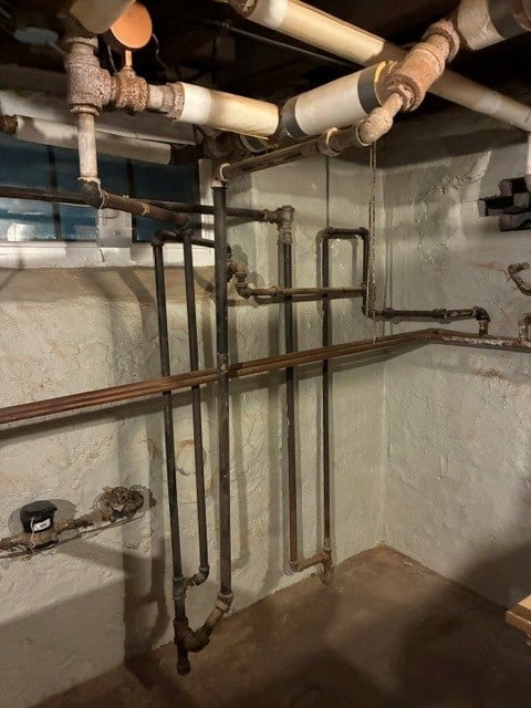

Is it advisable to take apart the loop just to service it …I am pretty sure the two loops on my two pipe system have never been cleaned.
Thanks.
If it's easy to do — nice unions or blowoff valves or somesuch, there's no harm. Otherwise… I wouldn't touch it unless I had a very good idea there as a real problem, like significant water hammer on that main…
Exactly Ed, thats why any chance I get and all new installations get Tees instead of elbows and a 3/4" Boiler drain. A gate valve if possible. This saves hours and hours on flushing and cleaning. Mad Dog

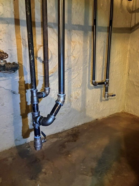

Well this is what i did. Hopefully is better than before. There was indeed a lot of water hammer and essentially sludge all the way to the ceiling. btw, in the background you can see the sealed off old central "district" steam line supply.
1 -
or is that a water seal between mains where it goes down then back up to a higher return?
Looks great. As Mattmia says, check your system water level to keep the tees submerged. One other thing.... stick a plug is the bottom of each ball valve when you're all done. We dont wanna see Homeowners stacking boxes, exuberant dogs and curious kids inadvertently opening them. Mad Dog
