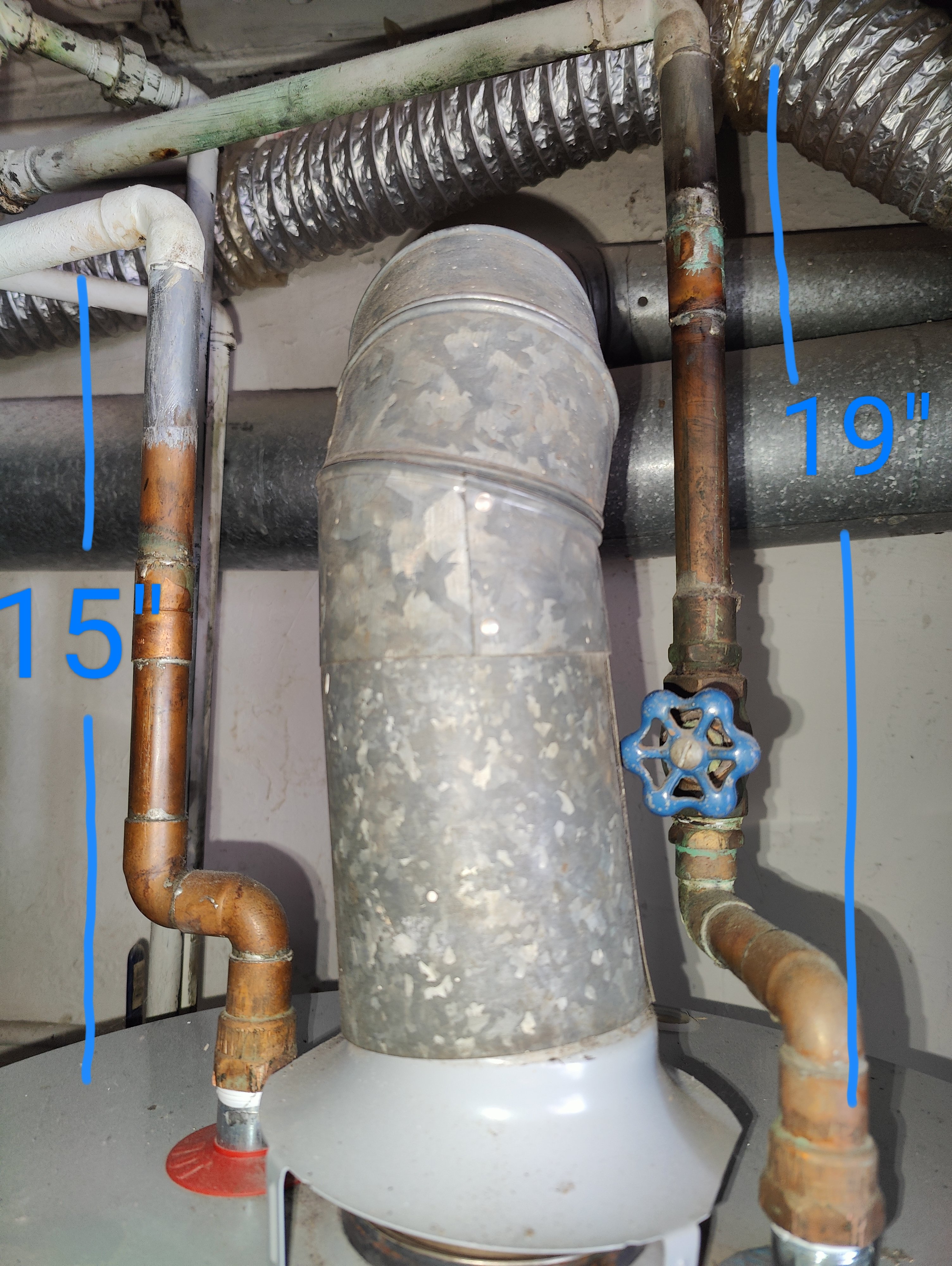

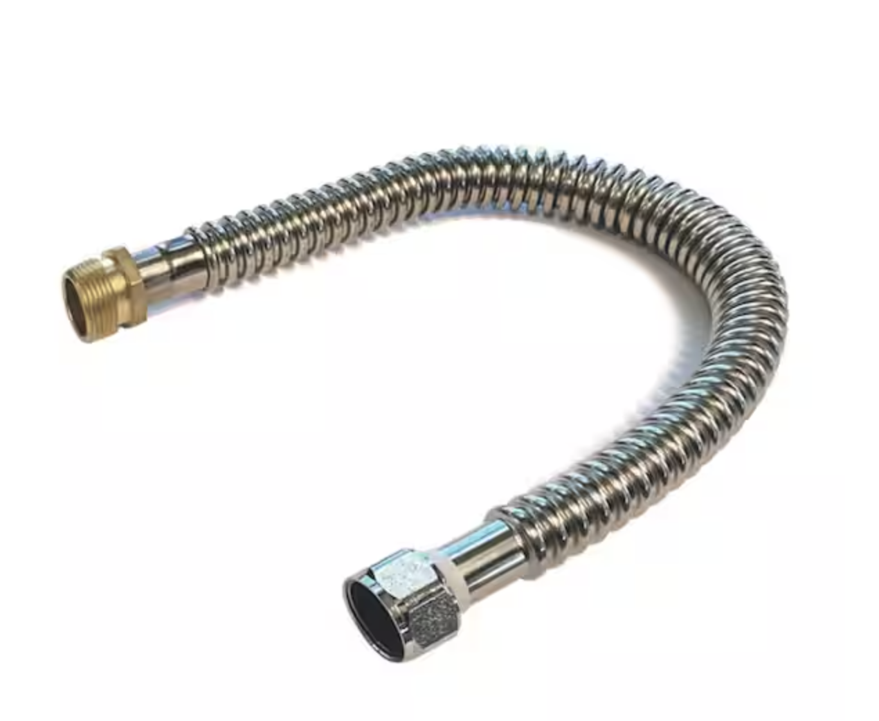

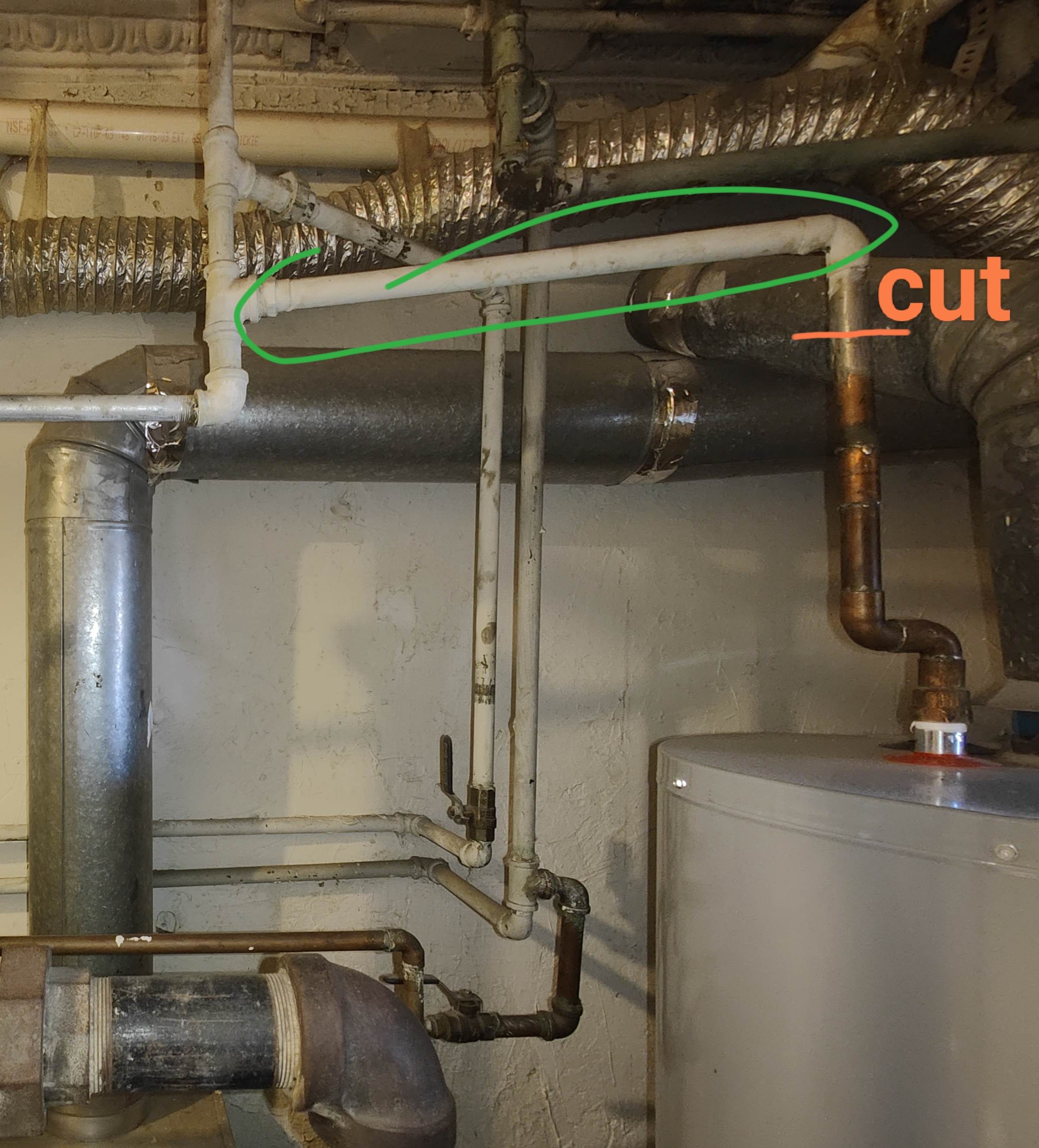

I need to disconnect the water heater. To make it easier to reconnect, I want to replace the vertical h and c tubings with flexible ones. What is a good point to cut the tubing and adapt to npt? These are 3/4 copper tubing.
Some sections are painted with white or silver coatings. What is the purpose of this coating?

    either they jus painted everything to make it brighter or there was a fire and the shellacked everything to seal in the odor.

    so the coating has no mystery. The available flexible s.s. tubing is 18 or 24 inch. What is an optimal point to cut?

    use some coarse sand paper to clean the painted section and confirm it is copper
    Flex connector are available in a few different types and lengths. I prefer the copper

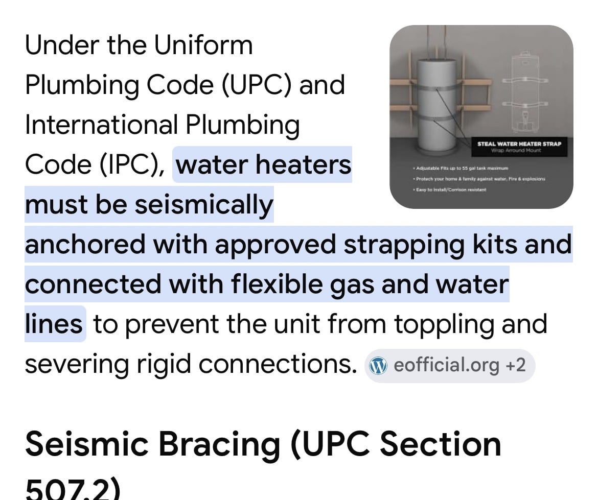

    In seismic areas inspectors want to see flex in water and gas

    Hi, I used to prefer copper, but now I get corrugated stainless connectors. They are easier to work with and don't work harden like copper. I'm hoping you'll replace that valve with a ball valve at the same time. I like to use longer lines (like 24") and form a heat trap with the excess length. In this case I'd cur both lines low and make a 360 loop with the flex.
    Yours, Larry

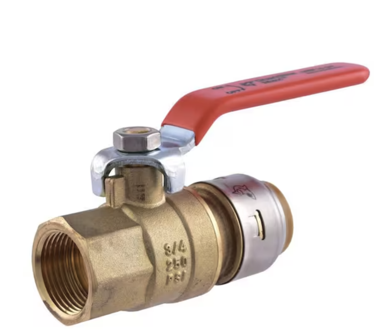

    A DIYer might go this solder less route. Sand the copper smooth, no nicks or deep scratches to get the best push connection.

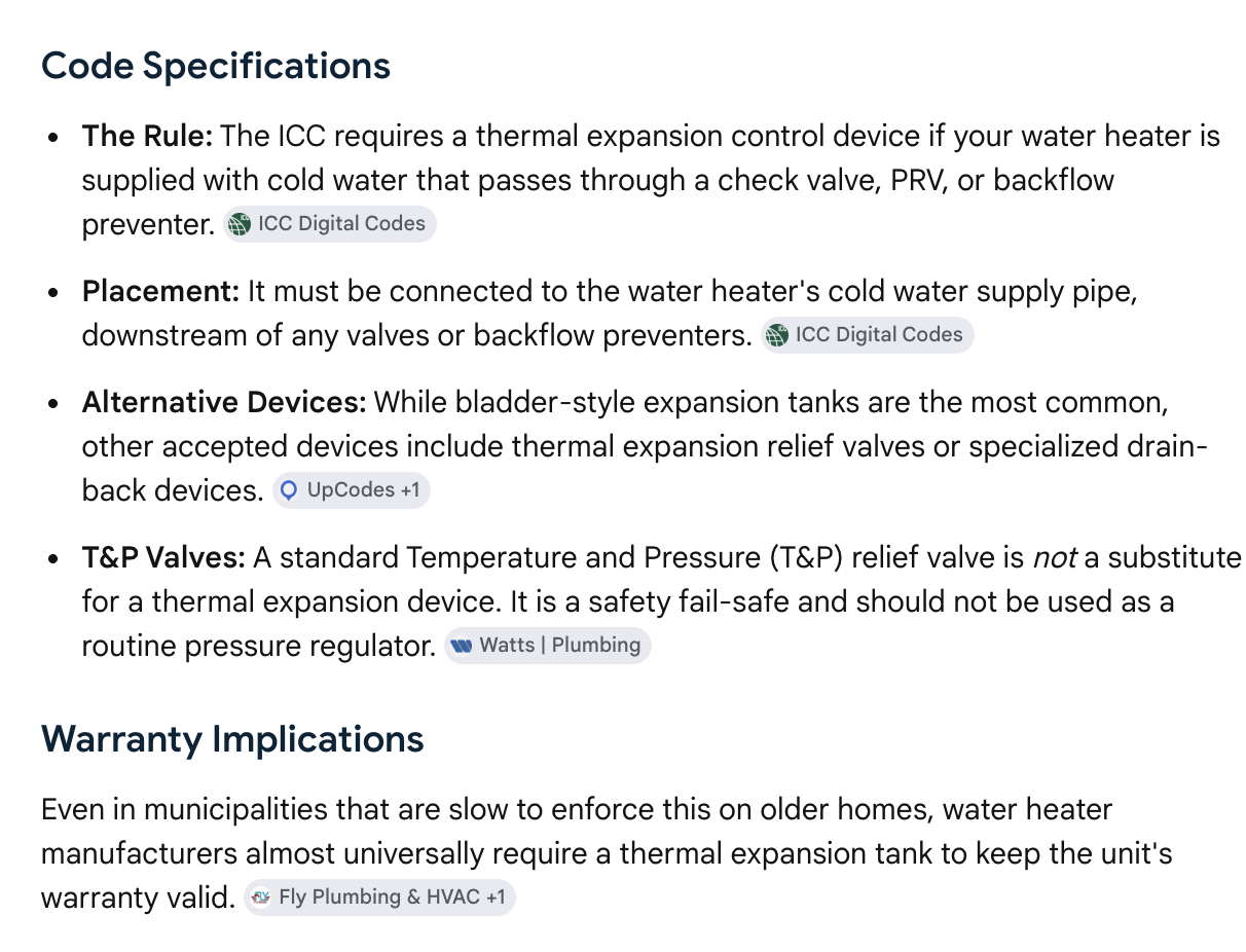

    Maybe add a thermal expansion tanks also. Plumbing codes and tank warranties are starting to demand them.

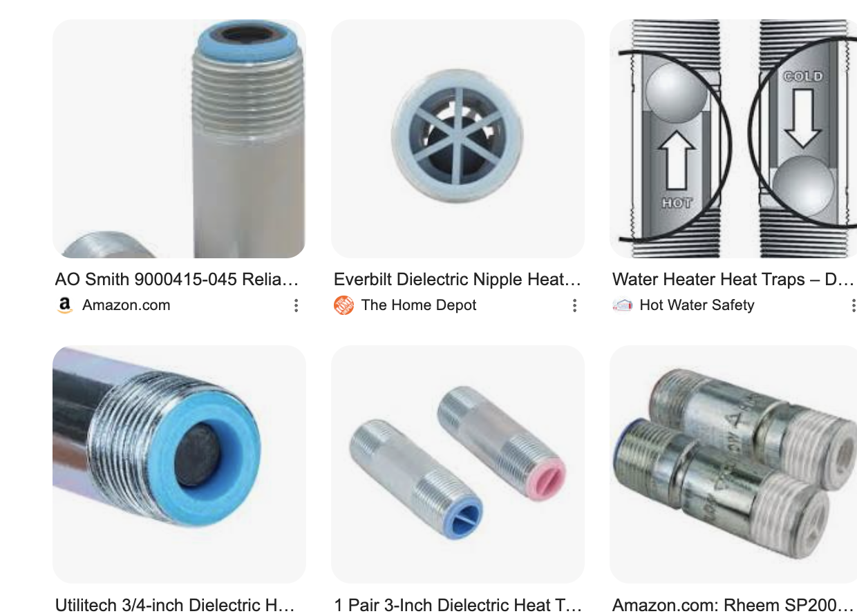

    Heat trapper nipples have been going int water heater tanks for probably 25 years or more.

    i hate those heat trap balls. my old water heater had them. every time the pressure in the municipal system would change or a fixture would shut off you'd hear this repeated clicking in the heat traps from the basement as the water sloshed in and out. i still imagine it every time i shut off a faucet or the toilet finishes filling even though i replaced that water heater 7 years ago.
    hot_rod Posts: 28,776
    some brands have a soft rubber flapper instead of the plastic ball

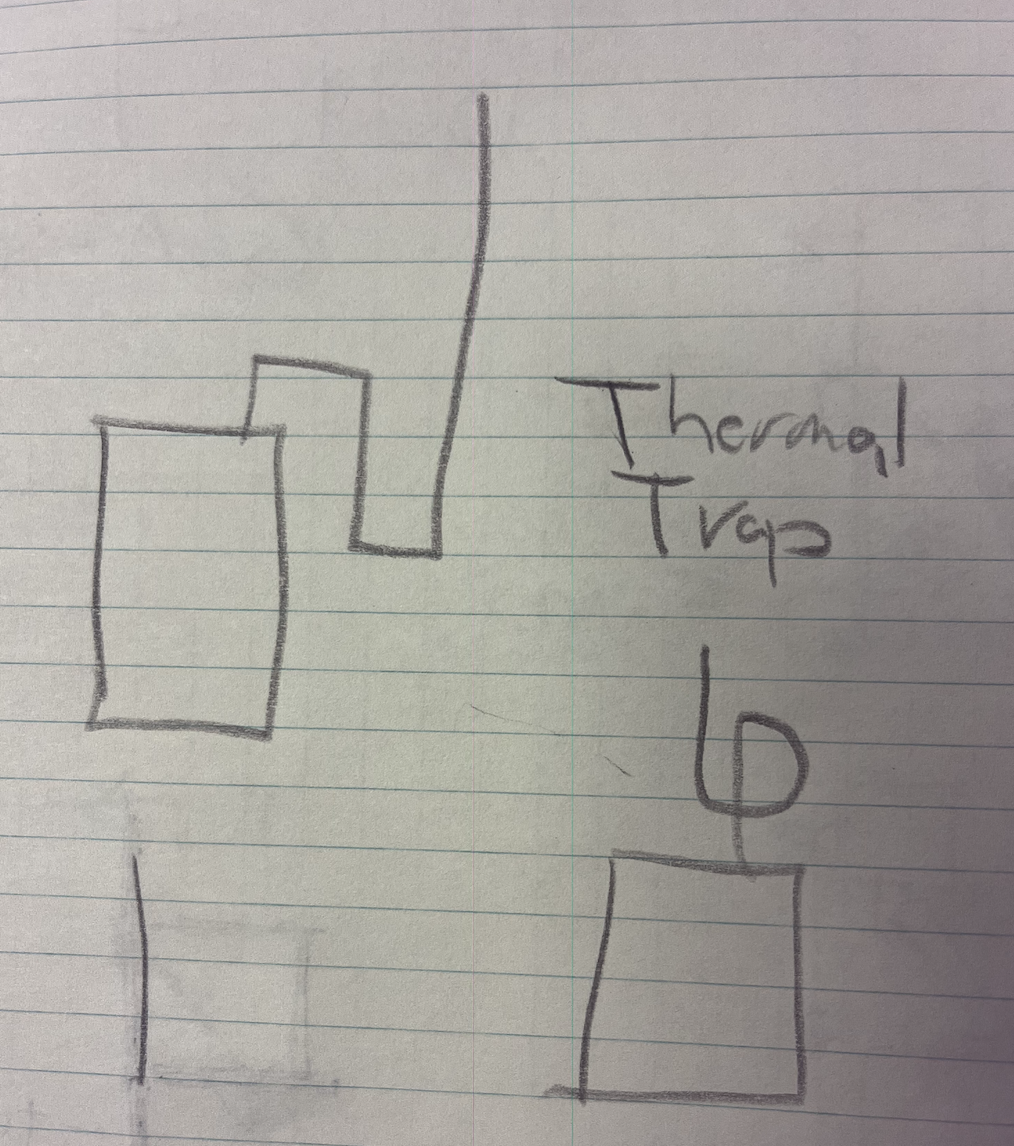

    what value does the loop add? is it the same benefit for both the H and C?
    I've seen where the water pipe from the meter rises out of the floor, rather than taking off directly, it goes through a transposed U before going straight up again.
    Sometimes called
    a thermal trap. Intended to keep the hotter, lighter water from rising into the system. A few ways to accomplish that fuction.
    The special nipples of one of these options with a long flex tube.

    On a water meter it's to keep the meter horizontal.
    On a water heater, see what @hot_rod said.

    No, my plot is the city water. The location is the rear of the house, about 18' downstream of the water meter. The pipe from the meter goes under the slab all the way to the rear of the house, turns its way up and out of the slab, sending water to all floors. It's always cold water with no thermal to trap, why the detour?

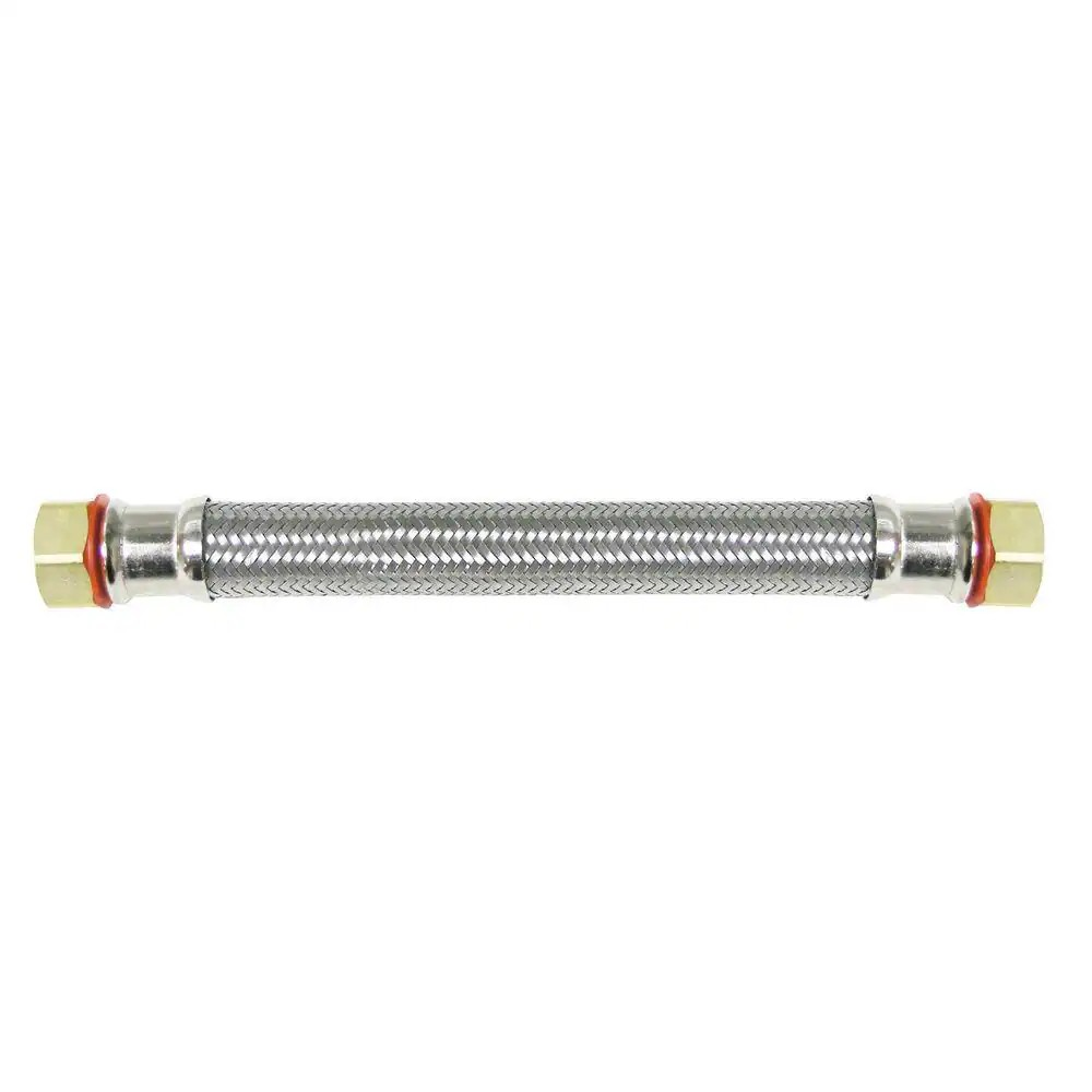

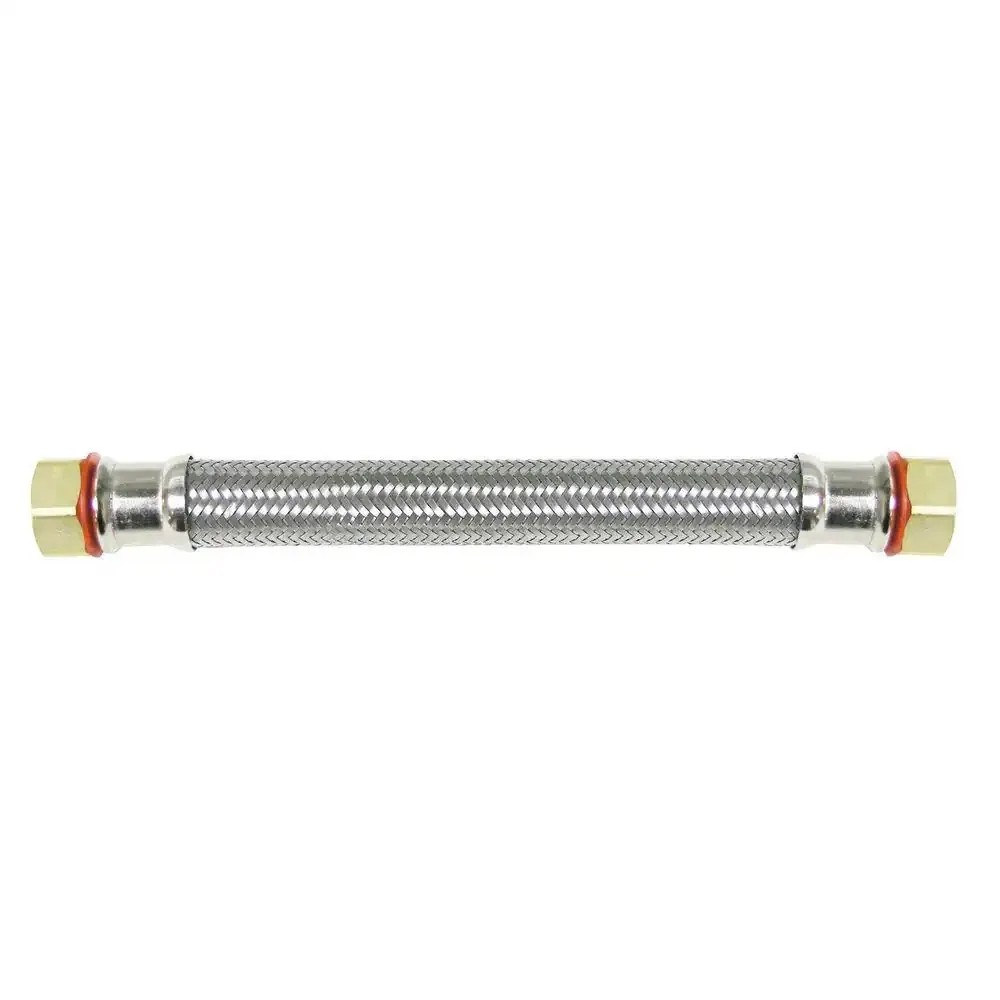

    Any comments on the SS flex hose? I think inside of the braided outer layer is some rubber hose.
    https://www.homedepot.com/pep/Everbilt-3-4-in-FIP-x-3-4-in-FIP-x-24-in-Stainless-Steel-Water-Heater-Supply-Line-EBBC-07-24a/206527409?

    Hi, A thermal or heat trap would only be used above the water heater to prevent heat loss into the piping. I was responding to the photos of your water heater and it's piping. 😉
    Yours, Larry

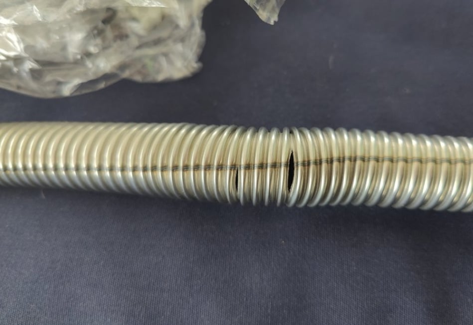

    Here is an exhaust s.s. pipe that failed after a year's sunlight and then a few bents a month ago -
    So I want to avoid that and use this type of hose shown below:
    Both have similar price. Anyone can comment on the preference?
    mattmia2 Posts: 18,437
    the plastic inside the braded one is likely to eventually fail due to degradation of the plastic, the stainless will only fail if you make it fatigue and break

    Hi, In addition to what @mattmia2 said about the braided connectors, they have flow restrixtion at both ends and the lining has been known to degrade and lose little bits of itself.

    With the stainless braided WH connectors, the inner lining, depending on the brand, is either EPDM hose or a reinforced PVC core. Either should hold up to the harshest of water conditions.
    I doubt the outer braid is water tight, it is the protection for the thermoplastic or rubber core.
    I agree the fittings on the ends reduces flow somewhat.
    The copper flex flow well and are as durable as the rigid copper tubing in many buildings.
    Most plumbers would replace the flex connectors with a tank replacement. Not often do they line up as WH dimensions change.

    My interpretation of braided hoses is the metal braiding is there just to prevent a catastrophic blowout of the hose which used to happen on washing machine hoses. Not too long ago all washing machine hoses were just rubber.
    It won't stop leaks.

    Cutting the copper will leave about 3' horizontal 3/4 pipe unsupported. On the cold inlet it would be about 4' copper left unsupported. There is no rigid fixed structure nearby to clamp these pipes. Although the code allows unsupported section under 6', is it better to provide some support?

    you could use clevis hangers and threaded rod or hanger iron but unless the new part is a lot more than you have now or there will be something like a circulator or expansion tank hanging off of it, I wouldn't worry about it.

    a piece of 1x or 2x4 from the joist above, and a 2 hole copper strap is another simple option

    Heat trap thermal circulation by creating high / low spots where hot and cold water naturally will stop.
