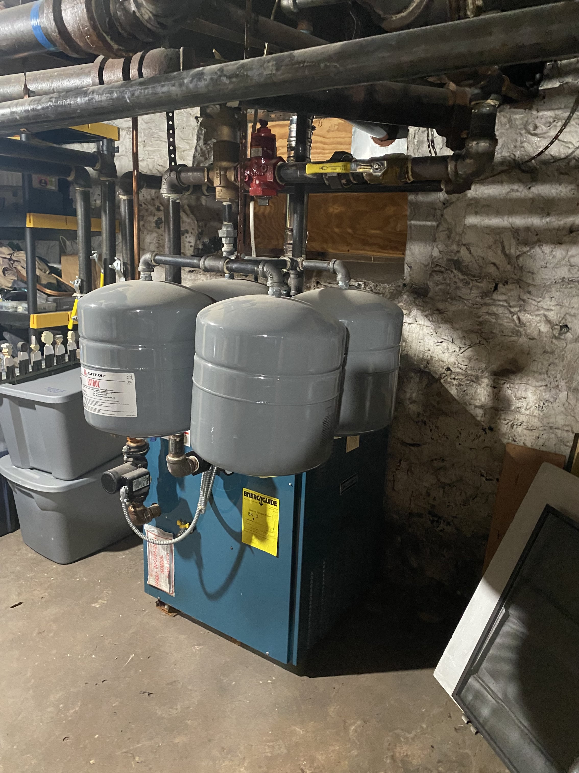

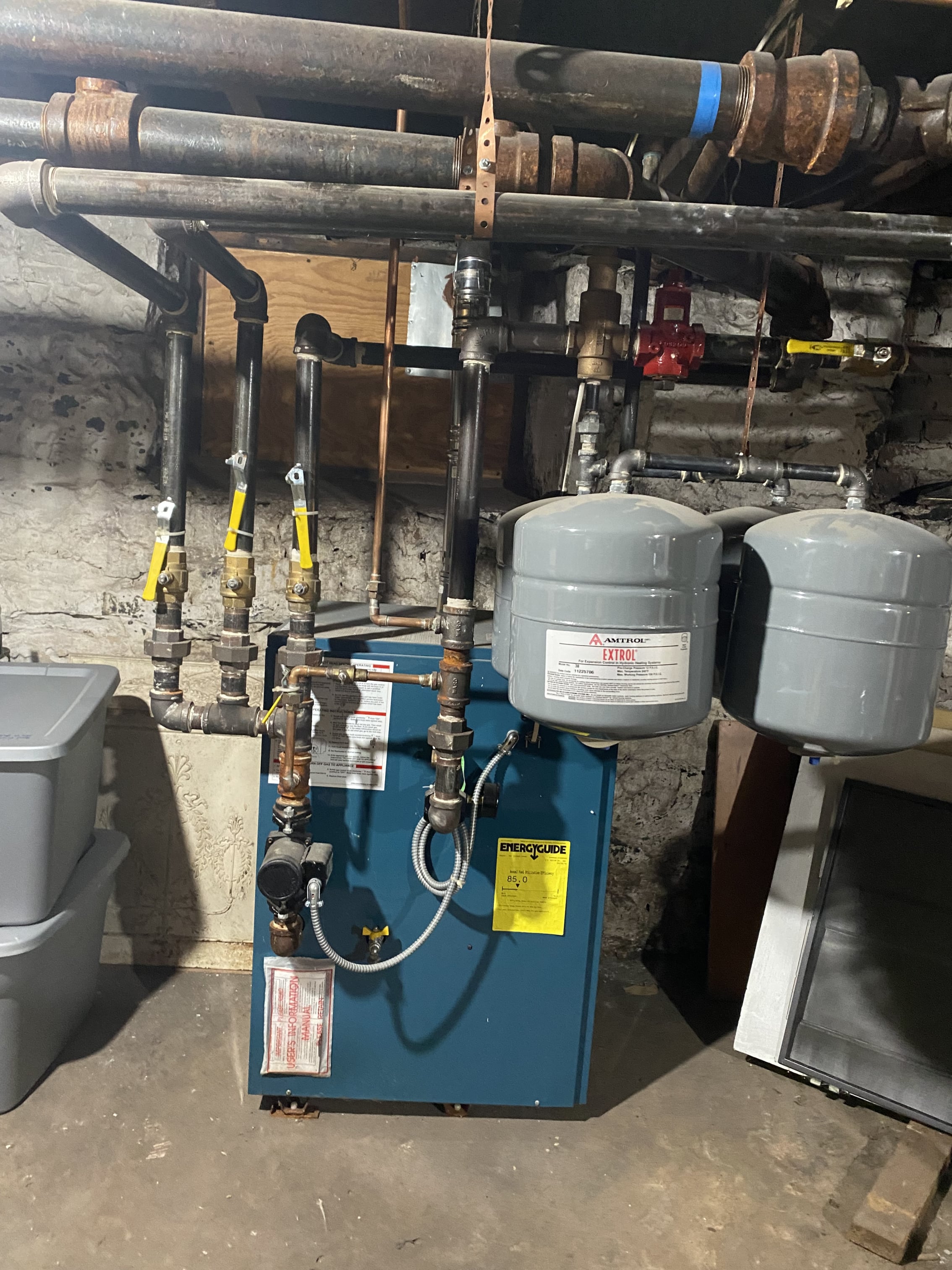

Anyone ever see an arrangement like this?

    what's the flo check for? i don't see any evidence that they are making dhw with that boiler.
    hot_rod Posts: 28,699
    A tank for each one of the little people to the left, to watch over?
    I did see a bunch of #30 on their side on a unistrut cradle once.

    Old gravity system? Probably lots of expansion/water volume. As strange as it looks, easier to source #30's, then 60's or larger, when replace time comes. Lots of supply place, don't carry anything larger than #30.
    EBEBRATT-Ed Posts: 21,328
    " If the relief valve blows add another tank"
    I do like the 1/2" copper supply to return bypass
    The ball valve handles removed to prevent balance tampering.
    0-30 psi ASME tanks are not required. Maybe that is why they used multiples of the cheaper tanks
    Only 1 circulator so no need for a flow check. "We put those on every job but I don't know why"

    That's the staged-admittance configuration. Charge each one a few lbs higher than the next & when one is full the next one takes over.

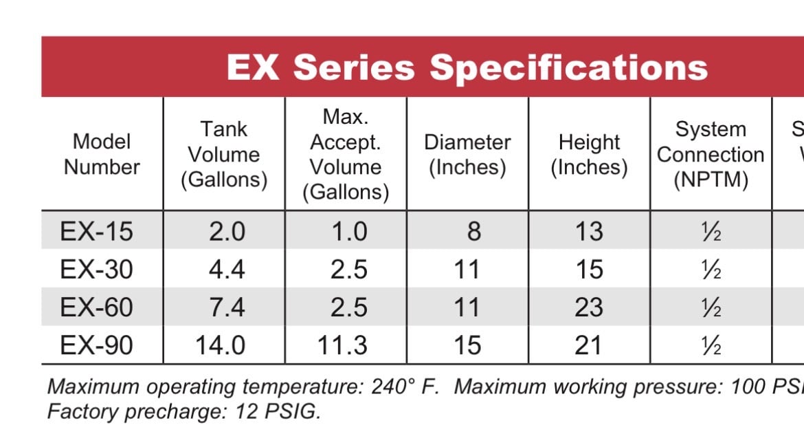

    4- # 30 Extrol= 10 gallon acceptance $252
    1- EX 90= 11.3 gallon acceptance $224.
    The # 30 are easy to find, not so much with the larger sizes
    Also the #30 and # 60 are the same 2.5 acceptance. You get a larger air space with the # 60

    I've hung double tanks in a pinch, but 4??? Looks like a Bunch of bananas 🍌 😆 . Mad Dog

    The flo check could’ve been there because they used to have a coil. Or the boiler maintains temperature.

    This seems like as good a place as any to share amtrols sizing tools! It's not rocket science, and if it is you made a big mistake!
    https://www.amtrol.com/resources-rewards/selection-tools/

    The local RE Michel stocks a floor #30 and can get up to a 90 in a day or two. That’s where I get them. But I also doubt that they would have had four these #30’s on the shelf.
    I wonder if they started with one and then kept adding them until the relief valve stopped releasing.

    The only problem is if it’s an old gravity system, then you have to calculate the water volume in the system. You can’t use the quick sizing chart. Most technicians don’t know how to do that.

    out of curiosity when you mention a floor mounted number 30 tank are you talking about a floor mounted tank similar to an ex30 or an SX-30V? I only ask because I have seen contractors in my shop ask for a floor mounted number 30, looking for a 4.4 gallon-ish tank and they get the SX-30V which is 14 gallons (similar to EX90) and end up paying more than they should.
    I am surprised the local supply house doesn't have 4 on the shelf! even with Amtrol prioritizing shipments to big box stores we still have around 50 or so in each branch here.

    With that said, this 4 pack seems to have done its job since those tanks are upward of 20 years old

    When the bladder psi is 4#, you need a lot of #30s.

    It’s neat to see so much threaded pipe. Usually see a lot of copper on an installation like this that isn’t too old. The flow control valve might be needed to stop gravity flow from higher points in the building. There are three returns so maybe one or two come from higher up in the building. The lack of isolation valves for service is unfortunate and that 1/2” bypass probably does very little.
    they probably didn't know they could use copper

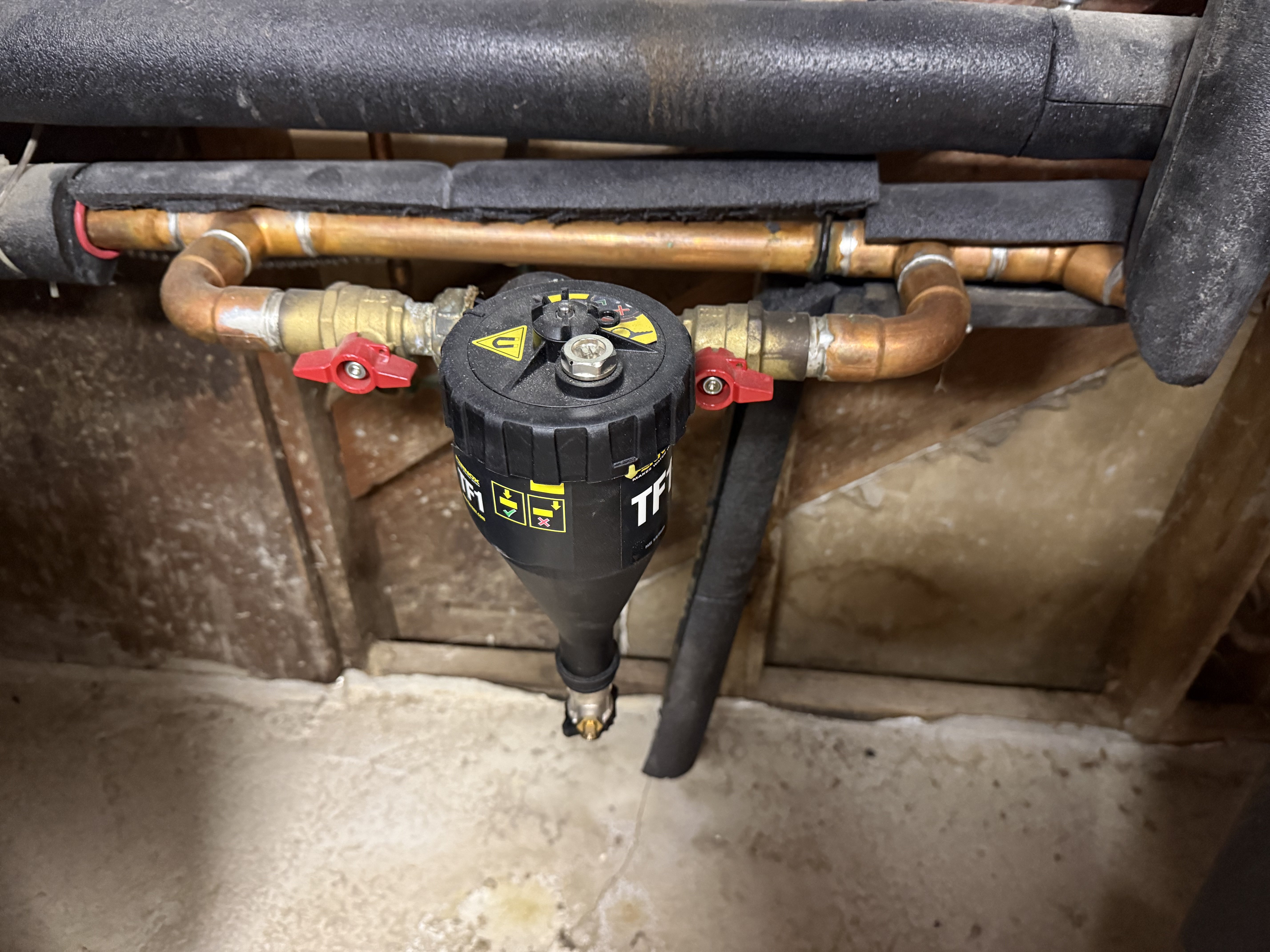

    Saw this yesterday on a job we installed in 2000. Another contractor added it onto the return piping from a radiator system.
