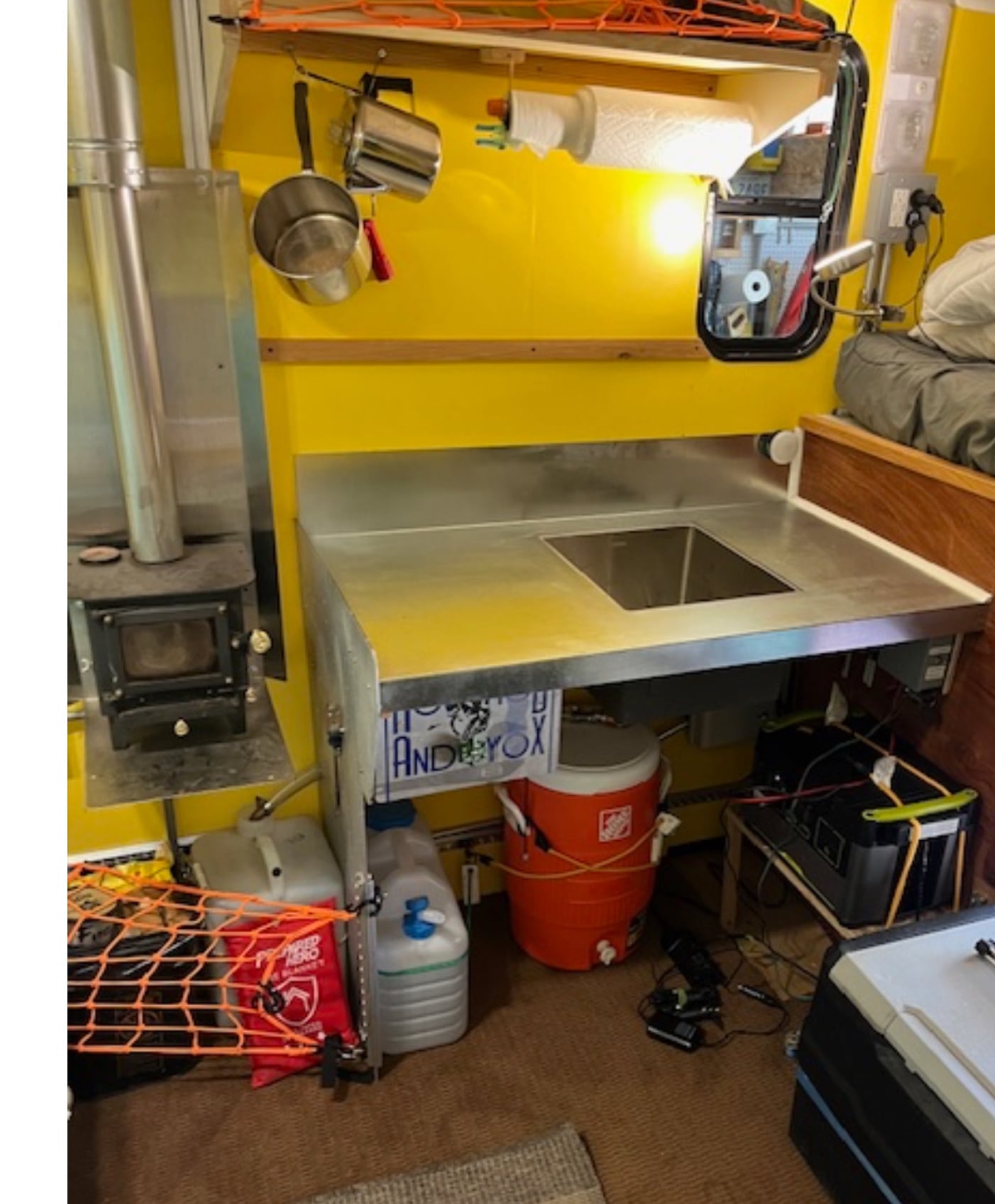

    I live in the city now, so I head to the mountains or desert to burn wood to heat and cook, in the camper, with a Cubic mini wood stove.
