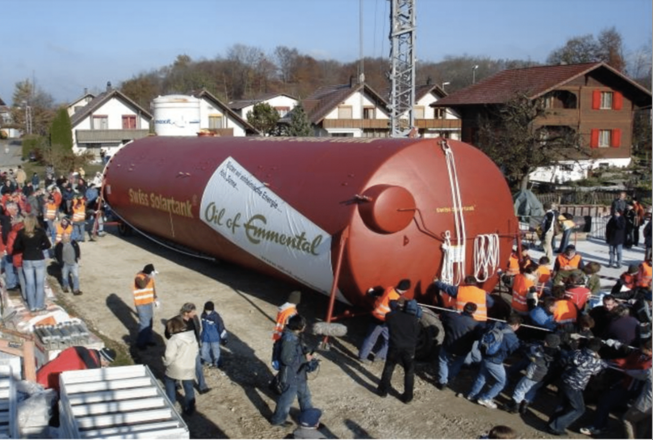

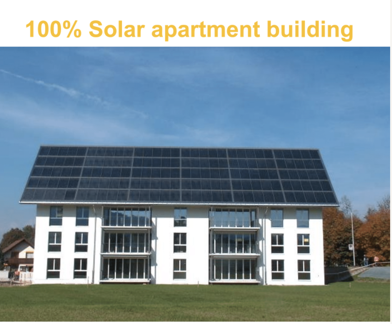

    hot_rod Member Posts: 27,811
    Actually it could be a good option for a small district system to supply their additional buildings. Or with a large buffer tank.
    Personally I'd design a large drainback solar thermal with wood back up. They are in a good location for ST, lots of clear sunny days.
    With enough storage 100% ST is possible.
    This building in Switzerland had enough surplus to pipe some "free" heat to the neighbors. About 54,000 gallons to carry the building heat and DHW year around. The locals raised and lowered that tank into the ground by hand!
    I suppose their budget will determine how creative they will get.
