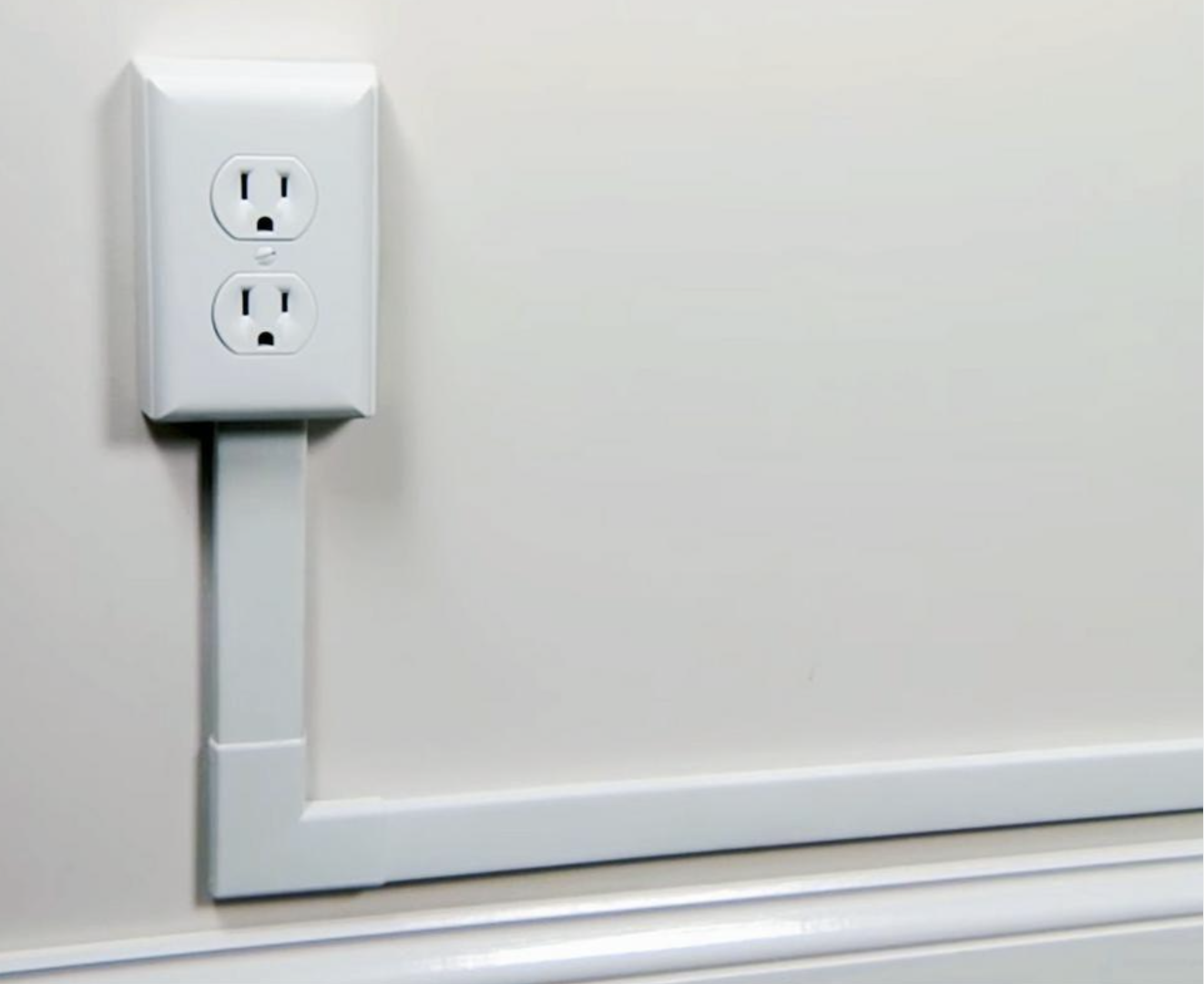

    Has anyone thought of "WireMold"?

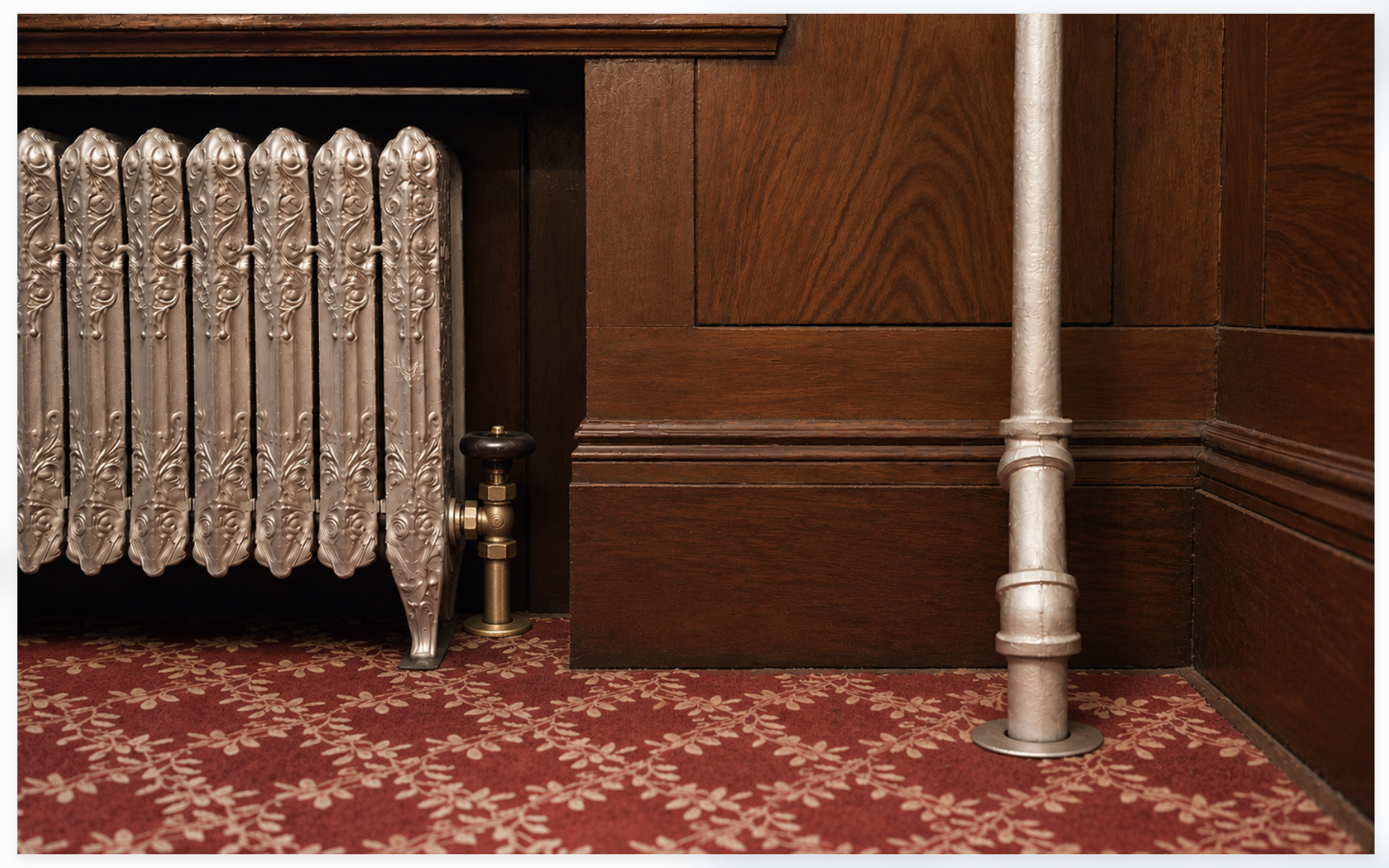

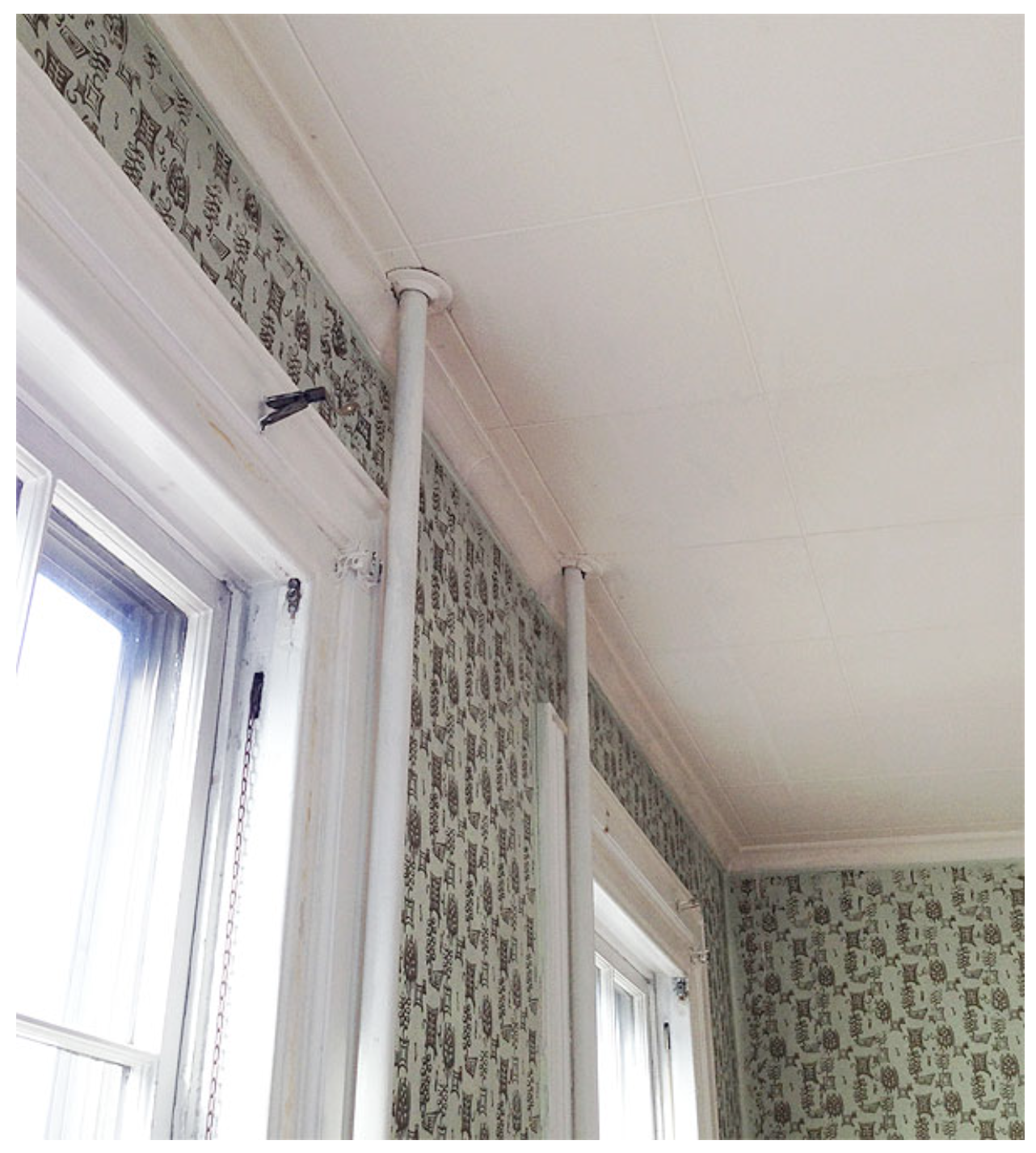

    You don't need to hide stuff in those old homes. There are all kinds of things that are exposed in homes of that age. The pipes for the gravity hot water boilers and the pipes to the steam radiators on the second floor were not hidden inside walls. They were just done plumb with neatly bored holes, so they look nice. here is what I'm talking about.

    No one thinks twice about stuff like this. Well almost no one.
