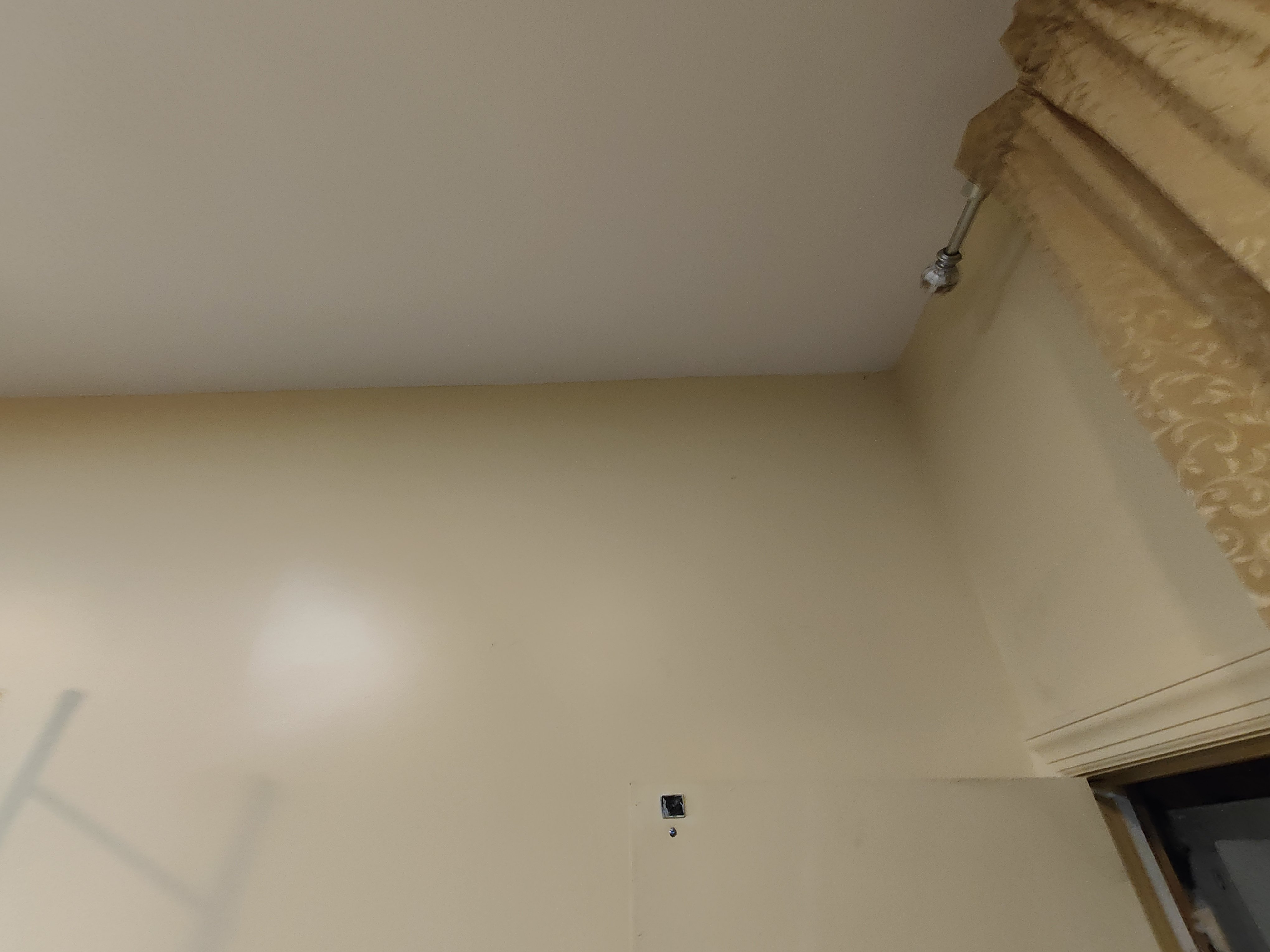

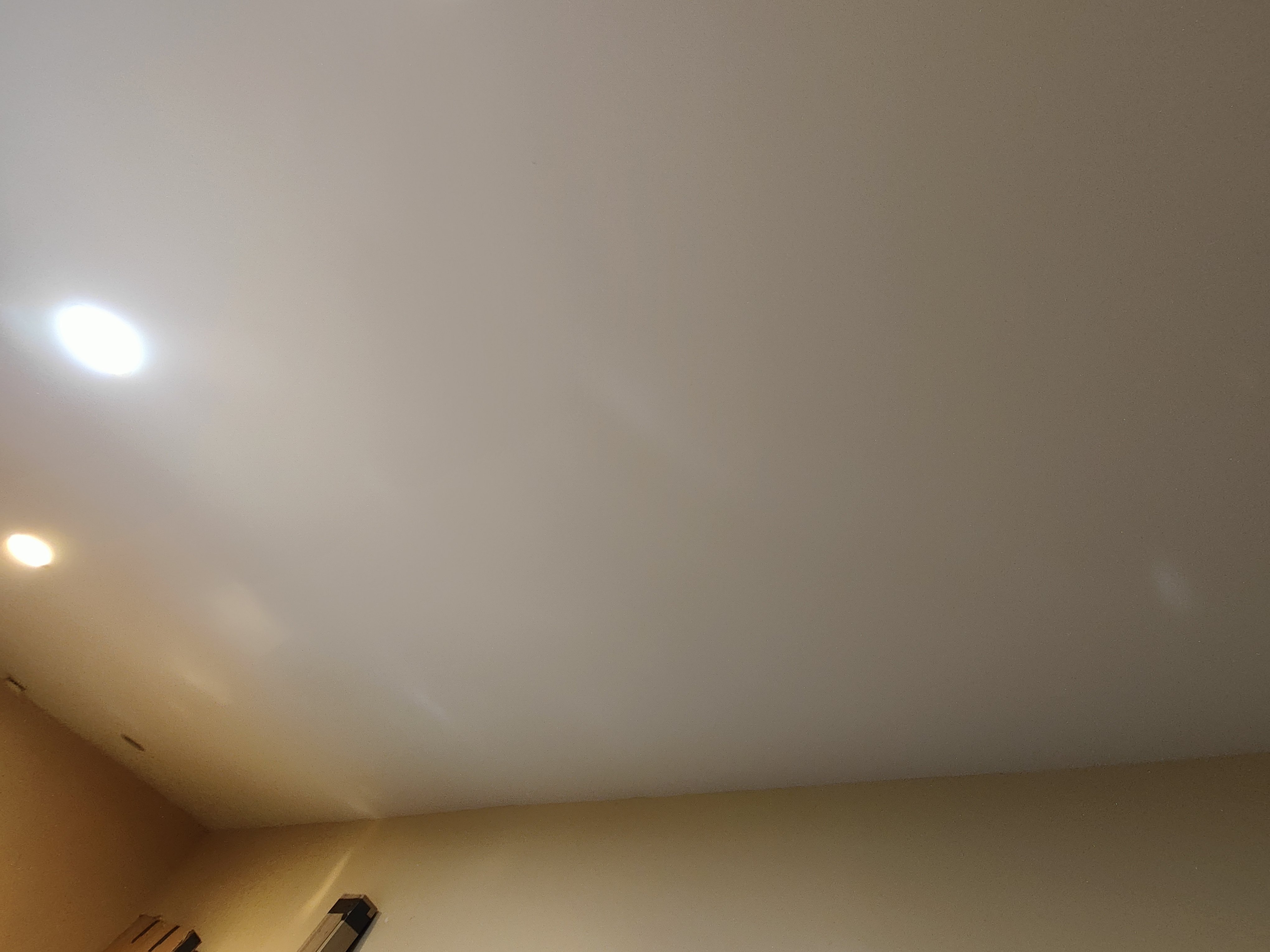

How to pull wire over ceiling

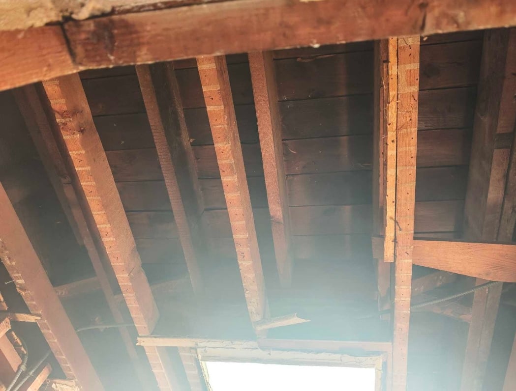

I need to pull some wires from the main panel across a room for a subpanel. I want to pull the wires from above the ceiling. But the span is 20'.
I can open a series of openings to get the string through. But then how to repair these holes?

    is the ceiling plaster or drywall? if there is no framing in the way you should only need to get to each end and can pull it with a fish tape or pull string or fiberglass rods. sometimes a tape measure works well to get a pull string through too.

    is the ceiling drywall or plaster?
    Flat, swirled or spray on popcorn?

    Its drywall ceiling, with recessed cup lights installed
    Do you mean a plaster ceiling has some gap inside it to allow pulling wire?

    plaster vs drywall changes how you patch it. plaster is easier to patch. drywall you will have to cut out a piece that either lands on 2 joists or screw some blocking in to screw a piece of drywall to. then mud and tape the joints. in the ceiling probably taper it out at least 12" on each side of the tape.
    if it is textured you will likely need a good plasterer to make a patch that blends in.

    Pop the recessed lights out. Use those holes and then put them back.

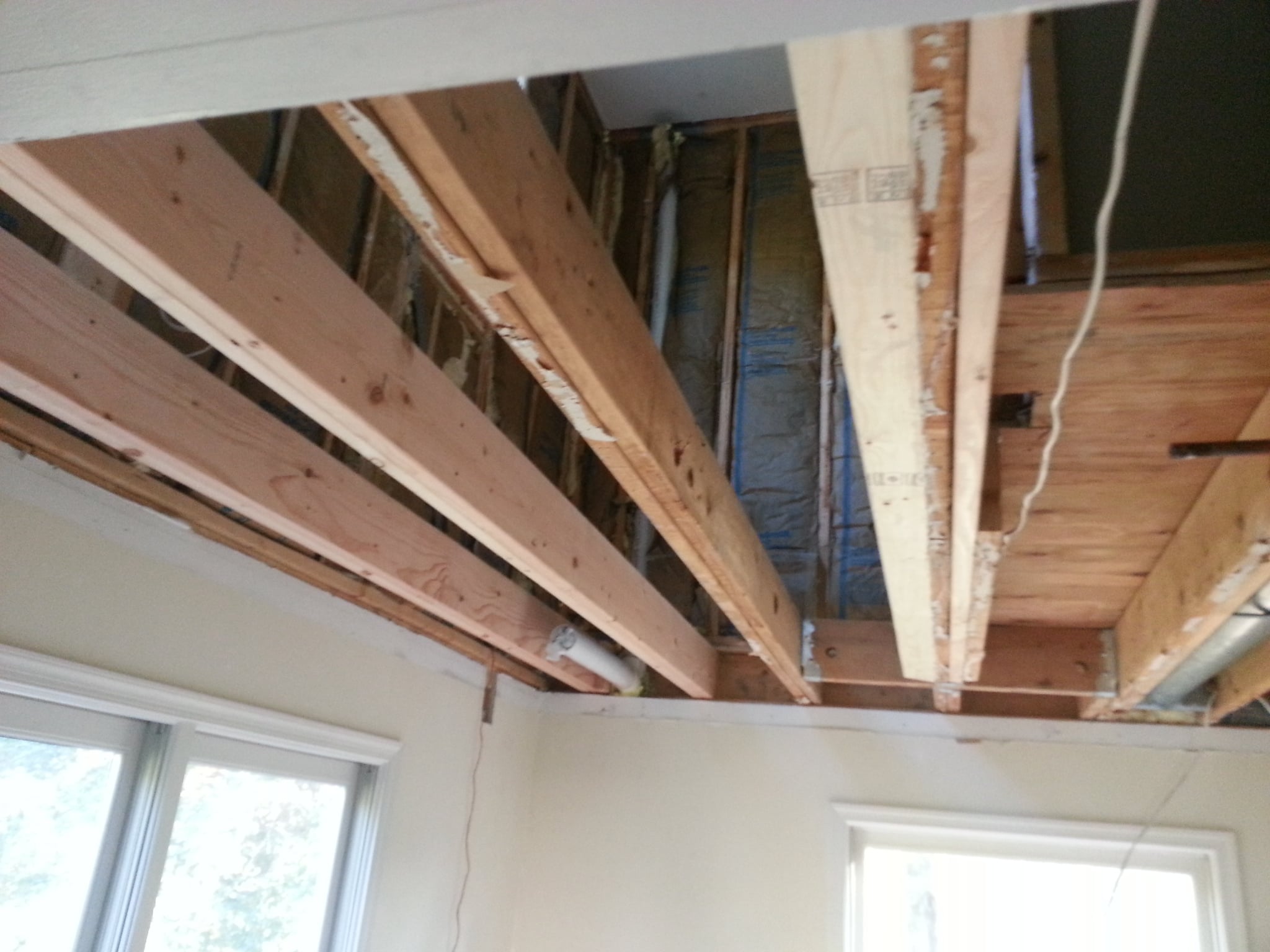

    There will be joists running one direction as illustrated below. Level of difficulty is based on if you are going in same direction as joists or having to drill holes in joists to pass wires through.
    You may also be dealing with engineered 2X4 Truss joist which are simple to pass cables through; see below.

    these truss joists are 22" high. I'm almost certain the flooring is not that thick. should be
    ~10" joists against the direction that the wire will go through

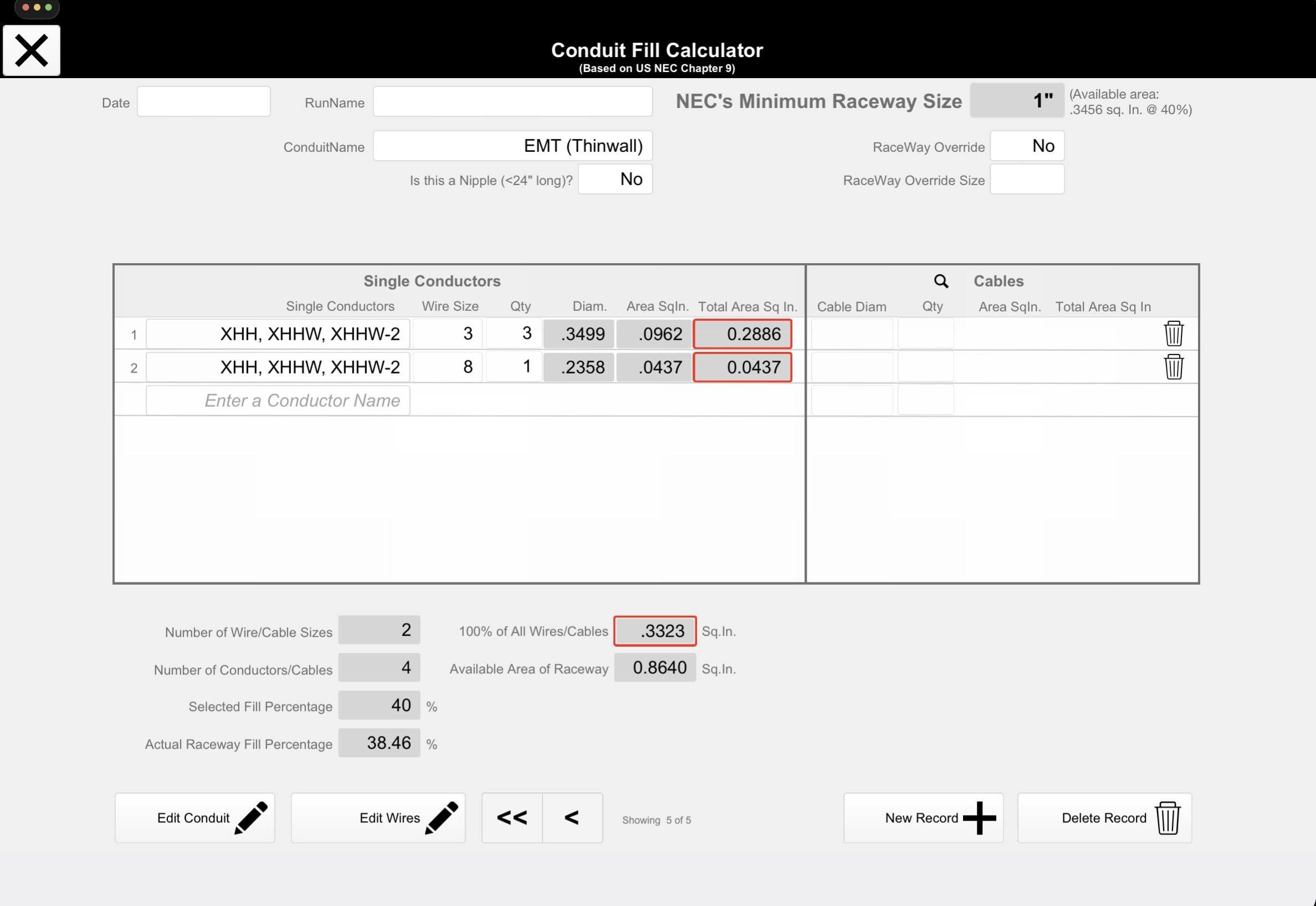

    ratio Posts: 4,337
    Individual conductors in one raceway (e.g. EMT, or flex). The NEC has all the info you need to size it properly.
  • wayneb301
    wayneb301 Posts: 136
    the main panel has extra slots. however, other than the 50a outlet, there are a couple of switches, outlets and lights, window AC that needs to be powered, other than a sub panel or load center, what fits?
  • wayneb301
    strip off the outer jacket and use the individual wires with the flex raceway?
    and this make the 75c ampacity chart applicable?
    with the outer jacket, then 60c chart applies?
    mattmia2 Posts: 18,306
    edited September 1
    both the cable and the terminals in the panels and on the breaker need to be rated at 75c to use the 75c column.
    if i am reading the code right, ser cable can be used at the 75c if both of these are true:
    1. It does not pass through any insulation
      AND
    2. all of the current carrying terminals it will connect to on both panelboards and the breaker are rated 75c.(the ground probably does not need to be 75c. the minimum ground size will come from the table in the code)
    if you used raceway, ent might be most cost effective, you would buy thhn or xhhw wire or something like that.
