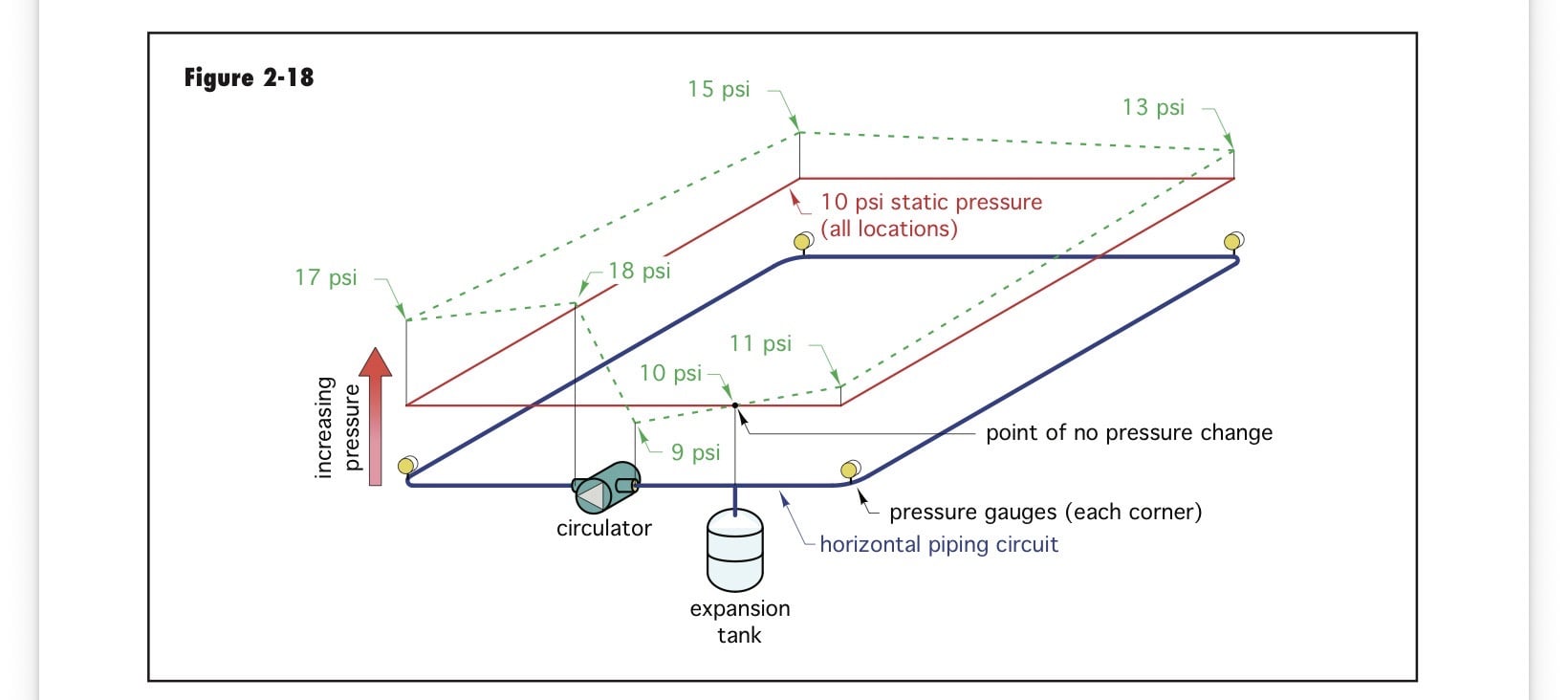

Any air purger works best when you are pumping away from the expansion tank. The graphic below shows how the pump adds the pressure differential to the system, when pumping away
So boiler, air sep, expansion tank, pump.

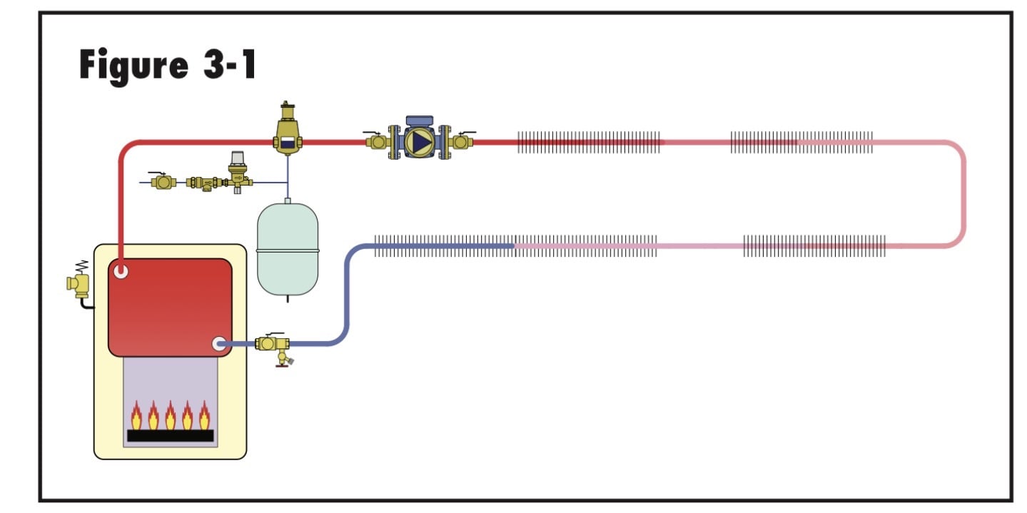

Typically the expansion tank connects under the air purger. The fill system connects at the expansion tank also.
Living the hydronic dream0 -
So ya my current setup is wrong for sure, the air eliminator is right after the circulator. Looking at the mfg pdf for the boiler my expansion tank is connected to what is labeled as the relief valve outlet according tohttps://dunkirk.com/wp-content/uploads/2022/03/2304_0.pdf . Which seems odd to me.The more i look at my setup and compare it to the pdf the more i question what the installers did.
It is possible to have the expansion tank connected into a port on the boiler, with fiill and relief, pump on boiler supply and air purger after the pump.
IF you use a good air sep like a Caleffi Discal, it coulld be after the pump. You are still pumping away from the expansion tank.
Any of the microbubble type air seps can be on either side of the pump with no piping distance required.
Air comes out of solution best at the hottest point and the lowest pressure. So suction or inlet side of pump., is the ultimate
Additionally the expansion tank could be on the return piping, but air sep at the hottest point, supply out of the boiler.
