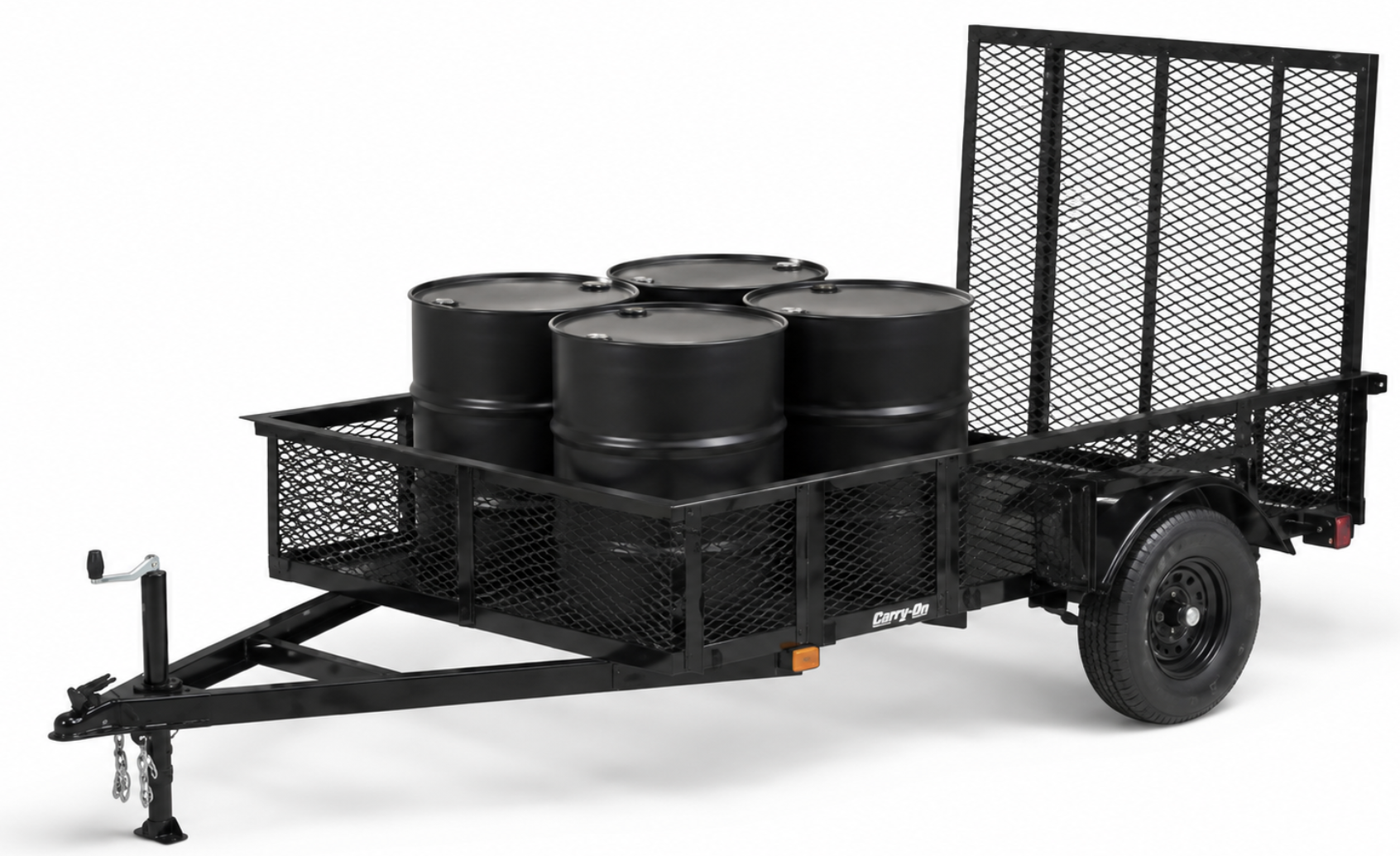

    Tried to add to your post about "oil fired combi" a few minutes ago and all of a sudden it vanished.
    You said "Frankly i have wondered if i could get a 50 or 100 gallon tank to tow with the car since for some reason diesel at the pump is less than getting oil delivered and its a nearly identical product ( except heating oil isnt getting hit with road tax like diesel does so in theory it should be cheaper right? )"
    I was wondering if this might due for you?
    I did something similar with this setup to service and install new 275-gallon tanks so I could remove the oil from the old tank in order to install the new tank. I also had a toolbox on it with an electric-powered fuel pump to suck the oil out of the old tank and into the drums, about 100 feet of hose with an automatic nozzle on the end, and about 12 feet of reinforced suction hose so it would not collapse.
    It worked out great for me.
    EdTheHeaterMan Posts: 12,880
    Then I thought, if you were going to get fuel from a truck stop. yopu might be able to find a filling station that also sells OFF ROAD DIESEL for farm and construction equipment. That would save you on the road tax.
    Then I thought if you were interested in this idea, would you let your friends use that trailer to do the same thing? …or would you just do it for them? …You could make a little extra scratch with this side hustle. Or would you just sell the fuel for the same price as you paid for it? Then who pays for the gas and wear on your tires?

    EBEBRATT-Ed Posts: 21,190
    Not sure it would be legal to haul oil around in barrels. It's usually considered hazardous waste even if it was new oil. Probably have to put placards on the trailer.
    Somebody rearends the trailer and you have a spill, can't imagine what that would be like. And would a place that sells diesel even let you pump it into barrels?
    I know, just being a jerk.
    hot_rod
  • leonz
    leonz Posts: 1,968
    No, you are not being a jerk EBERATT-Ed, putting a bulk fuel tank ment to be placed under a pick up truck tool box is a common practice and can be done on a trailer as long as it is strapped down and properly labeled with a hazmat placard.
    TdiGuy
    pecmsg Posts: 7,613
    plenty of fuel tanks approved for the back of pick up trucks and trailers.
    farmers and fishermen use them all the time
