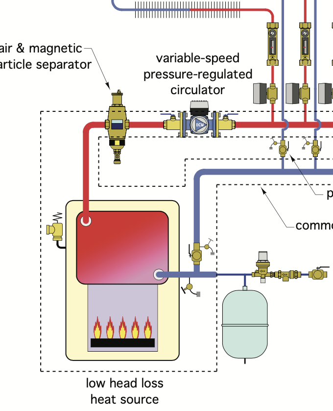

    hot_rod Member Posts: 27,855
    Any air purger works best when you are pumping away from the expansion tank. The graphic below shows how the pump adds the pressure differential to the system, when pumping away
    So boiler, air sep, expansion tank, pump.
    Typically the expansion tank connects under the air purger. The fill system connects at the expansion tank also.

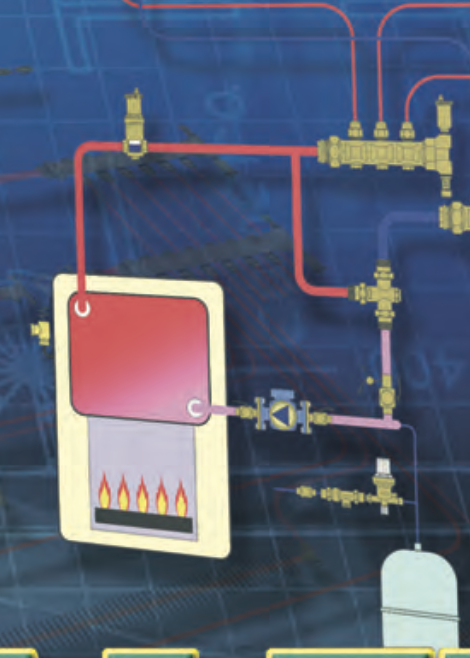

    It is possible to have the expansion tank connected into a port on the boiler, with fiill and relief, pump on boiler supply and air purger after the pump.
    IF you use a good air sep like a Caleffi Discal, it coulld be after the pump. You are still pumping away from the expansion tank.
    Any of the microbubble type air seps can be on either side of the pump with no piping distance required.
    Air comes out of solution best at the hottest point and the lowest pressure. So suction or inlet side of pump., is the ultimate
    Additionally the expansion tank could be on the return piping, but air sep at the hottest point, supply out of the boiler.
    Other options here.

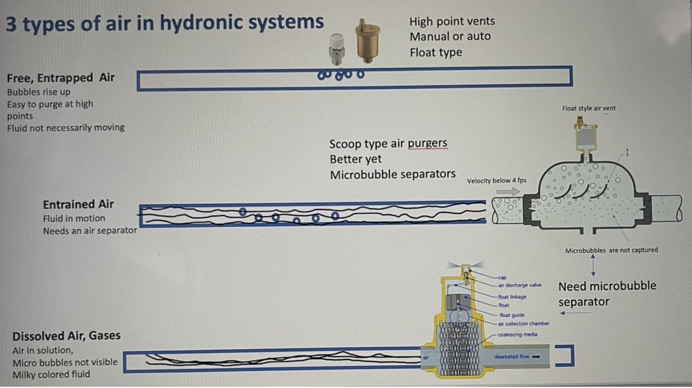

    Back at the boiler use a good brand air separator. These are 95% efficient within a few passes of all the water through them. Within an hours running, up to boiler high temperature a system should be air free. Big bubbles and micro bubbles.
    The ramp type are not as efficient as there is no media inside to capture the micro bubbles, and they need straight piping, about 18" upstream.

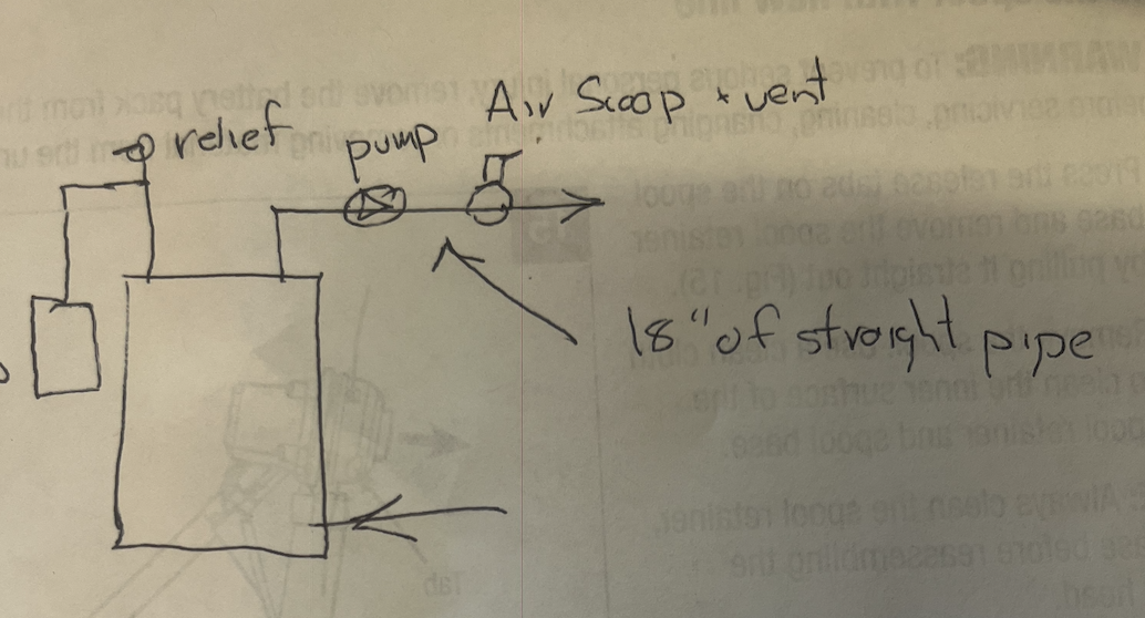

    So, i have a high point auto float type with one of those scoops. But its directly after the circulator. Its also the only air eliminator in the system other than manually opening the drains on the returns.
    I thik this is what you have? It can work ok, ideally you want 12-18" of straight pipe between the mpump and air scoop/ vent.
    Also vents do plug or the floats can stick and not do any elimination.
    A good air separator can make a difference with air noise, increase system efficiency. You want water with no air traveling through the boiler, pipes, and heat emitters. For top performance.

    Most manufacturers flow test their air separators at different operating conditions. Results show better efficiency and faster removal with microbubble type seps.
    The tiny microbubbles that develop at the boiler wall need to combine it a large bubble before a scoop purger will grab and expel them.
    Systems with chronic air problems do well with the microbubble removers. Withinan hour you should have complete air removal.
