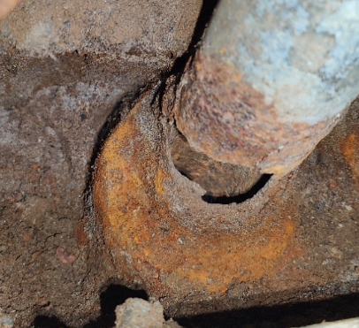

    I have always used a 1/4" drill bit to remove the lead. If a length of pipe was still in the hub then a 16" long bell hanger bit was used.
    Then with most of the lead drilled, a hook was used to dig out the remains.
    Then the pipe stub could be removed and the oakum drilled or hooked out.

    when the lead was packed in, it should be slightly lower than the rim of the hub, like the photo shows. but in my photo, why is the rim not visible?
    Steamhead Posts: 19,007
    Looks like a lot of rust covering the rim.

    do some digging and scraping and see what you find. you can't make it worse.
    there is some sort of caulk substance that has been sold for years for use in place of the lead, it could be that too or the lead could have been poured flush and not packed

    I worked on it with a 18" bell hanger bit for about 30 minutes, then I had to leave for the day. I made several holes, but was not able to go very deep. after about 1/2", it became very difficult to go any deeper, then the progress flattened out, but you can see it's still very far from reaching the bottom
    is there a more efficient way to do it?
    the lead should just be a cap on top, there should be oakum which is oiled hemp fiber packed in underneath.

    Why the drill bit was not making progress through the horse hair?
  • PC7060
    PC7060 Posts: 1,980
    No idea why it’s not penetrating are you on the cast iron neck?
    I use a narrow chisel or screwdriver to get through and remove the lead.
    sometimes there is cement impregnated in the hemp which would grind the edge off the bit. they could have used all sorts of other things instead of oakum too.

    The long bit was used if there was still a section of pipe connected to the hub, the length gave the clearance to keep the drill clear of the pipe as the long bit would bend somewhat.
    Now that you have no pipe, just a broken stub, you could use standard bits.
    If you are drilling lead it will spiral up very easily.
    You might have concrete in the hub? Perhaps try a masonry bit.
    My father used concrete for lead joints in 1942.
    PC7060
    And if there really is horsehair in there it will foul the cutting edge of the bit and keep it from cutting..
    there could be some concrete on top of the lead that got there when they poured the floor too, that would take the edge right off the bit. maybe try tapping around with a small chisel or an old screwdriver and see what comes off.

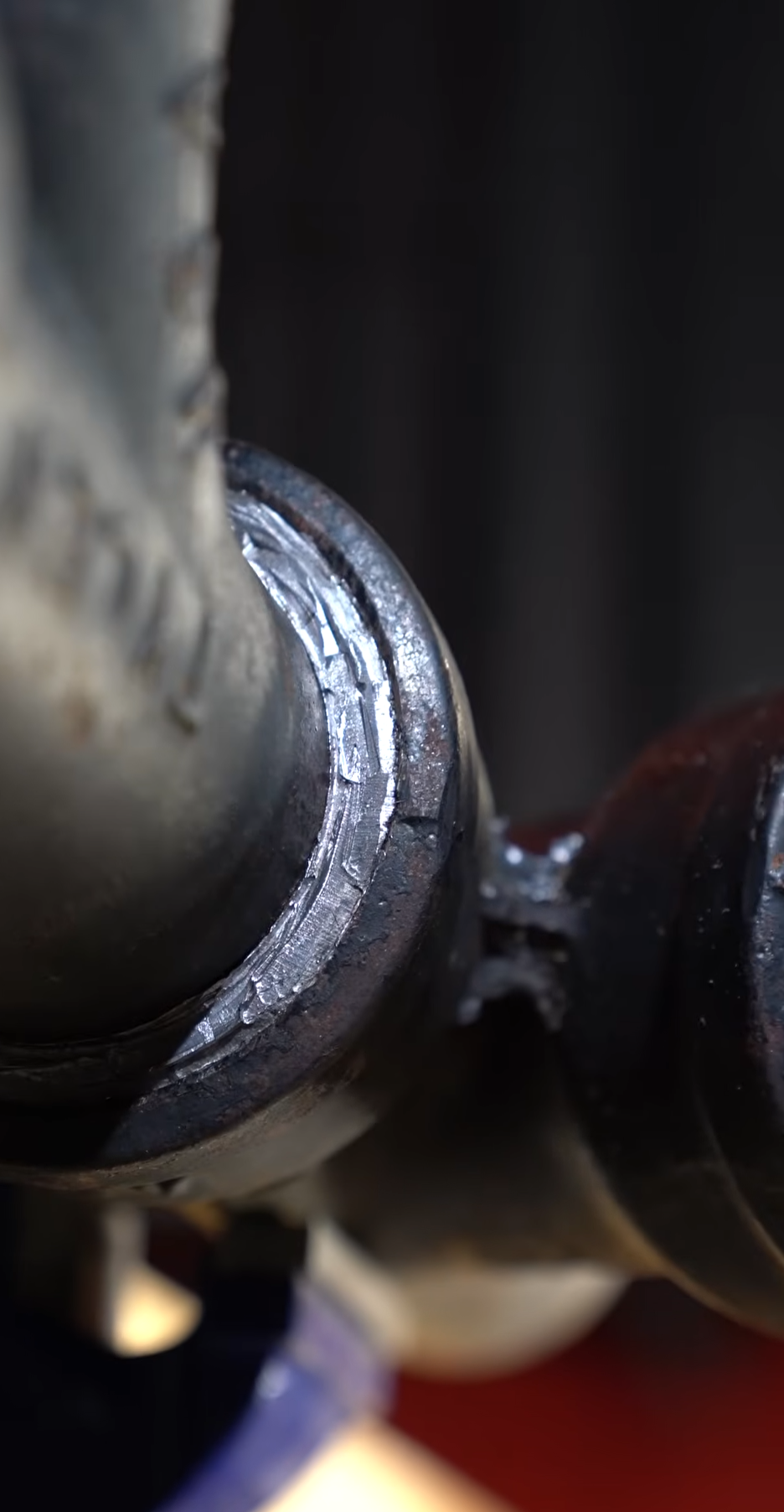

    in that new picture it definitely looks like there is some mortar or concrete that ended up in the bell of that fitting one way or another.

    It's a tiny piece that I chipped off yesterday using a hammer and demo screw driver. The shiny color shows it's lead. I don't know why the drill / screw driver don't make progress. When I knocked on the screwdriver, I felt a large resistance preventing it to go deeper
