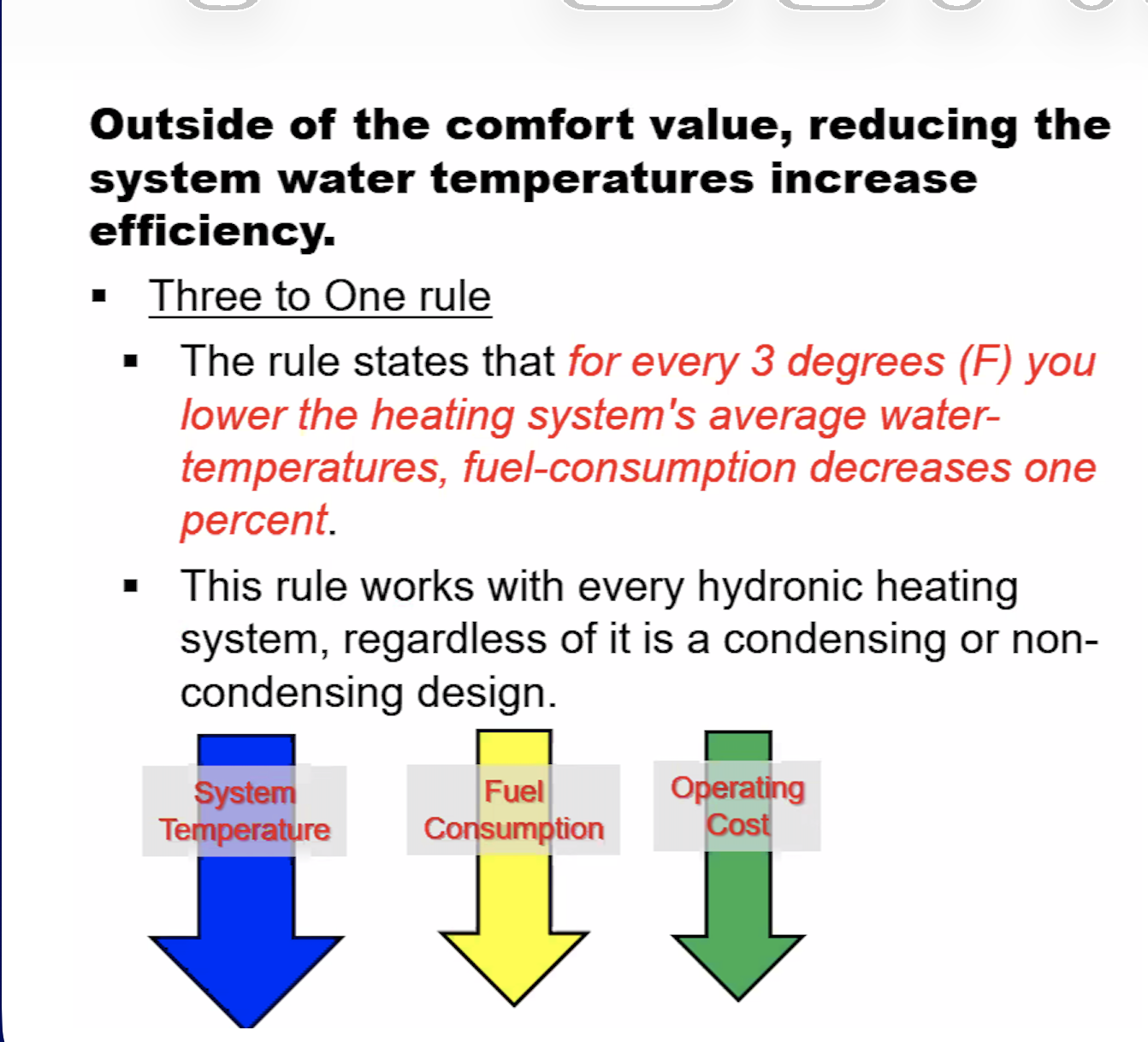

    hot_rod Member Posts: 28,303
    I think you are missing the point of a condensing boiler. It will condense and run 90% plus on some, maybe most of the year. But we don’t have enough specifics on you application
    Location, heat loss of the building, amount of fin tube, boiler sizes)
    A short cycling cast boiler on a mild day may be running low 70%, while the mod con on the mild days 90%.
    A WAG of 25 btu/ft X 4500 sq ft =112,500 load on design day.
    Ultras are available from 80-399,000
    Assume someone sized it correctly, a 155,000 Ultra would be adequate. It turns down to 30,000
    I doubt the cast iron has any turndown, so on a low load day it is 10 times too big, maybe more if it is oversized.
    Care to share anymore data? At this point the comparison is just which type you like better, no data to base a best decision.
    If efficiency is the goal, which seems why you started the post?
