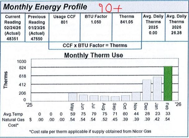

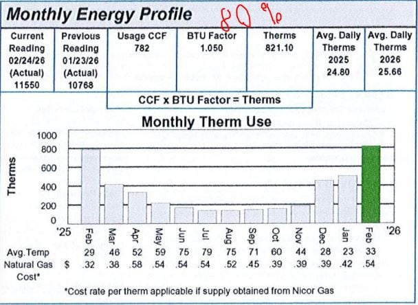

My dad owns 2 buildings that are essentially exactly the same. They were built at the same time and are next door to each other. One of them still has an 80% Burnham from the 80s heating it and the other has a Ultra Series 2 that was installed a few years ago. They both have a wireless sensor system monitoring temperature and regulating based on that. The temperature is set to 73 in both buildings in the winter. Both buildings have the same water heater BTUs installed as well. I cleaned the exchanger on the Ultra last year, although once I opened it I found it wasn't very dirty. The Ultra does NOT have any kind of "Boiler Buddy" tank.
As far as I can tell everything is the same, the only difference is the boiler system installed.
However, when we look at the heating bills they are very close, sometimes the Ultra boiler building is noticeably higher. Is this normal? Or is there something wrong with the Ultra?
I've attached photos of the Therm usage. I'll get photos of the boiler setups.

    @EBEBRATT-Ed the graph is in therms. So it's 80,000,000 btus. These are 11 family buildings.

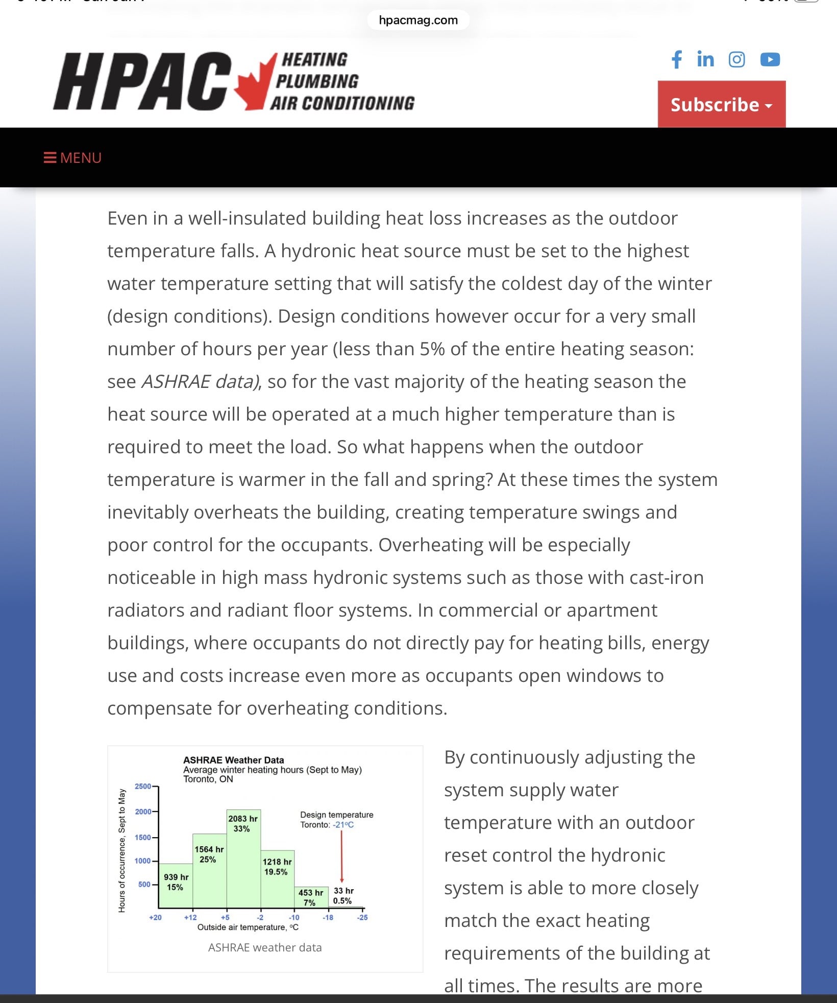

    Even if the fin tube was sized for 180 SWT on design day maybe 85- 90% of the heating season it a could run at a lower temperature. On a mild or moderate load day you could perhaps supply 140 at. 20 delta that would allow the Ultra to condense and get into the 90% efficiency.
    It’s rare to find a building at design condition all heating season
    It really depends on how the control was setup as far as fuel savings potential.
    Find weather data for your location to get an idea of % at design. The example below shows Toronto at design condition about 33 hours September- May
