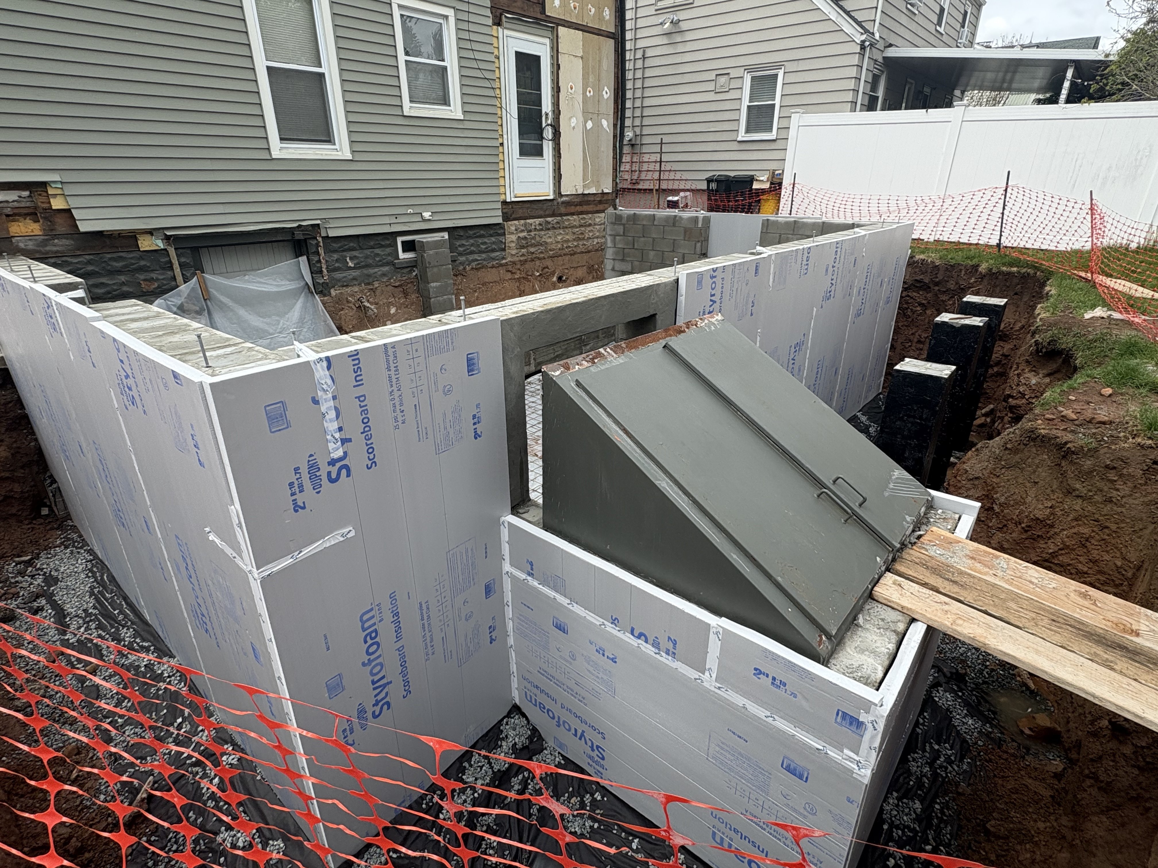

Foam in place, against all odds

How are you going to insulate the door and around it? It looks like a big hole in the insulation right now.
I'm sure the builder will figure it out, I'll let you know
If building from scratch what's wrong with insulation on inside of block wall?
nothing is wrong with it but putting it on the exterior is easier and better
When you insulate the exterior, you have fewer issues with exposed areas causing condensation
You also don’t lose interior space
And I can still insulate the interior as well of course
Insulation on both sides seems like it would be an issue like double vapor barriers.
You can't do that, you trap moisture / water.
I guess you could do fiberglass / wool without a vapor barrier.

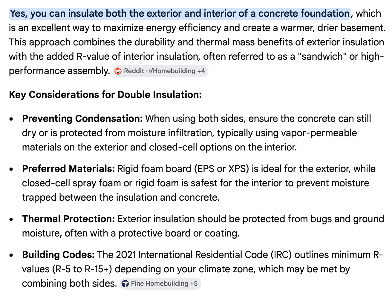

Sorry to haul out the AI, but this is a solved problem:
AI told you you could use closed cell spray foam to prevent moisture from being trapped.
That kind of proves it's completely wrong, doesn't it?
I don’t think it said that. It said you could used closed cell spray foam on the interior
Correct.
But the interior is where it should be "venting" moisture towards.
The outside is sealed via styrofoamfoam, caulk, tape etc.
You can't put a moisture / vapor barrier on the outside and inside.
You make a good point also because the exterior has a water resistant tar-like coating on it regardless of insulation there. So I would have to make a vapor permeable insulation layer on the interior in any case, right?

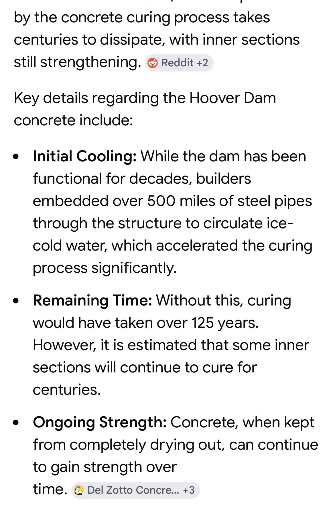

125 years for the Hoover Dam to fully cure. The embedded piping reduced the time a bit
Living the hydronic dream0 -

500 miles of pipe in the dam.
Just tell me they threaded it all by hand LOL.
Wonder if it was leak tested😂😂😂😂
