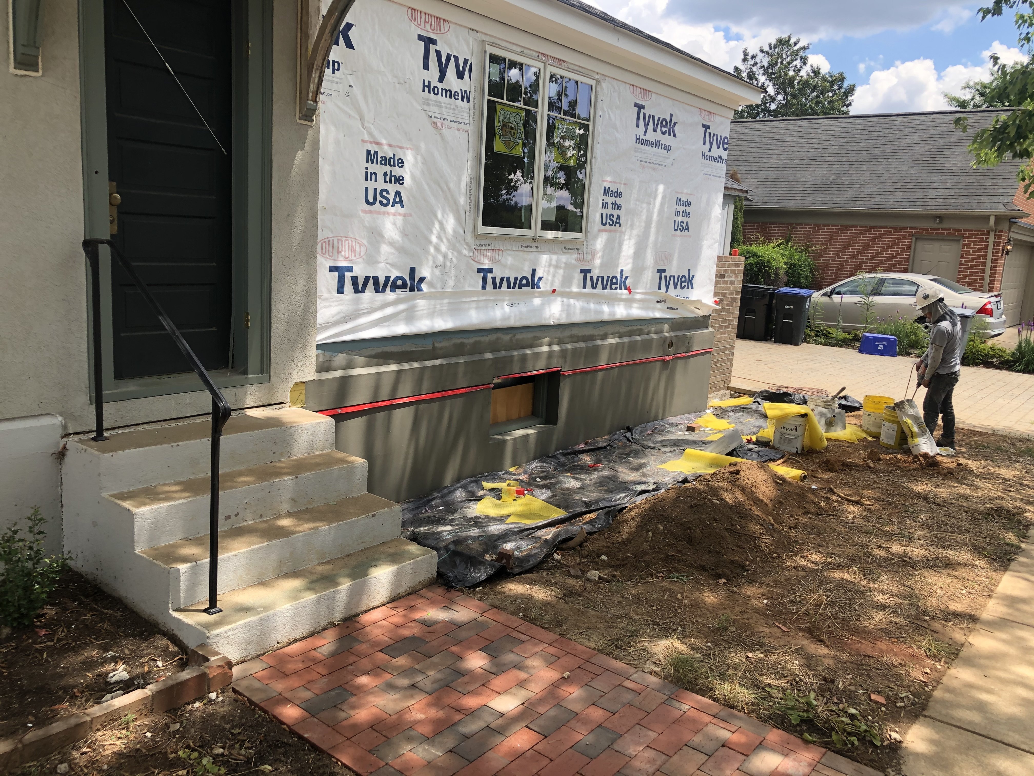

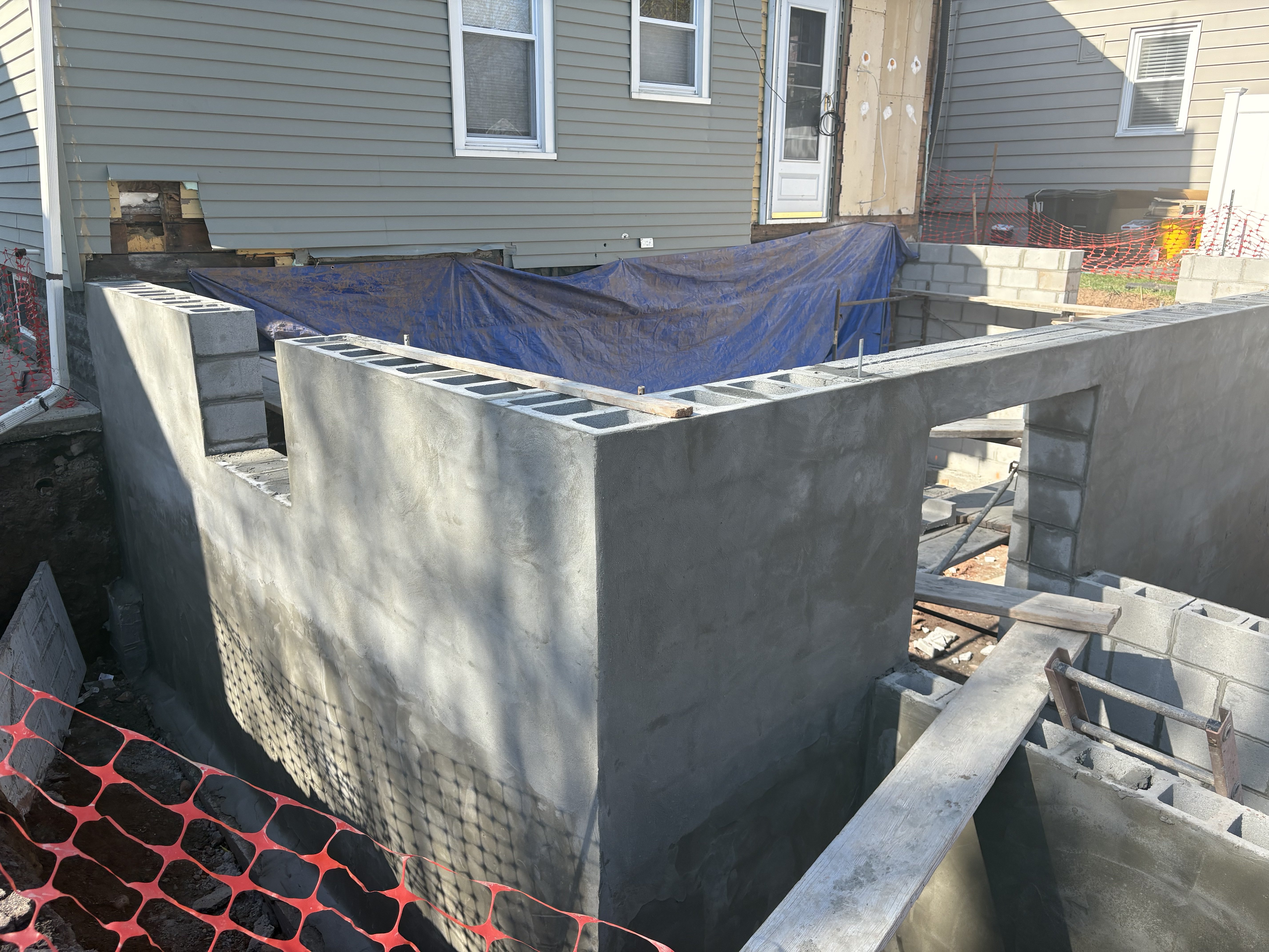

Hey gang—
Has anyone been involved with exterior insulation (probably 2” poly-iso panels) on a new foundation (in this case on an addition)?
Here in NJ they just like to insulate in the first floor joists, but I’d rather consider the basement to be my building envelope and keep the heat inside even though the basement is unfinished.
I think I can get the contractor to do it, but they are hesitant to have it on the top 4 above-grade courses, which in my mind are the most important ones.
I have read you can put cement board then mortar/stucco over that to cover the foam board.
Has anyone done exterior foundation insulation? Thanks!
(they just put the “plaster” layer of mortar over the blocks yesterday. Next is the sealant I’m told)

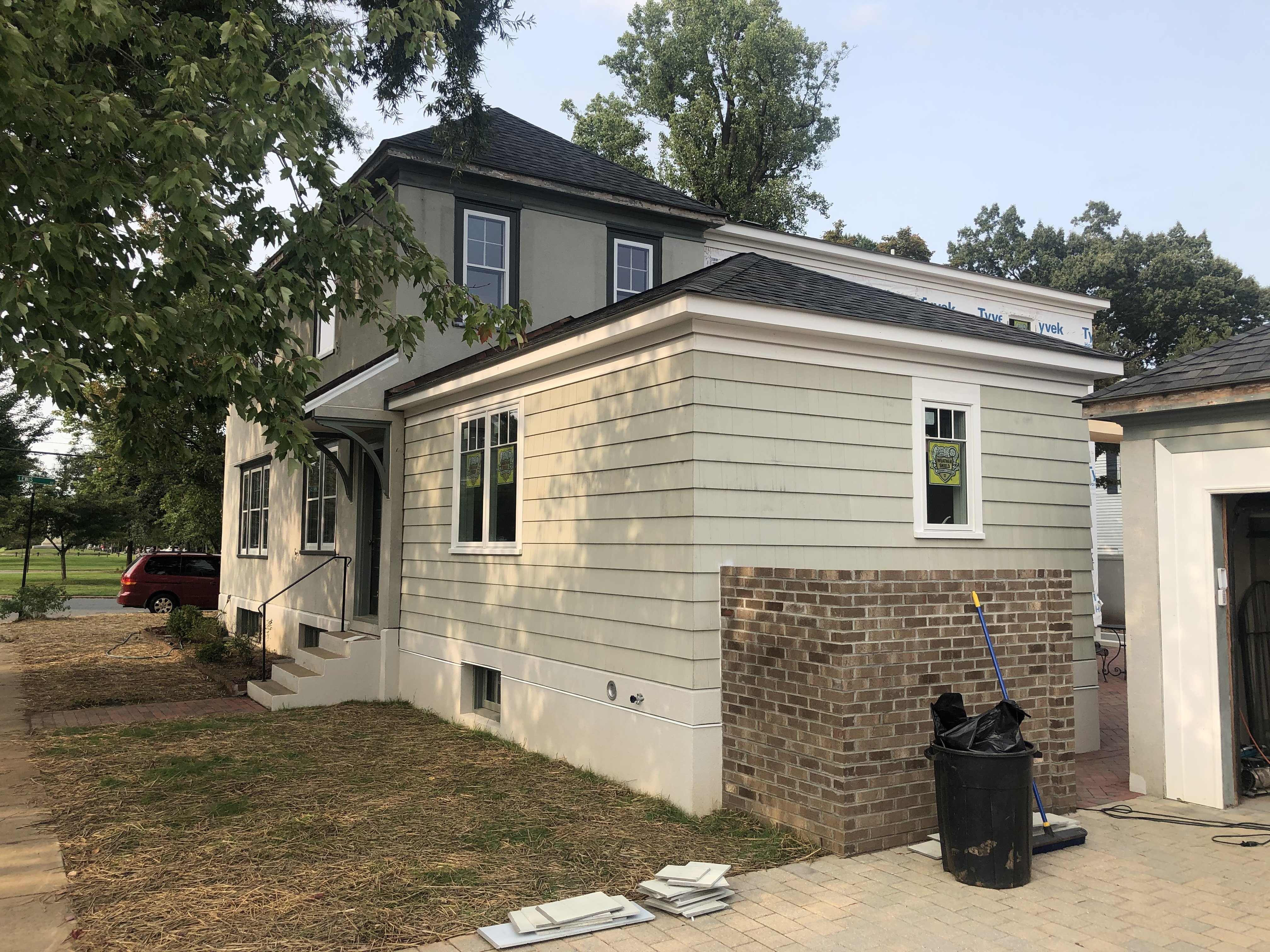

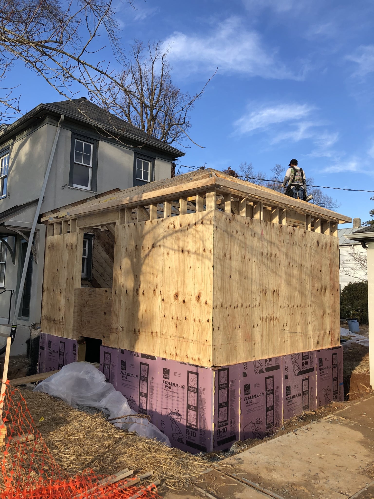

    I used 2” XPS screwed to top plate with foam adhesive to attach to foundation. It’s important to plan ahead on how to the transition from foam to the siding, especially the flashing
    GGrossethicalpaulLarry Weingartenhot_rod
    i'd cover it in stucco.
    you have to coordinate the wall assembly so it doesn't stick out beyond it
    make sure all f it is sealed up against rodents, the foam is capped with masonry so they can't burrow and tunnel up through it, the interface between the top of it and the bottom of the siding is all sealed off so rodents can't climb under the siding because they can climb up the masonry

    thanks @PC7060 and @mattmia2 that is perfect and exactly what I was looking for.
    I will have to do a sloped transition near the sill plate I think in order to not have to get into modifying the framed part.
    It blows my mind that contractors here (at least mind) have never heard of this

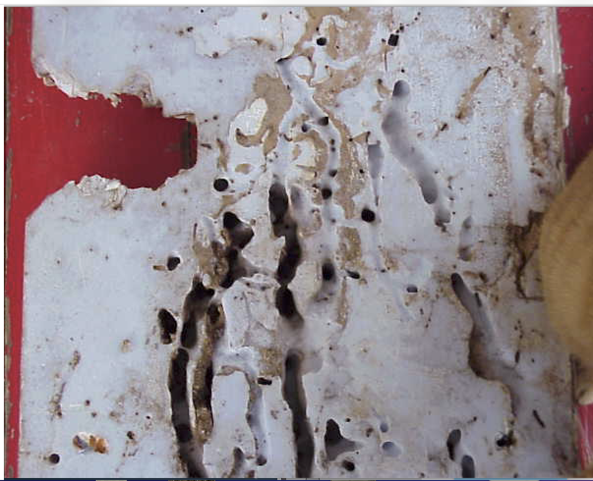

    Hi, I did something similar building my house. in California, termites are a concern with foam, so termite shielding and good flashing above the foam are essential. I just bought copper sheet and had it bent to form that flashing, so will never need to worry about replacement. Getting the copper sheet metal cost less than getting preformed galvanized back then. 😊

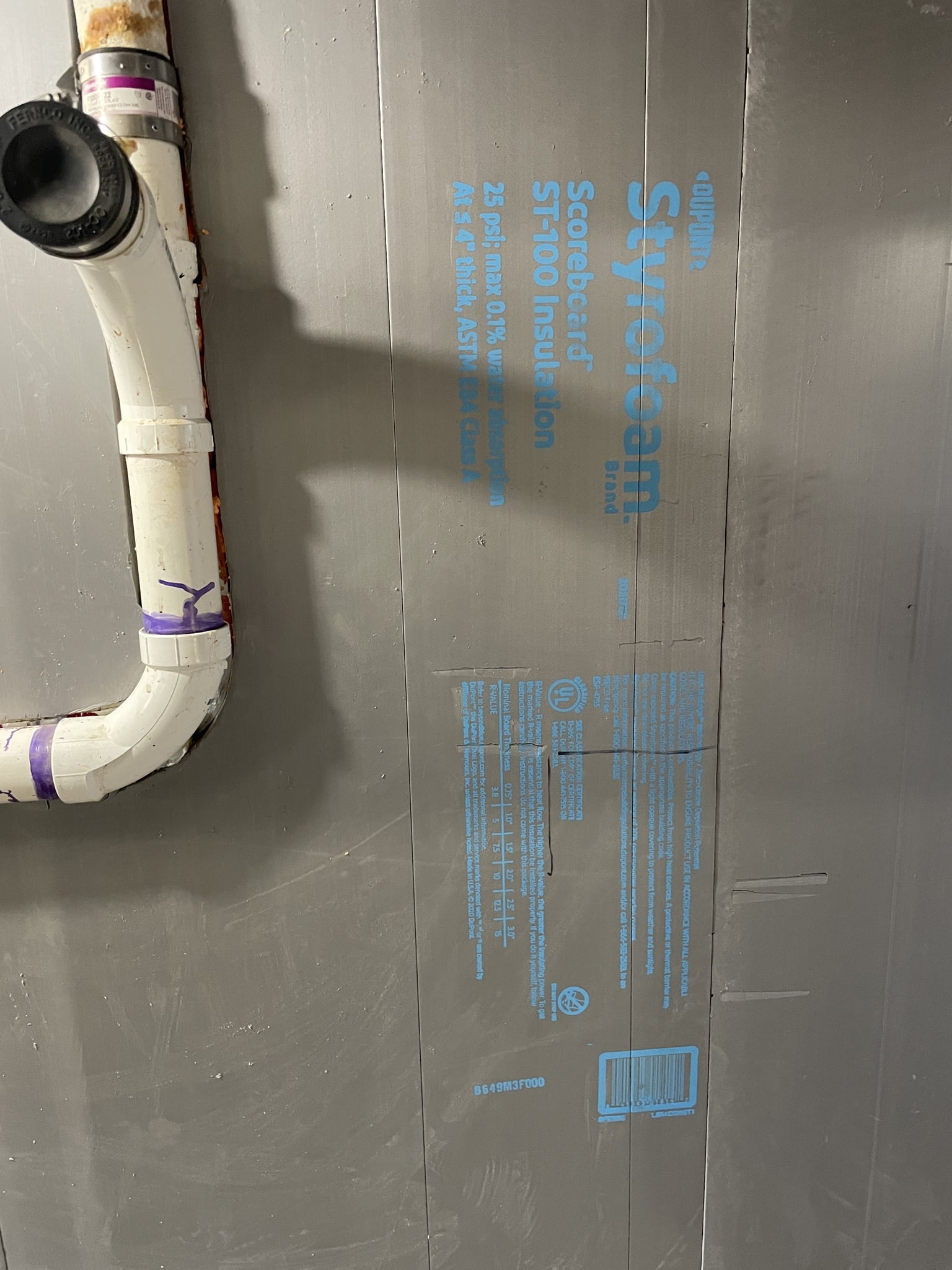

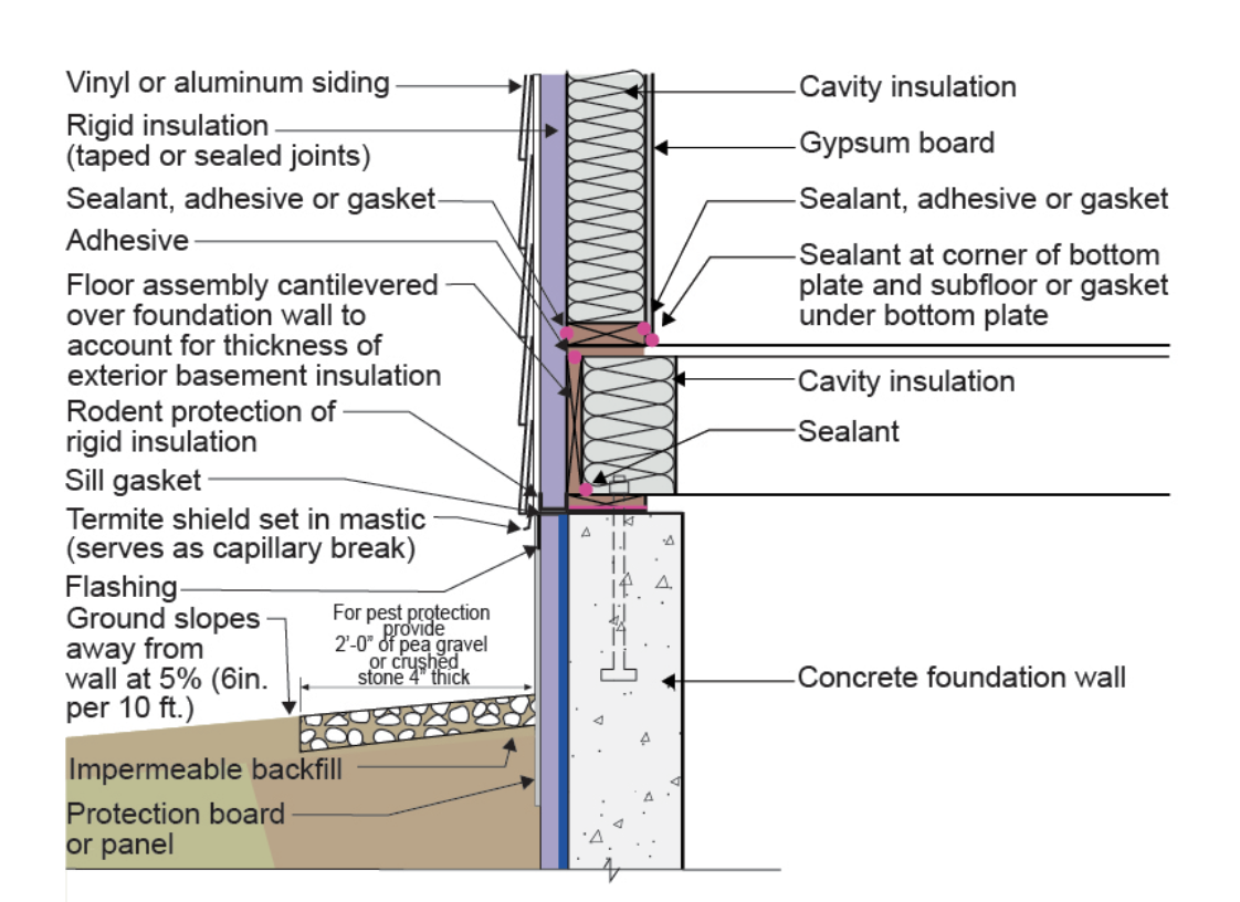

    In a stick framed house, a common myth is you can have a the basement as unconditioned space. There is no such thing, living space is near impossible to isolate from the basement. You are on the right path with your plan.
    I've read a lot of BSI over the years. I'm 100% sure, they never said that exterior rigid insulation doesn't work. They even show it here:
    https://buildingscience.com/documents/building-science-insights/bsi-142-foundation-insulation-protection
    Exterior rigid is somewhat common around me, box stores even sold a grooved version for a while so you could get drainage and insulation in one product. The bonus of exterior rigid over interior is that it doesn't need any protection so you can skip the interior framing/drywall until you
    You don't want polyiso though as it can absorb water over time, XPS is really the best product here.
    Another thing that can greatly help with thermal comfort is air sealing between the foundation and framing. The simplest is tape the two together. Siga Fentrim is the ultimate for this as it sticks like crazy, 3m 8067 flashing tape also works pretty well. Both tapes need to be rolled with a small J roller for proper adhesion. Taping all the seams of the plywood on the framing is also a great DIY job that makes a big difference on energy use.
    Hard to tell from the pictures, but a another common mistake a lot of contractors make is putting the foundation drain on top of the footing. This doesn't work as it means water level needs to go above the interior slab before it will drain. Foundation drains need to be put BESIDE the footer. Also make sure they put in the sub slab vapor barrier.

    Thanks very much @Kaos. Everything you said makes perfect sense. I will continue to gently promote my exterior insulation desire to them. It's totally on me that I didn't see it missing on the plans, but I am not familiar with looking at them so there are things I miss.
    They are putting the drains beside the footer I believe and will keep an eye on that—that detail is not on the plans.

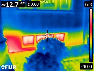

    @ethicalpaul - if the exterior insulation doesn’t pan out with the GC, you can always apply to interior walls. I used exposure rated DuPont gray board on the interior of the original basement. Went up quickly and made significant difference.
    The FLIR image give good before (left) and after (right) of the 1.5” R7.5 panel

    hot_rod Posts: 28,699

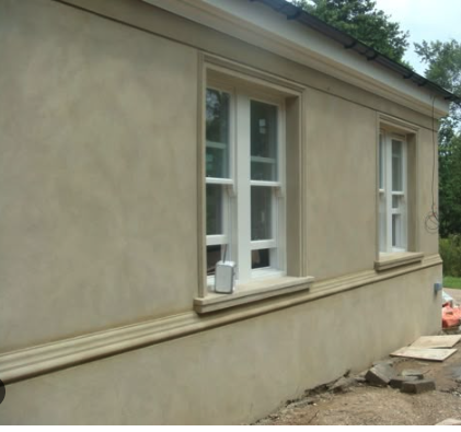

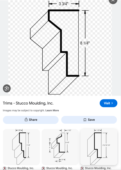

    there are all sorts of trims to do the detail where the stucco is proud of the upper wall.
    But I'd prefer it on the inside. Termites and some ants bore into foam.
    The foam from around my foundation in Missouri.
