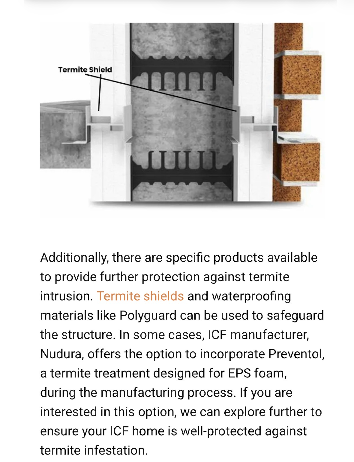

    hot_rod Member Posts: 27,695
    I did a few ICF jobs for my own buildings and a bunch of radiant in ICF homes.
    I'm told in Australlia they are required to wrap the underground ICF with stainless mesh for bug protection. They have a product that is mesh and a water proofer, according to one ICF manufacturer I worked with.
    I think ants and termites burrow in for housing, not a food source.
    BoraBoard is one brand of foam that claims to be "termite resistant"
