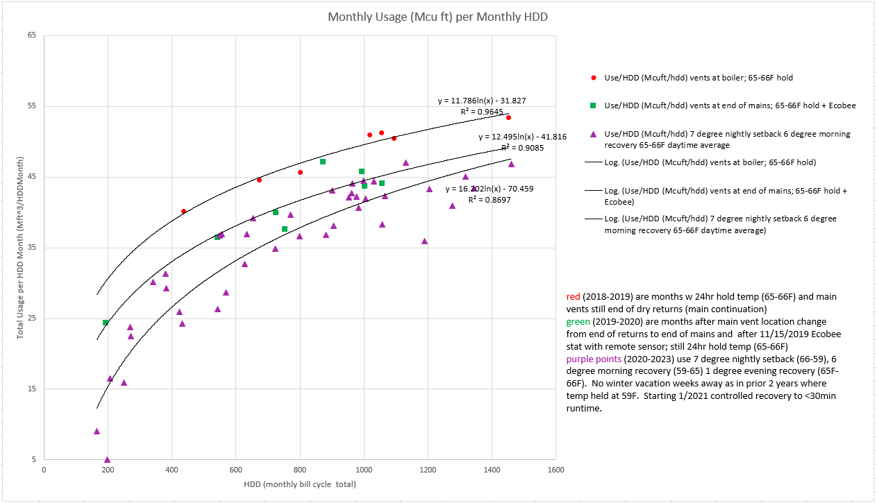

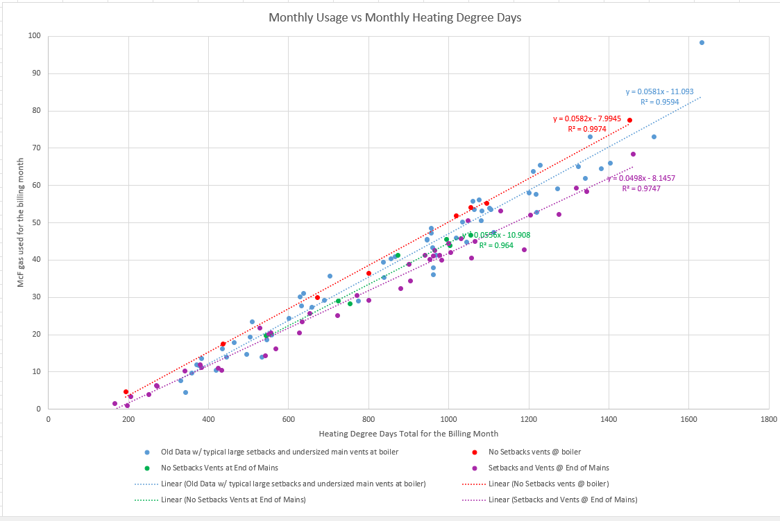

  • dabrakeman
    dabrakeman Member Posts: 1,021
    How quickly you get steam to the radiators does indeed improve total gas usage to satisfy the thermostat (I am avoiding the word efficiency here on purpose. As many of you know I have carefully recorded my gas usage vs HDD on a monthly basis for over 15 years now dedicating 3 entire years to comparisons of setbacks and main vent location. Pertinent to this discussion is the main vent location which in my case shortened time to main vent closure and delivery of steam to the runouts. The difference is quantifiable. Unfortunately, I did not have a simple comparison of poor vs good main venting since my main venting changed soon after getting a new boiler, changing my setback process, swapping out a bad sunroom radiator and adding some storm windows. All these factors are subsequently largely unchanged for the period comparing the baseline (no setback and vents at boiler - red) vs no setback vents at end of mains (green) vs setbacks with vents at end of mains. The conclusions were moving the main vents to end of the mains on an average winter month of about 800 total HDD with a constant hold temperature thermostat control I saved about 6 McF of gas use per month vs baseline. Going to a setback with the mains at end of the mains also showed an improvement but it was primarily just on more moderate temperature months with less impact on the coldest months. The two different plot styles below (same data) are used because the second one with the logarithmic curve fits shows the seasonal impact of setbacks more clearly.
    If someone has some better data please share.
    Captain Who
  • Captain Who
    Captain Who Member Posts: 883
    edited March 20
    @dabrakeman BOOM ! Nice work. Looking at the upper graph, it is pretty indisputable that the least mean squares line representing the Red Dots is definitely above and has higher slope compared to the one for Green Dots (about 10% less for your situation). If only we had some data for wet steam of a known % vs dry steam of a known %. Someone who is industrious enough could definitely do it for "Calculated Takeoff Velocity". Your data certainly disproves the faulty energy conservation argument of "no Btus lost to from the house".
