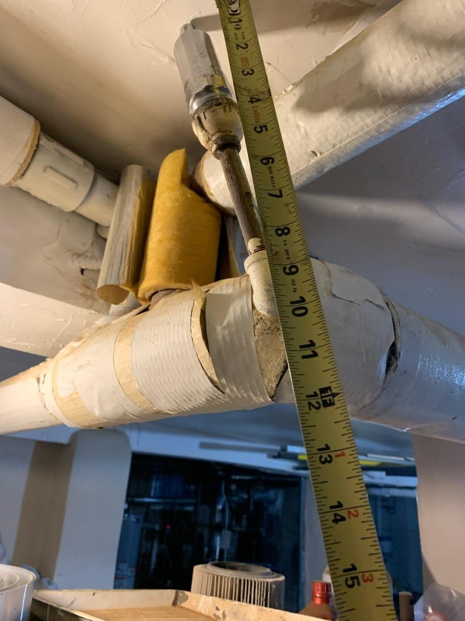

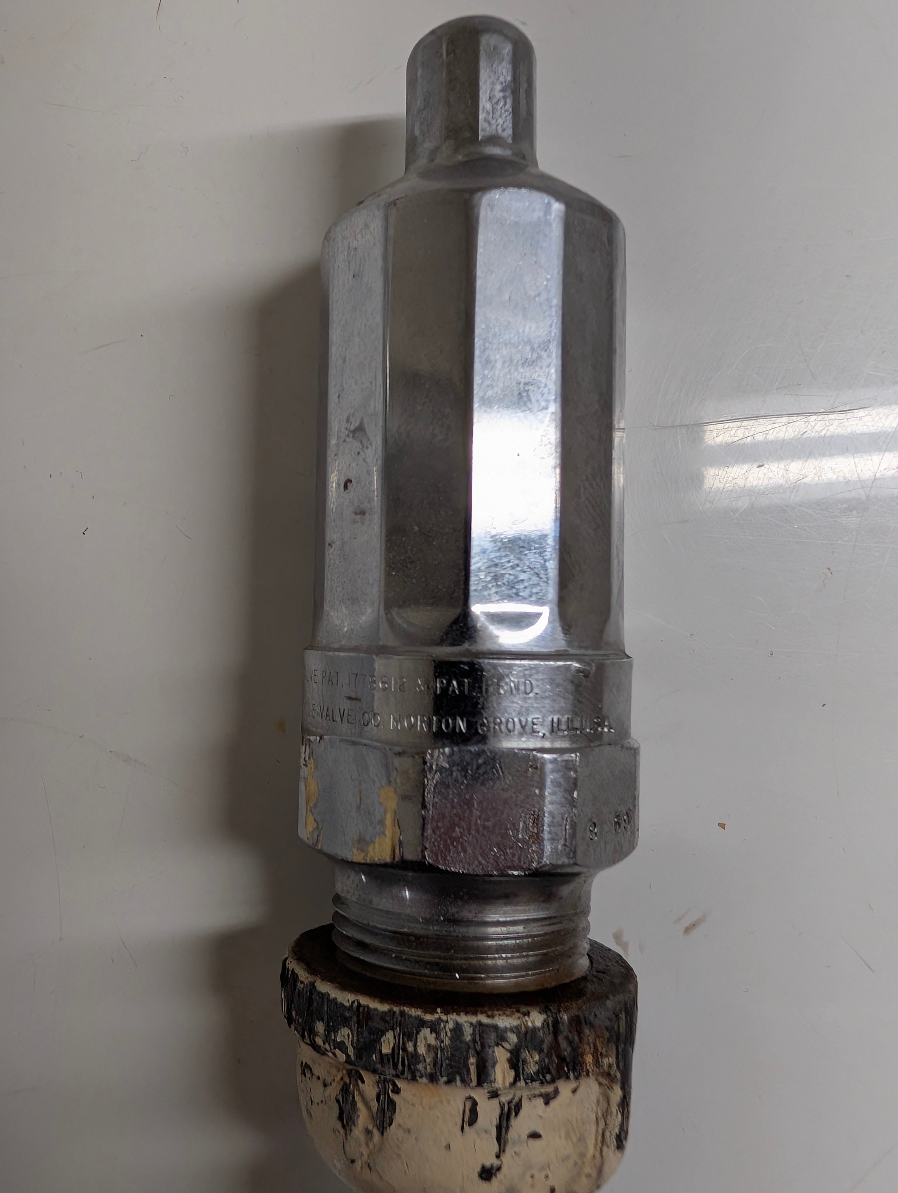

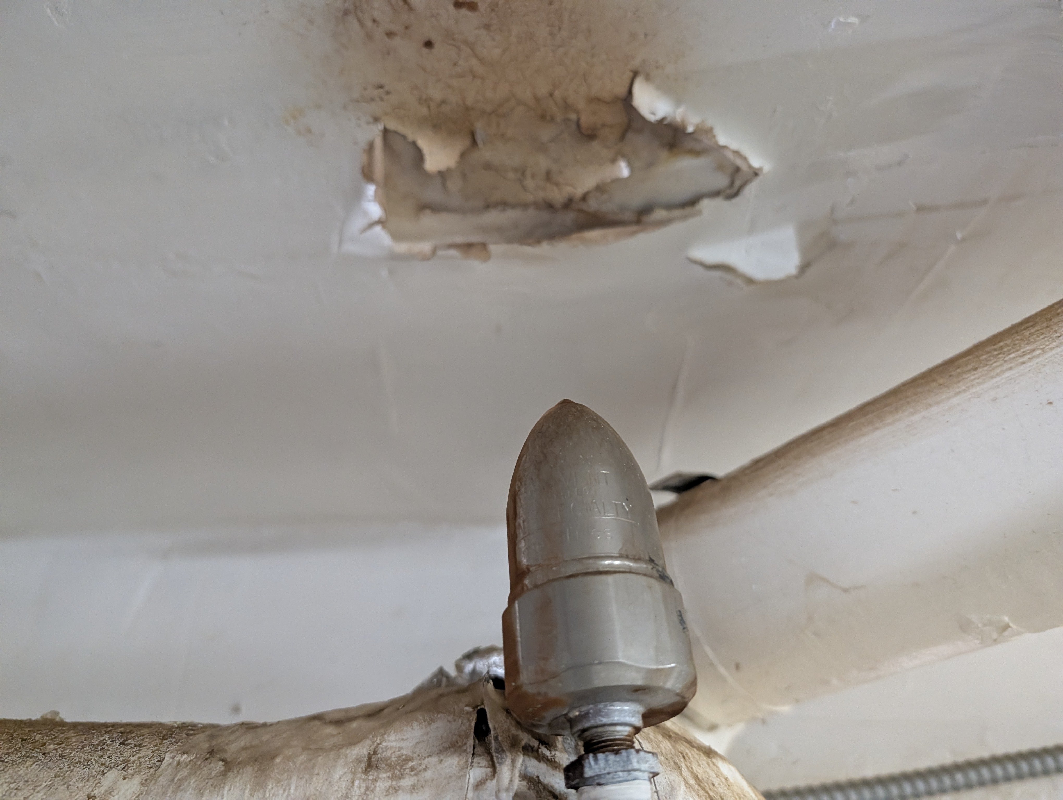

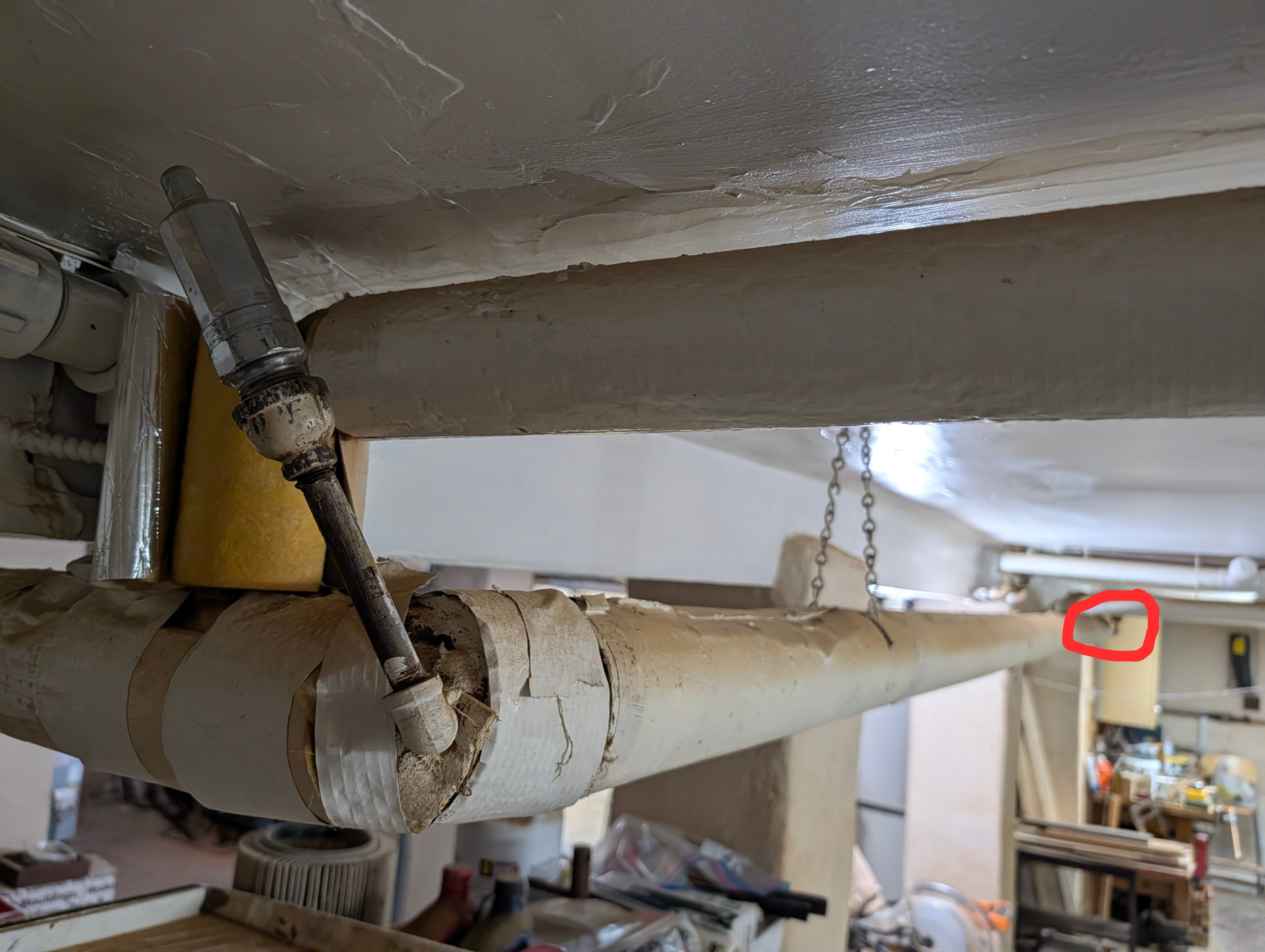

Hello -
Ordered and received my Gorton # 2 as recommended .
Since my previous post, I've had the opportunity to further explore over at my mother's. There are currently two vents on the main - one Hoffman # 41 about 12 feet from the boiler and then an unmarked, ancient Dole perpendicular to that one about an additional 12 feet away. I highly doubt that either of these is doing very much venting at all resulting in extremely high gas usage and bills this winter. Usage began to noticeably climb last winter, but prior to that, they were about a third of what they are now.
I will preface this that I am not looking for perfection, just a marked improvement to avoid having a 5 figure heating season bill.
My plan is to replace the 3/4" Dole furthest from the boiler with the Gorton as it will be the simplest by just adding a reducing coupling. Does having the Hoffman prior to the Gorton cause any issue? Like I mentioned, it doesn't seem to be venting anything, but if need be I could remove it and plug the tap. Right now, both of them get extremely hot very fast. Or, is there a benefit to having two vents in series? If there is, I could then replace the Hoffman with a 1/4" Gorton D say, for a little extra.
Secondly. what is the absolute minimum height for the Gorton to function properly. Right now I have approximately 9 inches from the tap to the ceiling. I could cut away the sheetrock and gain about another 2 inches — which would allow me to install the Gorton at about a 10 inch height. I would rather not mess with whatever original ceiling is above that.
Thanks again for all your help!

    Jamie Hall Posts: 27,907
    Having the Gorton last in line is fin3. No problem there.
    But.
    They have a float in them, and they really don't like to be anything off vertical. You may need to get a little creative… also an elbow isn't the best possible place….
  • MikeC_3
    MikeC_3 Posts: 77
    I can use a shorter nipple so it will be vertical, it just will be only around 9 inches above the main.

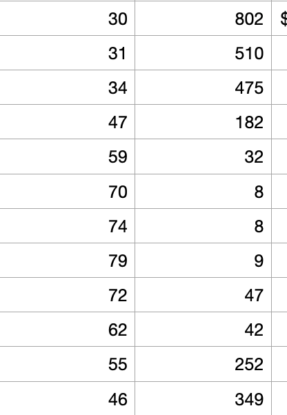

    There was a clogged pigtail that contributed to it, but that was promptly fixed. Boiler is only 3.5 years old.

    Neither a clogged pigtail, nor a bad main vent, will waste any noticeable amount of fuel. (I will edit myself to say if the main vent is failed shooting a lot of your steam into the basement, that could be some lost heat)
    When the boiler is firing, BTUs are going into your house. A vent or pigtail cannot divert those BTUs out of your house. As @patrykrebisz said, it's the colder winter this year that is freaking everyone out.
    But it's good to have good operating main vents. But since you said your existing main vents heat up very quickly, they may be operating OK already.
    109A_5 Posts: 4,617
    Wind velocity ? Wind direction ? I assume the chart is average monthly temperature and Therms.

    I meant Wind velocity ? Wind direction ? Influencing the fuel usage.
    Is the chart average monthly temperature and Therms ? My gas bill does not use Therms, I think it is CCF.
    I see a big difference between 47, 182 and 46, 349 So I'm not 100% sure what the numbers mean.
  • MikeC_3
    MikeC_3 Posts: 77
    Sorry, thought you were being sarcastic — yes, average temperature. National Grid converts CCF into Therms for billing. The last three months are the most telling 34/475 31/510, 30/802.
    109A_5 Posts: 4,617
    OK but how does that explain 47, 182 and 46, 349 ?
    I assume 46, 349 was last year, last winter, where this year 47, 182 was better (less fuel).
  • MikeC_3
    MikeC_3 Posts: 77
    Statistically speaking, this is probably a case where the average isn't the best way to compare. The standard deviation would tell us that. This year's 47 was November where the daily temperature was probably closer to that number. The earlier one was March when the first few weeks (like this month) can dip below 30.
