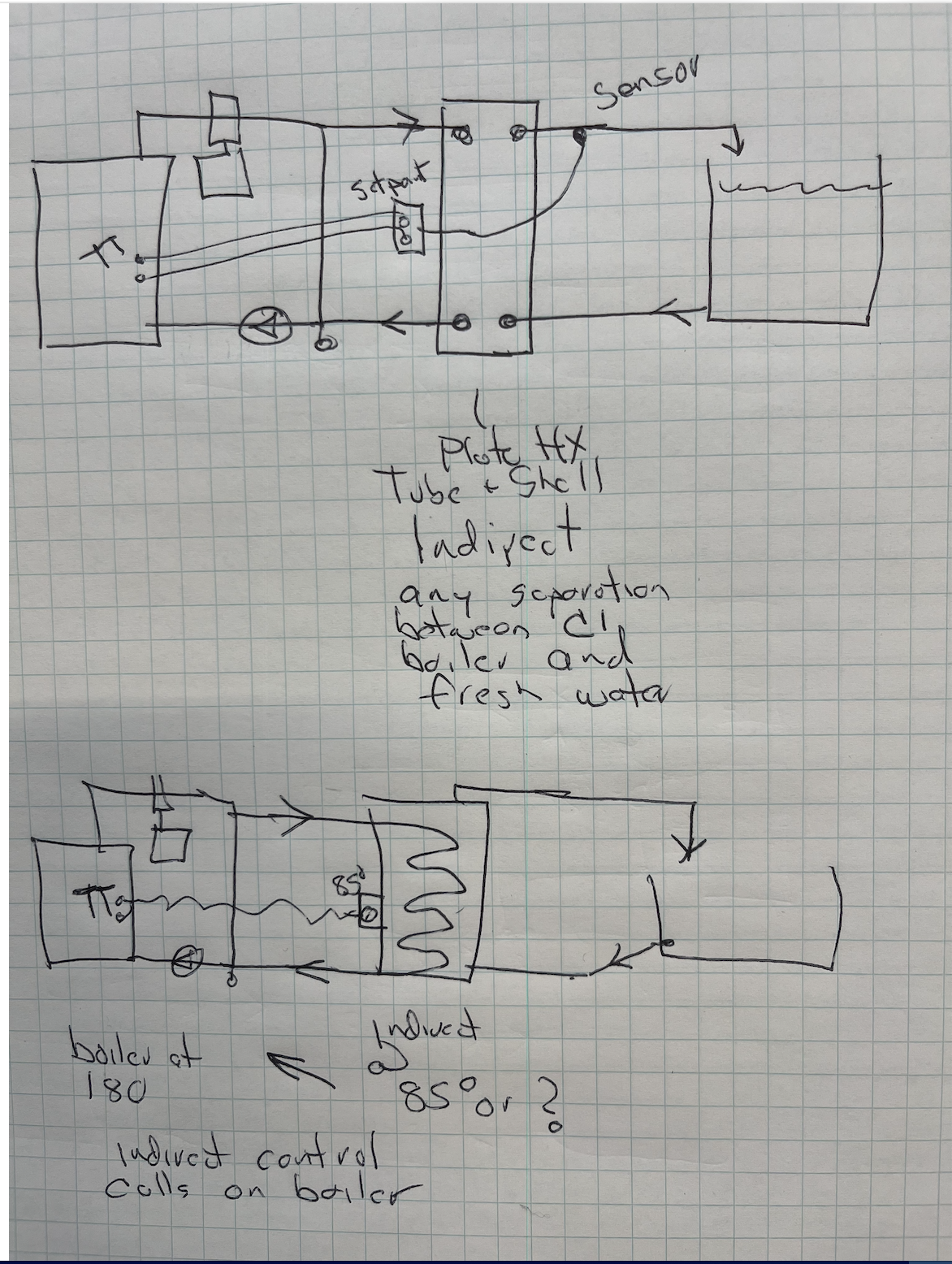

    The customer is fixed on a boiler set up. For your proposed set up which I like, is that with the boiler loop with a automatic bypass valve or primary secondary? Can you make a piping arrangement diagram? And I was thinking a tekmar 150 for controlling the pool temp. Thanks again
    hot_rod Posts: 28,528
    With a CI boiler you need some sort of return temperature protection if the tub is heated to say 85- 100°?
    A 3 way protection valve is ideal, or cobble together 3 ball valves and manually adjust flow.
    So you can use whatever device between the boiler and tank.
    With an indirect it may have the temperature control built in. Set it to the desired temperature wire it to TT on the boiler.

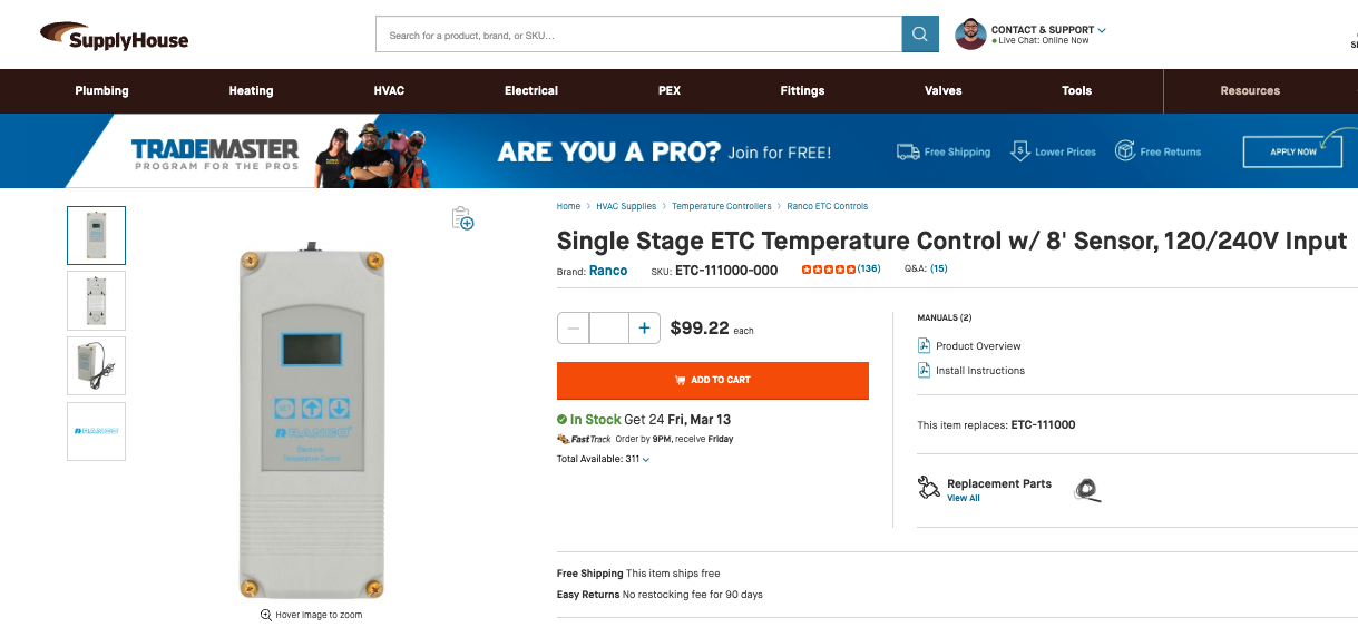

    A setpoint control like a Ranco, Johnson control, etc would allow tighter more accurate temperature control, and digital readout. Probably less $$ than a tekmar 150 and more features.
