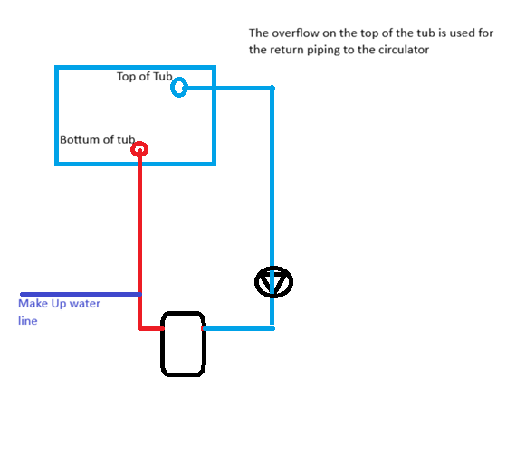

    The customer is fixed on a boiler set up. For your proposed set up which I like, is that with the boiler loop with a automatic bypass valve or primary secondary? Can you make a piping arrangement diagram? And I was thinking a tekmar 150 for controlling the pool temp. Thanks again
    hot_rod Posts: 28,705
    With a CI boiler you need some sort of return temperature protection if the tub is heated to say 85- 100°?
    A 3 way protection valve is ideal, or cobble together 3 ball valves and manually adjust flow.
    So you can use whatever device between the boiler and tank.
    With an indirect it may have the temperature control built in. Set it to the desired temperature wire it to TT on the boiler.
    A setpoint control like a Ranco, Johnson control, etc would allow tighter more accurate temperature control, and digital readout. Probably less $$ than a tekmar 150 and more features.

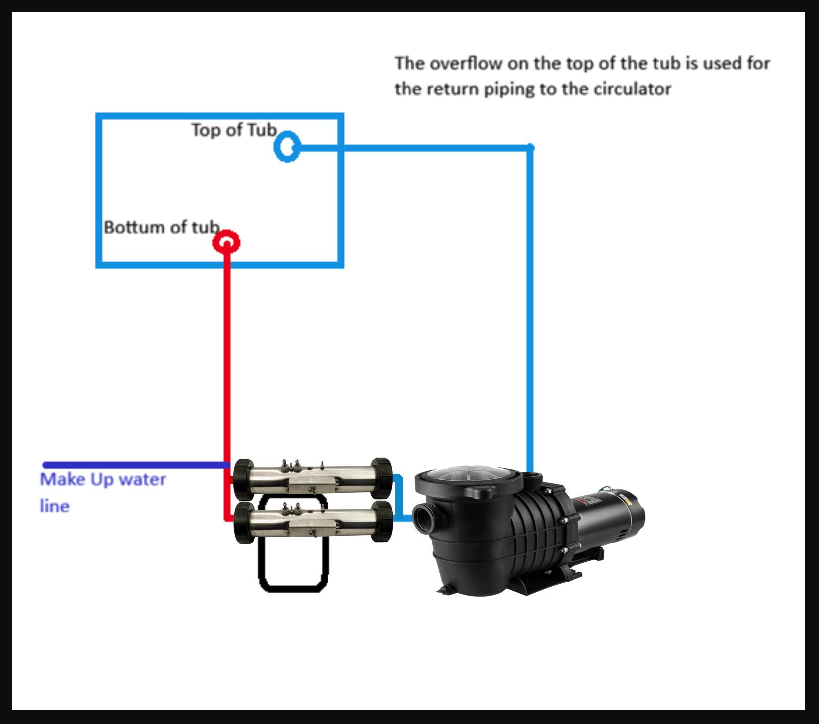

    This is what I come up with for your boiler system
    However, if you feel the need for overkill, install the bypass and use manual valves to get the return water temperature where you need it. The boiler protection valve will make the adjusting automatic if you believe you need it.
    The parts list is above and the boiler protection valve can be found here: Caleffi 280966A-1, but I really believe it is overkill. But if it is in the church's budget, then go for it. I try to keep the cost as low as possible when it comes to church.
    i really think a glass lined steel tank type gas or electric water heater will last forever in this application. if you're only putting 600 gallons of water in it a month that is nothing, in normal residential use it sees that in a couple days.
    i assume your boiler failed because you're running the tub water directly through it, a cast iron boiler isn't designed for an open system with potable water, a water heater is.

    Agree, but @Mail4tommo said above, "The customer is fixed on a boiler set up." I'd at least try to push an indirect coil.
    I also don't see the point of using a circulator pump instead of just filling it with water that goes through a water heater. Use a tempering valve to get it the right temperature.

    The original boiler was probably an AO Smith copper-coil water heater, similar to a AO Smith Burkay Water Heater. There was once a much smaller model available, but it is no longer manufactured.
    A copper-coil water heater with a bronze or stainless-steel circulator pump could last for decades in this type of application. However, in this case the unit has failed, and there is no inexpensive replacement that offers a 60,000 to 80,000 BTU burner, which would be ideal for this application.
    A large-burner, small-tank water heater would be perfect here. Unfortunately, there does not appear to be a large market for this type of water heater, so manufacturers rarely produce them.
    I suppose baptism is not a large market for water heater manufacturers.

    This is being made way more complicated than it needs to be.
    The makers of baptisteries also offer electric in line heaters (usually made by Little Giant) specifically for this purpose. They’re usually 4-5kw and can easily heat the average sized baptistery over night.
    I’m a Baptist and I’ve installed or repaired several over the years.

    Ed, the customer is definitely wrong in this case, probably from the misconception that they need a boiler to do the job.
    Baptist churches are democratic in their decision making (sometimes too much so) and usually a committee makes these kind of decisions. The problem is that the committee is quite often a pool of ignorance putting forth erroneous opinions.

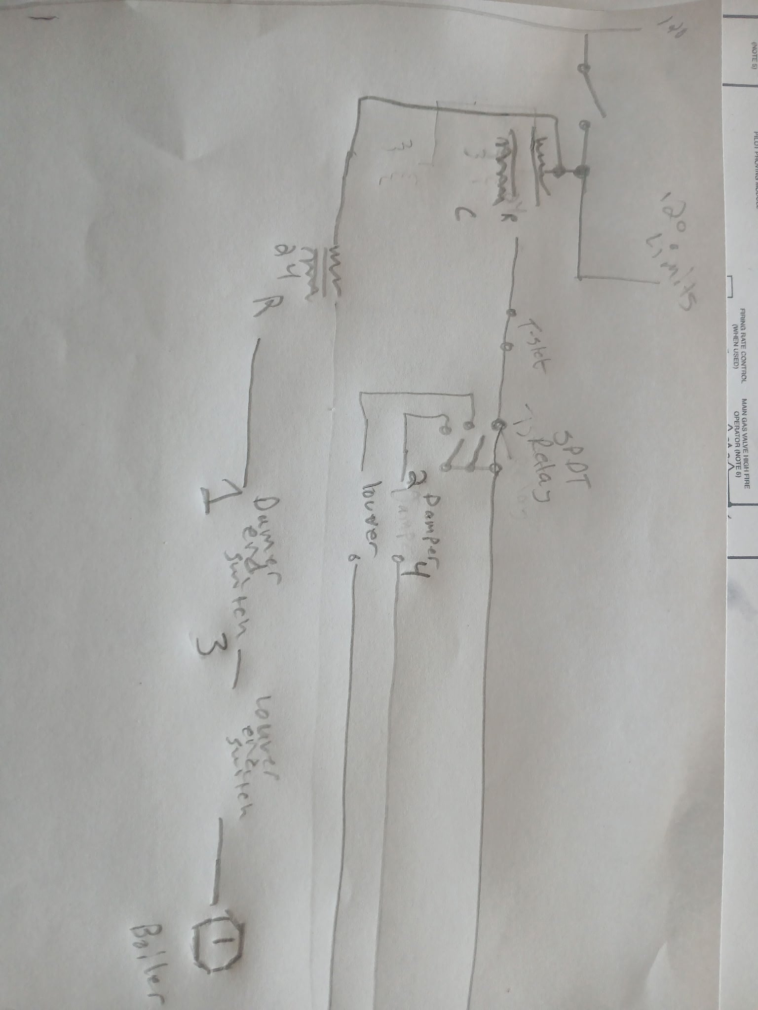

    @mattmia2 this was my first attempt... Then realizing the burner circuit will have no way of knowing what the pressure controls are doing... And keeping the burner on... So this won't work

    IDK if an SM8610U would be simpler, that Field Control is pretty straightforward. Regarding the combustion air damper, whether it springs open, closed, or doesn't move on power loss, along with the control voltage, is determined by the actuator you get. Get a 24 VAC spring return damper & mount it so it springs closed. I prefer an actual damper end switch (wisker or <gasp> mercury) to prove ic the damper is actually open, but an end switch in the actuator will work (the actuator has to be ordered with one).
    Don't use 120 volt actuator. You'll only make it harder on yourself.

    "you'd just put the end switches on both dampers in series with the burner control"
    Problem as soon as one of the 120 controls open you lose power to the actuators then.
    the thermostat or the end switches on the zone valves or the zone controller depending on how your system is set up should control the dampers then the damper end switches are in series with the other safeties to control the burner.
  • ratio
    ratio Posts: 4,344
    Yes, but if you ccan't open the damper, you can't safely fire the boiler, so it's moot.
    And don't use 120 volt actuators, use 24 volt actuators. You'll be glad you did.
  • pedmec
    pedmec Posts: 1,488
    RIB relay with 24 volt transformer for actuating damper.
    Thermostat closes and send 24 volts to the actuator. Actuator starts to open and closes the end switch. The end switch sends 24 back to the rib relay coil, closing the contacts.
    The common and normally open contact of the RIB relay will have the T-T terminals for a boiler demand.
    When the boiler flue damper opens it will send 24 volts thru the safeties to the ignition control module. I take the main valve 24 volts and send it to the relay at the fan in a can.
    This will close the contacts at the fan in a can. once the fan is up to speed it will close the pressure switch which will send 24 volts back to the main valve solenoid on the gas valve.
    there are other ways but i like to use the 24 volts from the main valve demand so the fan is the last thing to come on. i have seen electricians do it other ways but a failure after the the fan in a can will leave the fan running.
    By the way the larger size fan in a can requires you to add a relay. For some reason they don't install a realy like they do on the smaller ones

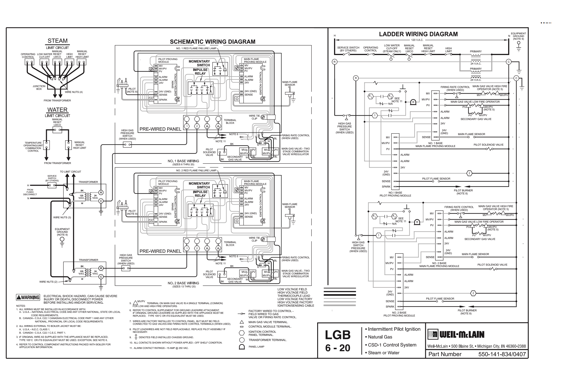

    About taking a ignition control off the boiler and replacing it with an ignition control that is equipped with a vent damper 6 pin molex plug I have this to say:
    The Weil-McLain LGB series is furnished with multiple factory wiring configurations to comply with various codes and standards, including Factory Mutual (FM), CSD-1, and others. In these boilers—particularly the larger models—the burner system may consist of multiple gas valves and corresponding ignition controls operating in stages. Because of this, a vent damper cannot simply be added by replacing or modifying a single ignition control.
    From a safety and code standpoint, the vent damper must be interlocked so that all burner circuits are proven safe before any ignition can occur. If only one ignition control is tied to the vent damper proving circuit, another stage could still energize and fire into a vent system that is closed or partially closed. This creates a serious hazard, including flue gas spillage and the potential for carbon monoxide exposure.
    Therefore, any vent damper installation must be integrated into the common safety circuit so that no burner—at any stage—can fire unless the vent damper is fully open and proven. Anything less does not meet the intent of NFPA 54 or CSD-1 safety requirements and should not be considered an acceptable installation.
    in this diagram there are 4 ignition controls to operate two different sections of the burners. the only common area for the vent dampera end switch is in the Line Voltage limit circuit before it feeds two separate low voltage control transformers.
    This would make it impossible to follow the 24 volt wiring that Field controls provides with the 12" vent damper. To know what to do here I would request that the actual wiring diagram from the boiler be provided. Hopefully it is from a series 1 LGB 7 that has simple wiring like a residential boiler system. With the actual wiring diagram the process will be easier without guesswork.
